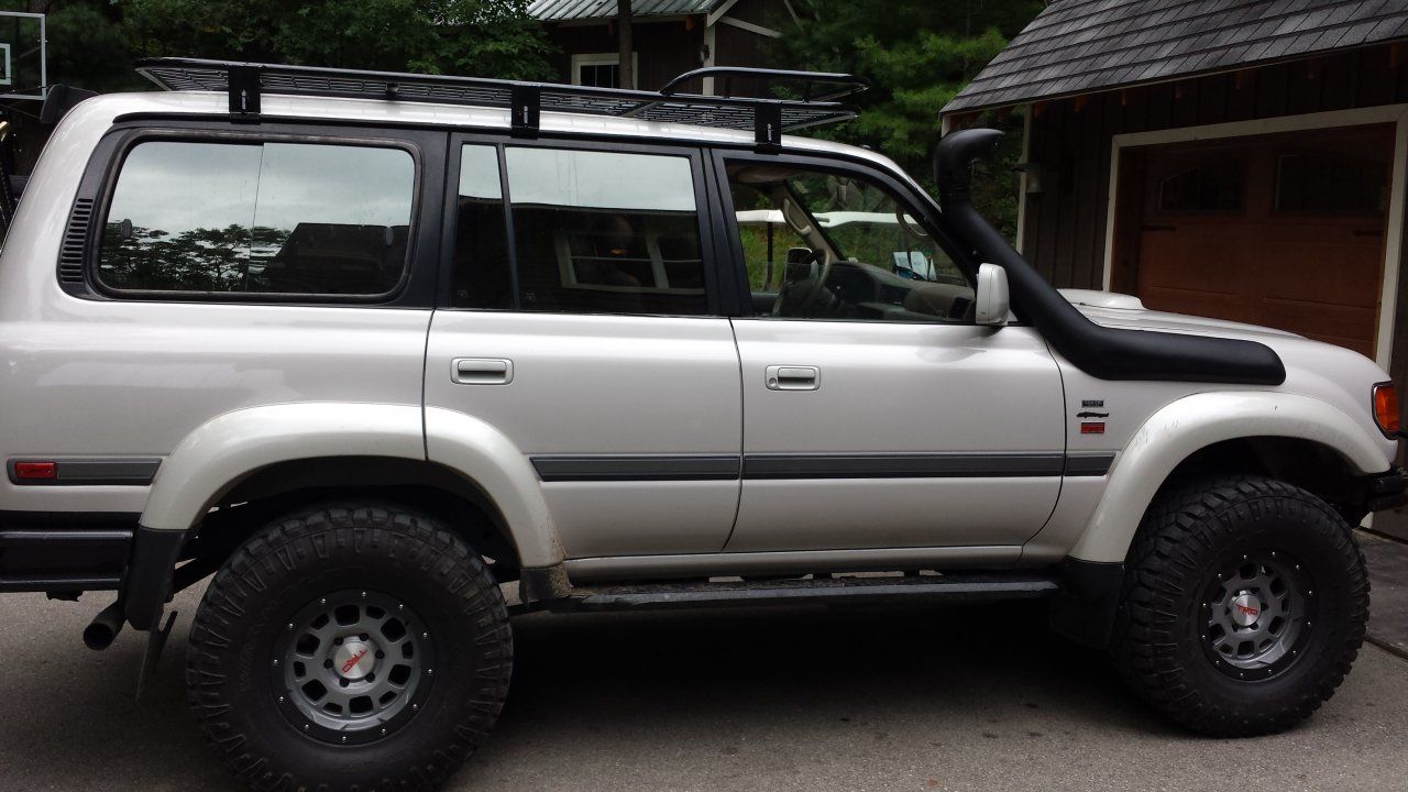

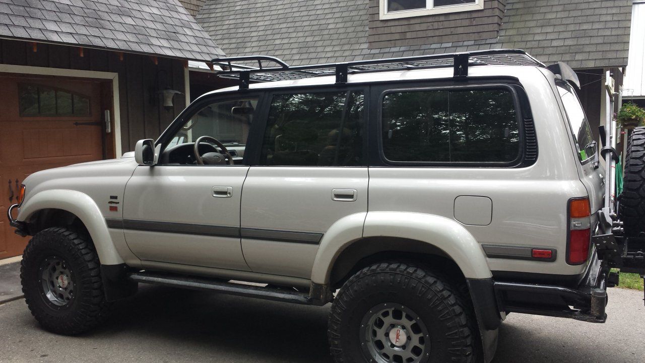

That's a cool color. It almost looks like the "millenium gray" on my rear bumper.
Cool. I picked it because there is a thread in the 100 series forum about it matching the bumpers on the dark colored Cruisers. It is a nice match to the stock 80 bumpers and side trim too.

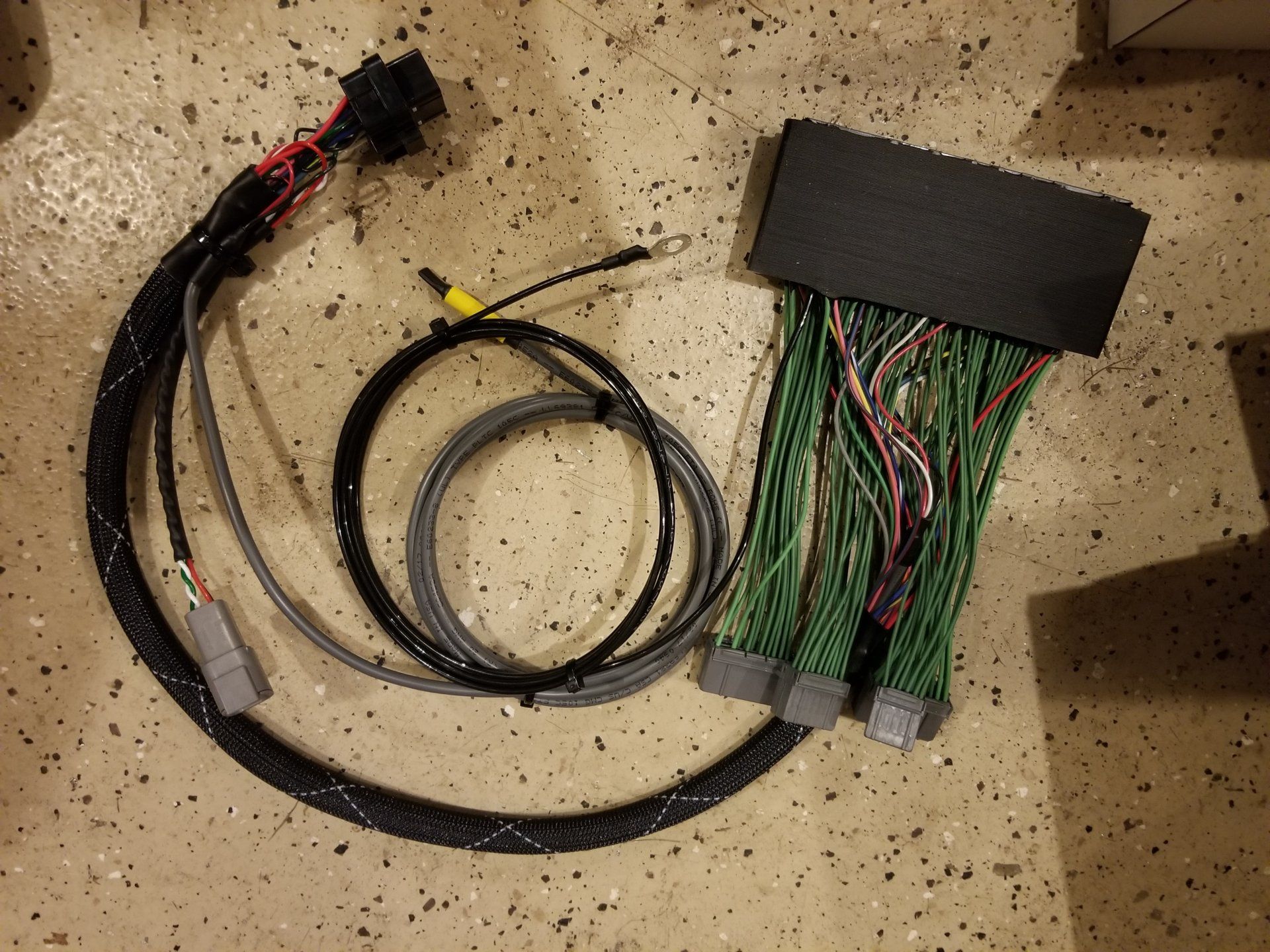

Hopefully the wiring is a bit easier with the Boomslang Fabrication harness I bought. It plugs into the factory harness and parallels the factory ecu. It should save a boatload of splicing.
