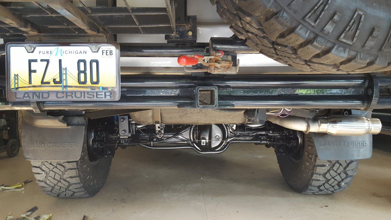

I got the tank in permanently. It looks so much better with the rest cleaned up. I just hated to put it together half assed. I gotta quit putting steps off til later.
A shot from straight back, i think it's tucked up there pretty well. It shows a little but not too bad. We'll see.
A shot from straight back, i think it's tucked up there pretty well. It shows a little but not too bad. We'll see.View attachment 1278045
Very nice build. I installed the OEM aux tank in my previous 80 and it was a pain. I especially like the filler neck. Let us know how it works, especially with fueling and transferring. Really nice and if it works well, I'm sure it will be followed.

Thanks. Hopefully the last little bit wont take too long. Another item i have been putting off is cleaning up wiring so i think a Blue Sea fuse block is going to become part of powering the sub tank pump.
Looking good! I'm assuming you'll just angle the fuel nozzle left or right depending on what tank you're trying to fill? Did you happen to find out what year Tracker the tank came from? This mod is moving up on my list and I'm trying to do it economically. Thanks for all the details and feedback.

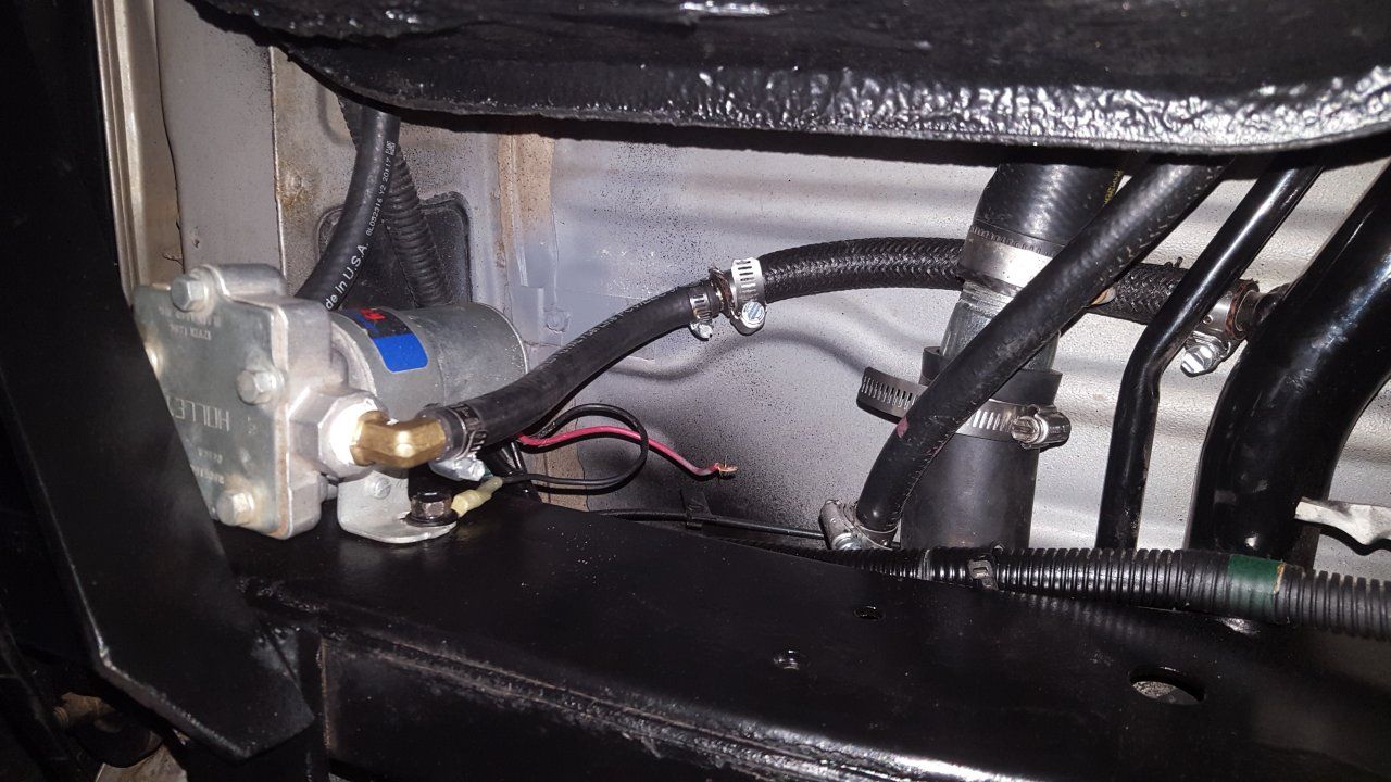

Pretty much finished the plumbing, kind of hard to see in the picture but you can see the dual filler, holley blue pump, and the fill and vent lines.
On to wiring which means I have to address the mess underhood. I bought a Blue Sea 12 fuse panel and built a mount for it that bolts to the vacuum canister bracket. Now I also
need to get my relays in order. Once done, I can power up the pump
