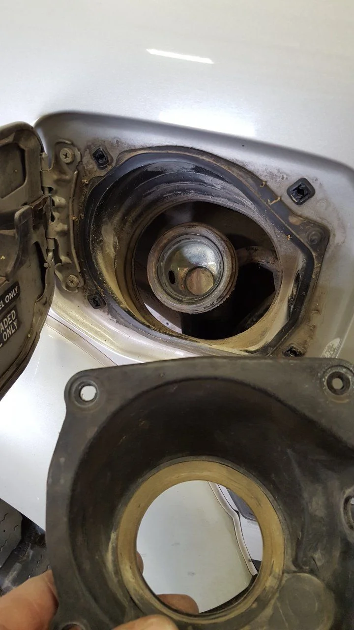

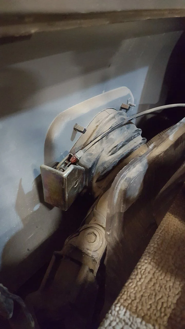

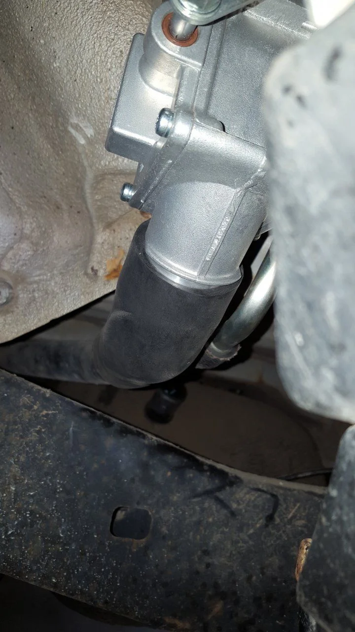

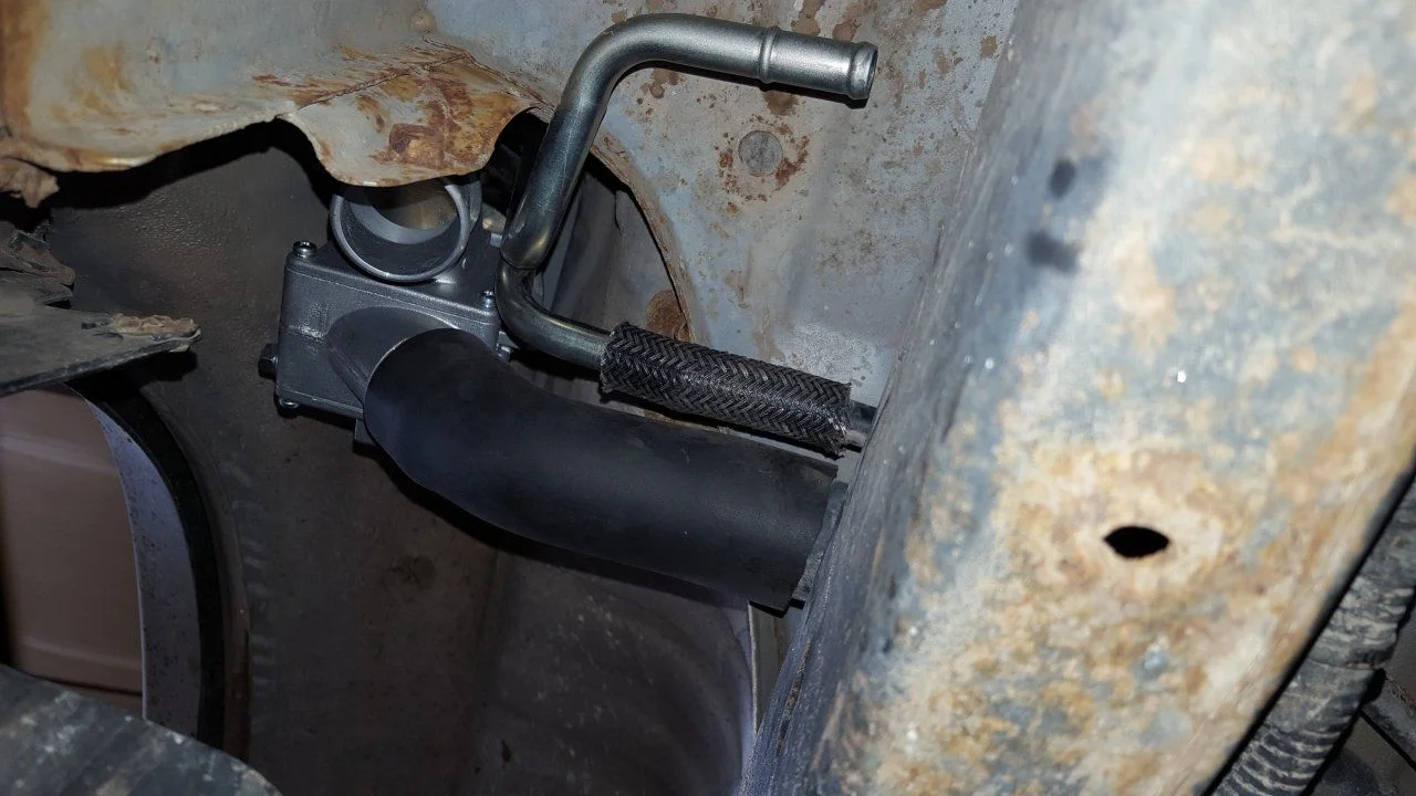

I made more headway on my sub tank install today. I installed the dual filler neck. It was really pretty easy, just remove the latch from the inside under the access panel, and take out the 4 screws. Next, I hack sawed the vent and fill pipe off.
In went the new filler, fit nicely. There is a blank in the plastic skirt at the top that i just drilled out and the supplied grommet fit in for the tank selector pull handle.

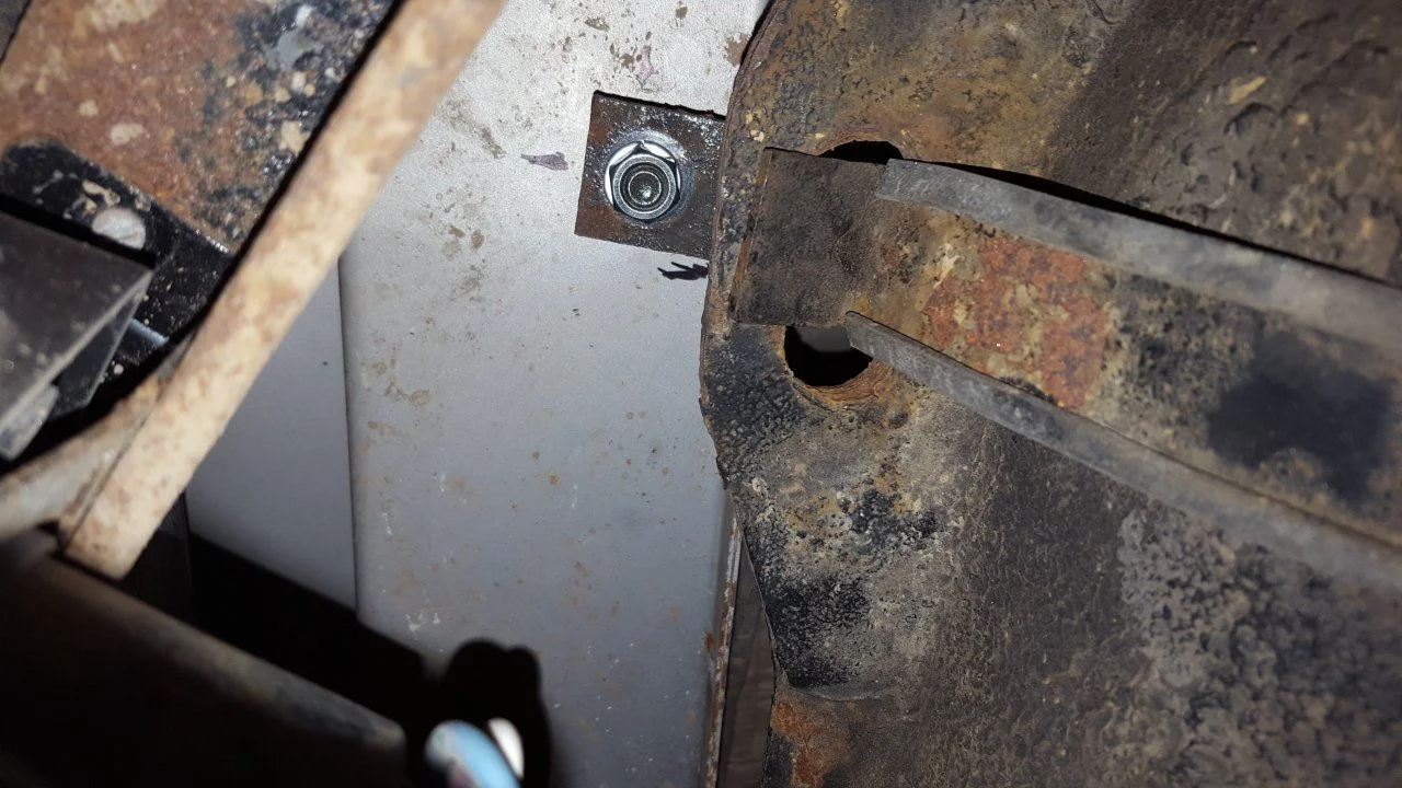

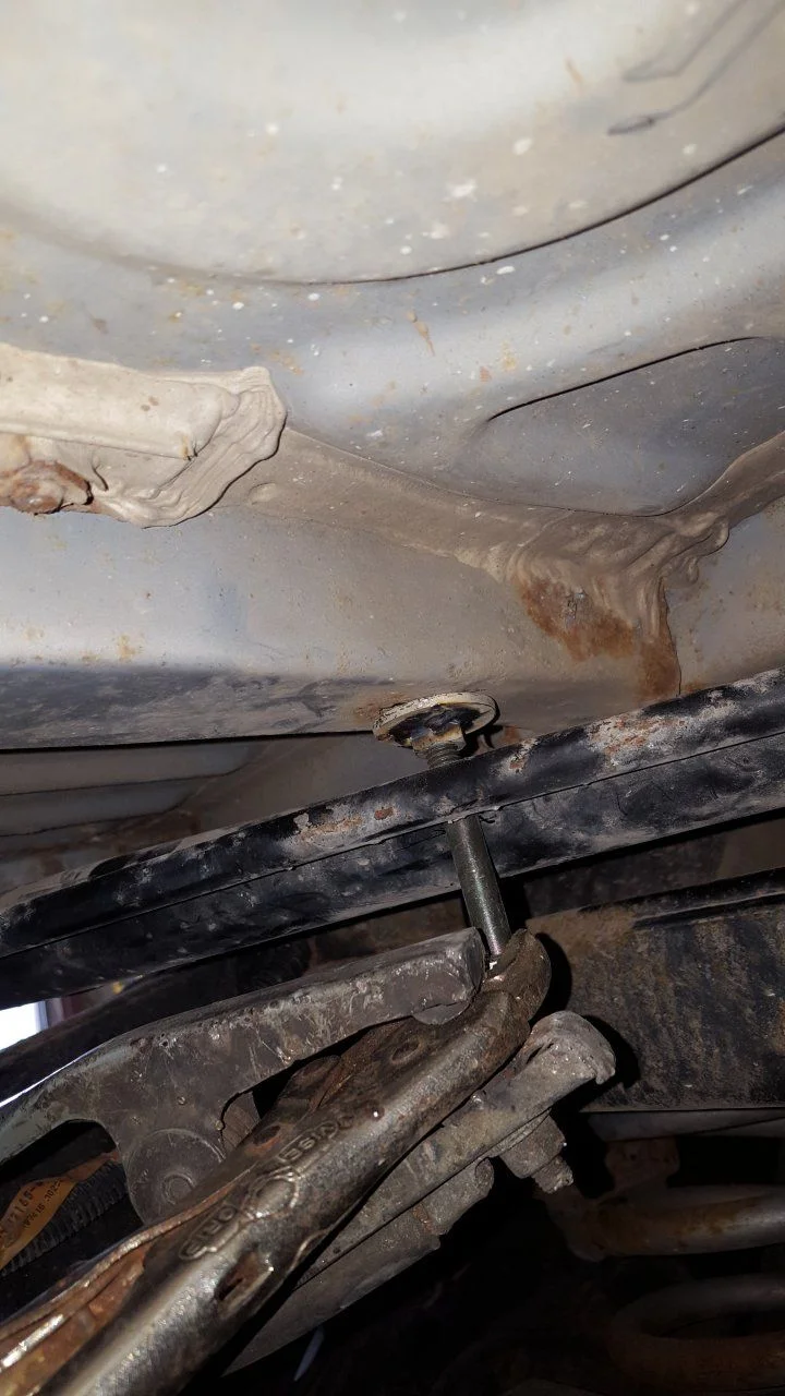

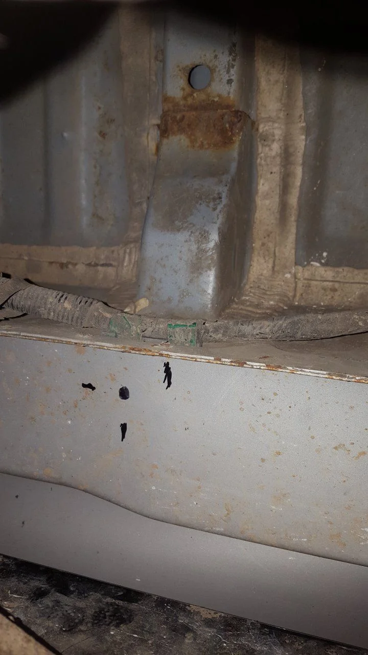

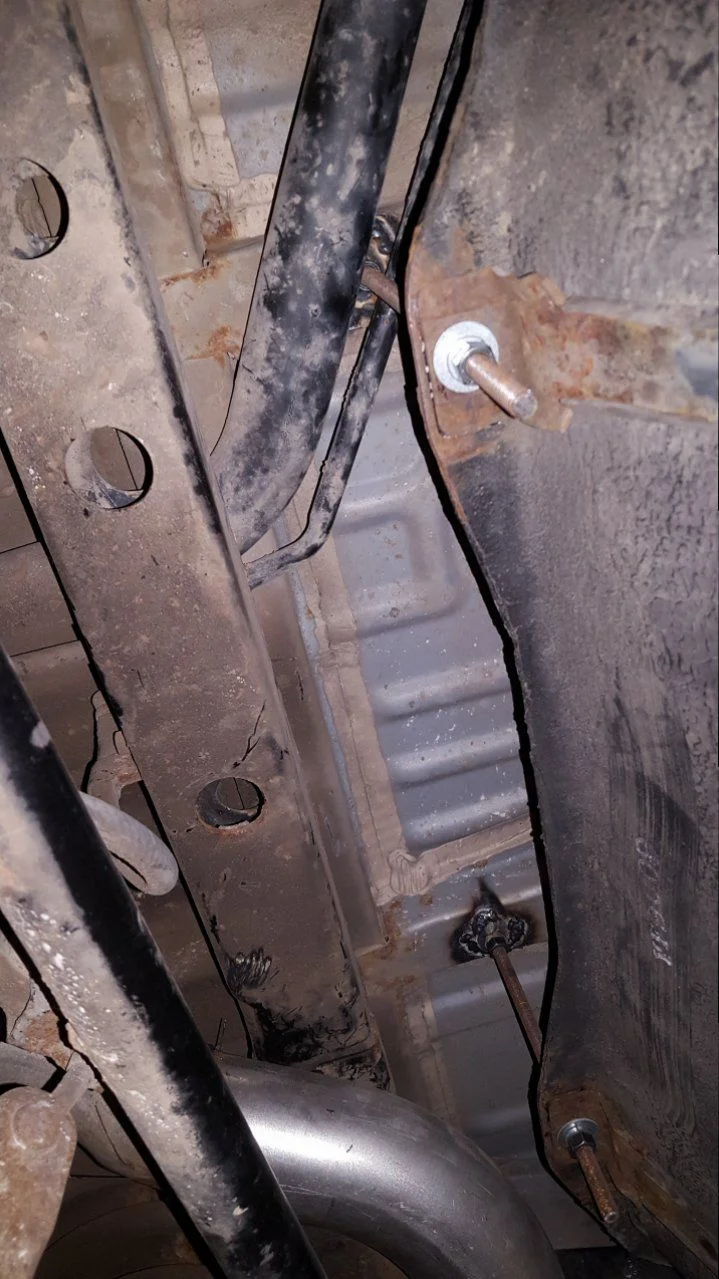

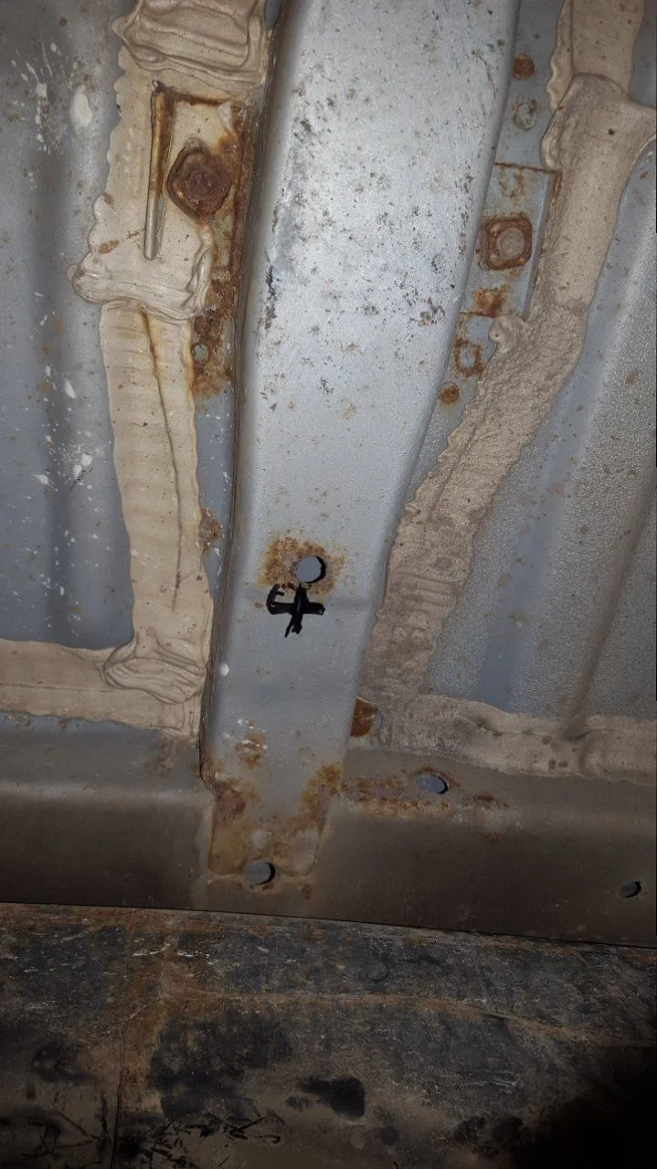

Next was to mark the body where the straps lined up with the tank ratchet strapped in. Then pull the tank and drill the holes in the body

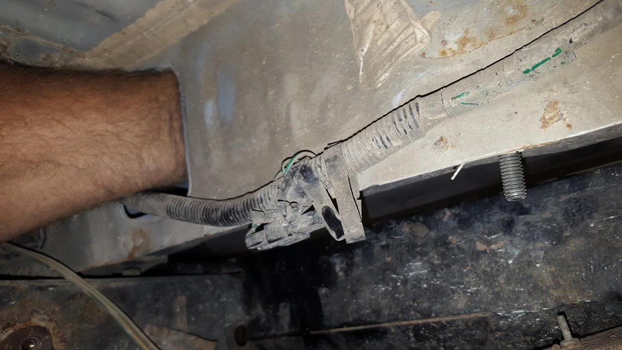

I pulled out the plastic covers for the back of the lower gate hinge and squeezed my arm in there to drop a bolt down for the rear part of the strap. That sucked! Hacked my arm up but i got it. After dropping the bolts,through, I ran a lock washer and nut on to hold it permanently.
On the front part of the strap, i welded a washer to a nut then held it up to the hole in the body with a bolt and welded the washer in.
I bolted up the tank and it fits perfect! I used threaded rod about 9" long on the front, and my rear bolts hang just enough. Now I will take it out and continue plumbing.

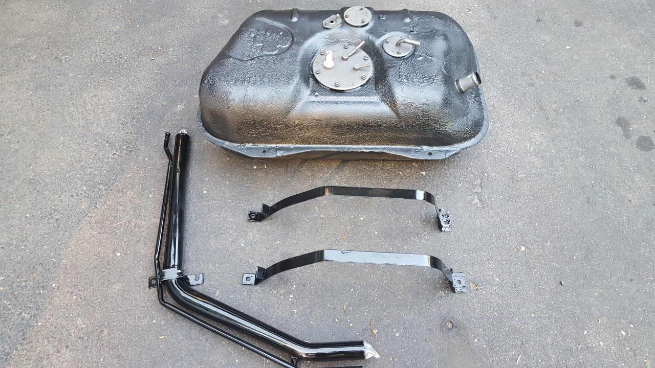

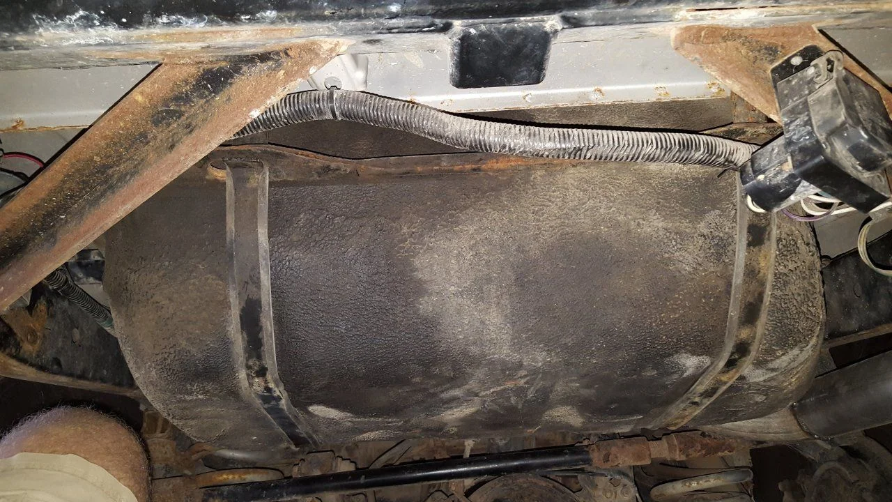

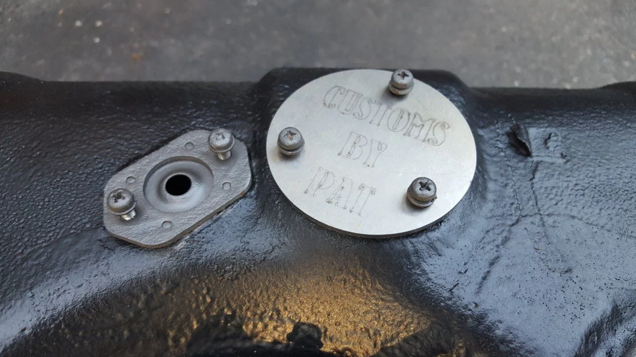

More progress on the su tank. I welded the bung on the filler pipe and powder coated it as well as the tank straps. The coating on the tank is suber tough so i sandblasted the grime off of it and the few rusty spots. Then I recoated the whole thing with good 3m undercoating. My buddy that runs a fab/laser cutting shop quick
cut me a cover out of stainless for the one hole I'm not using. He was having fun and engraved it too. I bought materials for an underside of the truck refresh this weekend, that's all thats keeping me from starting reassembly.

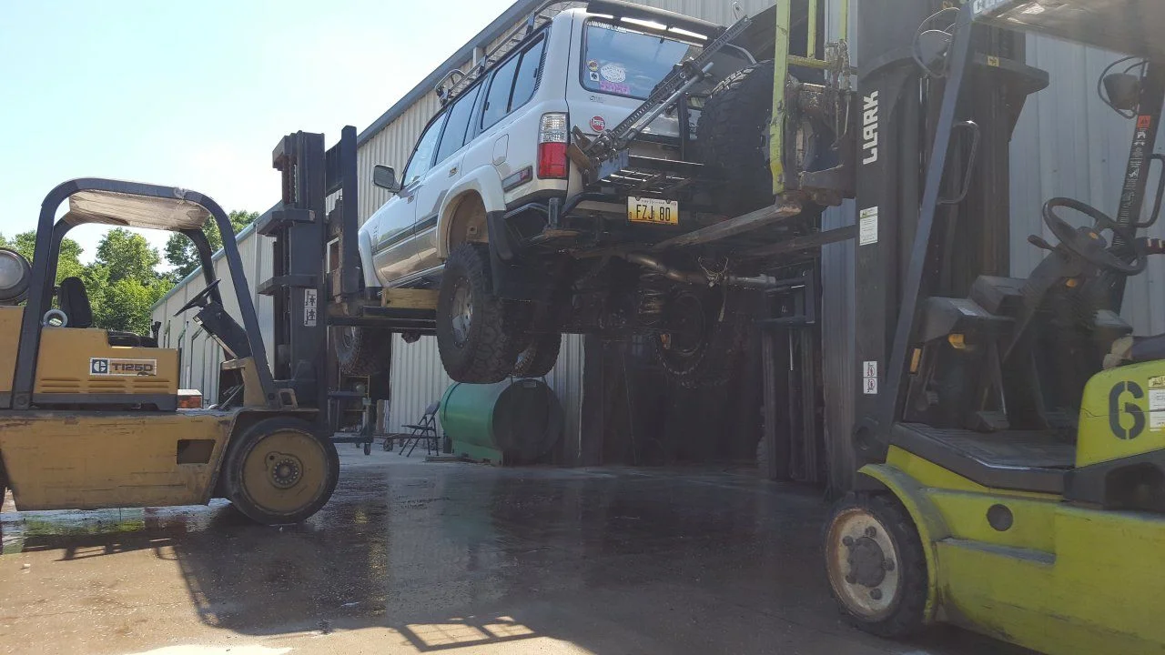

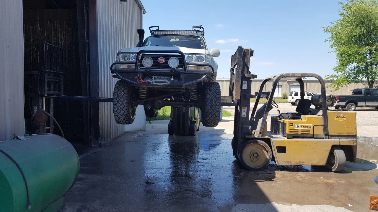

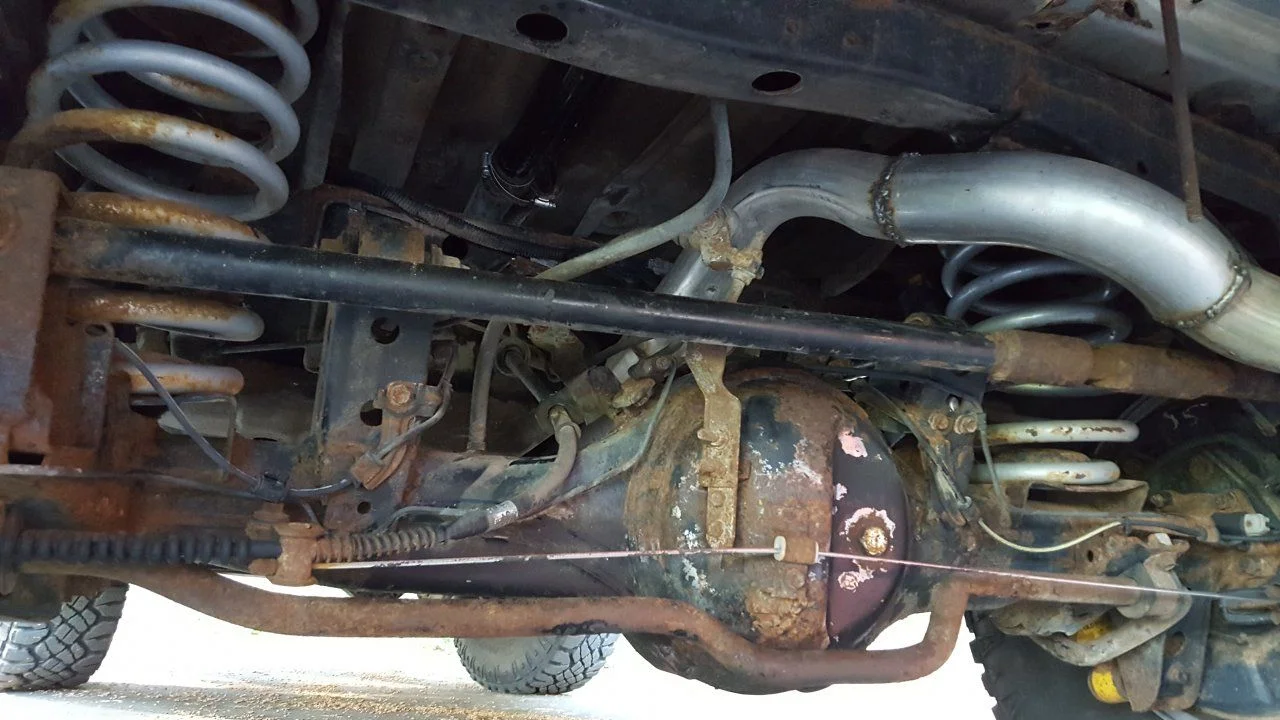

Picked it up with the 12,500# capacity fork lift, and backed it up with another and hot water power washed the bottom side. Next day will be blast and paint
Nice and clean but she has a suprising amount of rust coming from Missouri

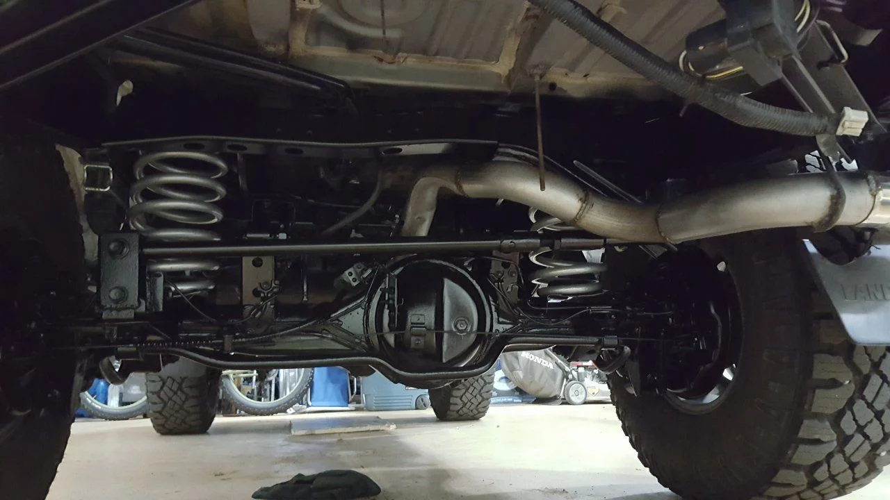

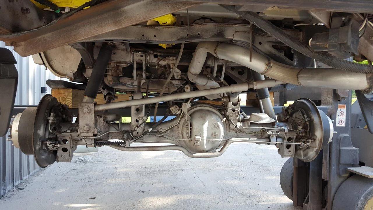

Picked it back up today and pulled the rear springs to powder coat, then sand blasted the crusty stuff to prep it for paint

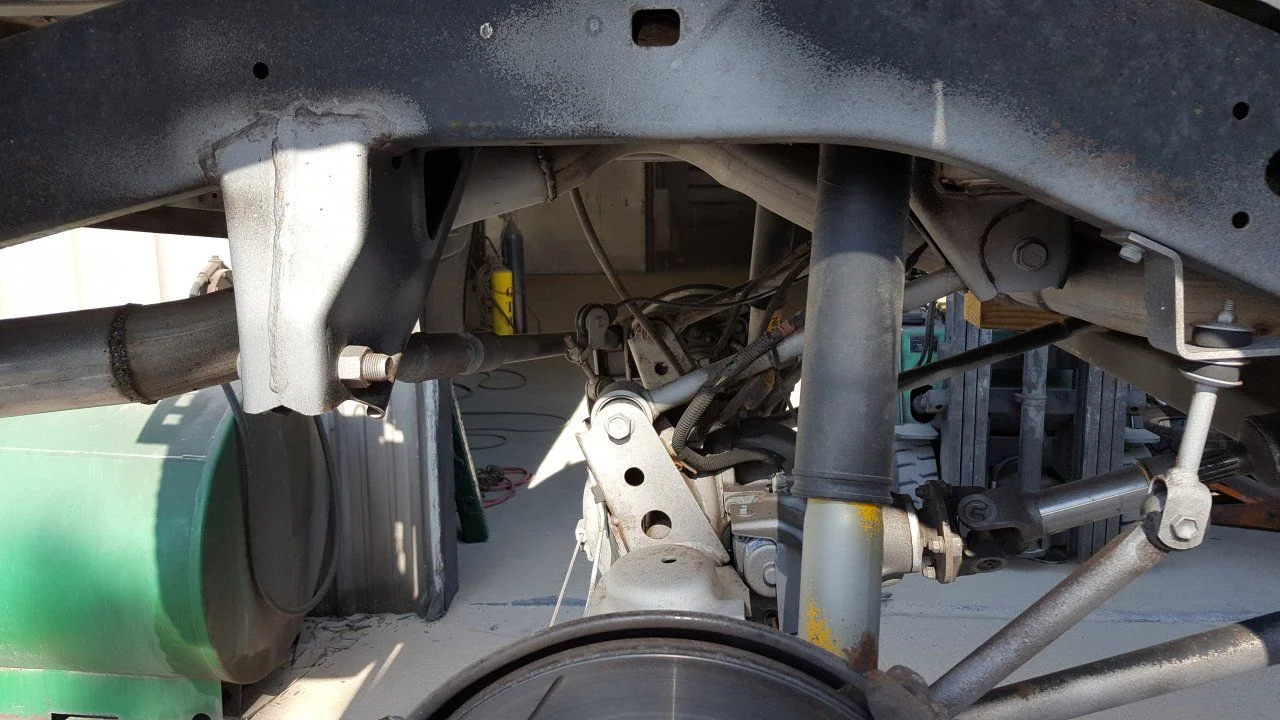

I used "Chassis Saver" paint in semi gloss. It uses moisture from the air to harden and is supposed to be super tough. We'll see. I sprayed it using my touch up spray gun for better control, also their reducer to thin it.
Two coats of paint, blasted and powder coated the springs and back together. Now ready to proceed with the sub tank install.
