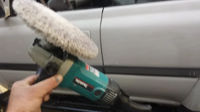

Started wet sanding and polishing the sides, heavily scuffed but no real deep scratches. 20140419_193700.webp20140419_193709.webp 20140419_193735.webp 20140419_193759.webp

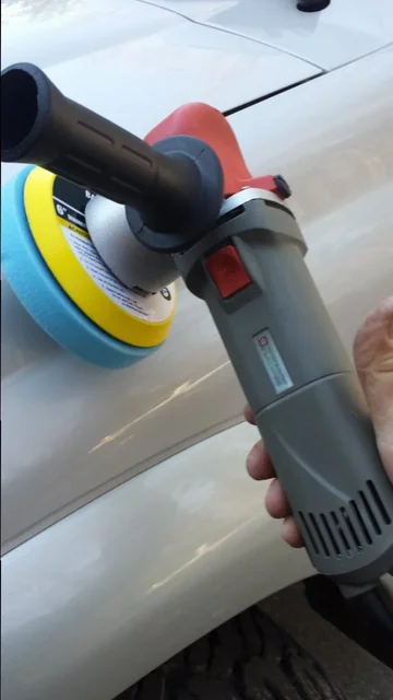

Also, I bought this orbital polisher from harbor freight. Seems to work pretty good20140420_095235.webp20140420_095235.webp 20140420_094832.webp
