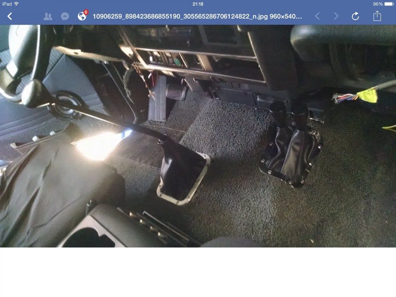

Some pics of my shifter:
Love the shifter boot. Very clean!

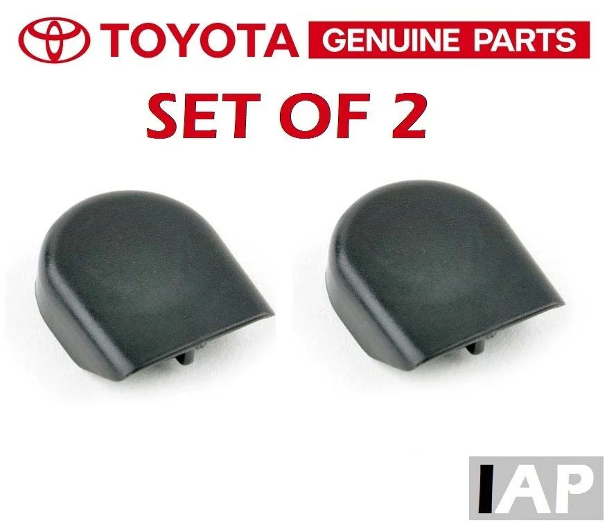

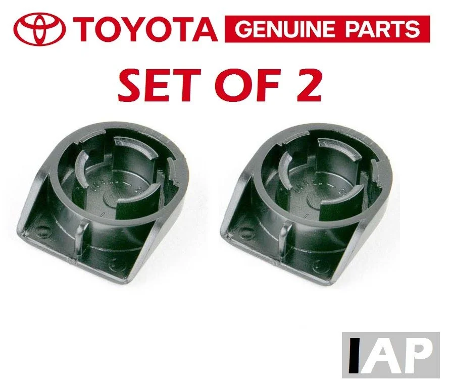

The arms bolts right on and feel stronger than the stock FJ60 arms, hopefully they will make better contact with the windshield. Only issue now is the bolt is exposed...maybe paint it black? Maybe these covers would fit?
Part #: 85221-35080
Part #: 90179-08026

Put some anti-seize on the threads, then cover them with these:
Also, what are the wiper blades off of? 4Runner I assume?
Nooooiiiicceee, I'll get a set of those.
