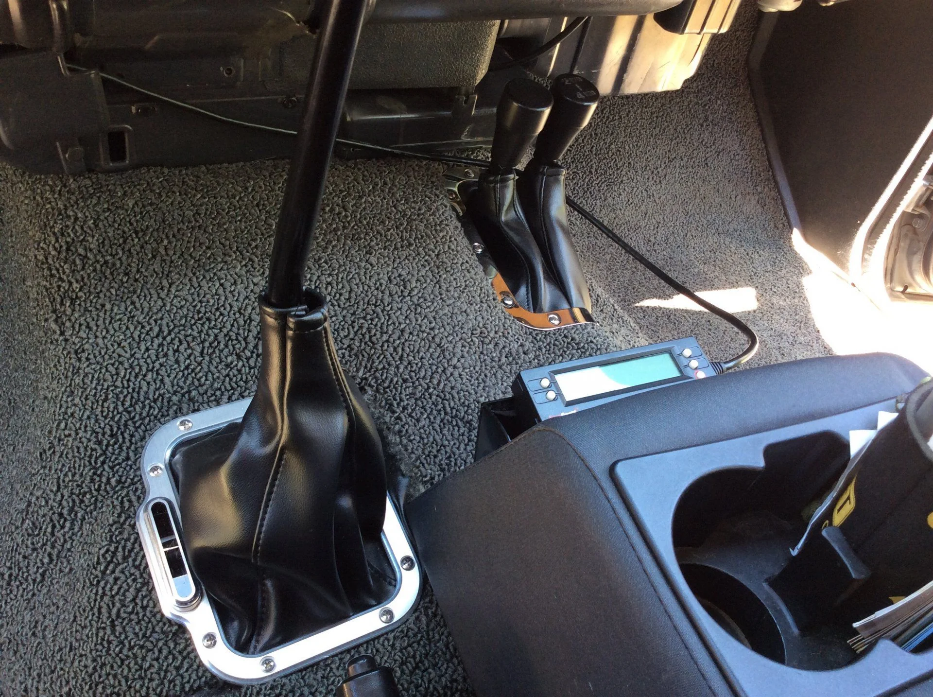

Lokar shifter is bolted down

Is there a gear indicator for the Lokar shifter or do you just count the clicks?
You can actually purchase a Lokar indicator boot that either has the indicator on the side (left of right) or bottom!

During my conversion I used the Lokar shift indicator. It's been a great addition.
