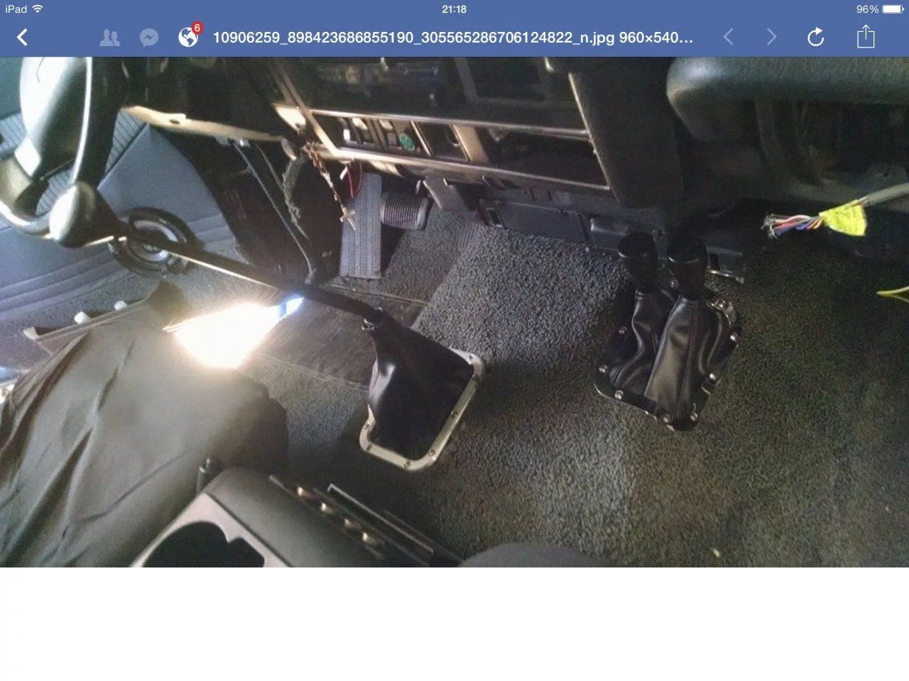

Followed your build, and adventures, on instagram. Huge fan! Had a few questions regarding shifter fitment. We've actually chatted quite a bit on instagram. I'm @CruiserSam.
I'm about to drop a 700r4 behind a tbi 350 in my trusty cruiser and I'm torn between the 23inch lokar or the shorter one. Saw the tuffy console and thats the same setup I want to run. What length did were you able to fit with the tuffy?
I don't have the exact Lokar part #...but I'm not the first to use it on a 4L65E around here so I'm sure you can find it.
The shifter I have has a long neck and works fine with the 8" tuffy console w/ cupholders
Lokar shifter 16" auto transmission fits 4L60 part # FMS64L60B
No clearance issues with a VDP center console.
