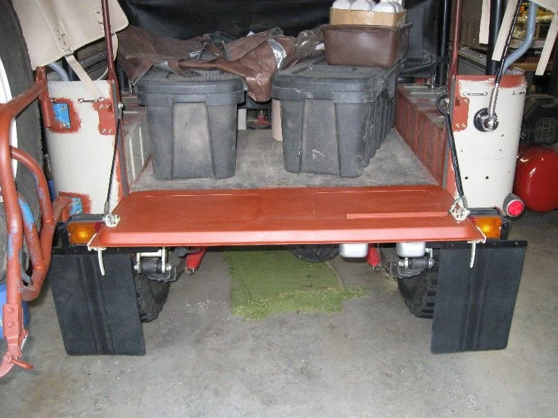

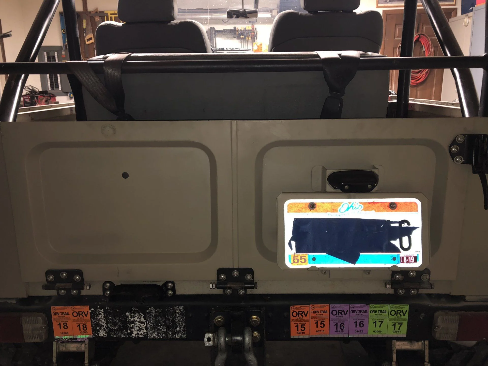

I cut and pasted an 81ish mini truck tailgate to fit. Used the mini truck hinges, jeep mj (or whatever the little cherokee trucks were called) junk yard limit straps and 2 sets of 40 barn door latches to keep it closed.
D
I cut and pasted an 81ish mini truck tailgate to fit. Used the mini truck hinges, jeep mj (or whatever the little cherokee trucks were called) junk yard limit straps and 2 sets of 40 barn door latches to keep it closed.View attachment 1829348 View attachment 1829349 View attachment 1829352
D
Just a FYI the spare tire latches are the same as the tailgate and barn doors. The 75/76 spare tire latches is the opposite and works the correct way on the left side. Not easy to find them but just a heads up if you do see one for sale.

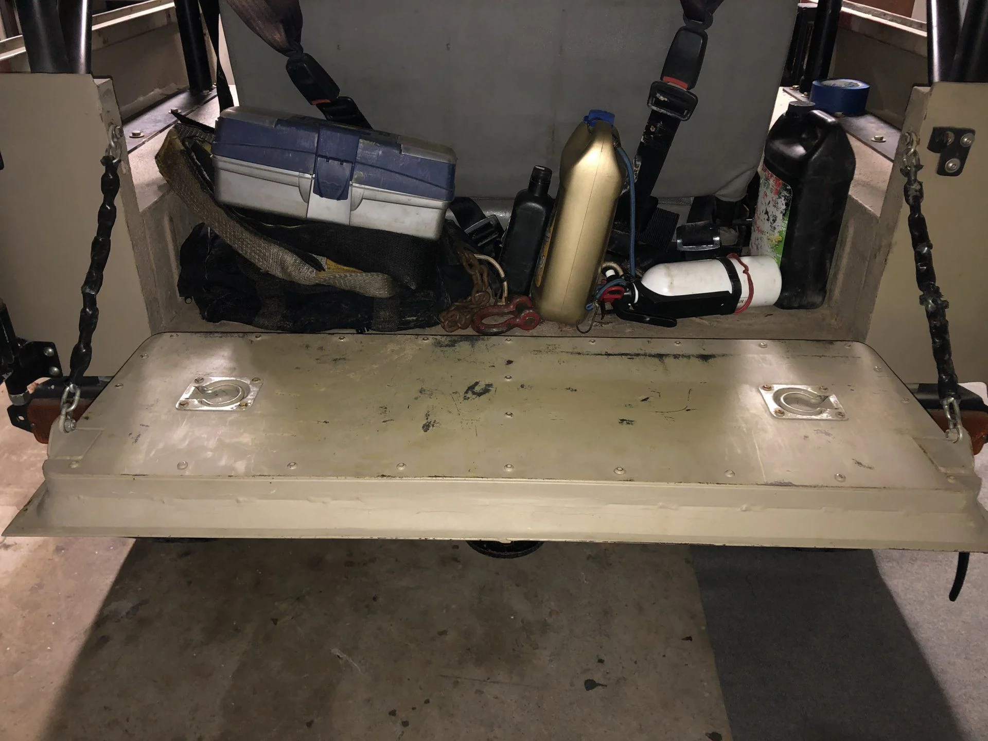

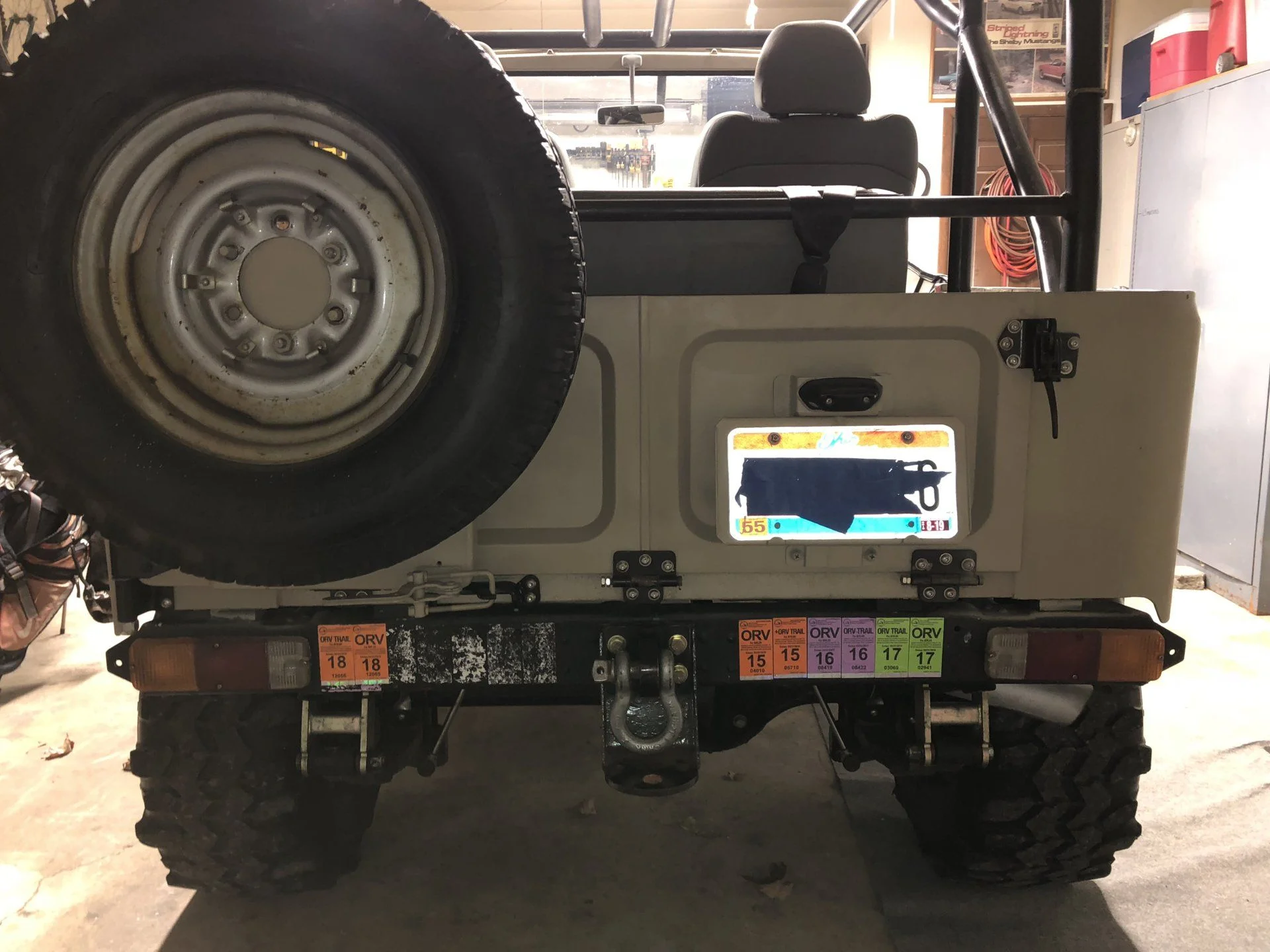

Unsymetrical in the new symetrical lol. Used what i had when i needed it.

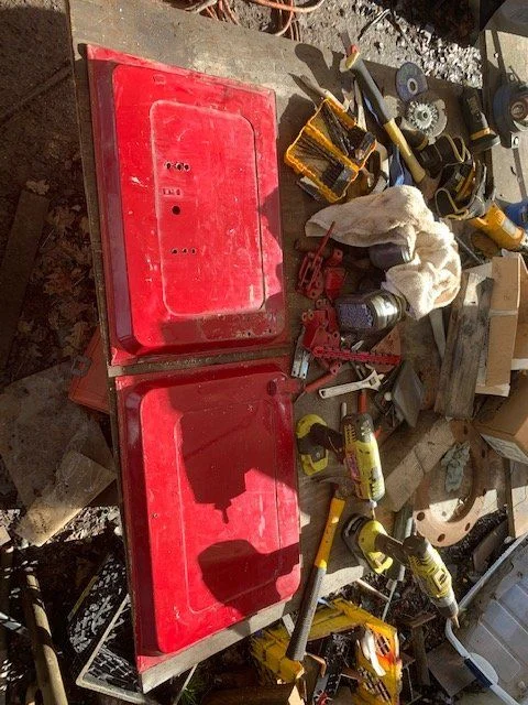

Bumping this thread as I picked up a set of barn doors for this and I am looking for more ideas...
I have been looking at integrating a Tundra center latch system into the tailgate but unsure if it'll look too out of place.
Also, anything in particular to be looking for in a spot weld cutter for these old 40s? New water for me.

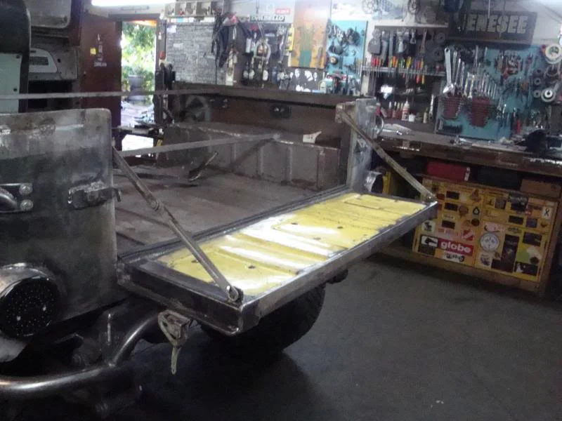

Another example.
