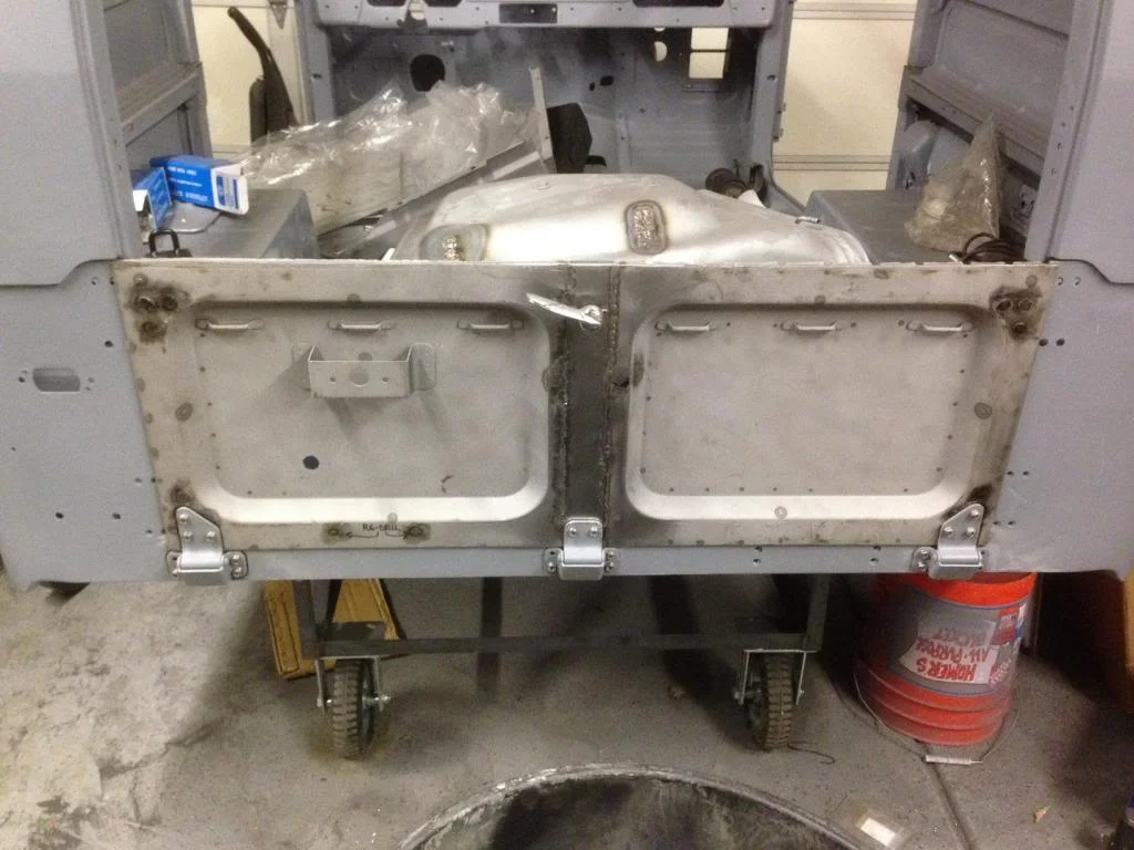

I'm going to try to do a version of this thread (thanks for leading the way) Poor Boy FJ40 tailgate and convert my doors into a tailgate because it would be so much more use to me.

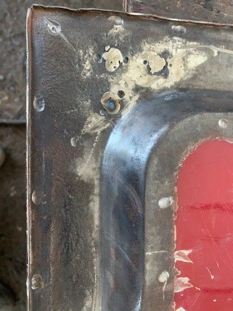

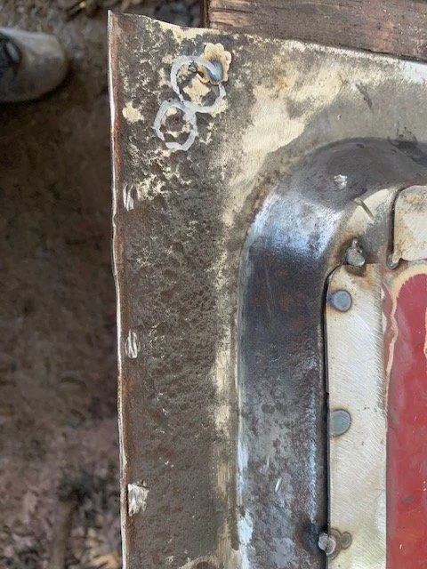

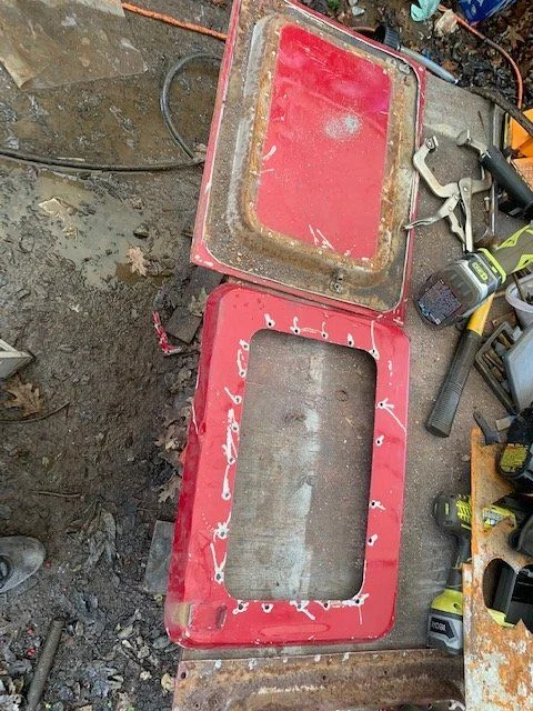

I can say that splitting the back off the main panel is a HUGE pita. The spot welds around the outside edge are really hard to get at cleanly and there are areas where the main section is folded over the back pieces. It's taking a lot of time.
So, I can confirm that the easiest and best way to split the rear does is to use a cut off wheel and cut around the entire thing as close to the same as is practical, drill or grind out the spot welds on the raised portion, and lift it off.
Which exposes the same for easier work. In my case, I'm still going to remove most of the seam and folder over areas as the rust has gotten in there and I need to expose that part so I can get at it with POR 15. Still hours of work to do to get the seams apart, all the attachments removed, and the rust ground down, and the many, many holes welded back up - before I can even start to think about putting it back together into one piece.

What you doing about hinges?
I'm hoping to do like poor boy did in the post I referenced at the beginning of this thread and re-purpose three of the side hinges to the bottom. I haven't tried laying it out yet - but that's the plan.

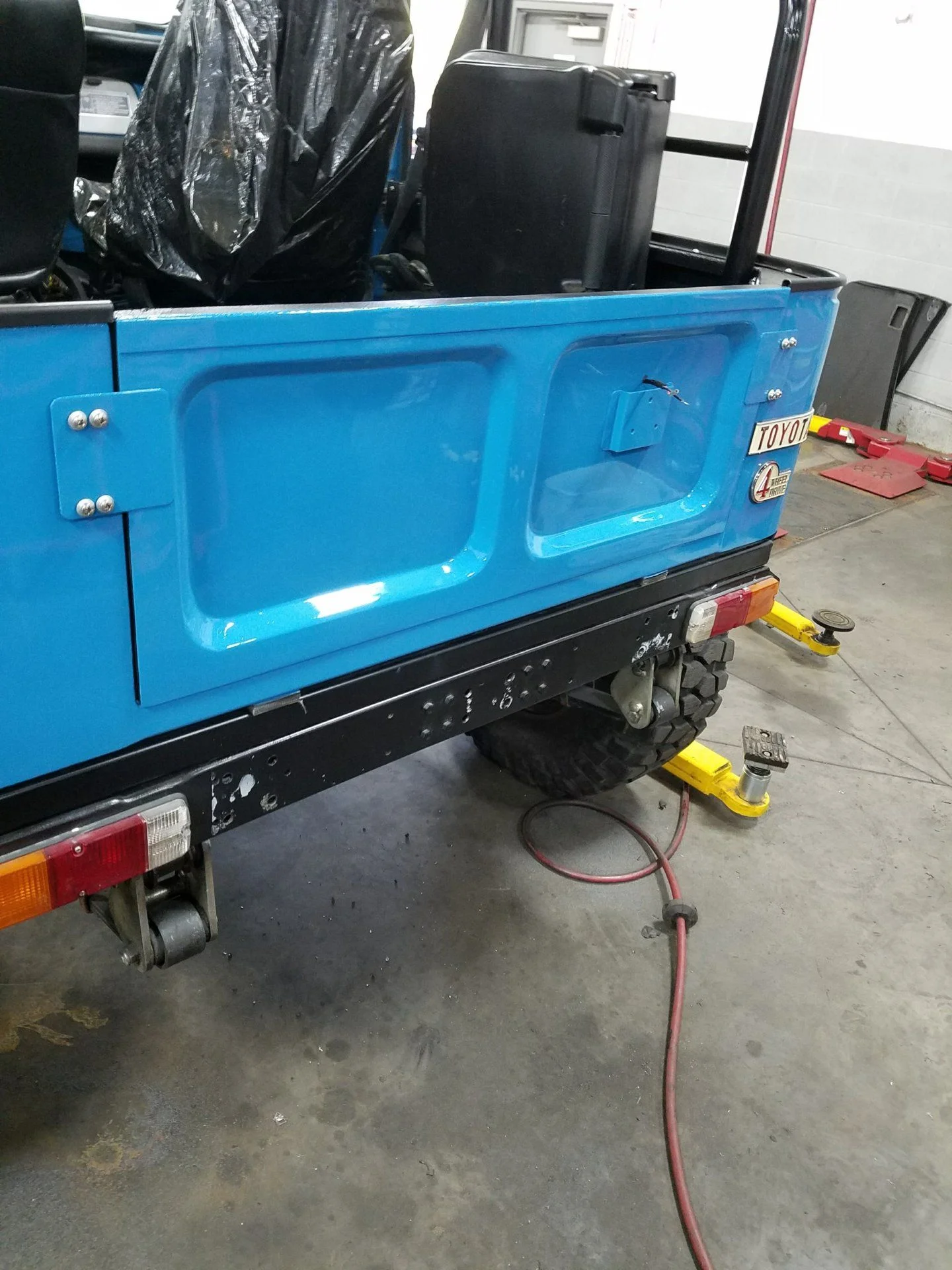

Nope, it works like a champ! Part of me occasionally wishes I had made it ~3" deep so that I could have built in some internal storage... but I really like how it lays flat when the tailgate is down and any thicker and it would annoy me.

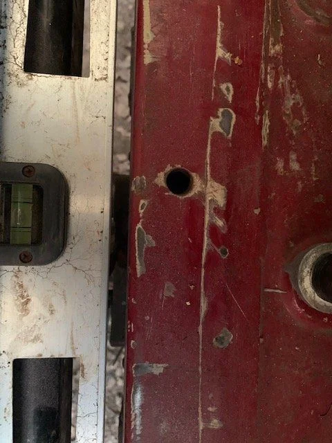

Okay, I was testing fitting the doors as tailgate and looking at locating the hinges. And I realized just how out of true the rear sill is.
The whole tub is coming off in a bit to replace the quarter panels (including the upper lip) and the wheel wells, but I was hoping to keep the rear sill and the pillars on each side. But, maybe the entire thing has to go? Or do I work with it?

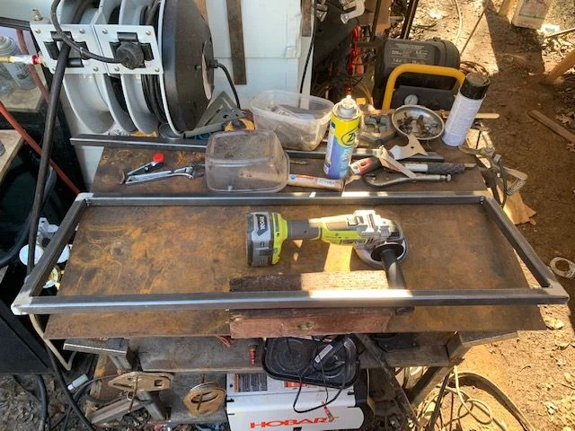

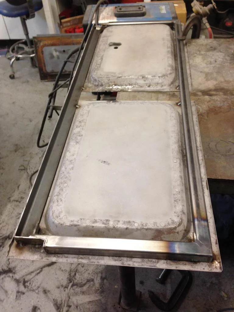

Okay, I made some progress. I got the frame made

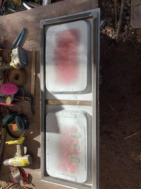

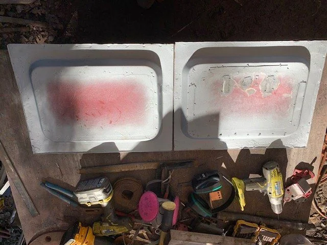

It took forever, but I've got the doors ready. They were really, really beat up. Had I known I never would have used them, but it's been a great teaching experience about body work. I bought a good set of Martin hammers and dollies. As suggested, cleaned and primed with weld through primer.
Got the insert strip cut, it's a little wide, needs a little more trimming.

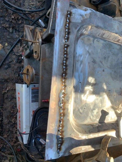

And got the stripped more or less welded to one side, this is my first stitch weld ever. But, I've run our of .030 welding wire and my grinder is dying. So, it's off to Harbor Freight.
