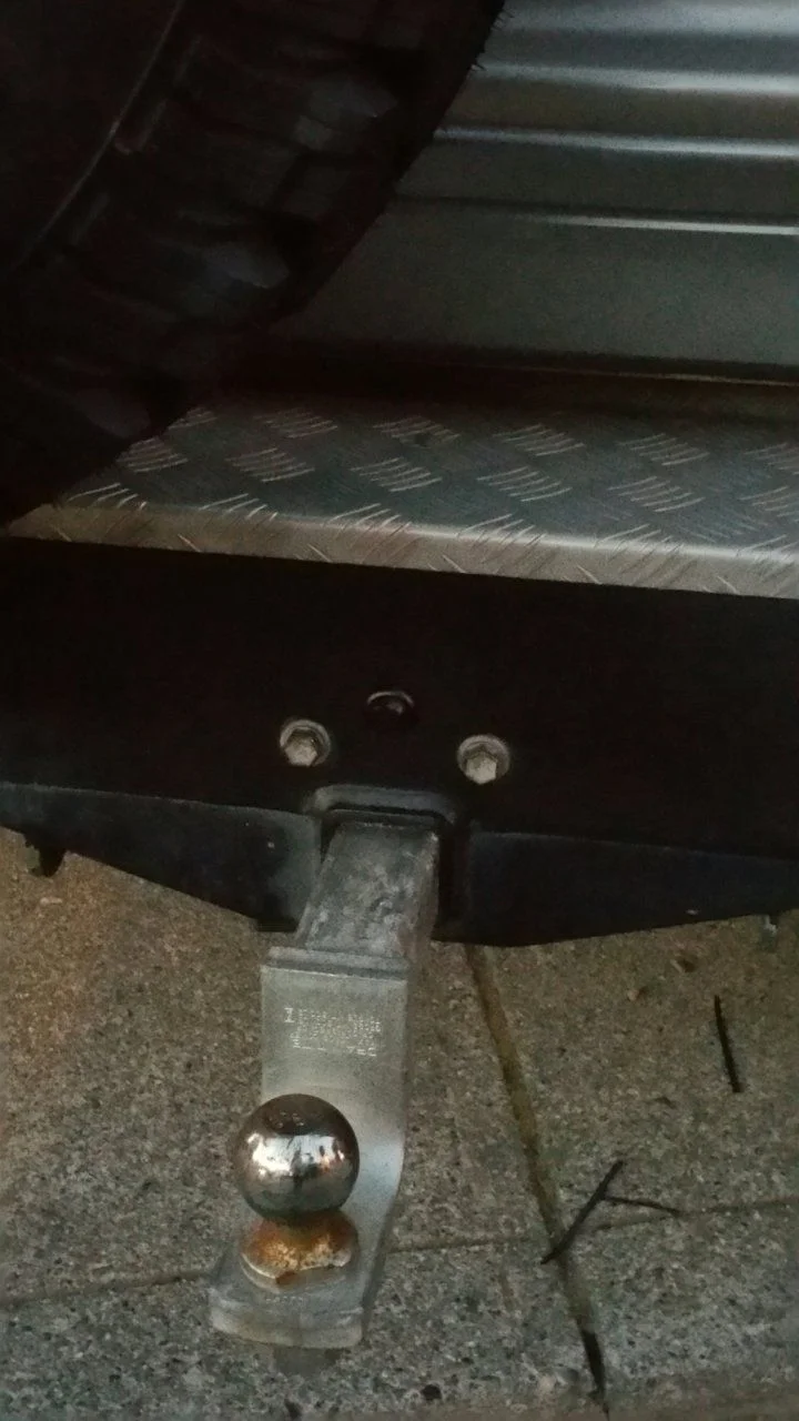

@milemarker60 drilled a hole in the center of his 4x4labs bumper right above hitch and put the camera flush to the surface. Great option if you have swing outs.

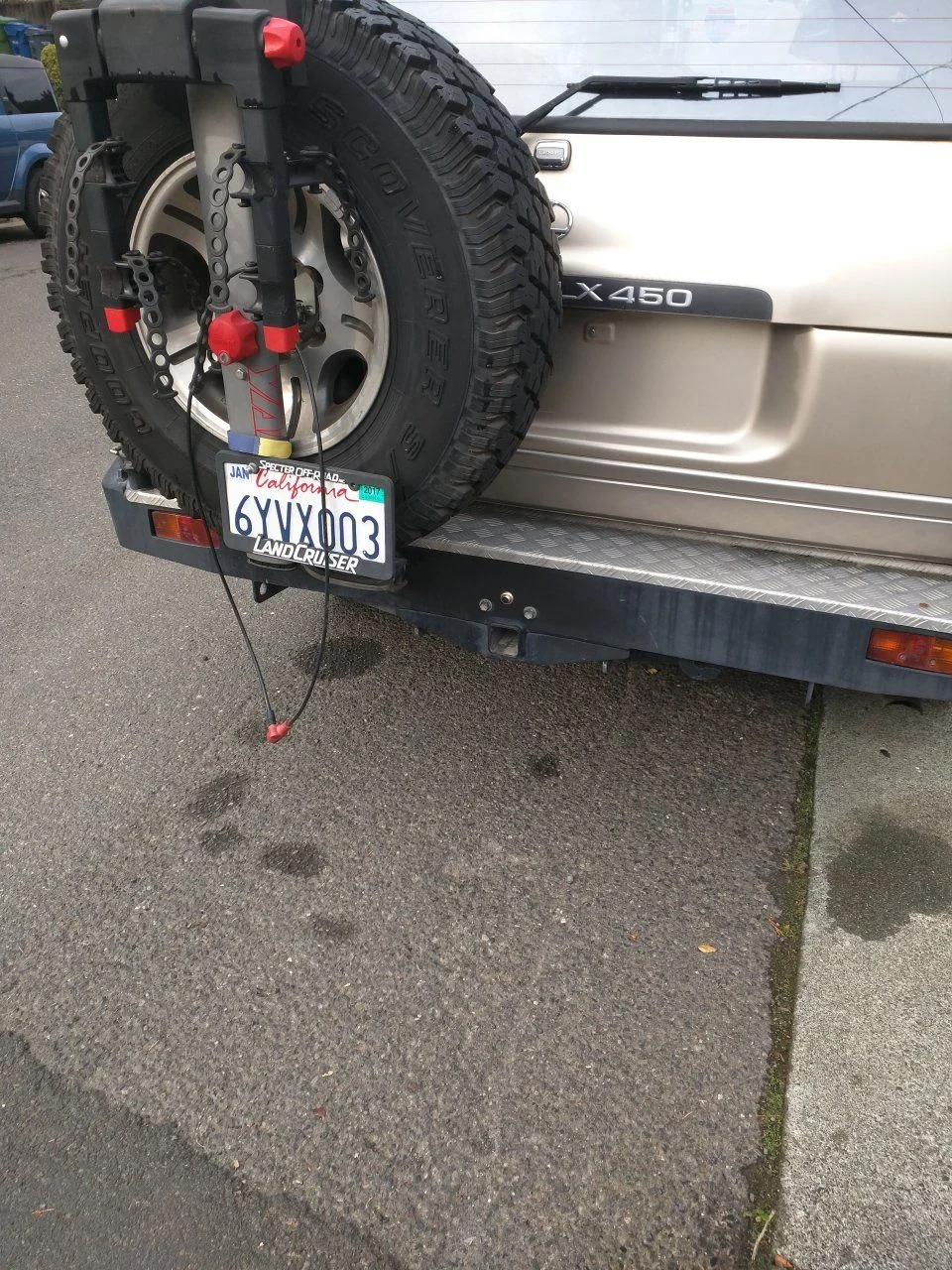

I was actually contemplating this. I'm building my swing-out in the next couple weeks so I may just have to wait & see where it'll be useful after it goes on.
It'll be a single long swing w/spare tire on DS & ladder on PS. I'd probably be fine w/it above the license plate but I guess I'll wait & see. Gives me a chance to route wiring & mount the bluetooth phone mic that came w/it too. Every vehicle I've had for the last 10+ years, except my LX450, had hands-free phone & I miss it big time!
The tire will be in your field of view.

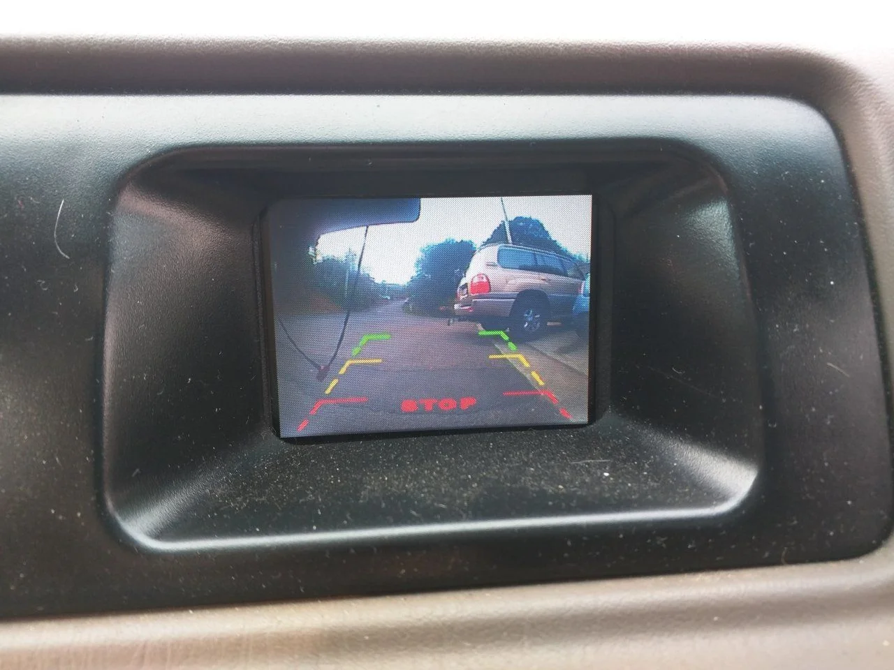

I agree with @NLXTACY . I started with a 4x4 labs bumper, but made custom tire holder, and I tried my best to keep the tire low and to the side, yet not blocking the brake light, and it still blocks my camera. If I move the camera to the side of the OEM license plate area, I might be able to have some vision, but it will still be partially blocked by the tire.

Installed the camera in my 4x4 Labs rear bumper. Used a 1/2" bit and took the front 'cap' off the camera lens. Disregard the color difference. I'd just touched up the black paint from drilling. Fits extremely snug and slightly recessed from flush so it's quite protected. Used gorilla epoxy to hold it in place. Fits nicely I think.
