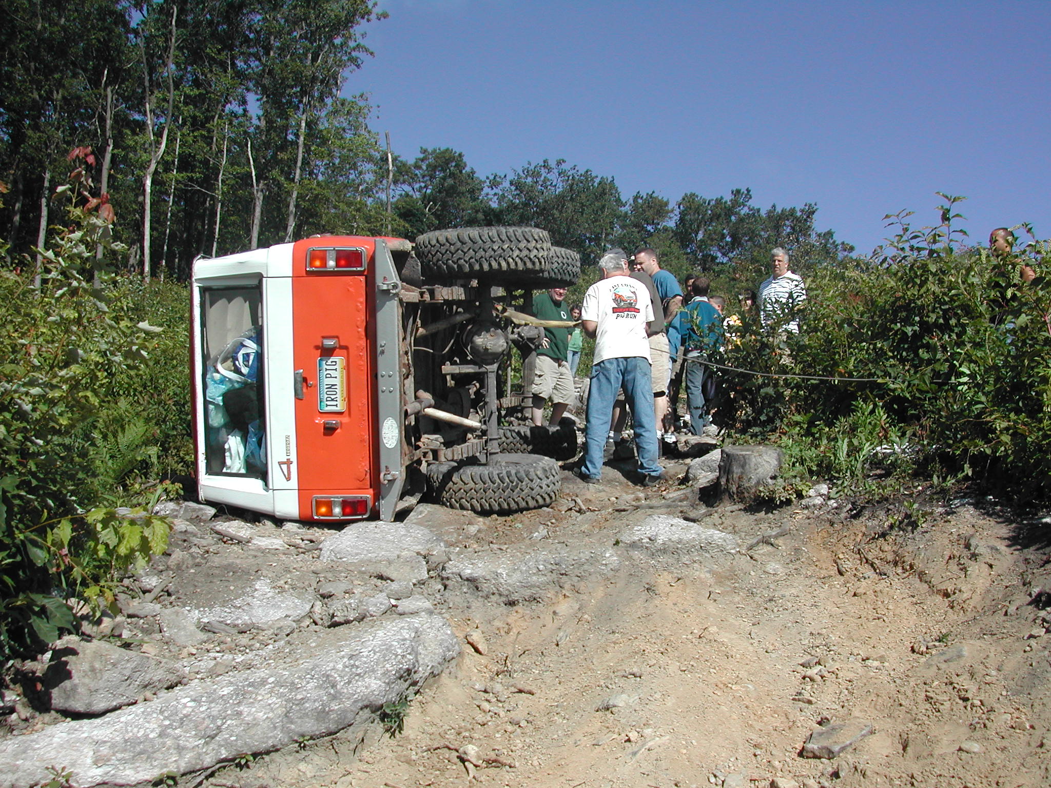

Sleeping. It's sleeping. On its side.
That's the only explanation because it's hard to fathom it rolled up the hill. I cant figure out how it got there from its surroundings.
Frankly I'd driven up that trail numerous times and never felt tippy at all. There was another stump that doesn't show in the picture- situated so that both passenger tires were on top of them at the same time. I thought I'd just walk right over them (having a doubler and all that good stuff) and voila, she just laid right over on the driver side. I couldn't believe it. i'd been in worse leaning situations many times before without incident don't know why the old girl laid over when she did. Good news is that when we flopped her back on her tires she started right up and I drove her up the hill to the top to assess the damages. One other thing you don't see is that both the hood/front fender and roofline are also laying on stumps they did some damage. I was able to continue wheeling that day and drove the old girl home with no cargo window on the driver side. It was fun and interesting but did eventually lead me to get into a 40 with a full cage welded throiugh to the frame rails. Gary S
