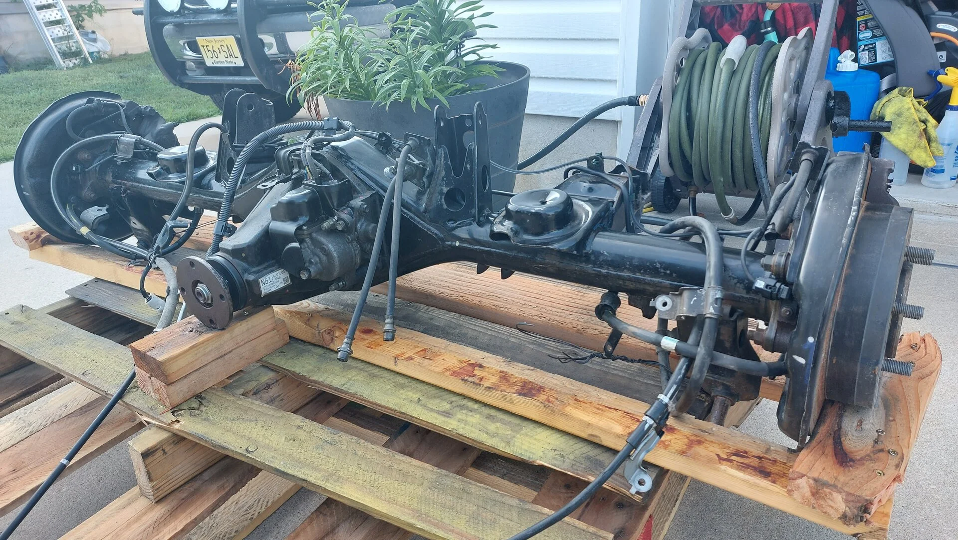

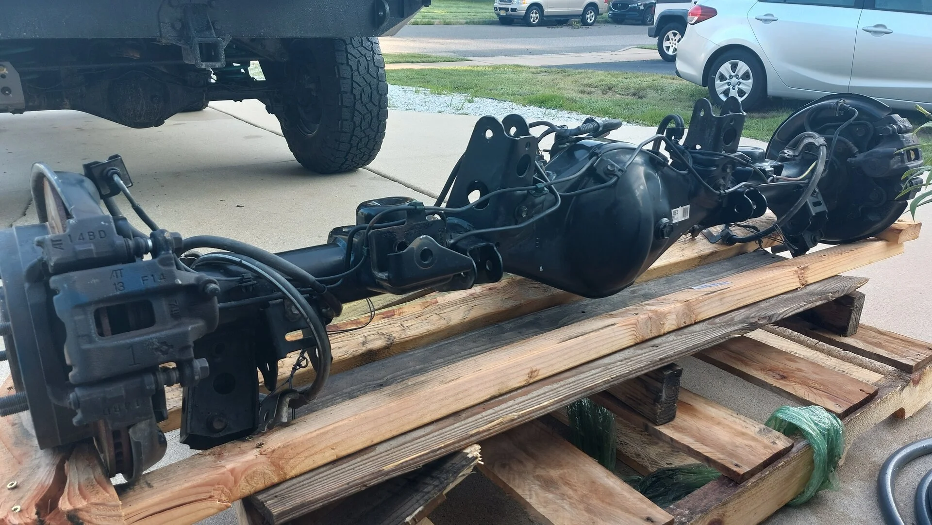

Factory locked 8.2 came in yesterday. This thing is cleaner than 2023 axles driving around NJ despite it being nearly 10 years old. For $2.2k-500ish (or whatever the old 8" 3rd can sell for), I am super satisfied. Planning to swap it all over this weekend.

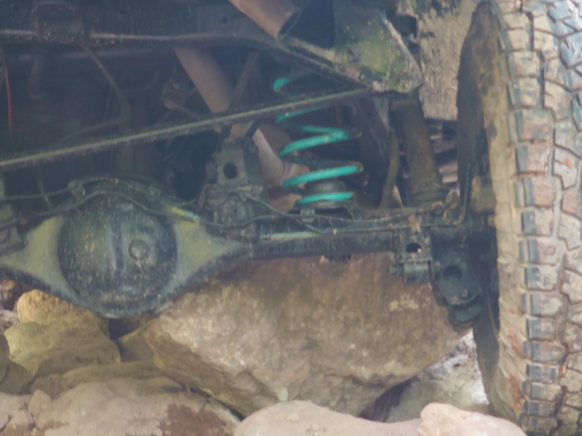

Bonus pic of the abuse my trusty 8" had to endure last weekend. It never failed, but I think it earned its retirement lol.

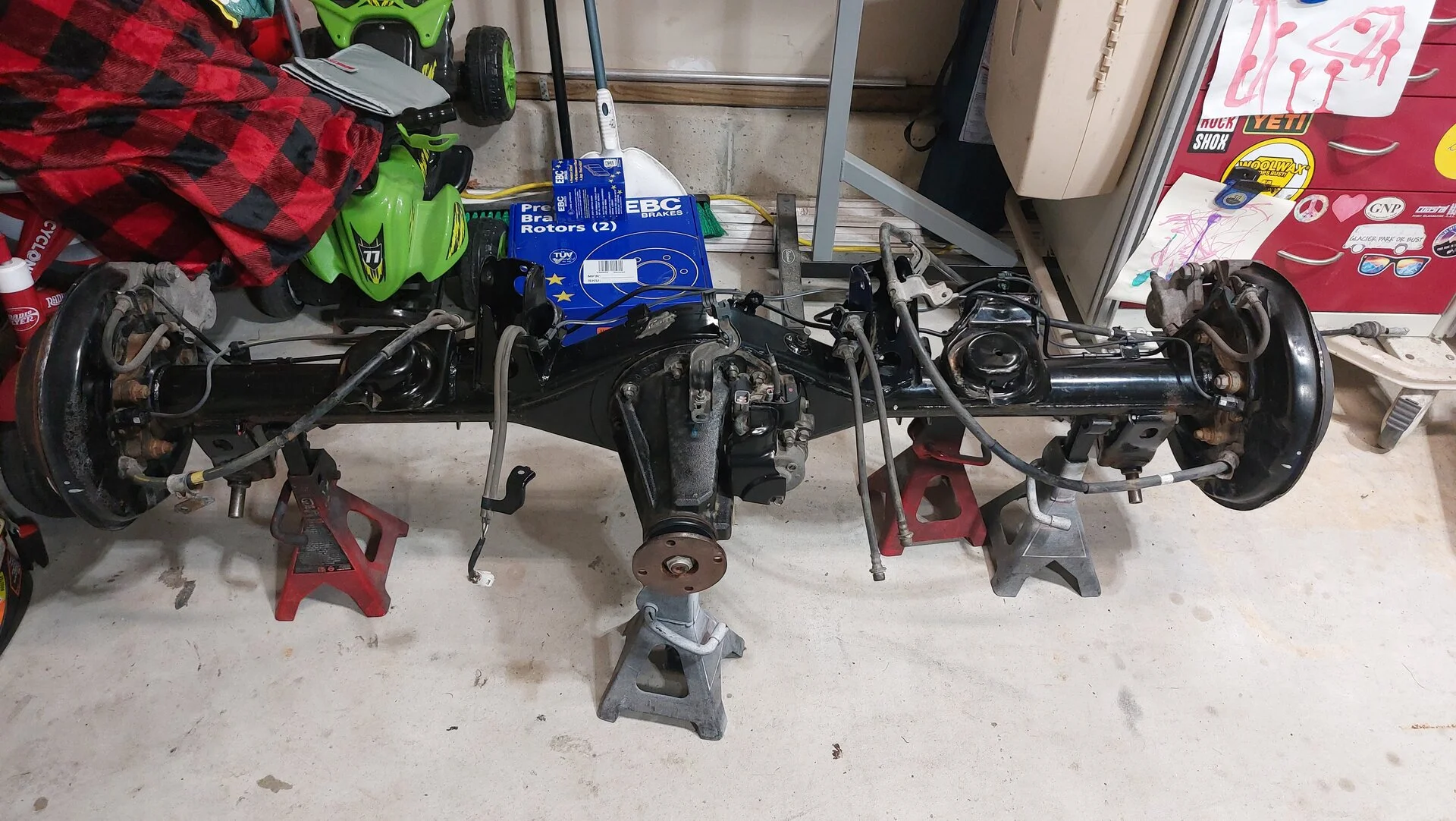

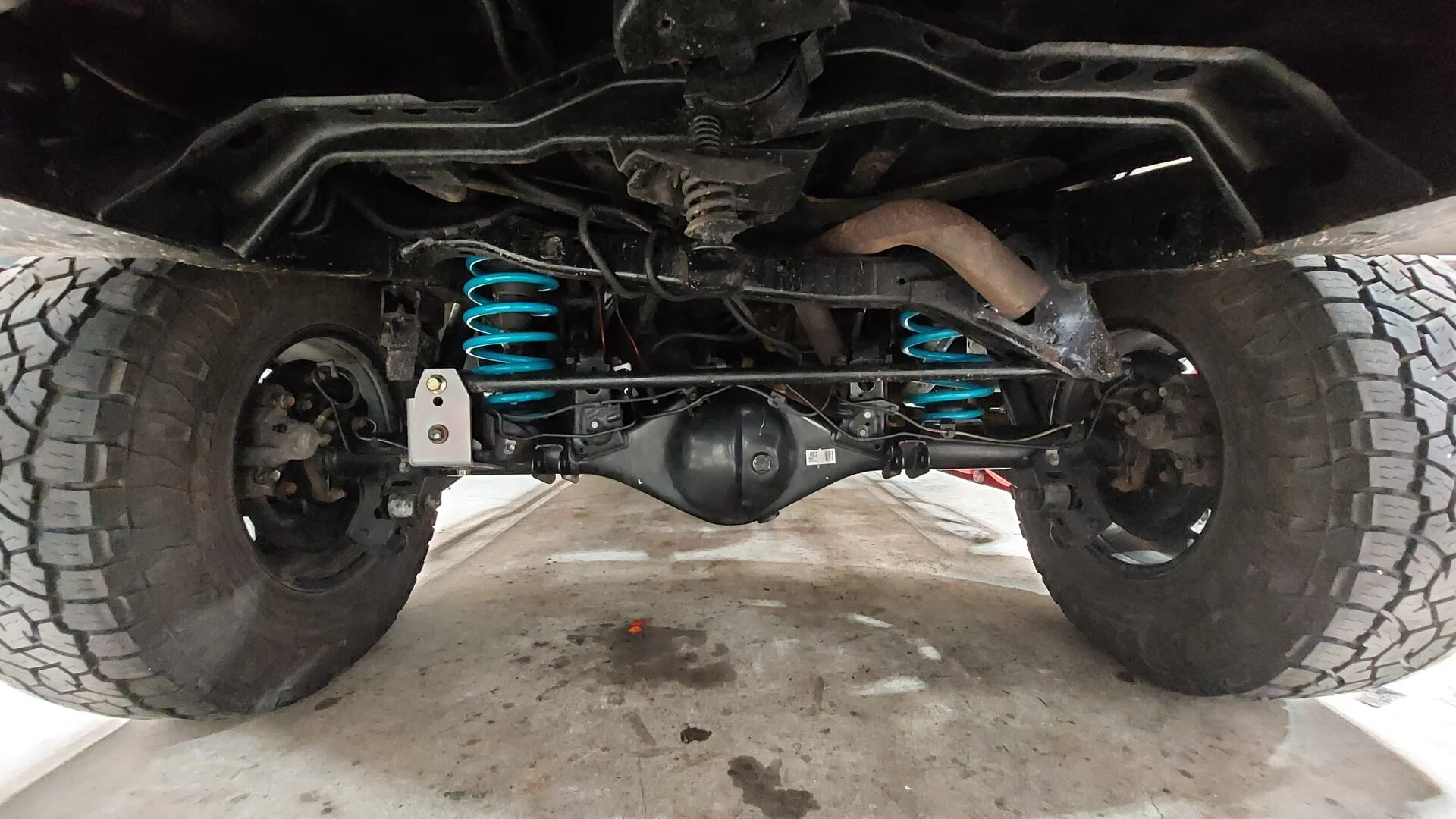

Got the new to me axle in. The old one was WAY crustier than I thought. Luckily no bolts broke or rounded off. It looks brand new under there now.
That looks great!!

Has the KDSS mounts and all!
