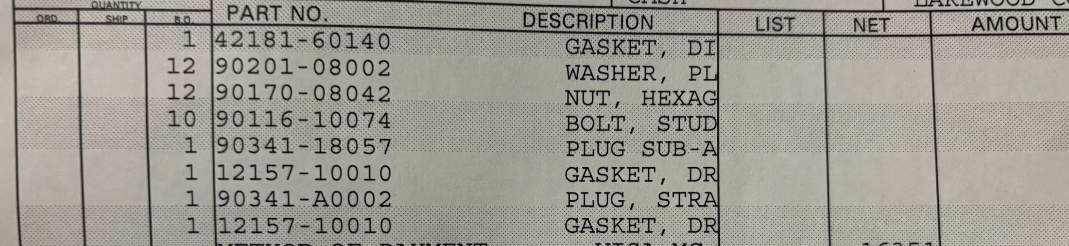

I still need to sort the sway bar out. I also found out the housing assembly doesnt come with the studs and nuts to mount the third member or the drain and fill plugs. I got the part numbers from toyota for them
Ah, I had forgot about the studs and nuts. I'll check the thread (betting they are M10 or M12) get some of them as well. I'll re-use the plug of my 8" on the 8.2.
For the studs i believe theres two that are longer than the rest
I checked the housing and they are indeed threaded for M10x1.25 studs (as opposed to the M8x1.25 8" housing).
I picked up one of these kits in lieu of the studs, mainly due to living in the sticks and a good distance from a Toyota dealer, I tried to assemble a kit myself, but M10x1.25 hardware is pretty darn tough to find.
