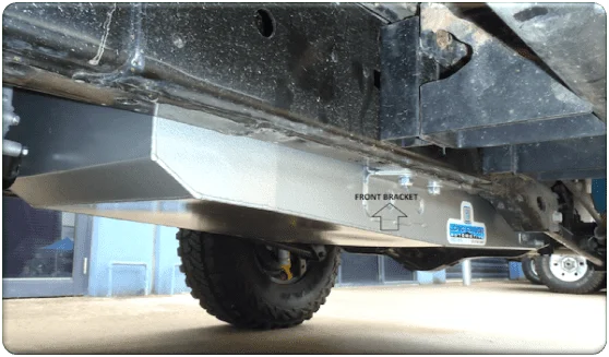

I forgot to mention that LRA has both auxiliary and replacement main tanks for US-spec FJ Cruisers. We have shipped/installed these kits and they work. We are also stocking them on the shelf in our warehouse.
Our marketing pieces are attached, but here is a photo of the 30 gallon LRA replacement main tank in the FJ Cruiser. Not sure if/how we can upsize the 200s and other Series, but will do what we can. As you can see, the FJC replacement does extend below the frame rails, but all that fuel has to go somewhere......
As with many issues on these rigs, design and operation involve a series of trade-offs....range vs. clearance, safety vs. cost, convenience vs. cost, etc.

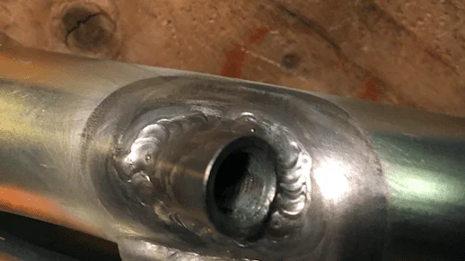

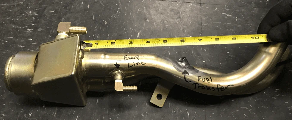

Georg and Dom have been hard at work fine tuning the install kit on Cole's aux tank.
TIG welded fitting on filler neck to accommodate US emission system. Other than tank configuration to clear the canister, most of the issues we are dealing with are relatively minor, but they add up. Time consuming and expensive if you are trying to install an Australian tank / kit in a US spec vehicle.
Dominic Descent is an awesome tech, lucky to have his mad skills focused on this project.

It's interesting to see the degree of differences between the same model car in different markets. Probably no other market shares the emission systems necessary on USDM vehicles. From a simple container, to a complicated system to keep everything happy, just to store extra gas. Keep up the good work!
