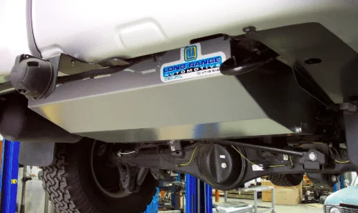

We are bringing in some Long Range Automotive tanks for stock, looking to gauge interest in tank size for the 200s. Will require relocation of charcoal canister. These are complete kits - using second fill point. Tech notes/install details on the LRA site below.
_______________________________________________________
EDIT/UPDATE 3-4-18
We have successfully developed a family of auxiliary tanks for US spec 200 Series with 40, 24 and 13 gallon capacities. The smallest accommodates the spare in the original location, the other two require relocation to another location.
The US kits work with OEM emission systems and do not throw codes or create issues with smog testing. We are taking orders for the tanks via this link Request a Quote - and welcome questions, comments, complaints, etc. via info@cruiserbrothers.com or call my desk number 209-636-0831.
Have a read, watch the video and thanks for your interest.
Ward Harris (and Georg Esterer)
16 gallon installed
45 gallon installed

I would follow back with them. Without the restrictor these would be illegal in the US. Long Ranger adds a restrictor when they ship to the US
Good point

I have a little concern for the LX's. From what I gather (not confirmed) about the evap relocations, the likely position is where the AHC pump and reservoir mechanism is.
I'm also less concerned that it is fully state legal. I want it to work with the evap system and be legit, but believe that current laws and red tape won't formally support a legal aux tank. I would be happy to be proven wrong.

Thanks, John. Ya, 40 gallons on the back of the truck is a fair bit of added weight.
Yes, like many things in life, the cost of the tank/kit is just the beginning. The LRA folks have been selling into the US market for many years and they are comfortable with the basic install time estimate of 5 hours, plus what is needed to deal with charcoal cannister.
Yes, we plan to confirm effort, time and expense to complete the US installs.
Not so sure about "49 state legal" as there are multiple, overlaying regulatory interests/agencies. We are going slow, working with selected Beta install customers and installing shops we know and trust.
My partner Georg (@orangefj45 at Valley Hybrids) has a 25 year reputation in the Land Cruiser community and will not tolerate half assed products or installs, so the standard is pretty high.
Will keep you all posted. :)

Any suggestions on dealing with gas vapor? I think the stock one gets overwhelmed already the 24 gallon tank.
I am interested on the 16 gallon one and very curious how to move the stock charcoal canister.
I had 170l one in my 1999 100 Series and it killed the stock charcoal canister. I hope you guys can find a solution. It would be great to have extra fuel on board.
We are not going to screw around with selling tanks unless we can also help resolve the related issues consistently across different tank models and Series. As noted above, @orangefj45 is the brains of this crew and if we cannot "get it right" he won't have anything to dow with it.
There are four basic issues, when dealing with modern rigs - 200, FJC, GX, 4Runner, Tacoma, etc.:
  1. Fitment
  2. Filler, transfer/valving, canister/filters and pumps/gauges
  3. Proper operation of system with ECU, emissions, etc. to reduce and resolve error codes
  4. Safety and compliance
