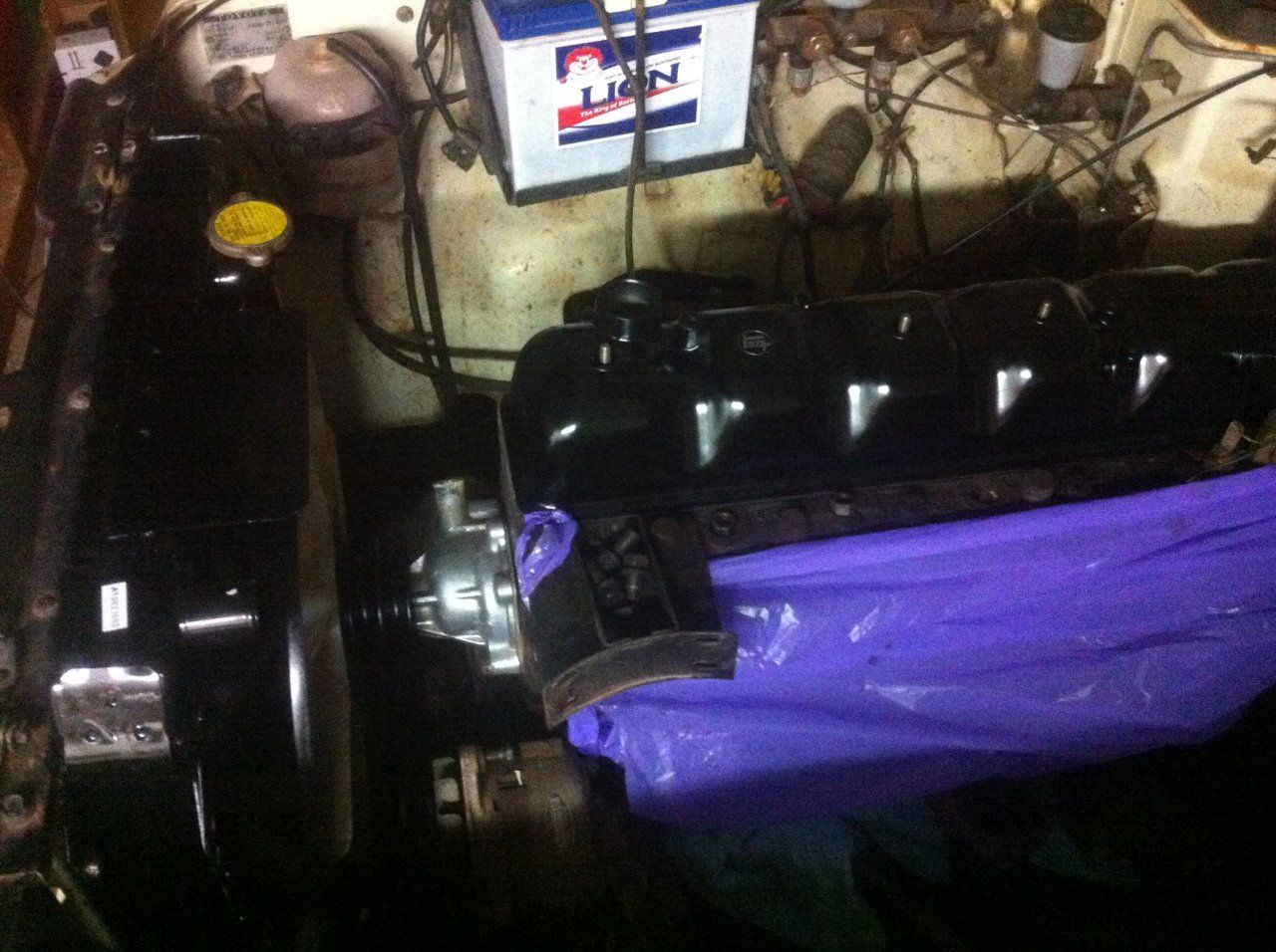

Got the water pump, freshly painted pulley and new plastic fan mounted the other day. Painted the shroud last night and got it and the new radiator bolted in today. Onto the rocker cover and power steering pump bracket at the moment. Being cheap and using the 8 cans of satin black rustoleum I already have for all my painting.

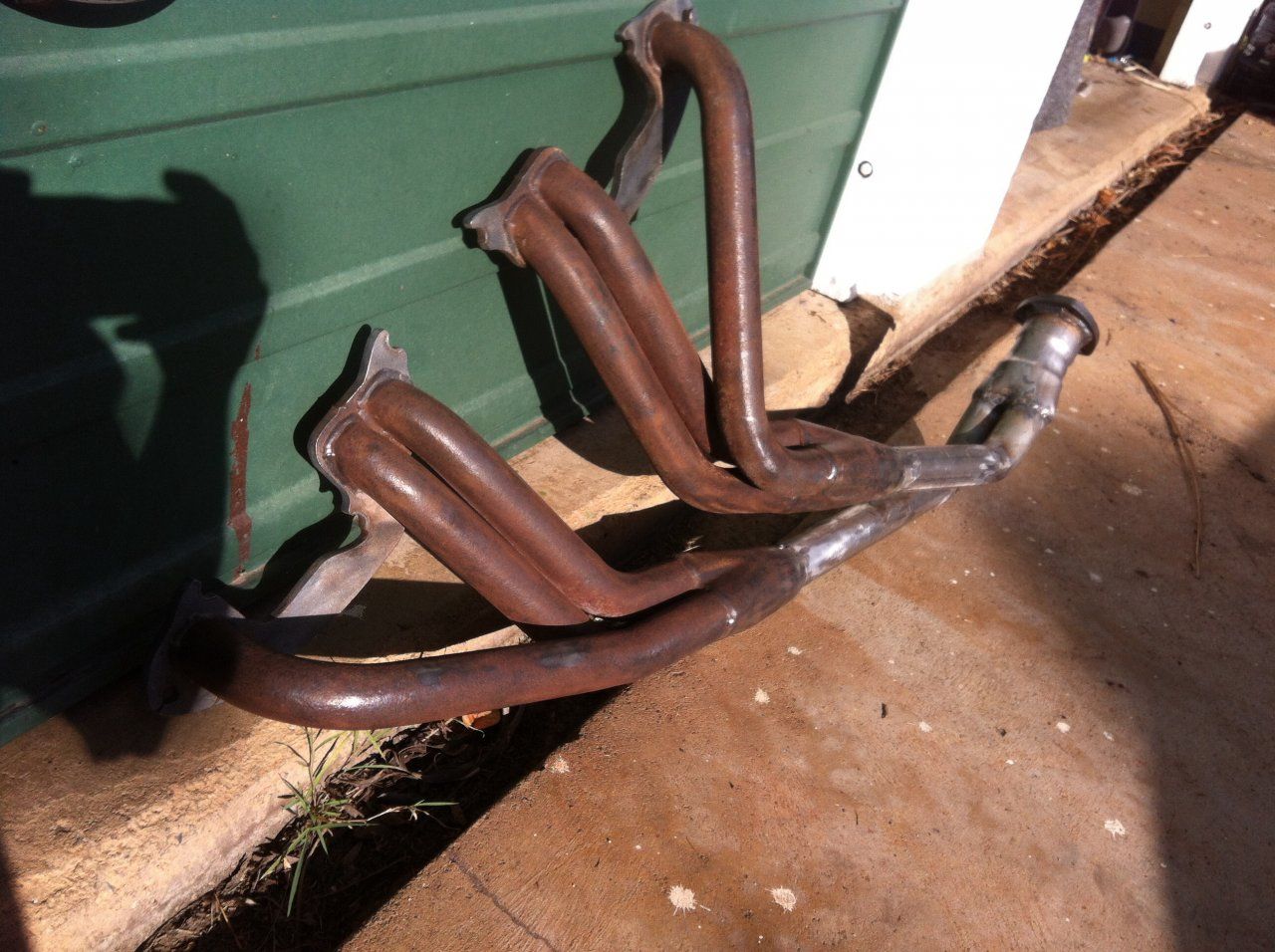

Started on my exhaust this afternoon, cut off the junk and welded on fresh pipes and a collector. Going a 2.5" pipe with a single muffler.
Had a few minutes after work today, did some more work on the headers. Not 100% happy yet, I don't like the angle of the pipe from the front bank. Thinking of cutting the elbow back a few more degrees.

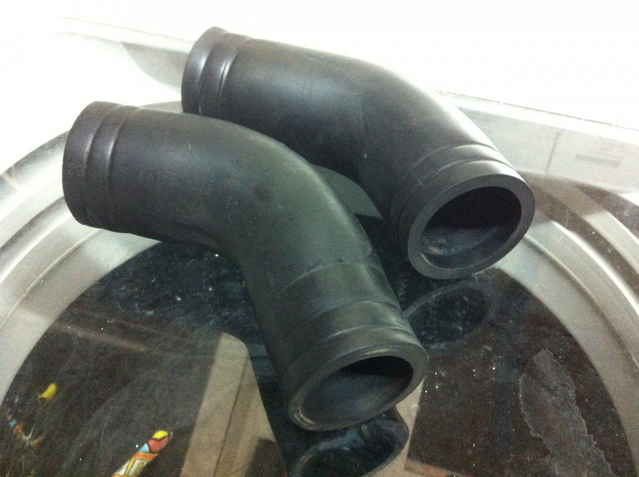

Got the headers all finished off and bolted in with a new gasket, carb is back on, just awaiting new vacuum lines now. Turns out the 1 3/4" exhaust pipe I bought for the headers is also the same size as the join between the lower radiator hoses! So I just have to grab some 5/8 tube to tee into it for the heater hose and I will be able to close up the cooling system. Not long now and I will have this thing running again, then it's on to the body work!
I'm thinking, he had his Wife clean them. :)
She is more than willing to drive but she draws the line at doing actual work!

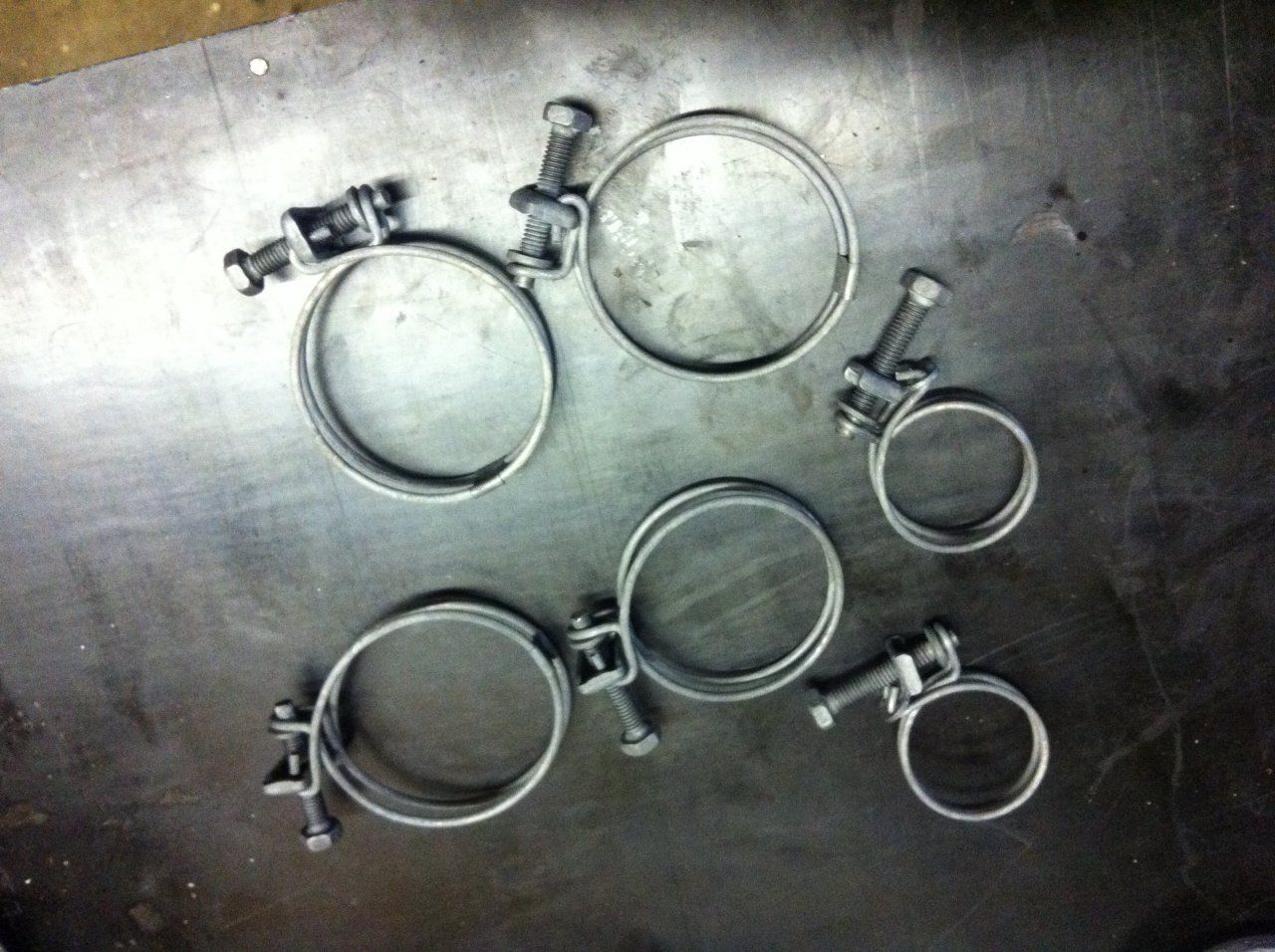

I just bathed them in phosphoric acid for a few hours and hit them inside and out with a plastic scouring pad. Came up like new. The phosphoric also does this to the hose clamps:

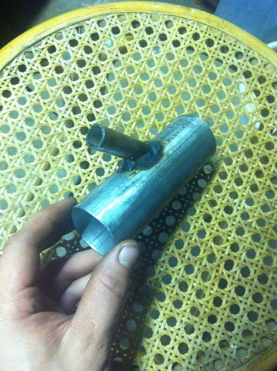

Got half an hour tonight after work and produced this. Gonna run a bead around the ends of the pipes to give the hoses something to grip to, then it will get a coat or 2 of por15 to stop it from rusting.
