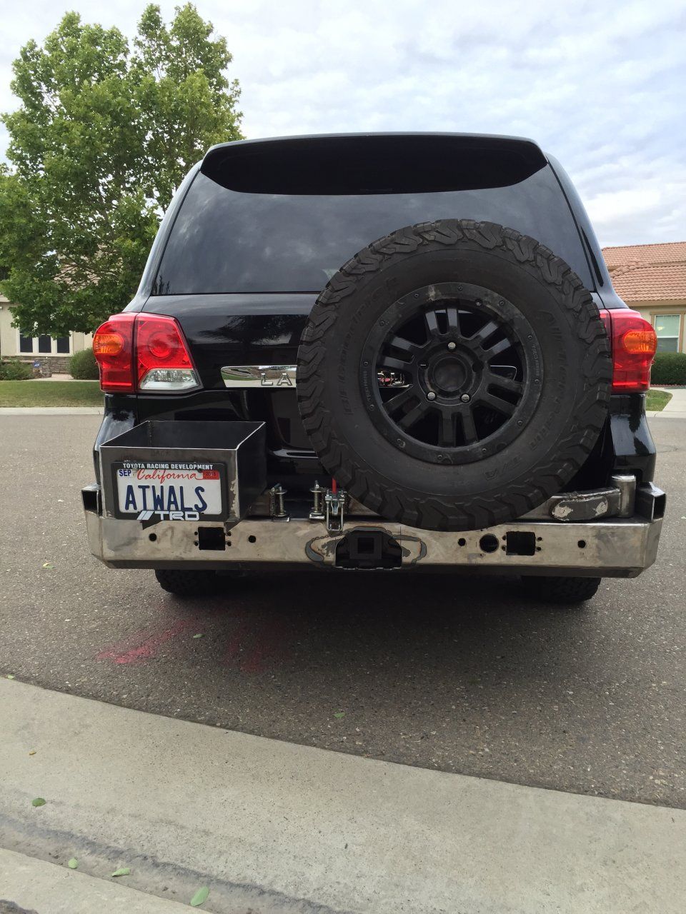

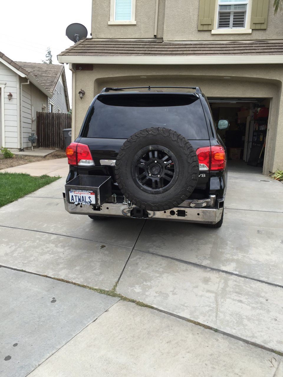

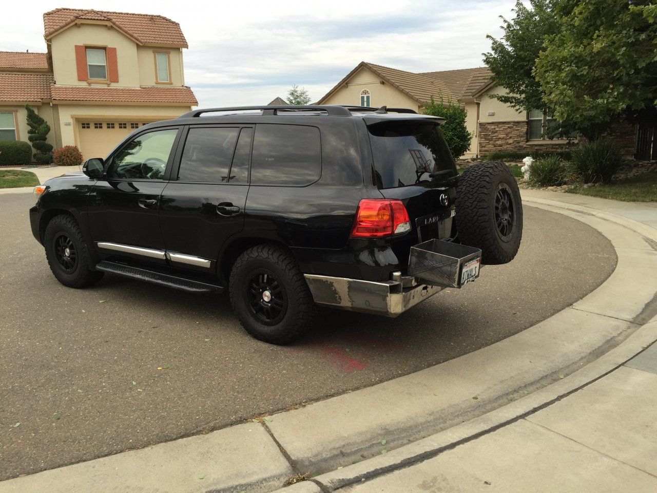

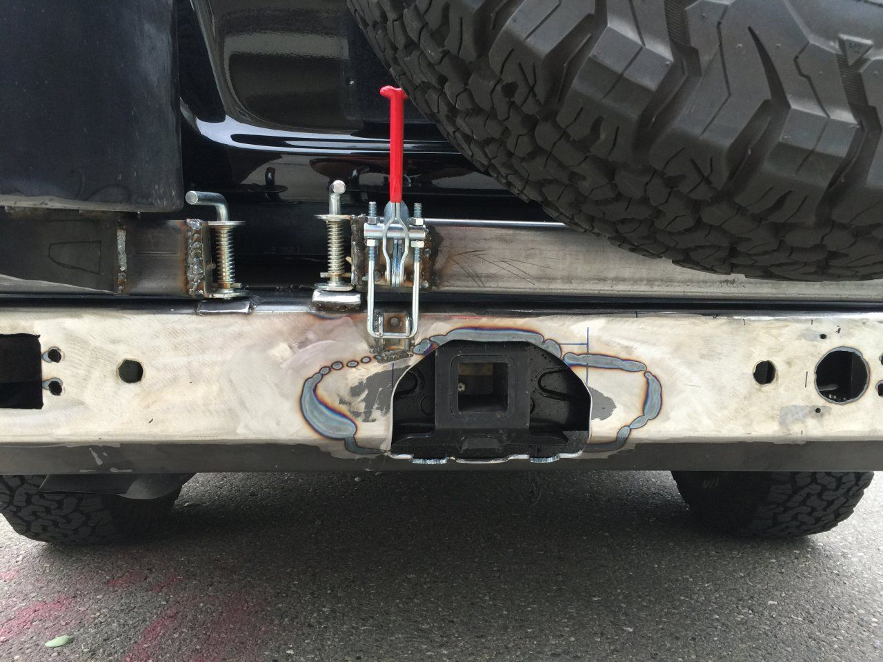

Few more pics of today's work. Got spring latches done. Tested RW spare on swing arm. Tapped license plate to jerry can holder. License plate light pending. Mud flap mounting plates are done. Need to finish swing arm bumper stops. Enjoy pics.
Slanted tire carrier and dual jerry cans. Nicely done.

This my first time building a bumper. I have built skid plates and rock sliders in past on my Tundra and Land Cruiser. I have gained experience doing my projects and learned watching lots of YouTube videos. I got Lincoln 180HD and Miller 625xtreme plasma cutter running at 220v. I wired 220v plug from panel watching a YouTube clip. Lots mechanic tools that I collected from past 15 years. Also, have shop press to bend plates. I have build bending dies using angle iron. Recently acquire swag off road bending die as well. I do this as a hobby only.

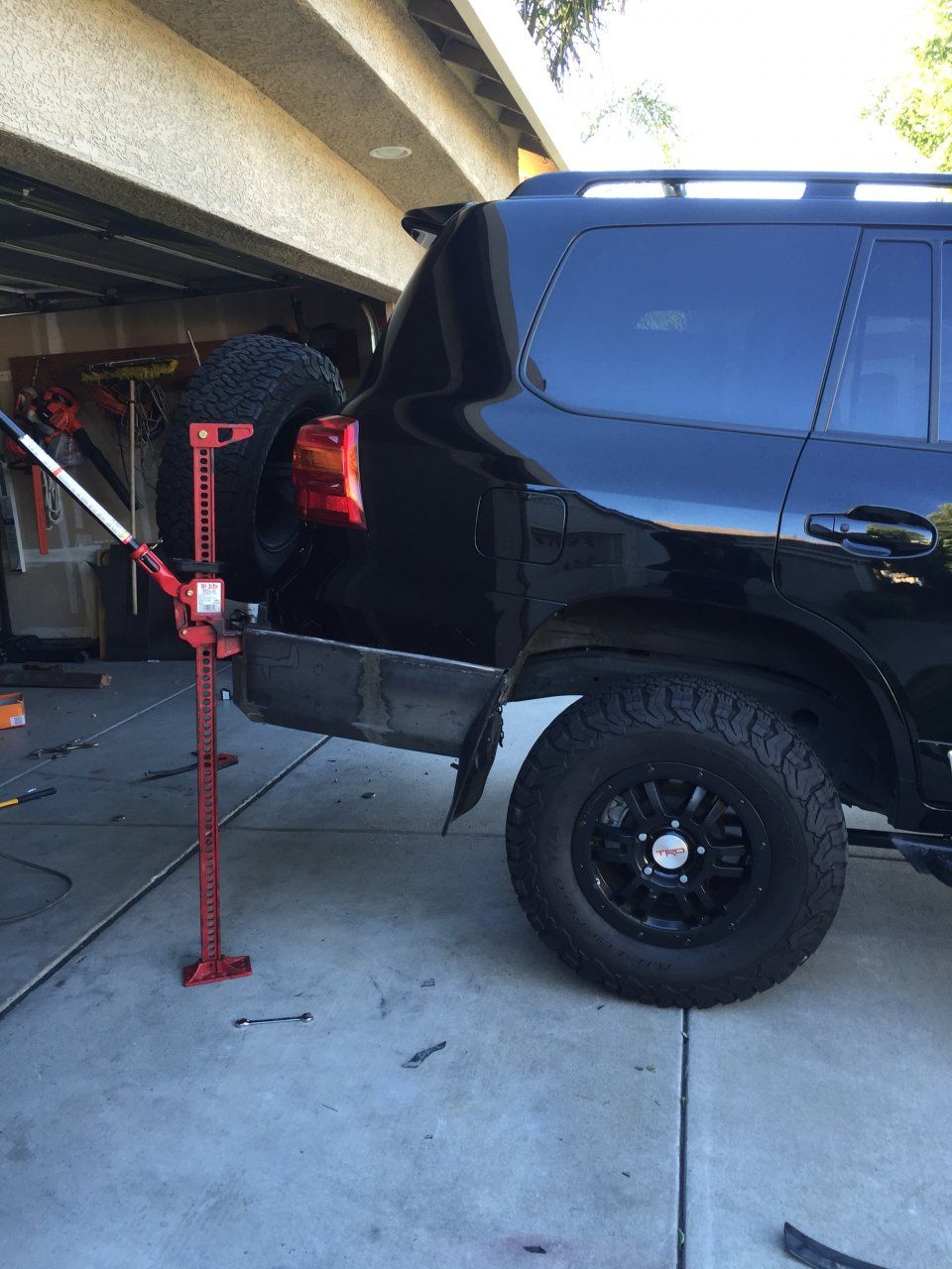

Hi-lift jack in action. However, jack itself will be mounted in front bumper (future build) There is lot of travel in rear axle.

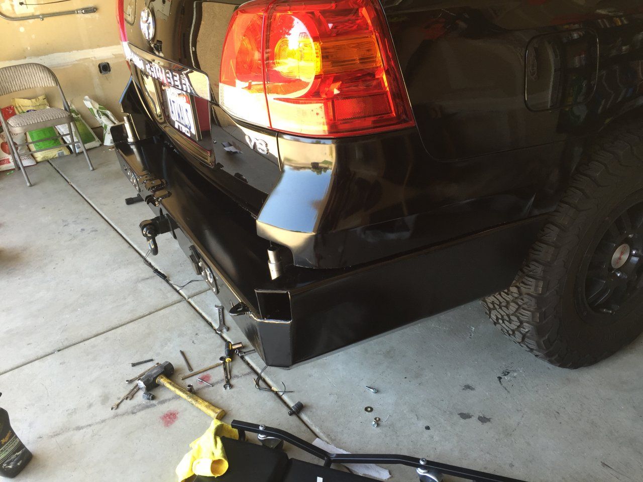

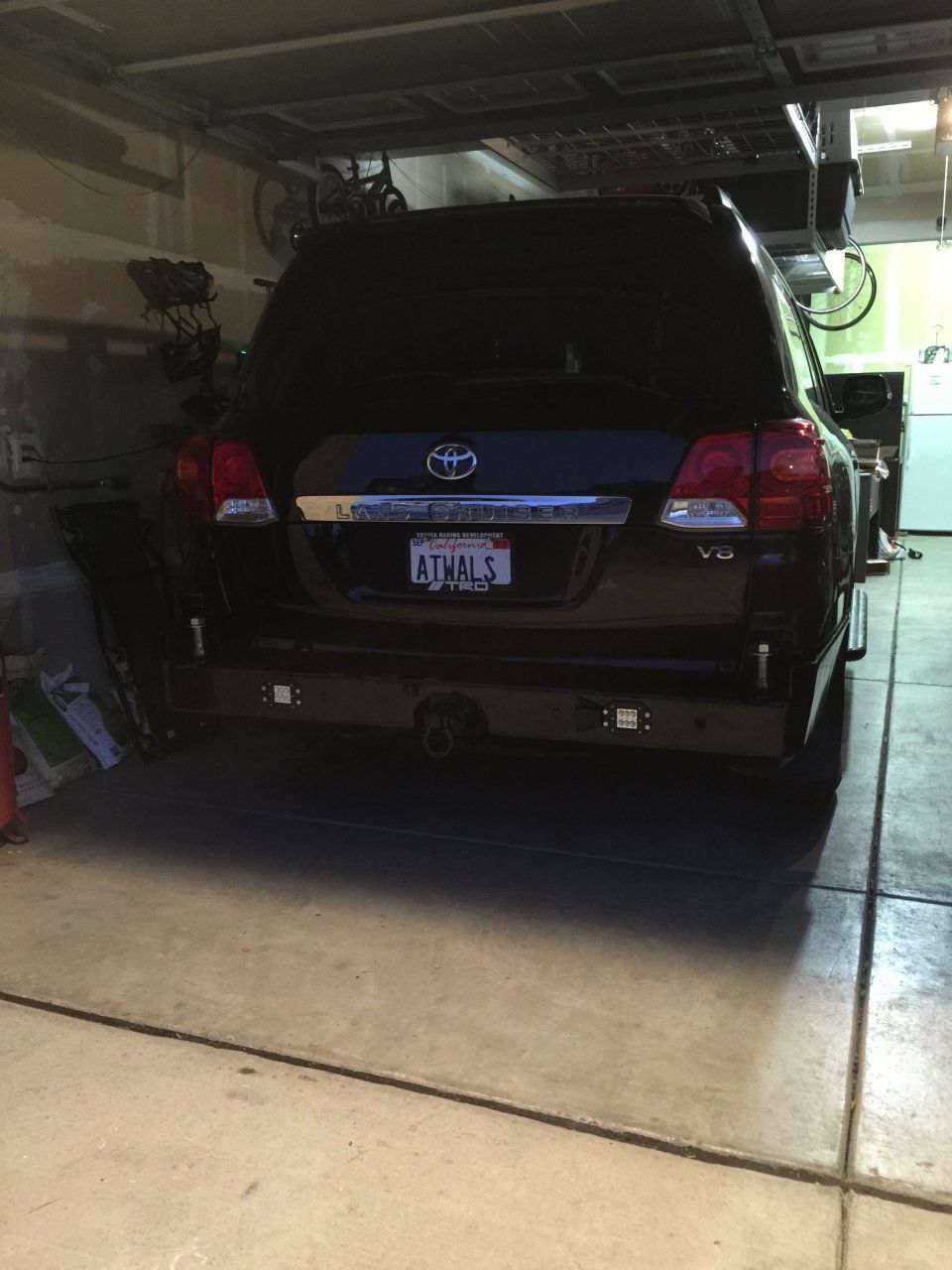

Updated post #1. And finished installing rear bumper. Hooked up led lights to backup lights. Also, installed license plate light quick connector when license plate is moved to jerry can box. I will do body filler work on bumper after Ouray trip as I can see grinder marks at few locations under certain light conditions. Otherwise it turned out good in my eyes.
Looks like some serious protection for your rear end!

Are you going to run the wheel/jerry can carrier full time or just put it on when needed
I will install swing arms on as needed basis. Otherwise, spare tire will be under the rig.

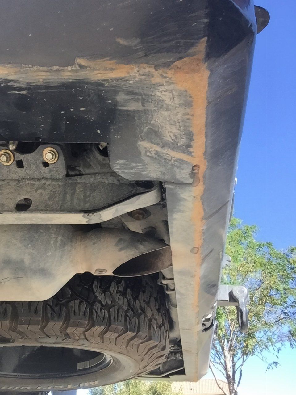

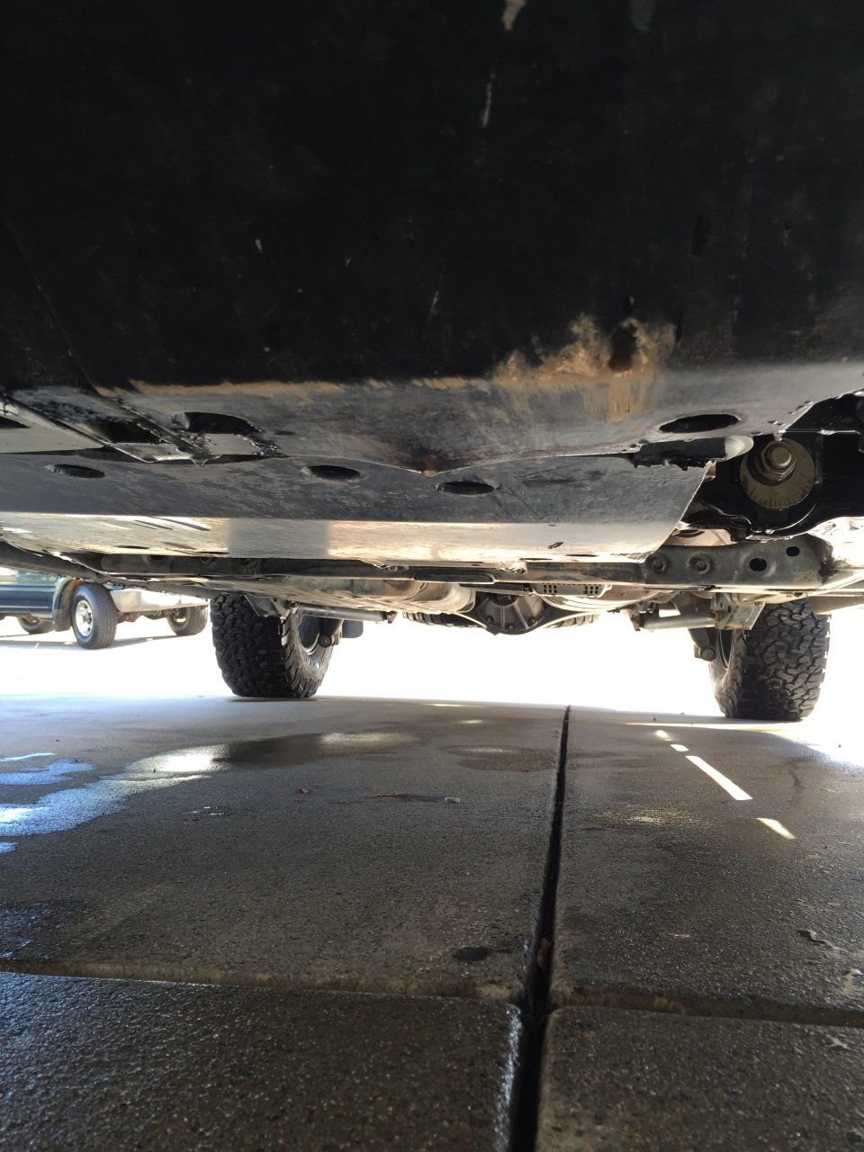

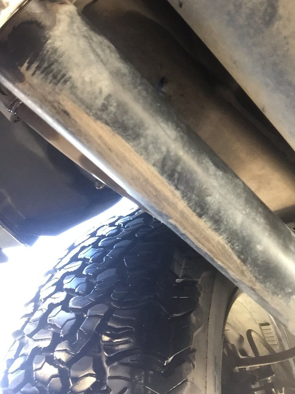

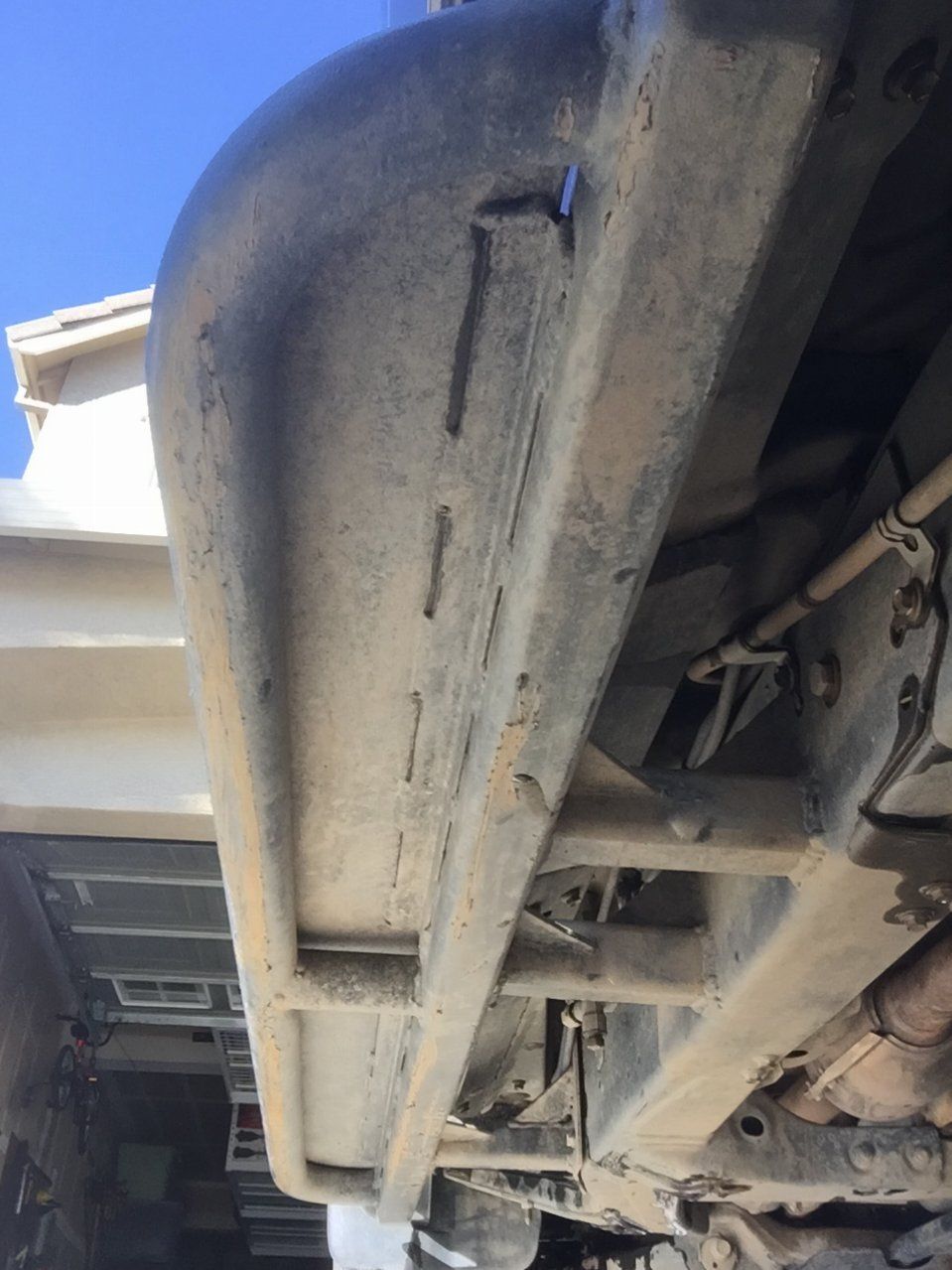

Pics of armor performance after Ouray/Moab trip. I am going delete front tow point and design an alternative. Bumper, sliders MT rear arms and skids plates did their job well to protect rig.

Yes, heavier springs are must after steel bumper install. I am gonna do them in few months.
