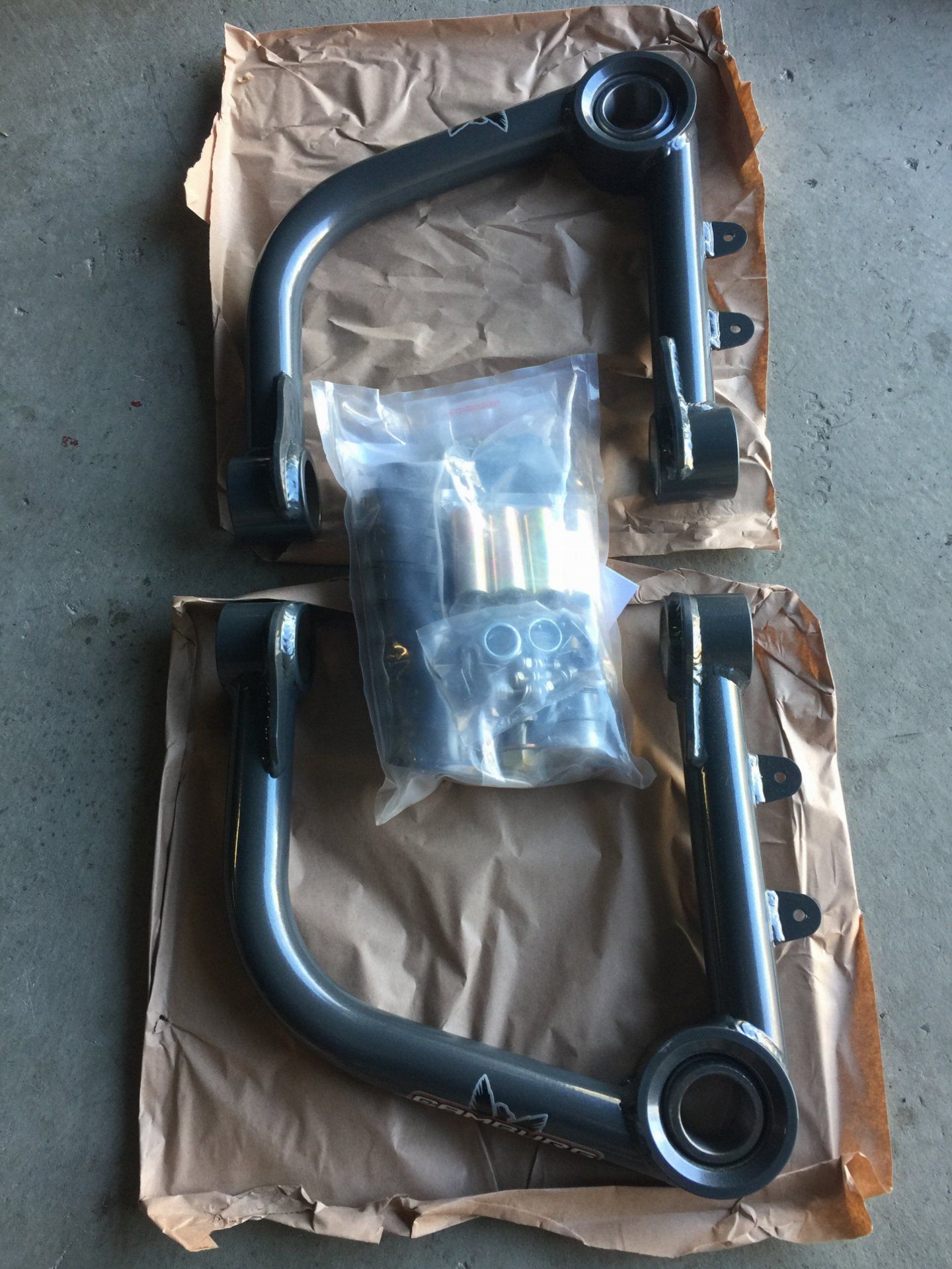

I received Camburg control arms.
Camburg is good stuff!!
