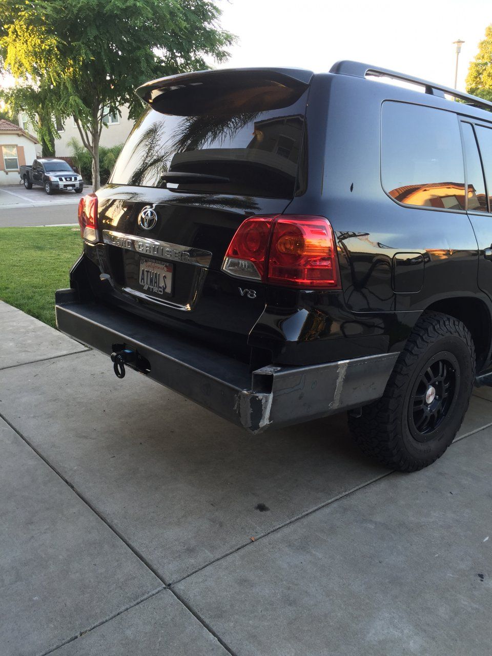

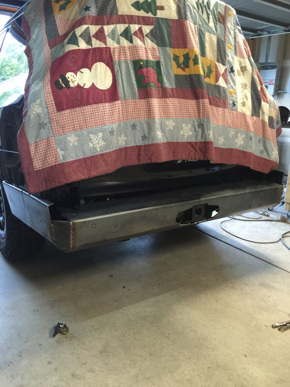

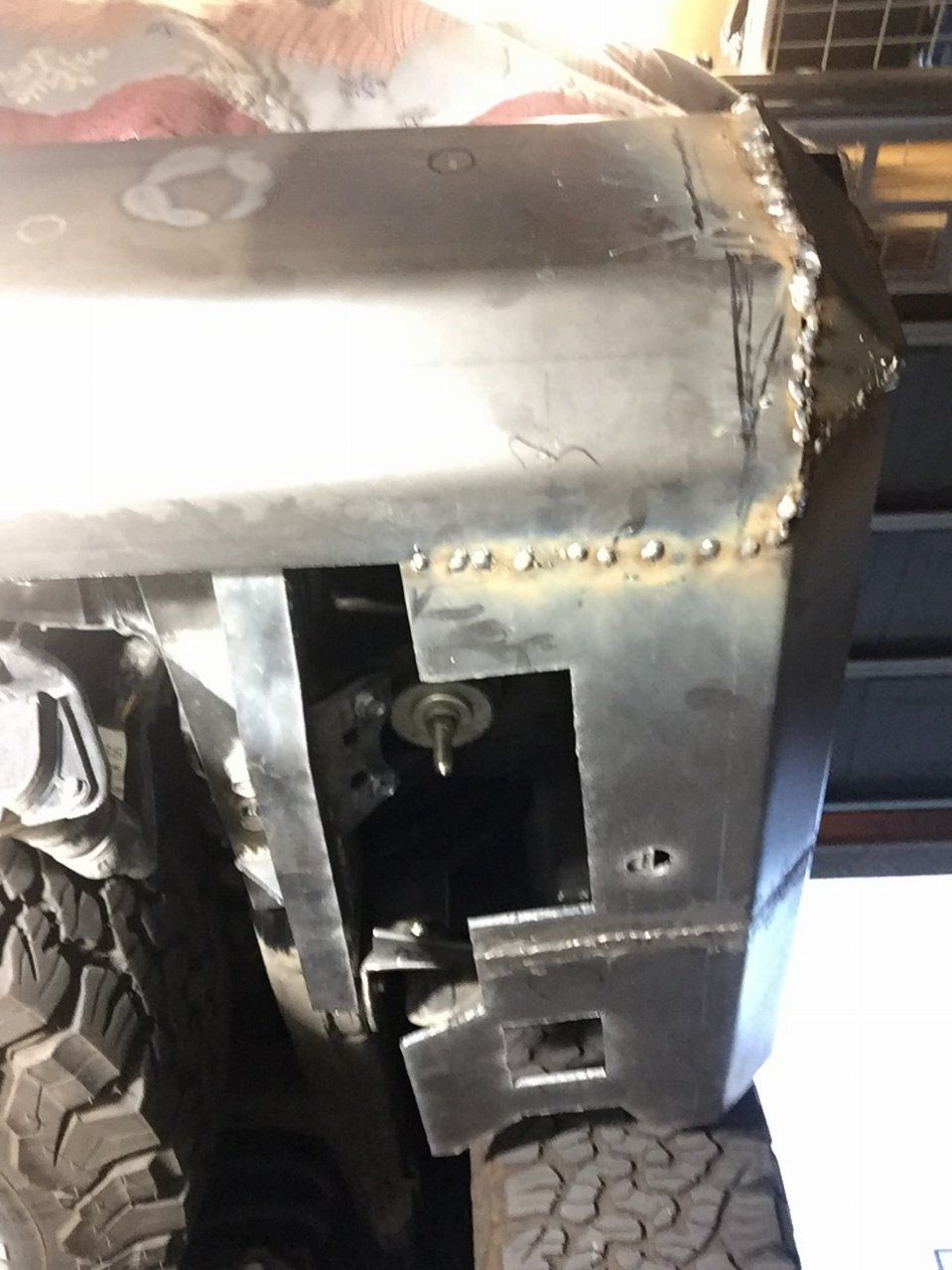

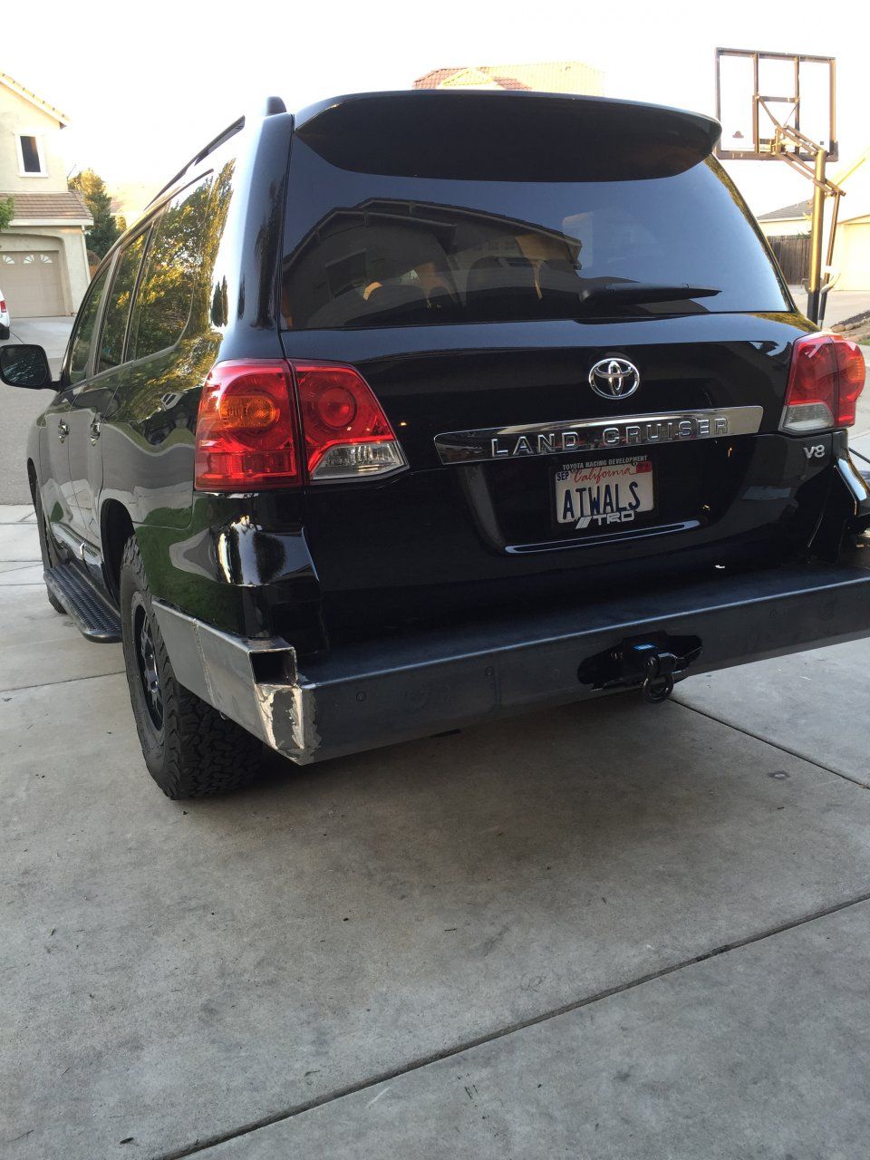

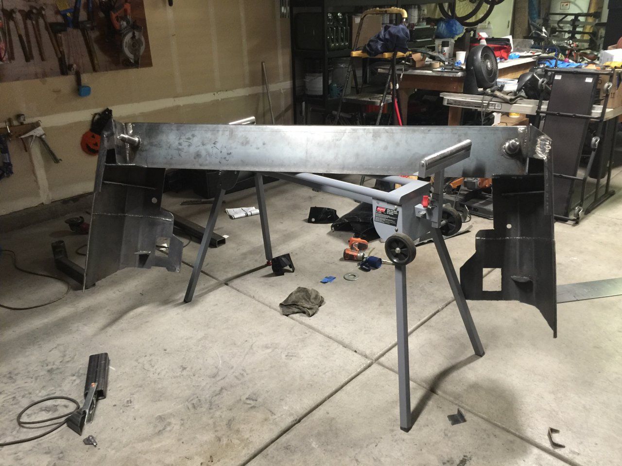

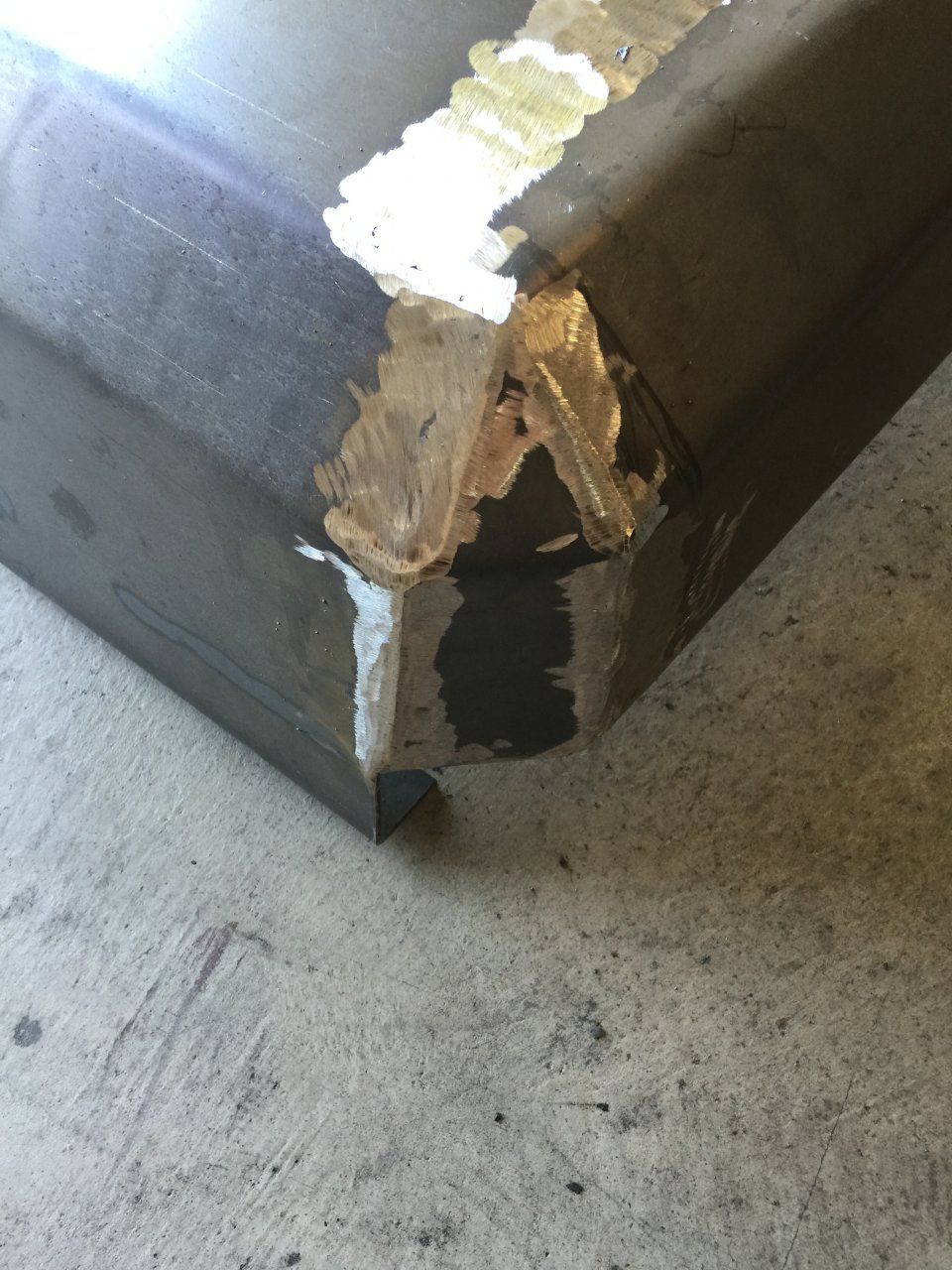

Started doing corners now. I will reuse factory rear flaps.

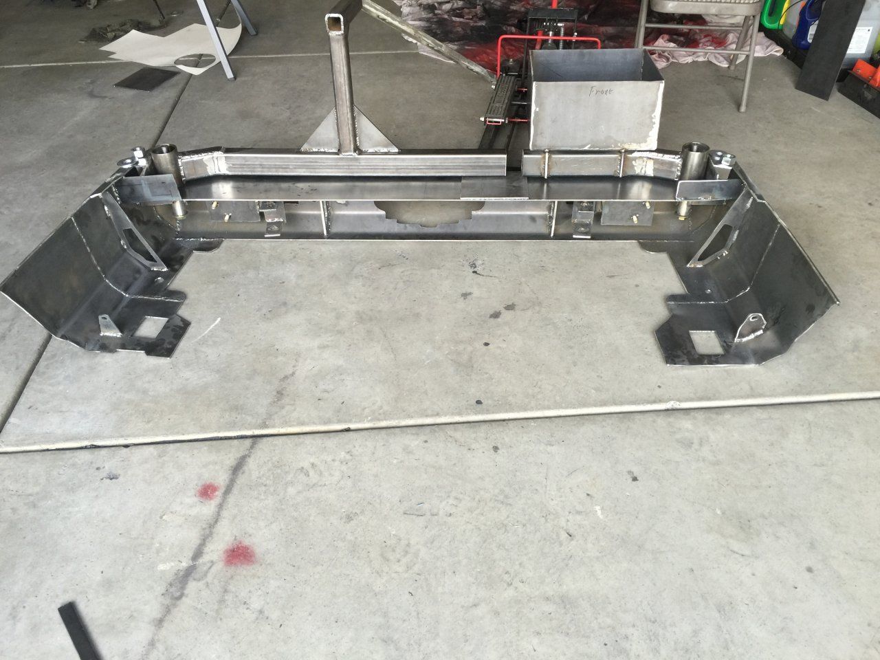

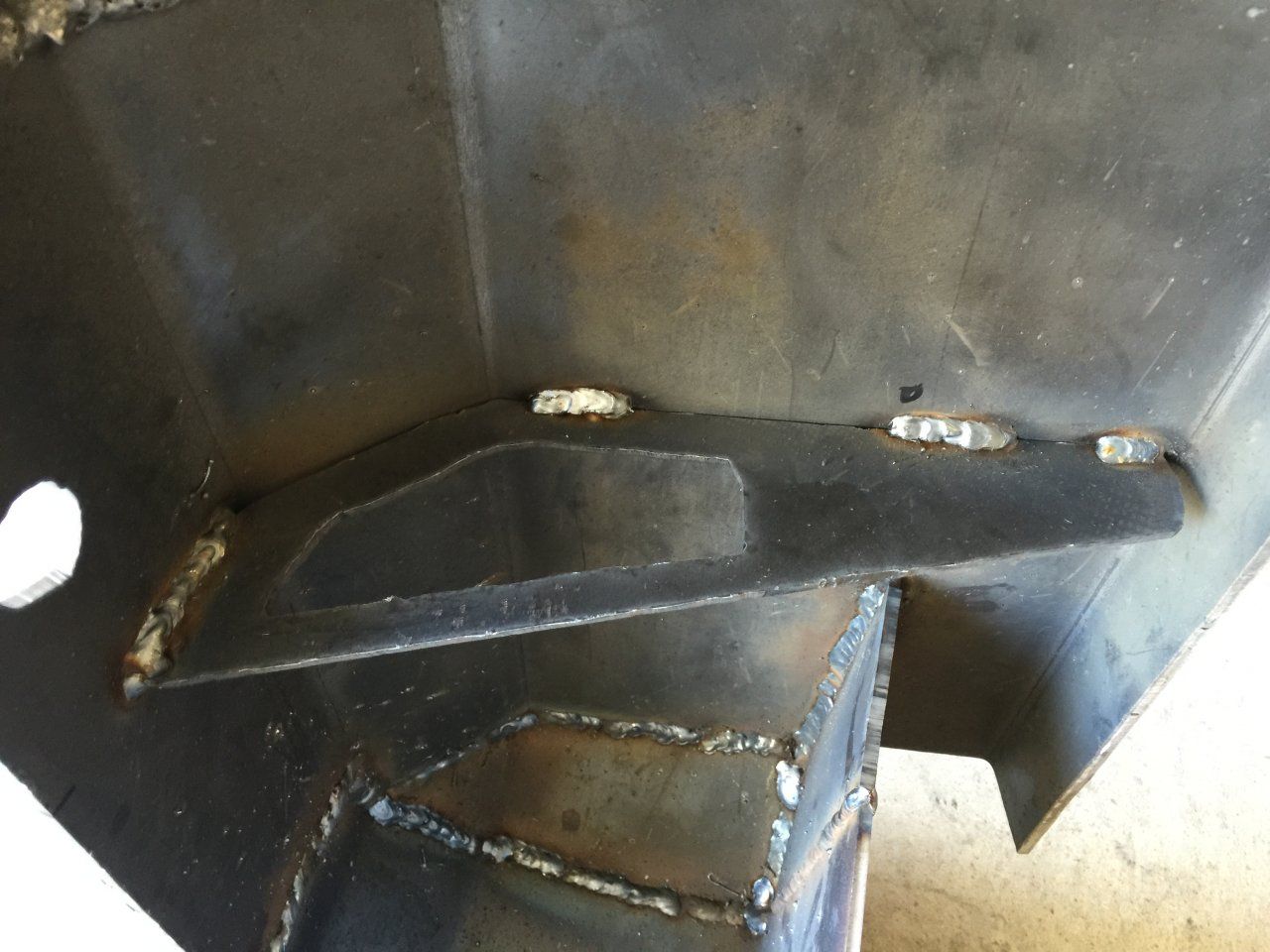

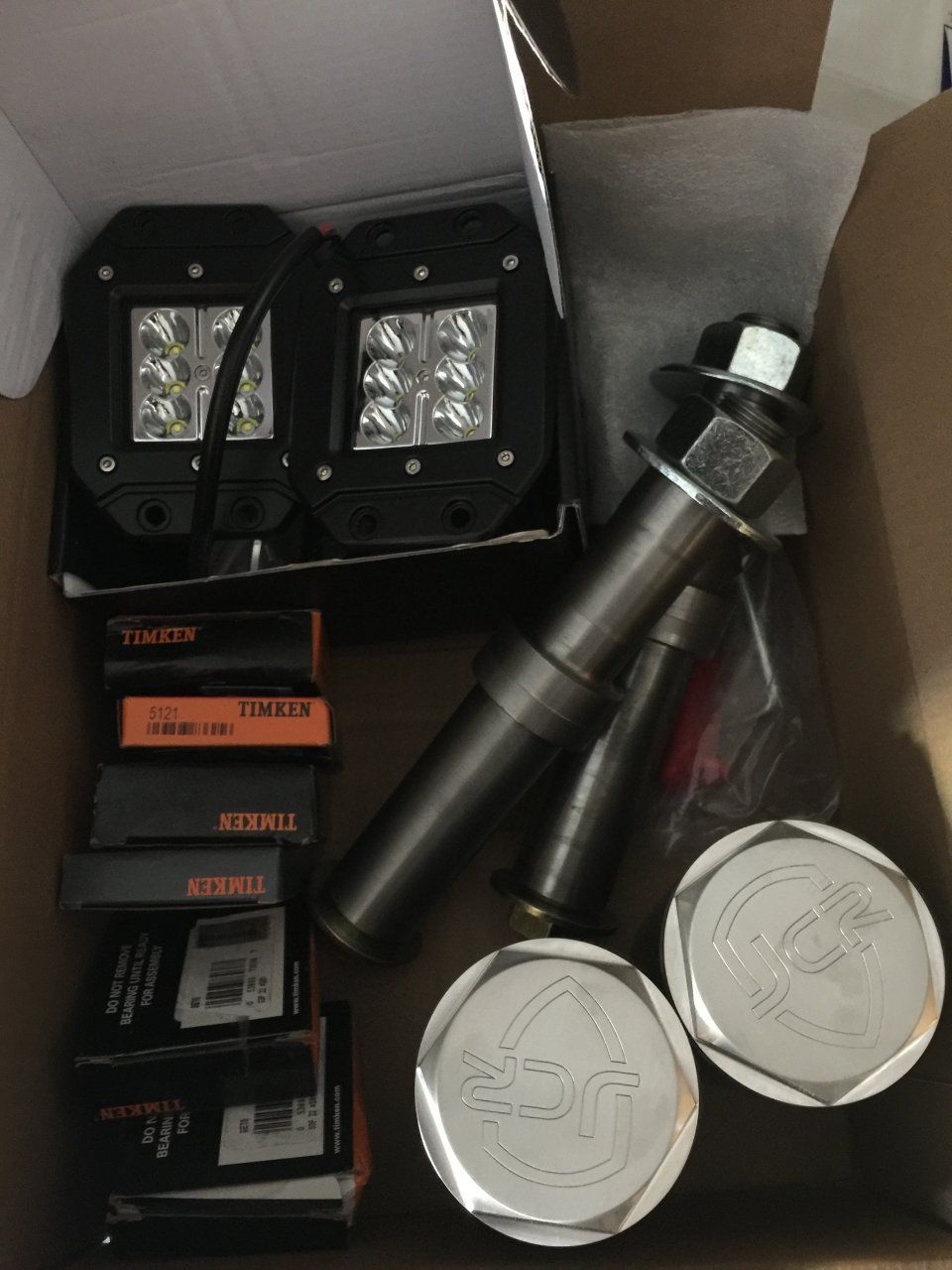

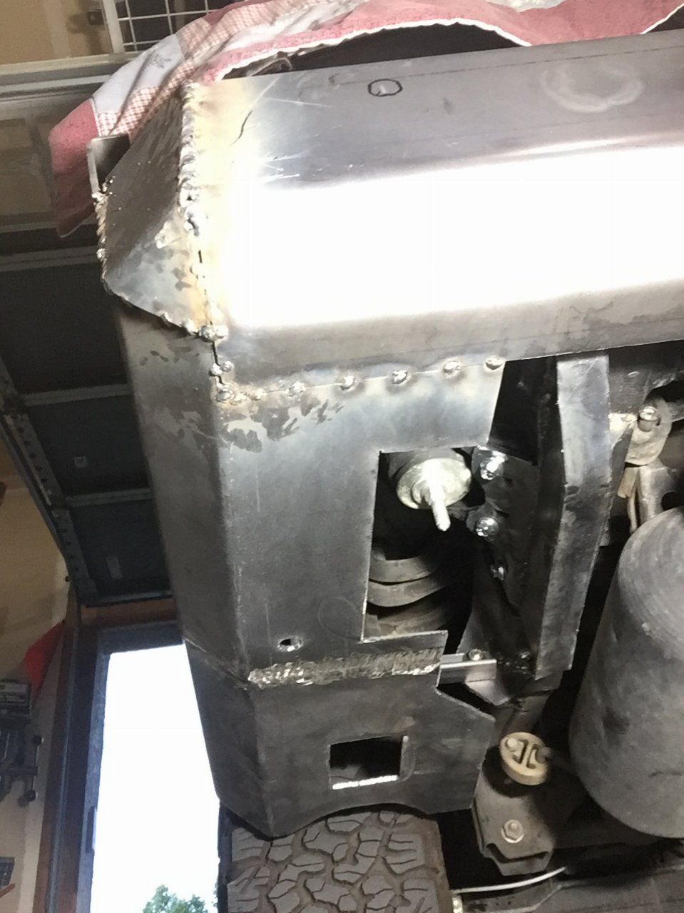

Welded gussets and grinding corners. Waiting for spindles and lights to finish rest.

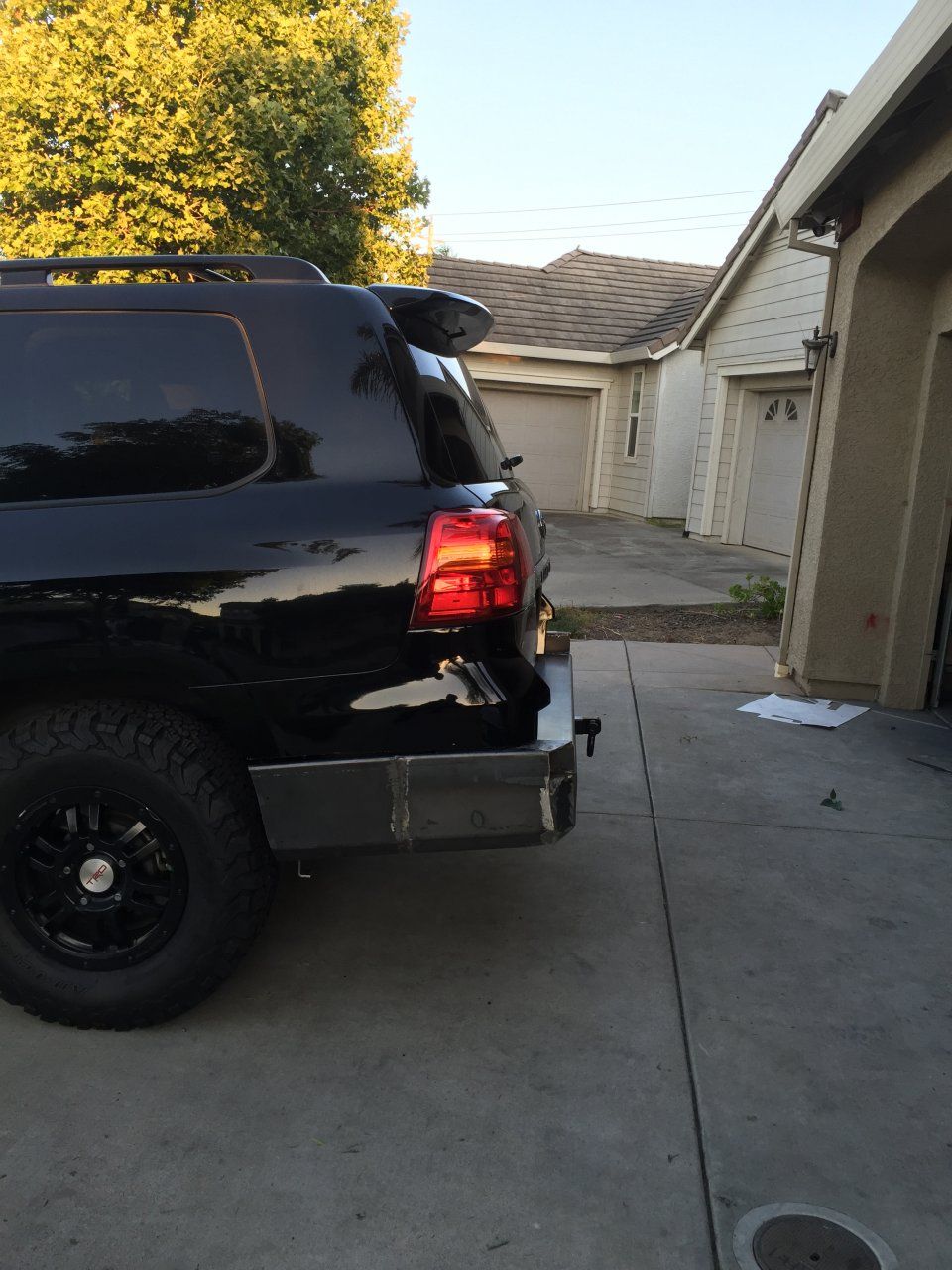

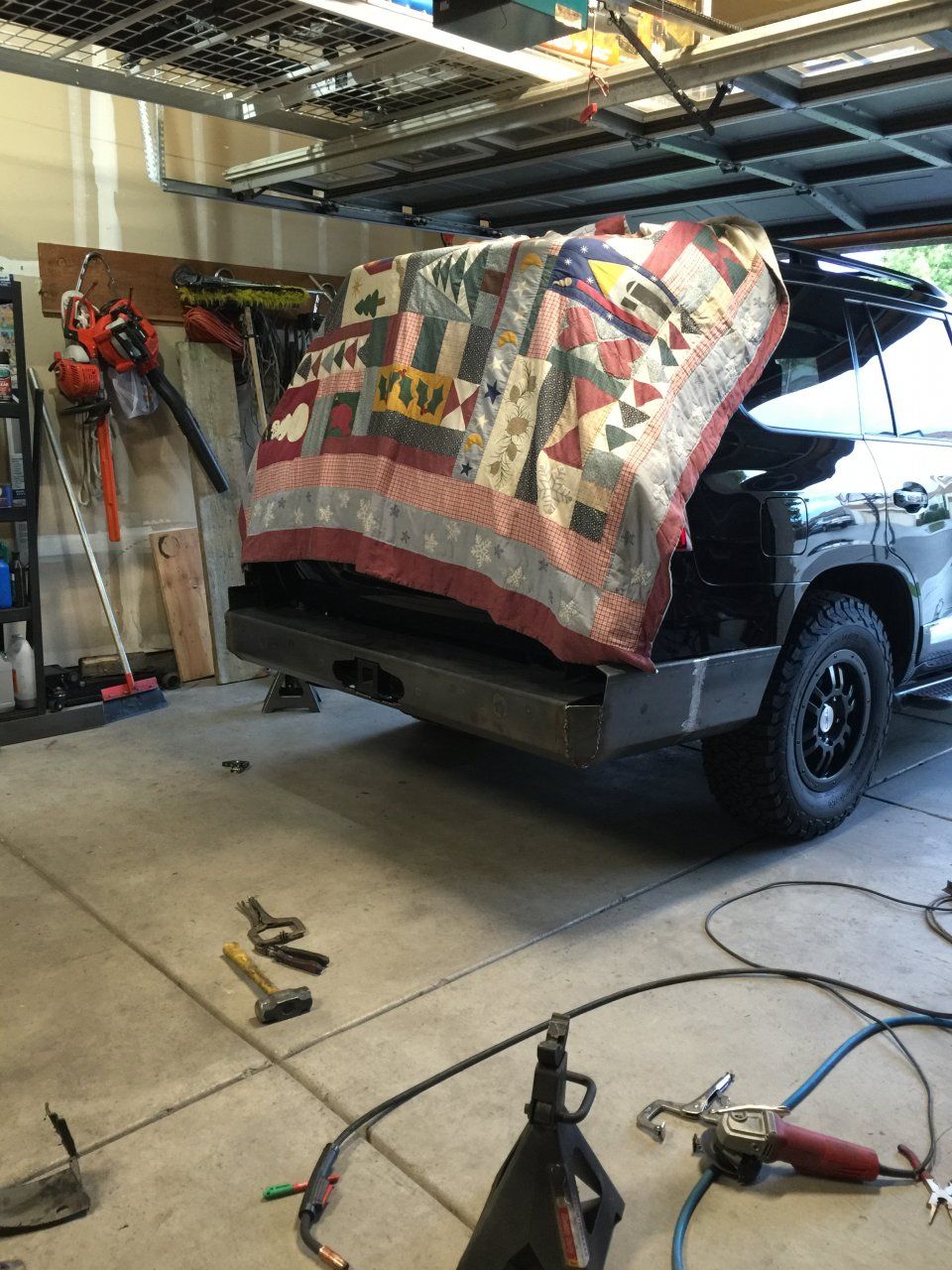

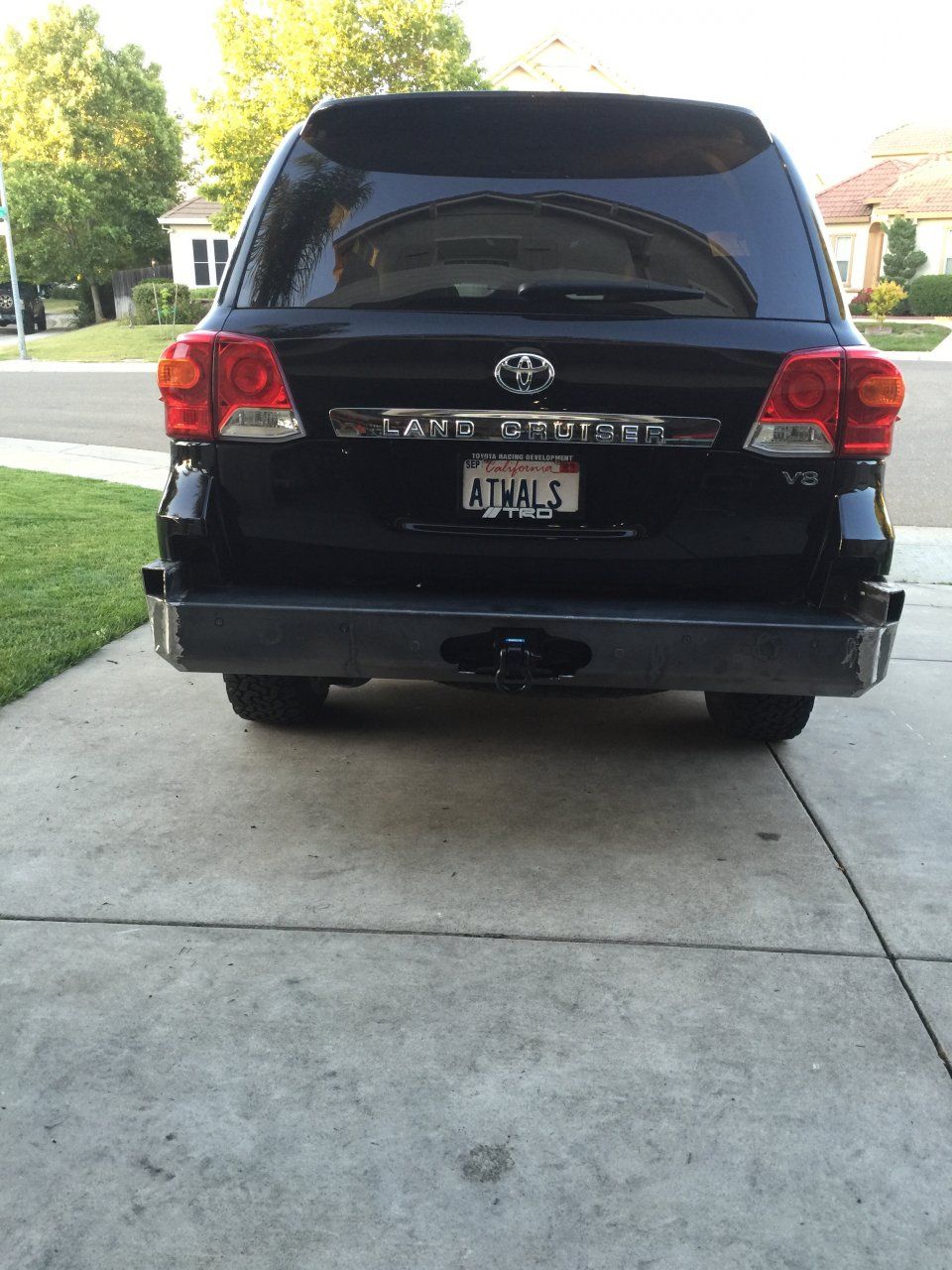

Temporarily installed to diagnose any issues. Added jacking point on top corners. Added angle/tabs to support wings. Parking sensors, lights, swing arms to follow. Swing arms only to used for off-roading/camping trips. I need heavier springs/shocks in back.
Looks beefy and strong
Thanks. Once painted black bumper will blend right in.
Awesome work! I am impressed

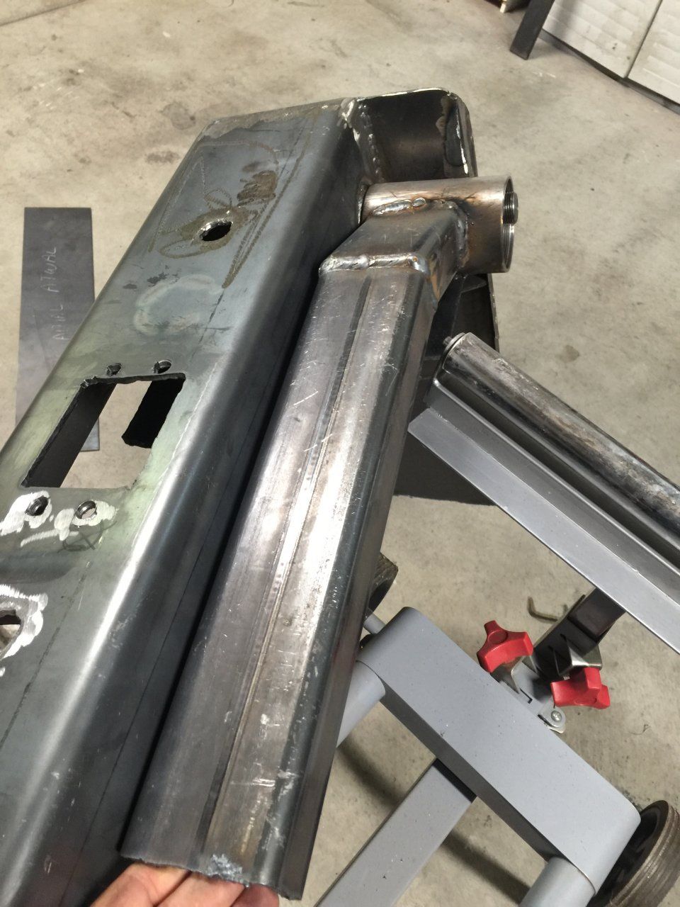

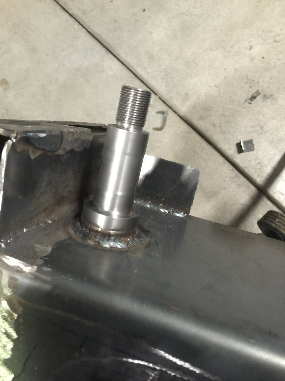

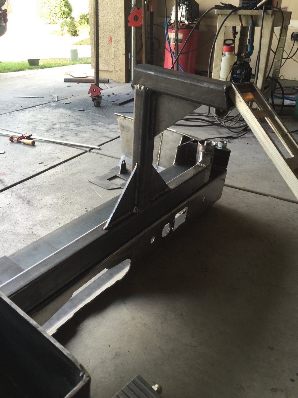

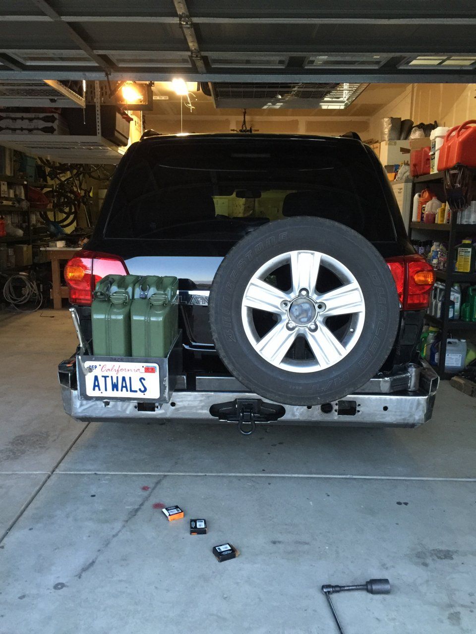

Making progress on swing arms.

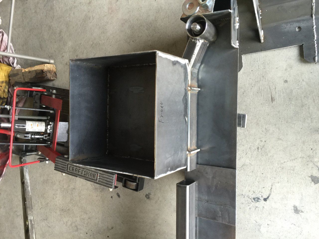

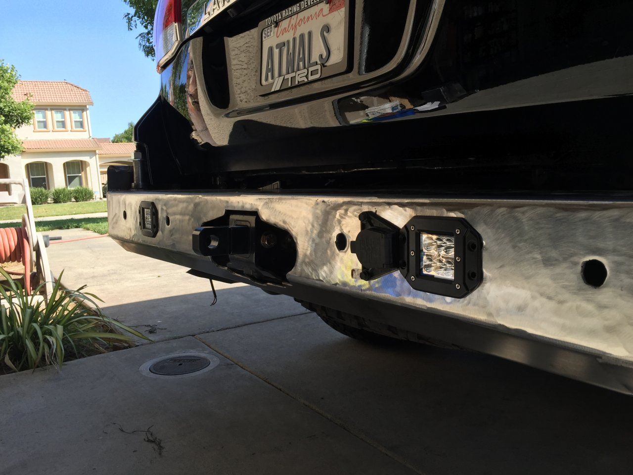

I especially like how you relocated the trailer wiring harness to the bumper.
I find the current location just plain sucks - aside from having to get down on my knees to see the plug, it's far enough to the side that I need to leave a lot of slack in the wire from my trailer in order to not rip the harness off on a hard left turn. That results in the wire hanging fairly low when driving, or possibly touching the ground during a hard right turn.
Space is very limited behind the bumper to relocate the 7 pin connector. With LED lights, four parking sensors and mounting brackets and factory hitch cross member, I was able to do this relocation by trimming the plastic ears of the factory trailer connector and by removing the tail end plastic cover. I will need to reseal the plastic trailer plug end to be water proof. I did this mod on my tundra as well and I was able to replicate again on the LC.

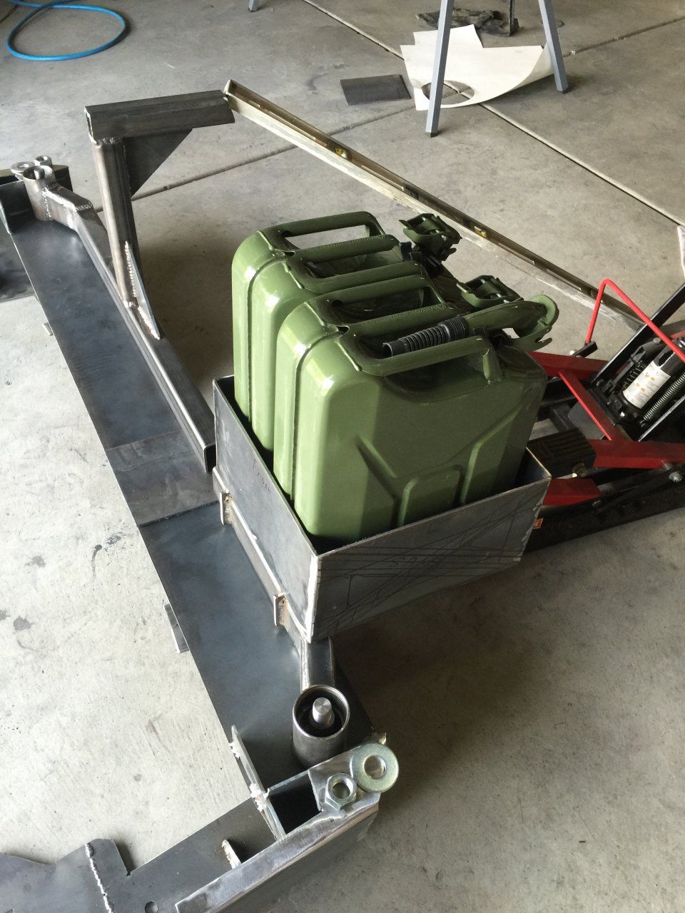

How much will you be selling these puppies for? You can throw a few on the roof rack and sell in Ouray... :)
Puppies are still under R&D phase. I will be testing them at Ouray and Moab. Truck squats with all that weight. I hope to have everything button up before trip. Maybe minus paint or powder coat.
New weight is always something to take a while to adjust. Looks great. Good job
