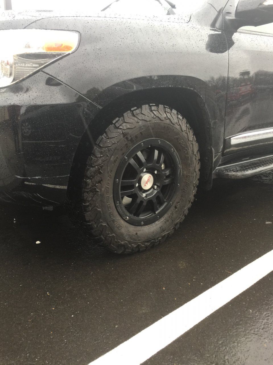

Wife had a side swap with a mustang convertible. Mustang driver was uninsured and going in a carpool lane as a single occupant. Carpool lane traffic stopped while the mix flow lanes were going stop and go. He lost control and encroached in my wife land and side swapped the truck. So, rock sliders saved the day and took most of impact and few minor scrapes on left front fender and wheel. Cruiser safety kicked and locked Mrs in seat and prepared to take an impact. Luckily no one was hurt and mustang took all damage. I have no pictures of mustang but here is LC.
Wow. So glad everyone is unhurt, and great to hear your sliders helped to minimize damage in the accident.
