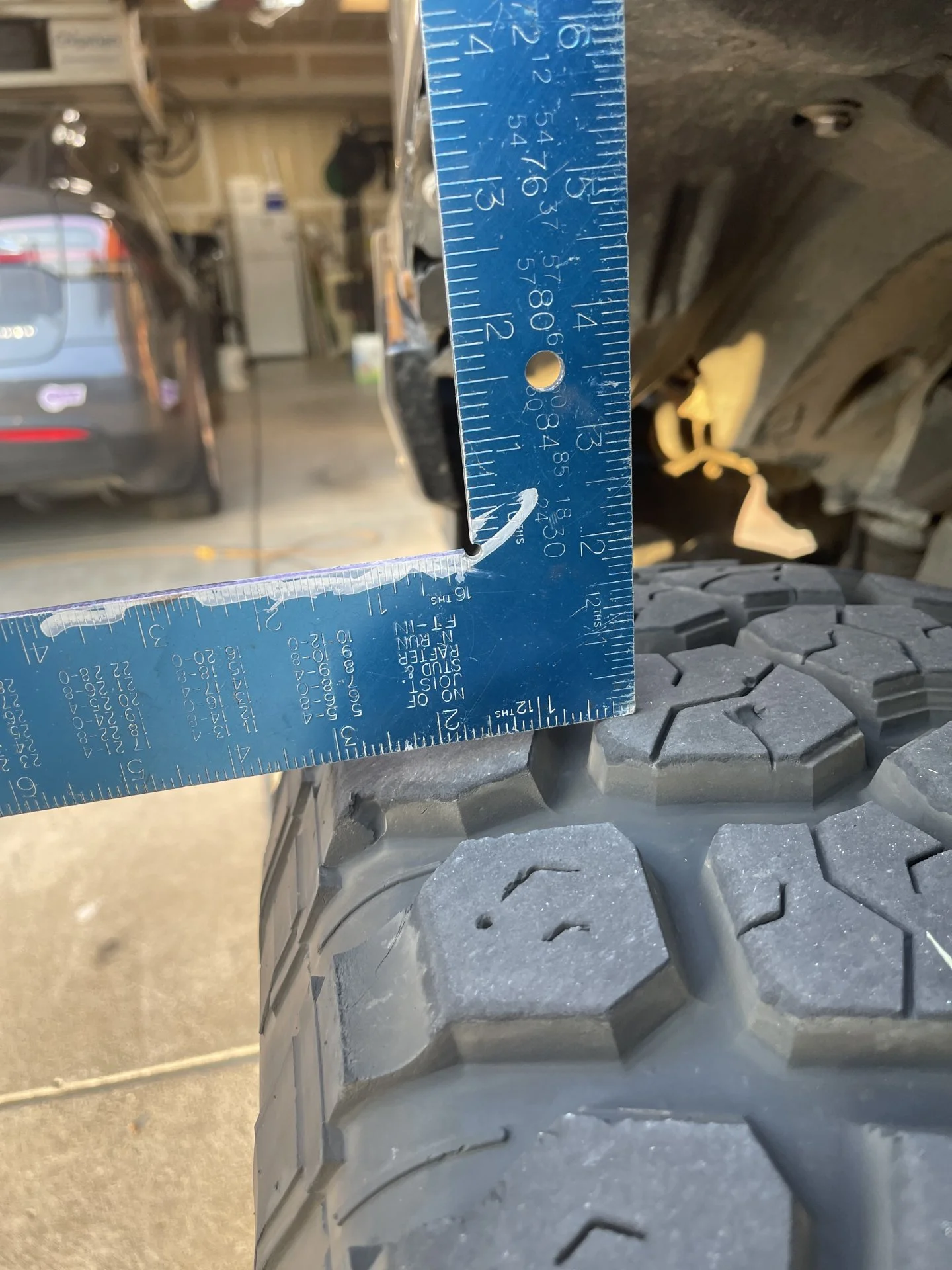

30mm on the rear was enough to Aline the tracking to the front ? How far is the front tires sticking out with the 0 offset ?

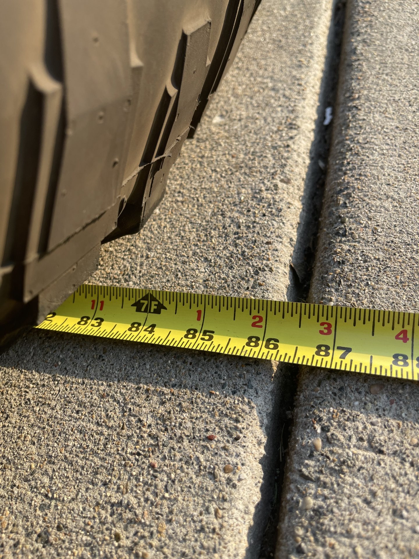

Front and rear tires stick out ~ 3” with 0 offset. Crown built me +4” brake lines than stock. You can use LC A-arms to save some dough. RW will not work with drop bracket lift. You can use em with spacers. I end up selling RW and went with method 704 17” wheels. Someone here on mud drove from AZ to pick them up from Sacramento. I still have Icon Coilovers, rear shocks and Camburg arms from my previous version of lift. I can still park my 200 in garage 😀. I am running spidertrax 1.25” spacers in rear on 0 offset wheels. I like wider track with lift and provides better handling. 84” OD for front tires.

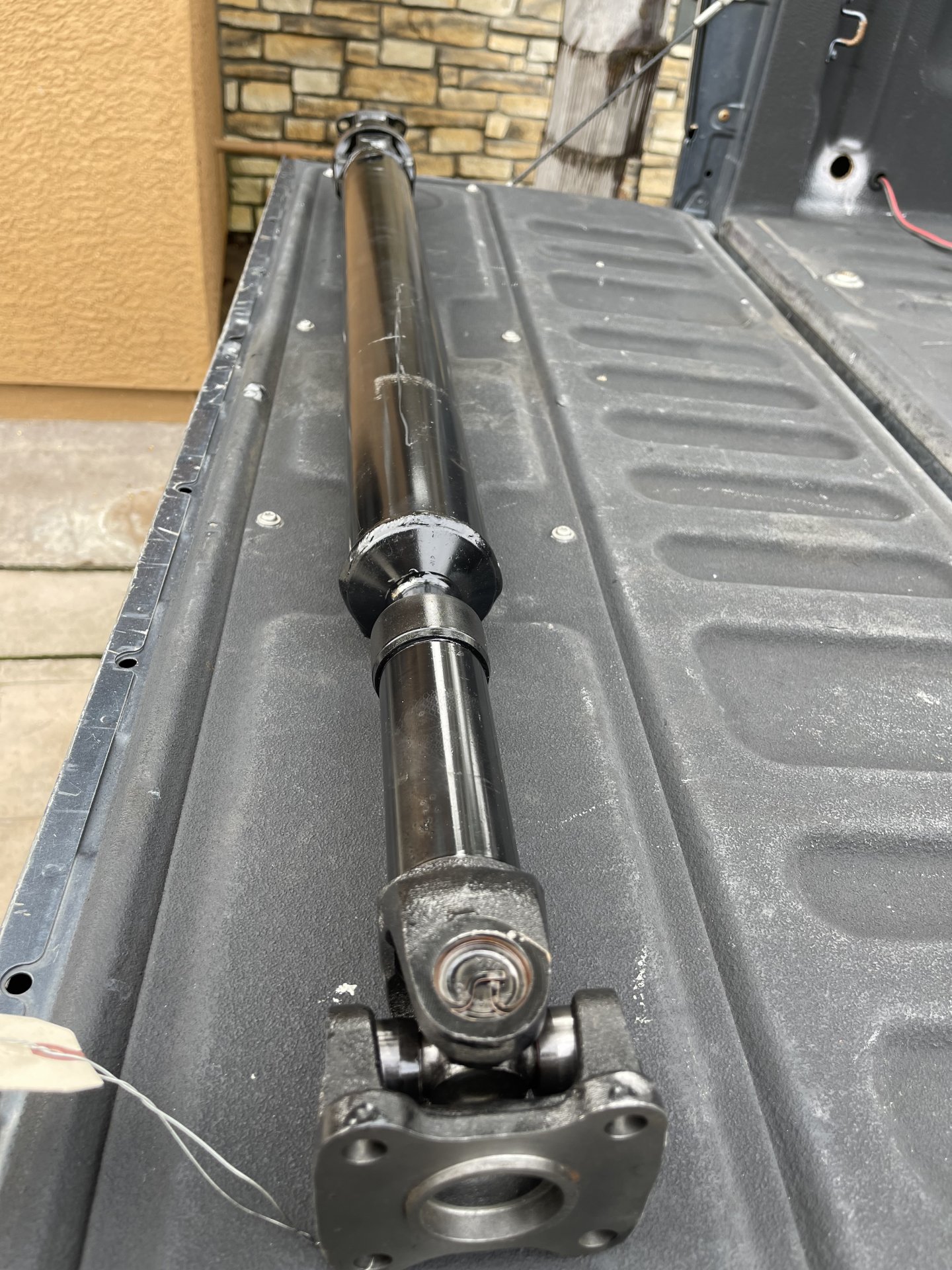

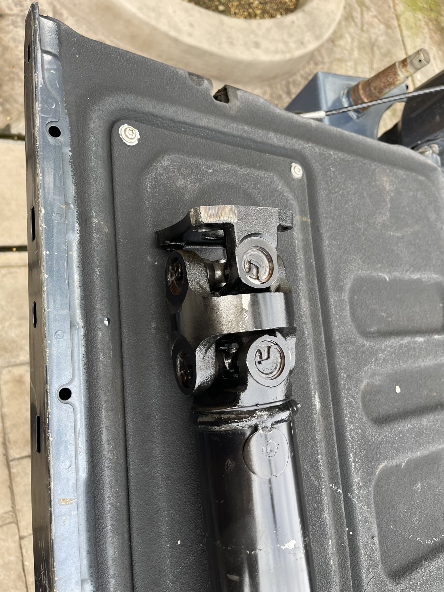

Custom rear driveshaft w/double Cardan Joint built by a local shop. Tube thickness is 0.134" x 3" OD using 1310 splicer U Joints.

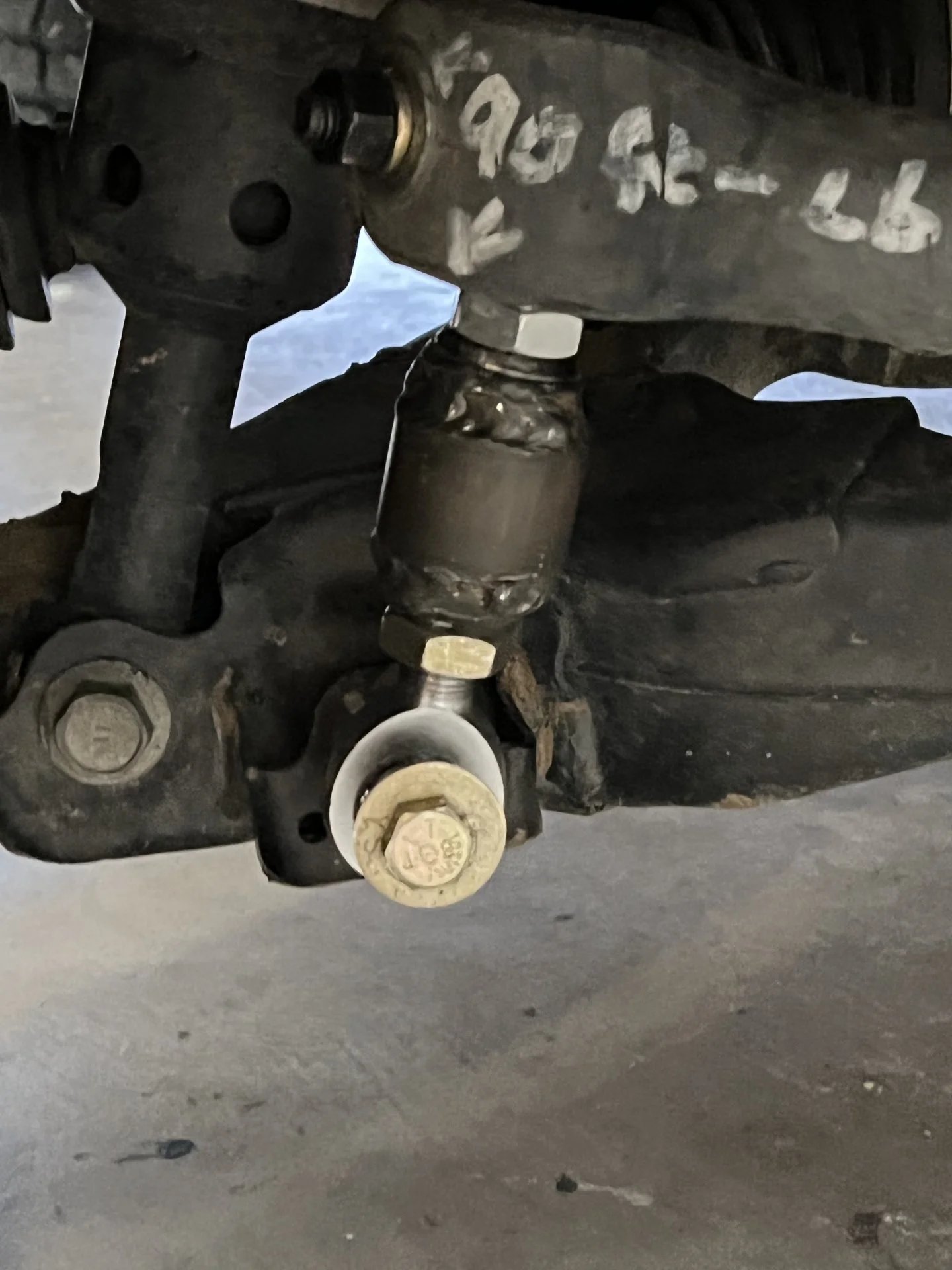

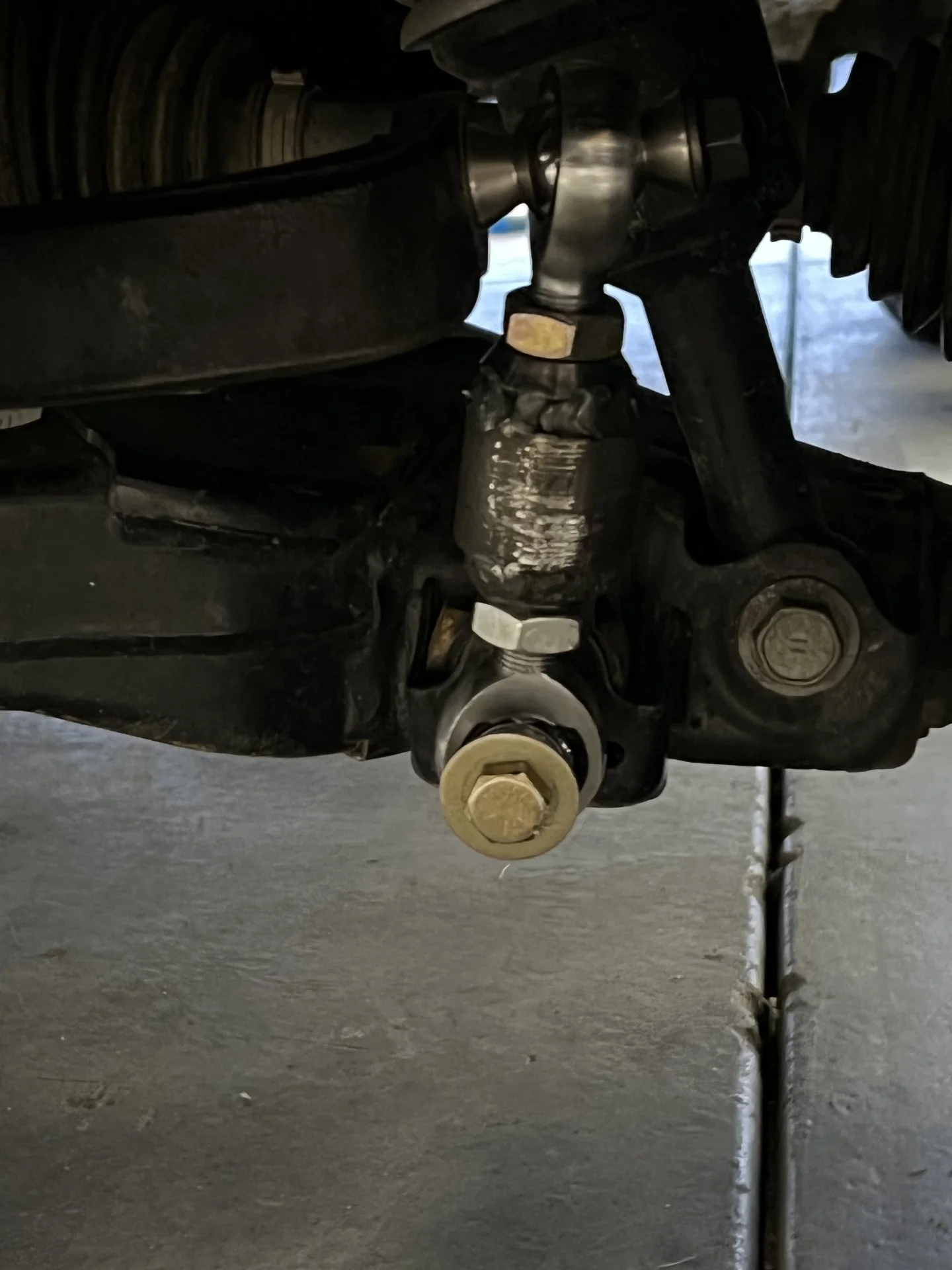

Swapped front Bds KDSS link with hiem joint homemade links.

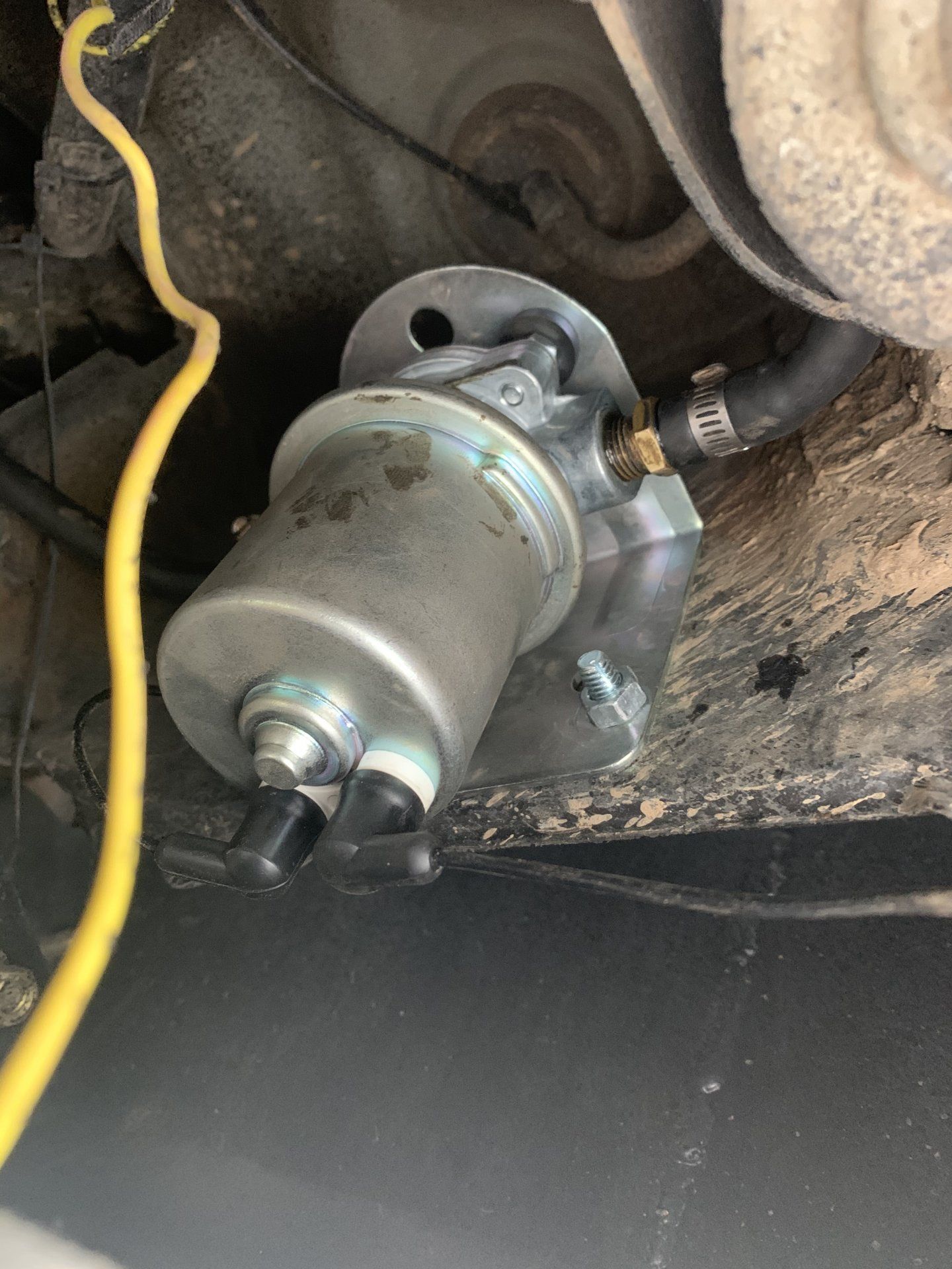

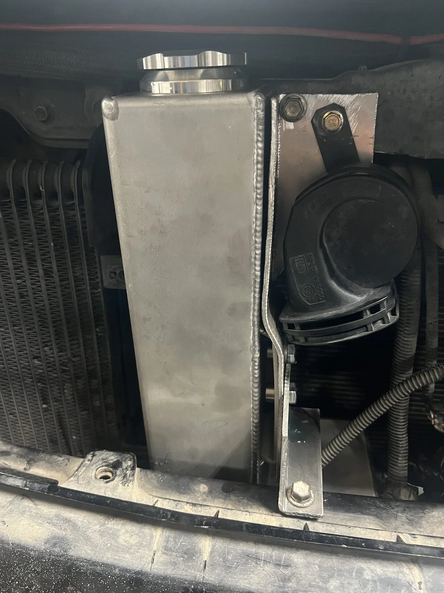

Relocated washer fluid reservoir . It’s designed for 4 runner by Rago fab, but I was about to fit to cruiser with some custom brackets. I only connected two pumps (front and rear). Fluid level sensor and headlights washer were deleted. This eliminates the washer hoses from damage as I deleted fender liners and cut fenders a while ago. I didn’t have to extend the harness. Reservoir hold 2 liters of fluid. Low fluid level warning light will not come on since sensor is not connected.
Glad you took the leap, I was trying to find a replacement - any worry about blocking front airflow to radiator at all?
I report back if there are any airflow issues. Probably will wait till summer to know results.
