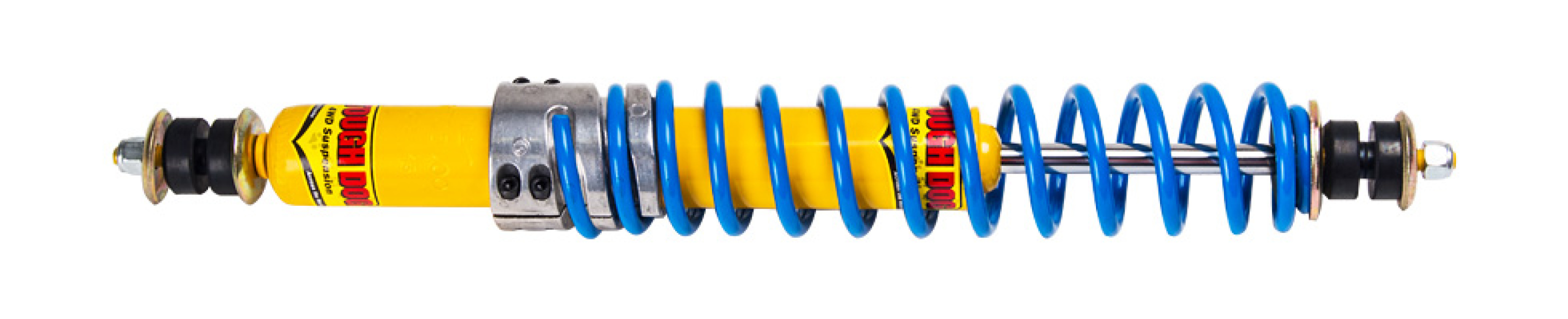

Ordered tough dog return to center steering stabilizer. Looking forward to installing this.
Icon stabilizer was limiting turn due to its length when I swapped drag link. Icon was mounted using pair u bolts wrapped around drag link in old setup. New drag link is using factory type mounting from Tre to bracket. this distance in my case was 21.25”. This tough dog setup seems to have sufficient travel for drag link movement. So far it’s good for around the block test drive.
