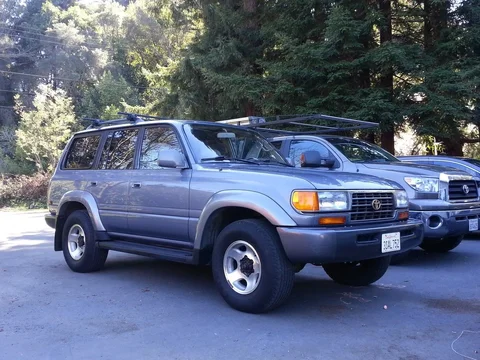

I have the exact same truck with about 75K additional miles. Mine too is mostly rust free and only Center Locker. You would appreciate the post I did for under-hood lights.
https://forum.ih8mud.com/threads/underhood-led-lights-upgrade.806377/
I too did the LEDs and just finished the stereo and speaker upgrade. Its super easy once you know how to remove door panels (which you already have).
I used the Pioneer speakers from Ebay and they are cheap, fit well and sound 10X better than stock. Willing to answr any questions when you get that far.
I removed my roof rack and painted my wheel center caps the exact same way.
I will be doing the emblems and adding extinguisher and extending alarm antenna soon. Thanks for the ideas.
