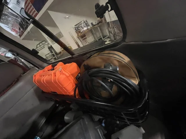

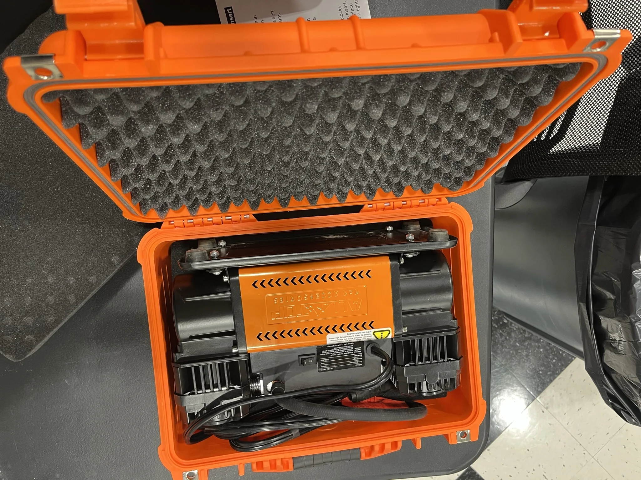

Picked up a harbor freight case on sale a few months back for my compressor. Tight fit but it works. Got the 4x4 Labs rear baskets. This should be a nice spot for the compressor. I'd prefer to integrate in somewhere but don't want it under the hood (it's too big anyway) and don't feel like running power to the rear at this time. This thing cranks the air.

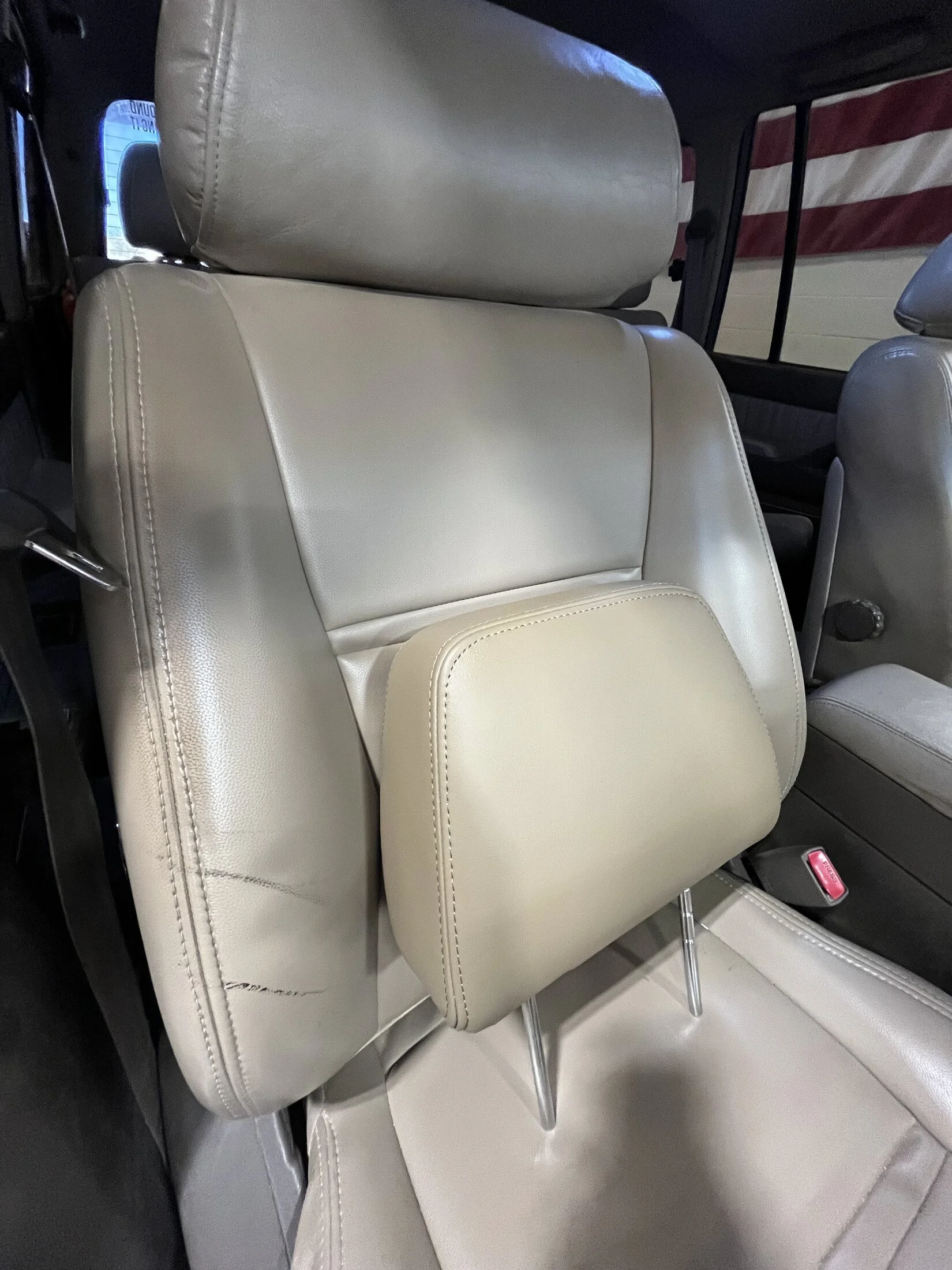

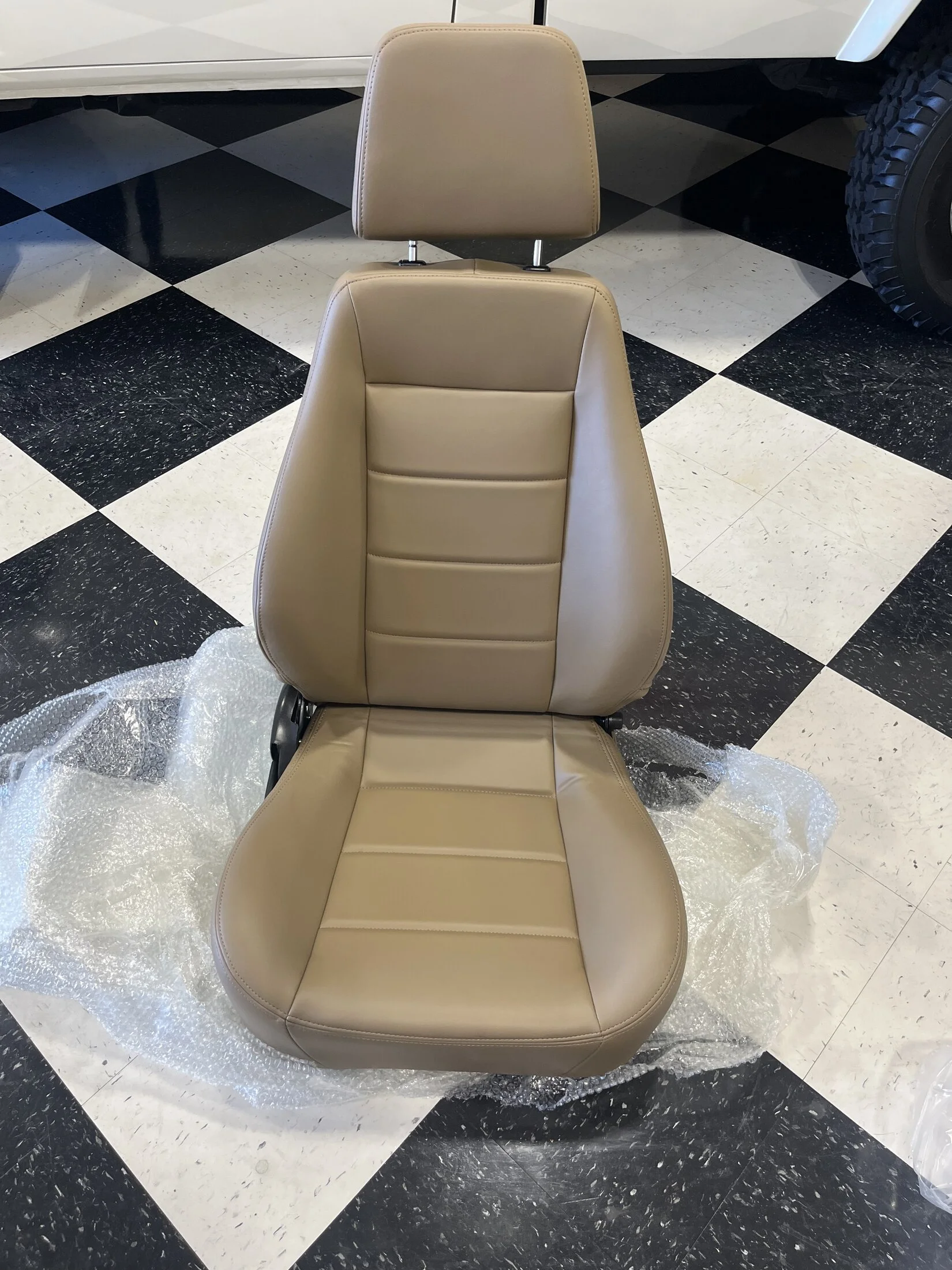

New seats! Hoping to install them before the weekend. Corbeau Sport in Spice color. They are a great color match. I got into some deep water (long story) and fried my power seats. $1080 total delivered including brackets.

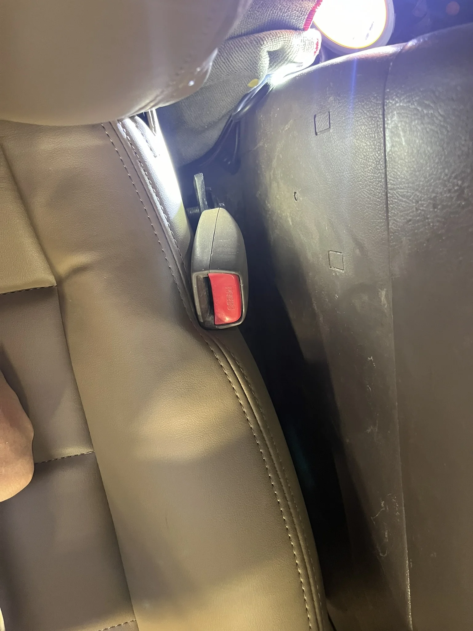

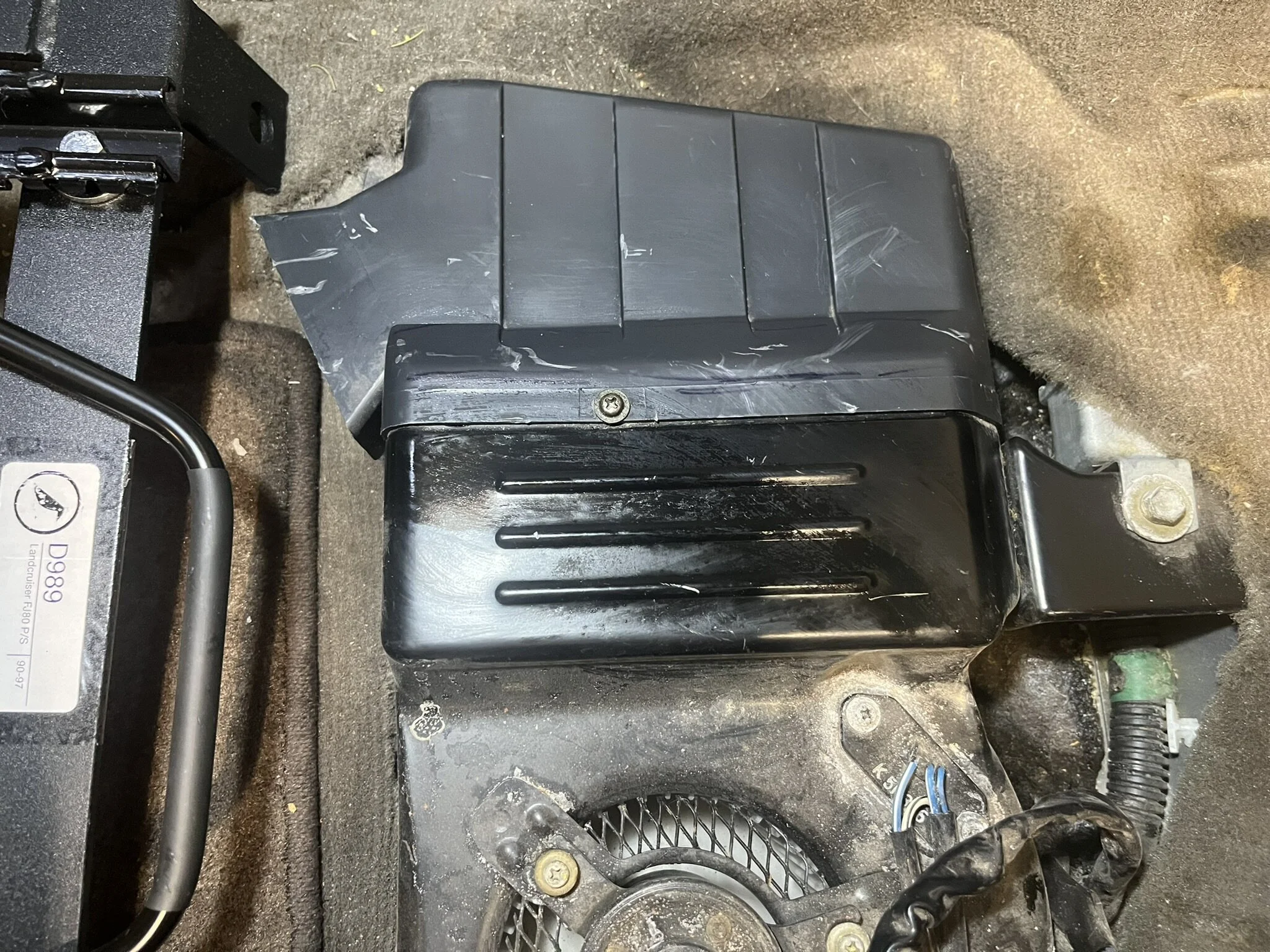

Corbeau seat installation - A few comments that might help others:

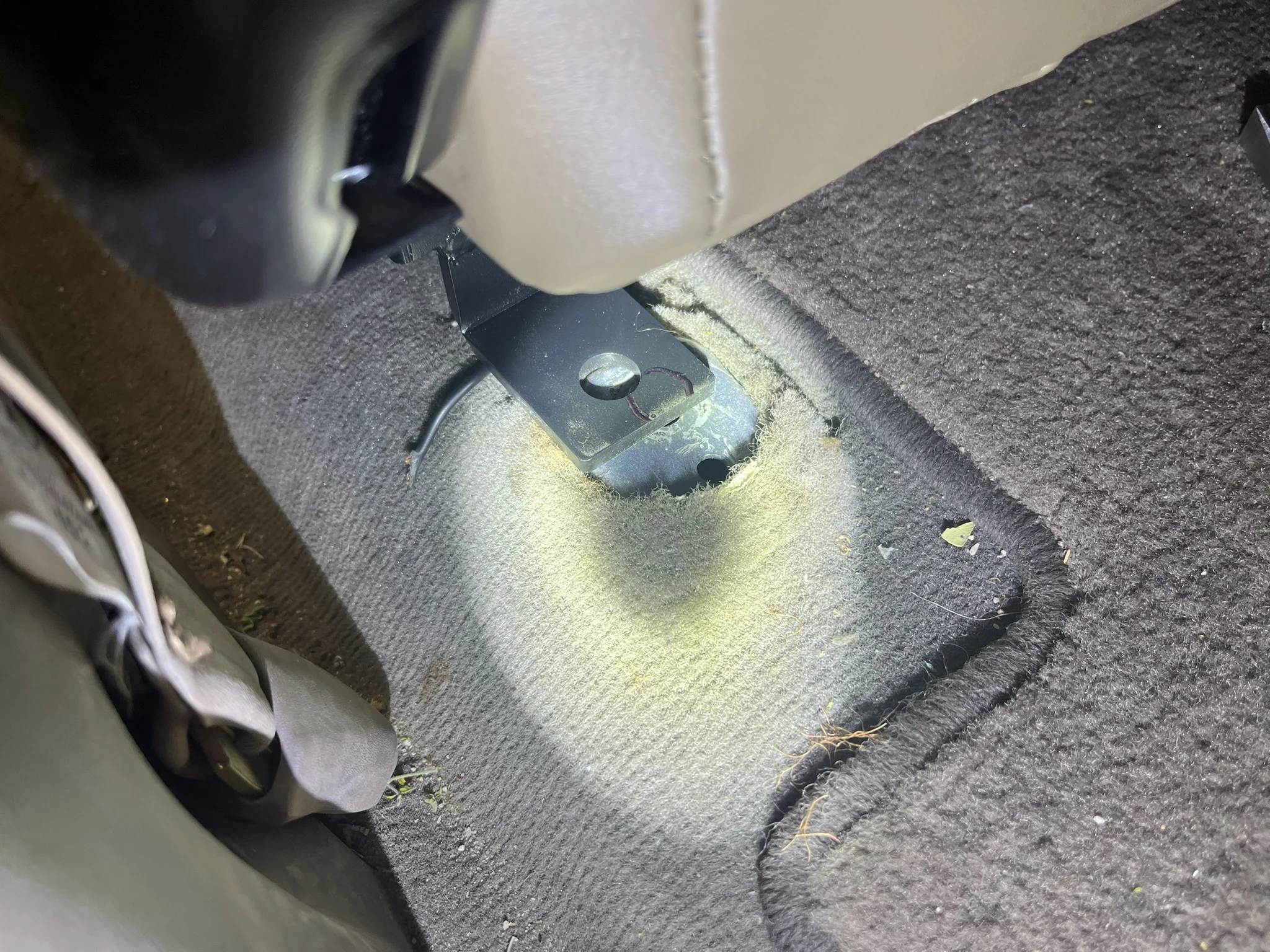

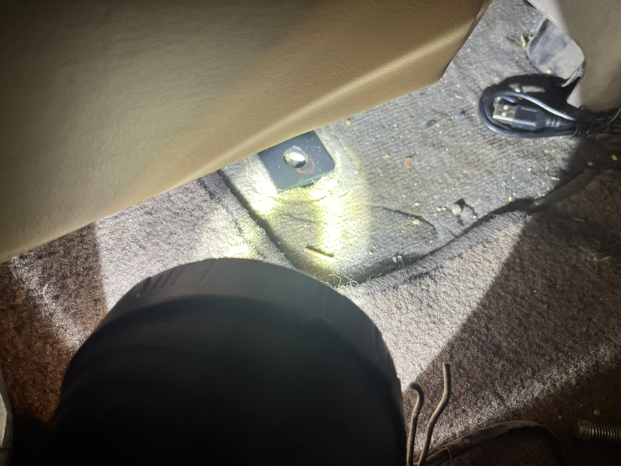

-Like others, my bolt holes did not line up. Passenger side was good, drivers side was not. Fit the brackets before you mount the seats.

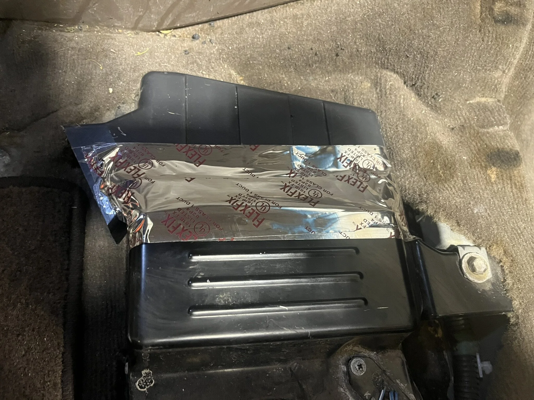

-Heater conflict on passenger side. Easy work with a dremil. Multiple layers of foil tape was my workaround.

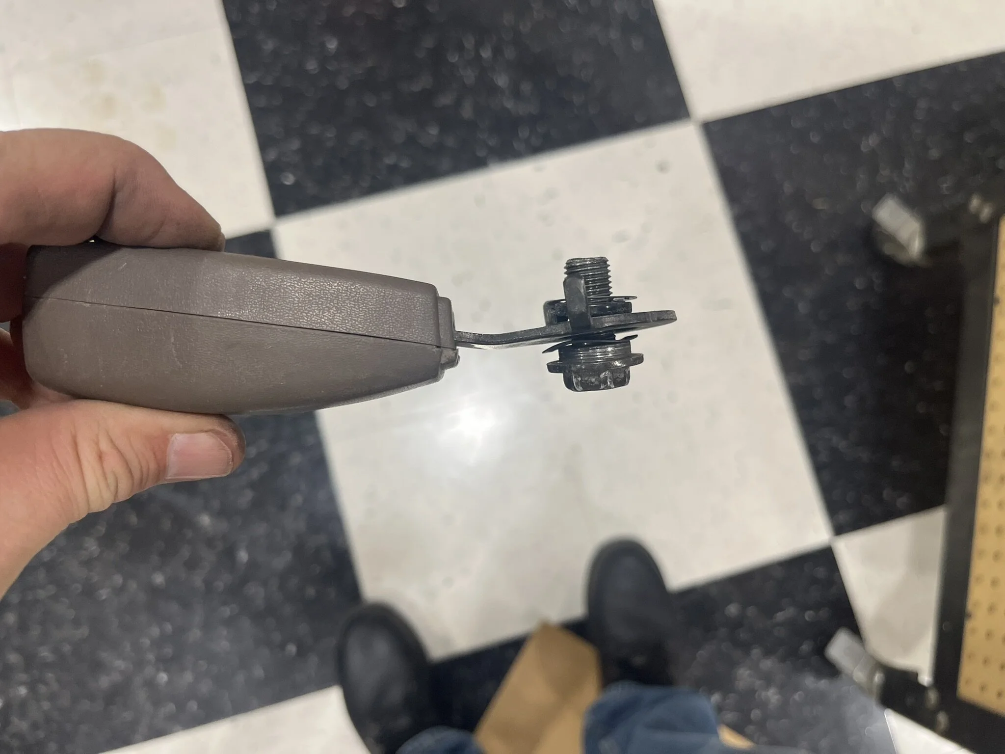

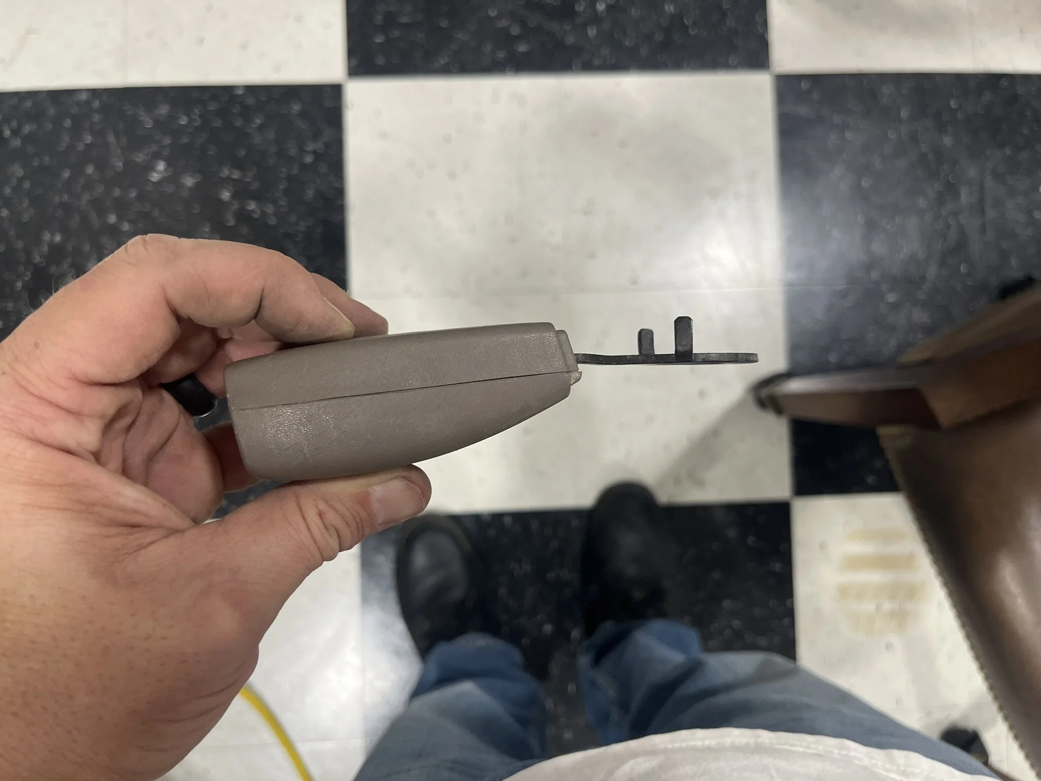

-You re-use the factory seatbelt receiver. If you just bolt these up they will potentially lead to a premature wear in the seat fabric. I had to put mine in a vice and bend them. This created much less "rub" when the seats are slid all the way back.
-I am very happy with the "Spice" color. They look good in the rig.
-Can't fully comment on the comfort but the bolsters fit me nicely. (5'-11, 205 pounds of pure love)
-If you are tall you will like how far back these glides go. Huge improvement.
Initial heater setup.
After cutting. It clears when glides are slid fully back.
After multiple layers of foil tape.
New and old comparison.
Initial passenger seatbelt receiver conflict. I'm not even all the way back with the seat.
Factory setup with slight bend.
After adjustment. I actually bent it even more after this picture. I'm going to stick a piece of felt on the receiver between it and seat to help. They still contact but this is much much better and I'm not worried about it wearing into the seat fabric.
Bracket conflict on drivers side. I will be making this final adjustment tonight. I made the mistake of mounting the seat before fitting. :bang:
