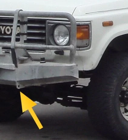

The old ARB bumpers had lower loops in them but they aren't strong enough for recovery with shackles. I contacted ARB about them (pic is of my bumper) and they said not to use for pulling, towing, winch yoke or pretty much anything else. All they are good for is for attaching the winch hook when the cable is stored.

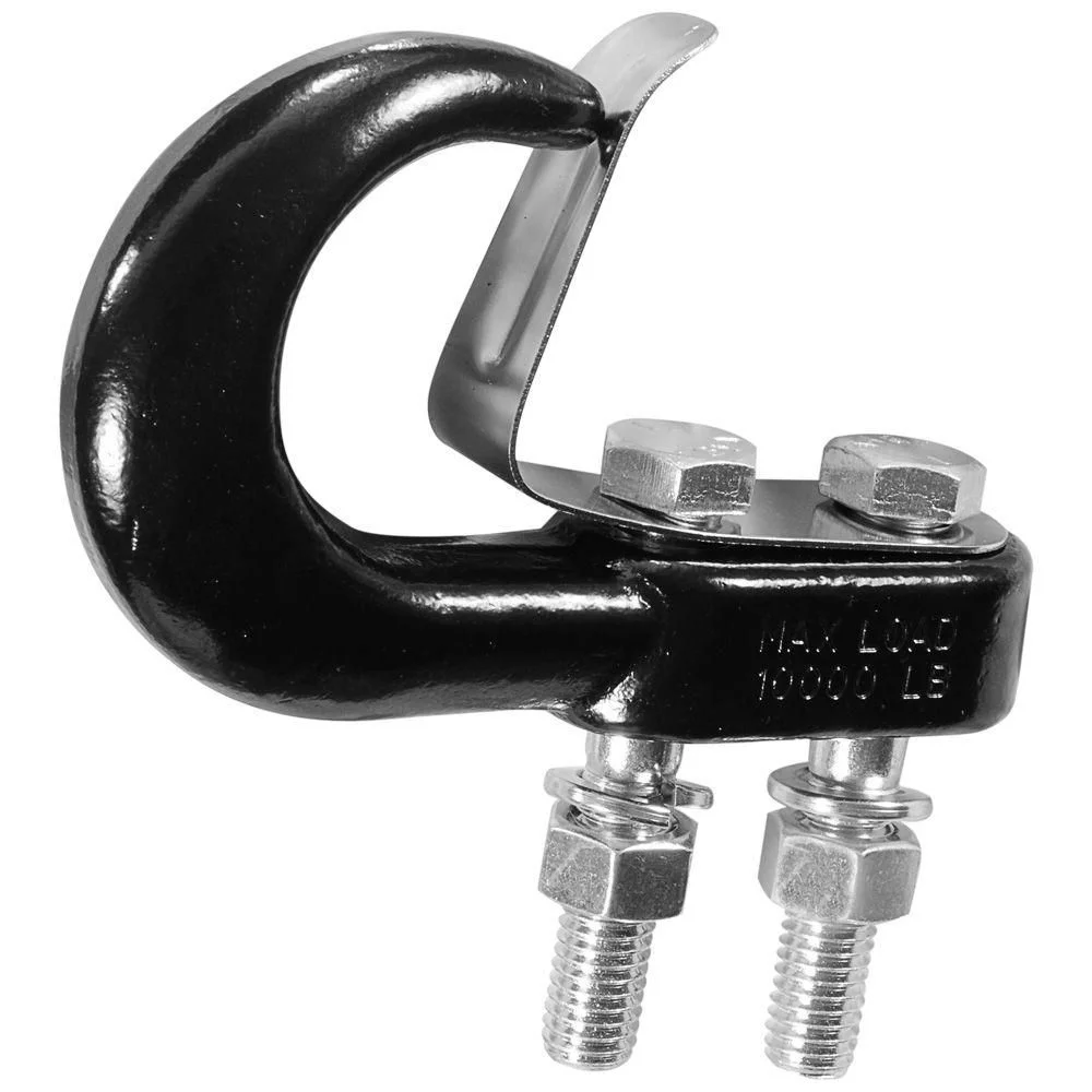

The two tow hooks and tow hook mounting locations on the uprights are very strong. These are the recovery locations. You can get tow hooks with strap keepers to keep the strap (formed into a yoke on both hooks) in the hook.
I just noticed in the OPs picture you can see the d anchor points on this new bumper. They are recessed and inline with the frame. Little boxed areas.
Yeah. The new style bumpers have them too but like the old style, they are too flimsy to use for recovery purposes. Best to attach a hook to the frame.
The two bottom holes are cut into VERY thin metal. I'm pretty sure that I can bend the metal with a good pair of pliers. If you installed D-rings it would be for show only. I need a true anchor point when I use a snatch-block to winch.
