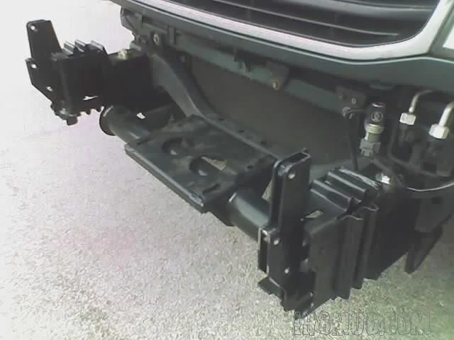

Also Greg B posted this pick of the winch cradle for a 98-02 combo bar winch cradle in an other thread. Does someone have the 03+? Sahara Mounts?

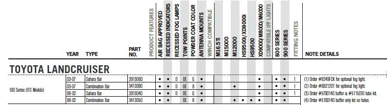

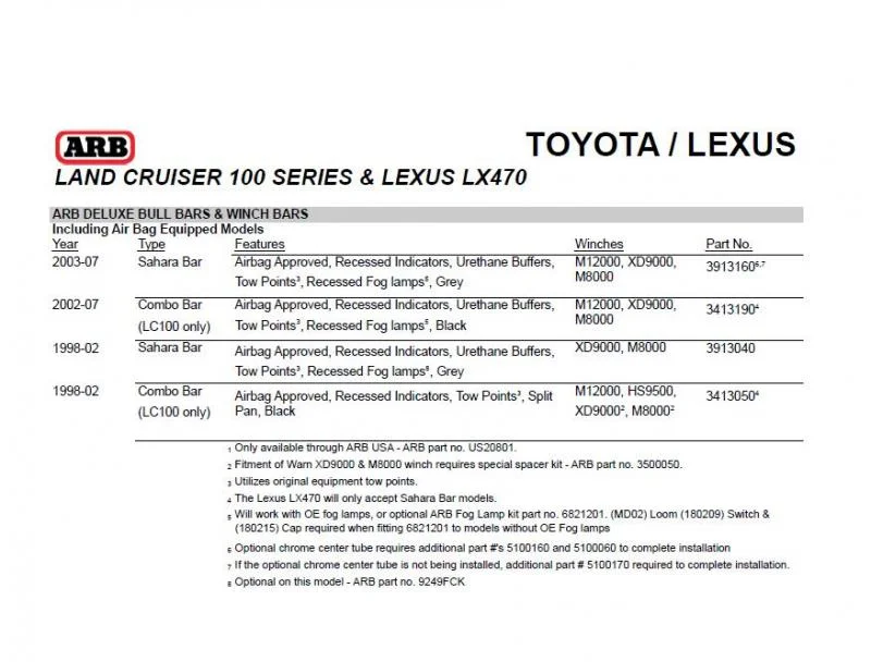

Hoser, I noticed that the picture you posted has a discrepancy for winch compatibility on the Sahara bars. Can anyone clear it up?

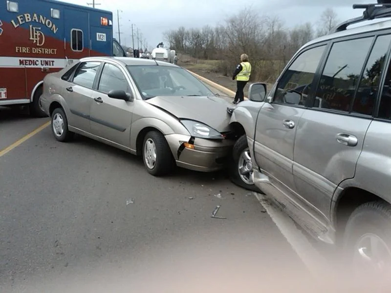

Hmmmm maybe this is why my wife's airbags didn't deploy when she was hit head on. The LC sustained $8500 in damage, and the other car (ford focus) was totalled.
The Cruiser seems pretty intact. They might not deploy until greater forces occur because the vehicle is so strong and protective in the first pace. Because of this it might be possible at lesser impacts that the airbags could do more harm to the occupants than the collision itself. How was your wife after the crash?
Shotts,
She saw it coming and braced for it. That didn't help and caused her to tear her rotator cuff, bilateral distal radius fractures, and a tear in the tendon by the scaffoid.
On a side note...when you get that call that your wife, seven and four year olds are in a head on collision... I never second guessed my decision to buy the LC knowing that they would be safe in a rolling tank.
