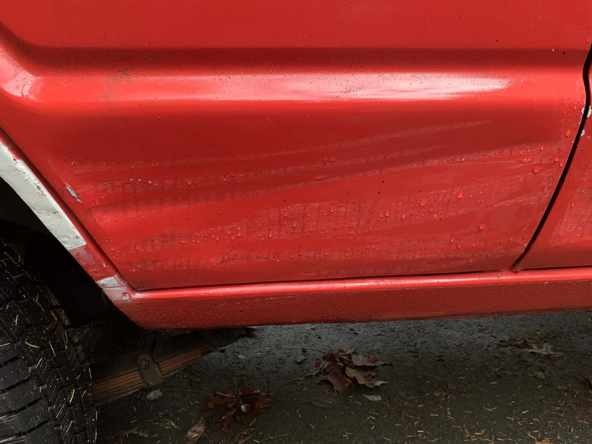

Lady crashed my truck with her lexus. Truck won but my doors are scrunched. Wondering if anyone has some doors?
Or is the front fixable? Maybe a dentless guy? The metal is so thin.
Advice about the rocker?
Thanks!

why replace? find an old school body man, turn 'im loose on it. i'm gonna say you'll be hard pressed to find something as rustfree as that seems to be. the rocker? a total non-issue in my world.
now you can wheel the truck, it's the first dent that hurts, after that it matters not :flipoff2:
You could remove the door cards at the interior and use a rubber mallet against the creased metal, then use a dead blow hammer technique to knock the metal out. Where the dent is near the door edge it will be more difficult as the inner skin of the door interferes; it could be driven out with a shaped piece of wood propped into that area. Old school auto body work could involve a dent puller on the rocker panel.
The metal at the rocker is thicker than the metal at the door.

I have a nasty blue truck for wheeling. This one is nice and I want it to stay that way.
I called all the recommended repair places and none will touch it, too old, not in system, etc, etc. They really want to repair lexus - its already getting fixed while I wait for callbacks and bad news.
I'm now asking for permission to find and go to a quality body shop that can use a hammer. Dentless repair place, etc.
Luckily car is drivable so time is on my side.
Your doors are perfect in my book! You should see what I had to deal with. I'd say any decent shop should be able to make those look like nothing happened.

Just food for thought. If you're wanting to keep your truck nice and pretty, I'd fix the doors you have as any replacements you find in the same color will likely not match perfectly and it will be obvious they've been replaced. On trucks this old, the fading and oxidation of the paint is rarely consistent between trucks.
