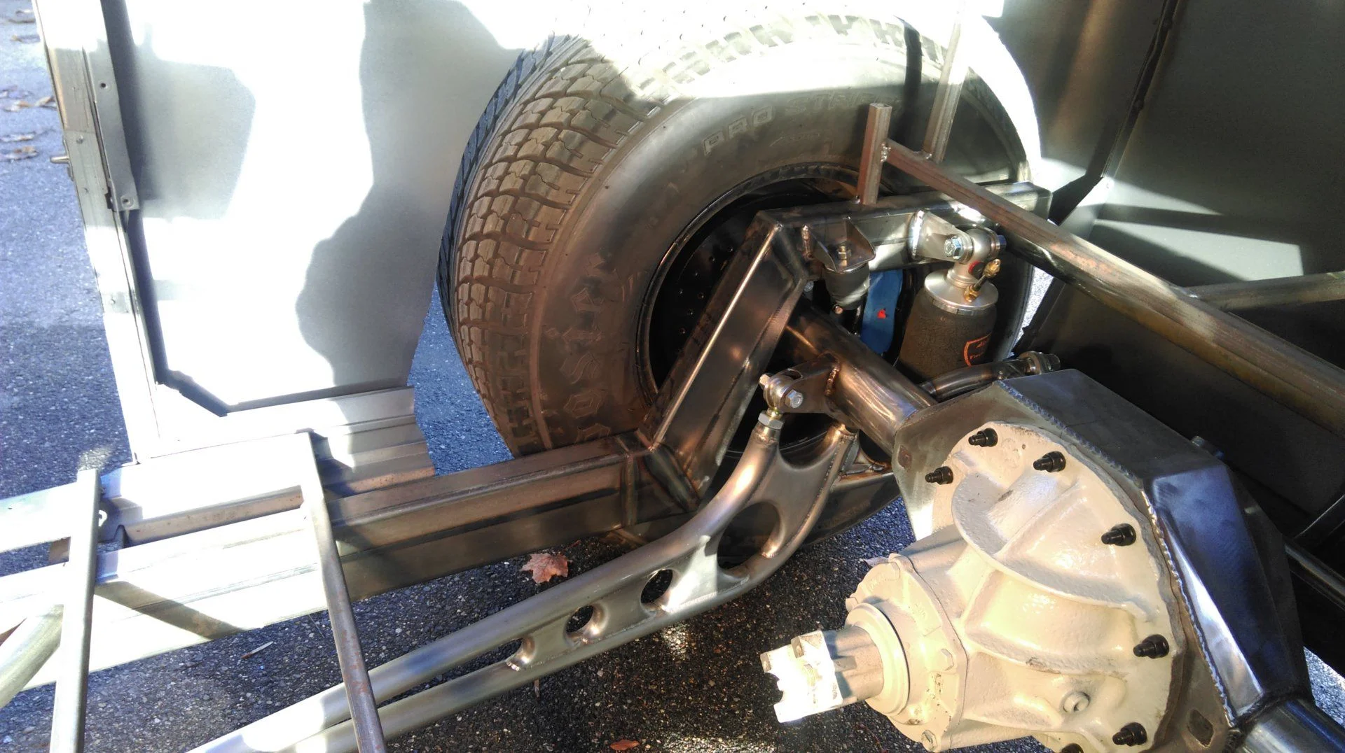

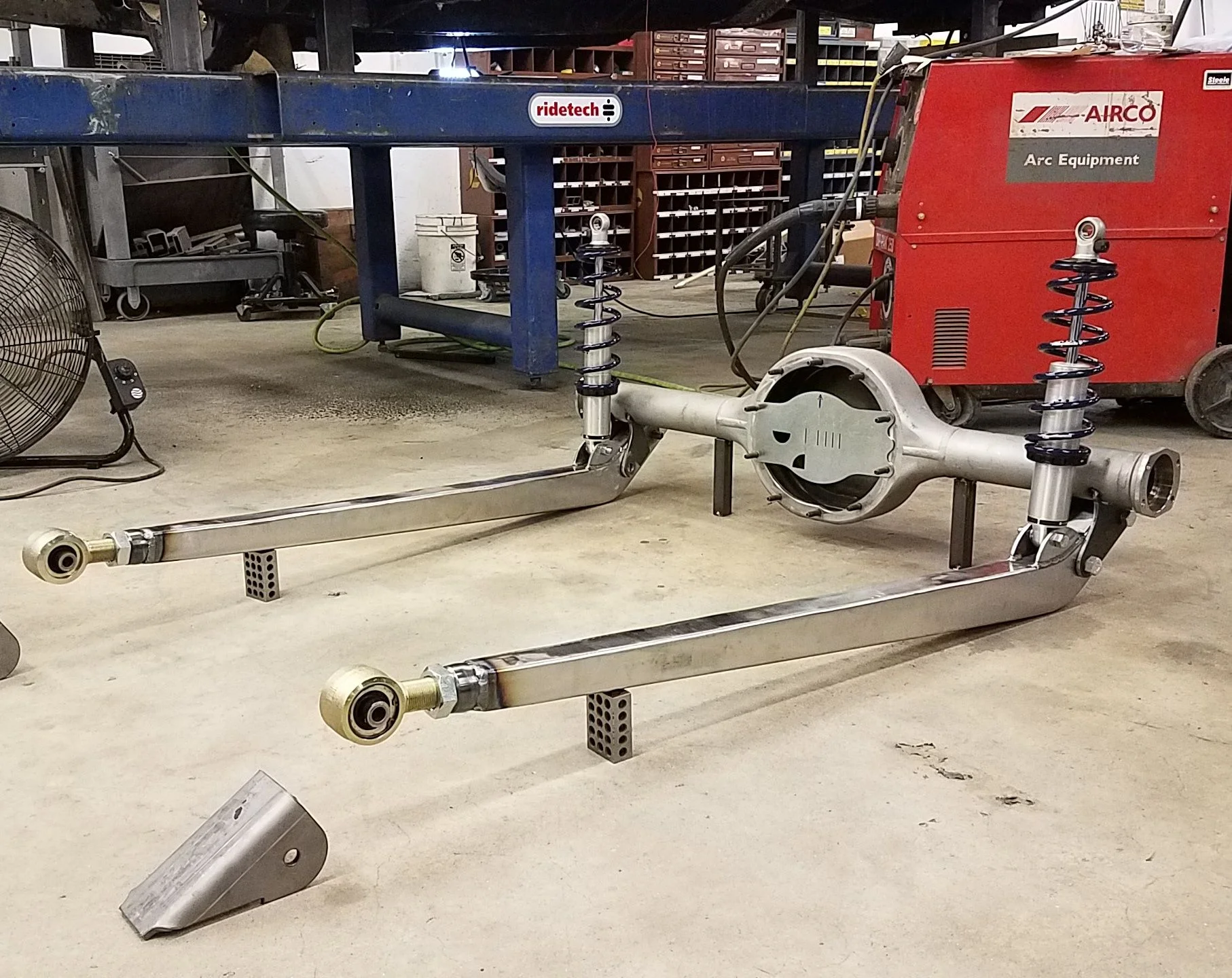

Here's some pictures of radius arms I have built in the past. I use the fact that the arm shape does not matter to my advantage, just like the OP intends to do. This gives me more floor clearance. A 1930s ford has this type of geometry front and rear. Also a 60-66 chevy truck uses rear radius arms.
Nice work!
