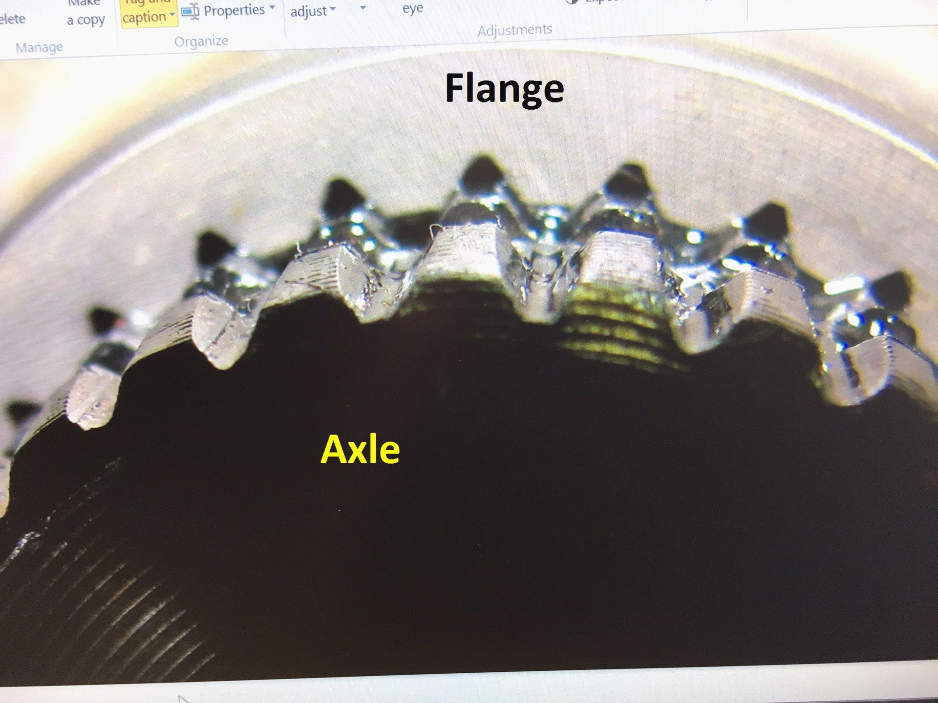

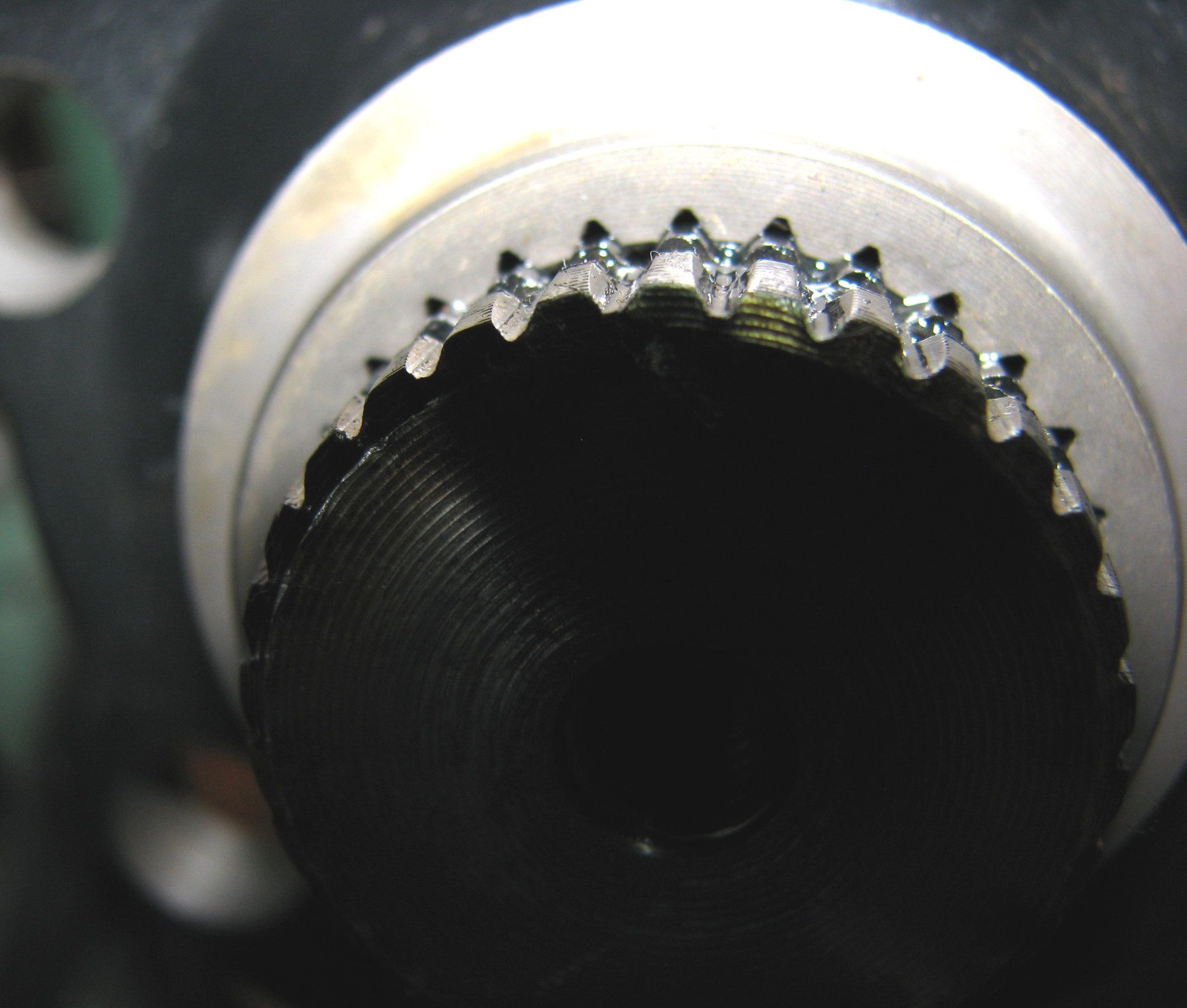

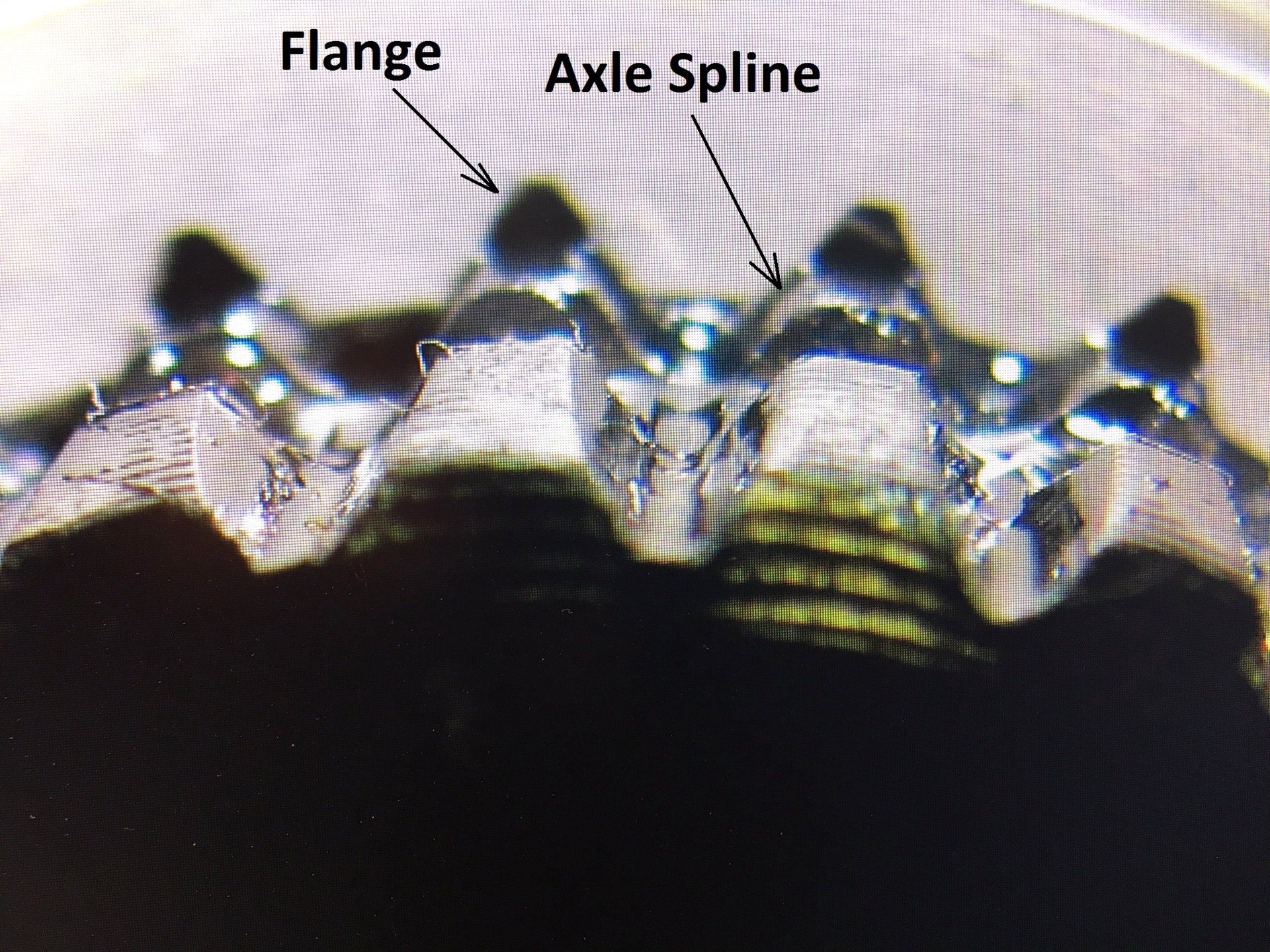

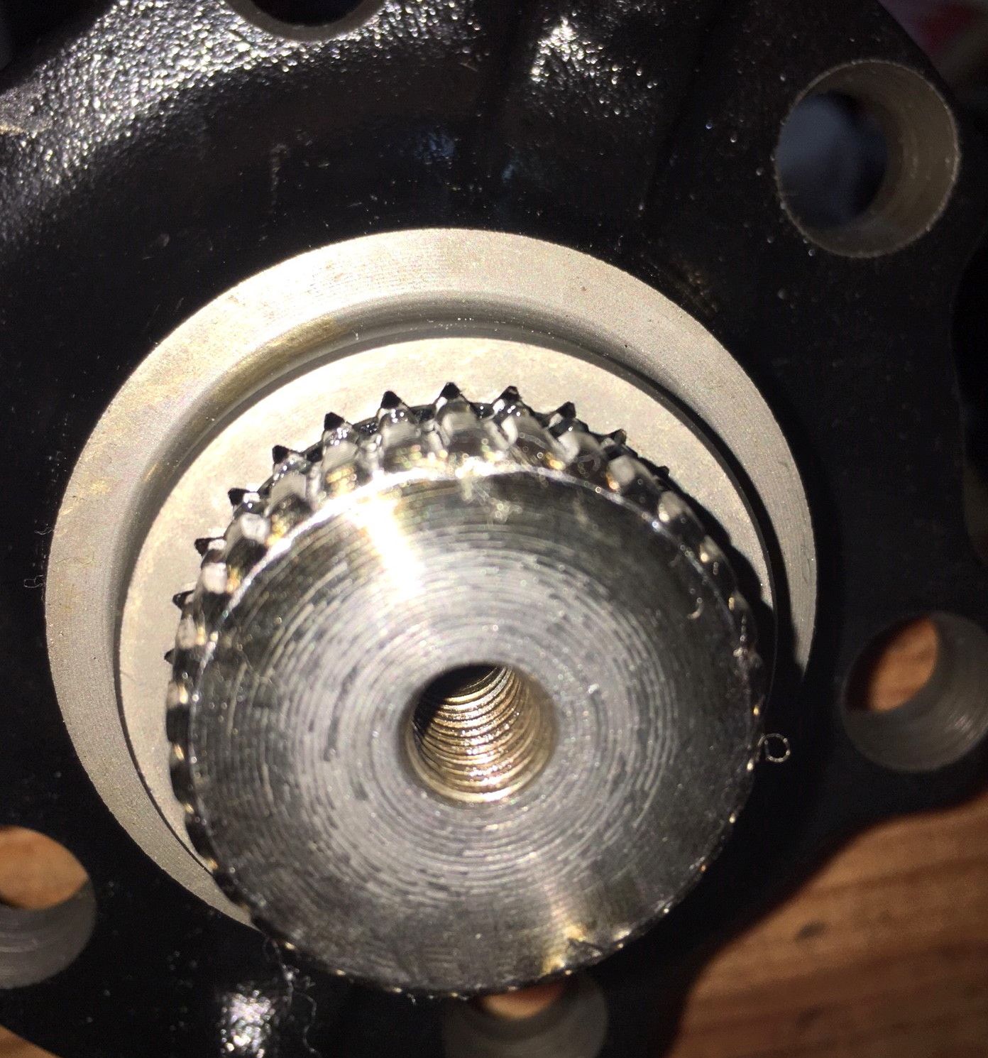

Cardone HD:
It's impossible to see how the splines fit the flange with a straight on end shot and it doesn't show the splines (the one's past the clip groove anyway). So...the best I can do, is shown below. The angle misrepresents the contact pattern a bit. But here they are (mine) for comparison.
The cuts in the Flange are triangular (easiest way to cut them), the axle splines are of course truncated and don't fully fill the area available.
