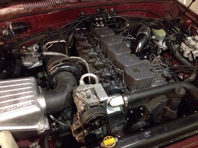

Hi guys, wanted to let you know I made it up to Diesel Adapters to meet Dustin and check out his shop on Thursday...
It was nice to meet and go over a few things you guys are talking about right now...
He showed me a lower profile intake horn he has just gotten that should fix the height concerns/issues
Also he had just gotten in the new air intake box... Looks nice (see pic)
So I guess I am about ready to take my FJ 80 out of commission and remove the engine and tranny. Dustin said he would need the torque converter and the wiring harness first.

Engine pic is of Fzj80 at diesel adapters... Other pic is my 1992

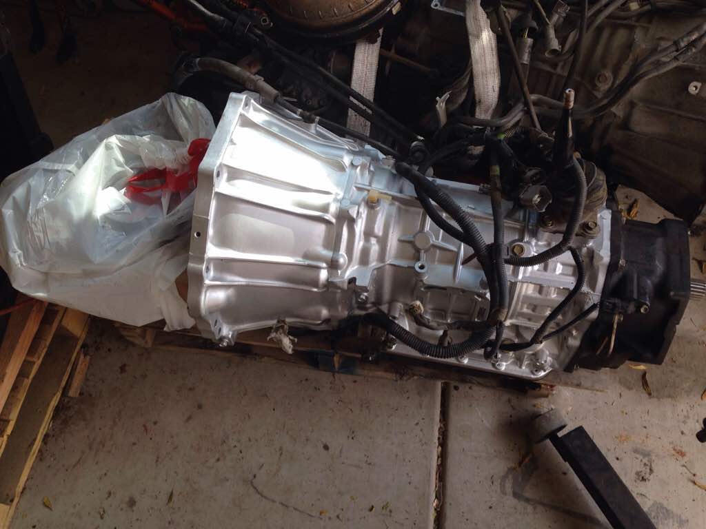

Thanks for the pics. One question why not use the 442 auto which has lockup? Seemed to be good enough to run behind the 1hz Toyota diesel. I just had one built for a friends Cummins swap we are going to be doing.
VB was upgraded and machined some parts to add more clutches. TC was rebuilt and added a lower stall.

Good point I think the 442 would be an excellent choice. I don't know enough about it to know for sure the electronic tuning that can be done to it as far as controlling shift points (again, if you would really even need to is an unknown for me) I ended up with a low mileage 343 out of a 95 & the 343's are a lot more common, at least in my neck of the woods... With the 343 I know you can control it with the Compushift programmer.
I believe the 442's only came in the last few months of the '92 model through mid '93 or maybe the end of '93?? I think a 442 is basically a 440 with some electronics incorporated??
So for us owners of a 91 or 92 with the 440 we would need to be looking for the 442 or 343 if we want to be able to change shift points... is my best understanding...
Thanks for chiming in & any input you have is appreciated :)
Compushift also has a controller for the a442 also. I personally think the a343 will hold up to a stock 6bt but not one pushing some decent power. Now some will chime in and say "well I'm running 600hp through one". I believe them, but that peak power is more then likely hitting at high rpms versus the Cummins lays it down on the bottom end. So that is why vb kits, boosting line pressure and having a good torque converter is key to your trans holding up.

And you'd trust a trans more that came behind a 1fz vs a diesel? I'm not saying the a343 is a bad trans I just personally think the a442 is built beefier. What trans are you running?

The A343F Toyota trans will hold the stock Cummins 440ft/lbs with just a shift kit, but if you really want to start turning the Cummins up the toyota trans is going to have a lot of issues and there really is nothing to "build" with the toyota trans, there are no built inputs or baskets, about the only thing I could find was a slight bump in clutch material. I would think with the firmest shift kit you are pretty good at 600-650ft/lbs all day. I have 680ft/lbs peak around 505 all wheel, and I have had no issues with the trans, knock on wood.
