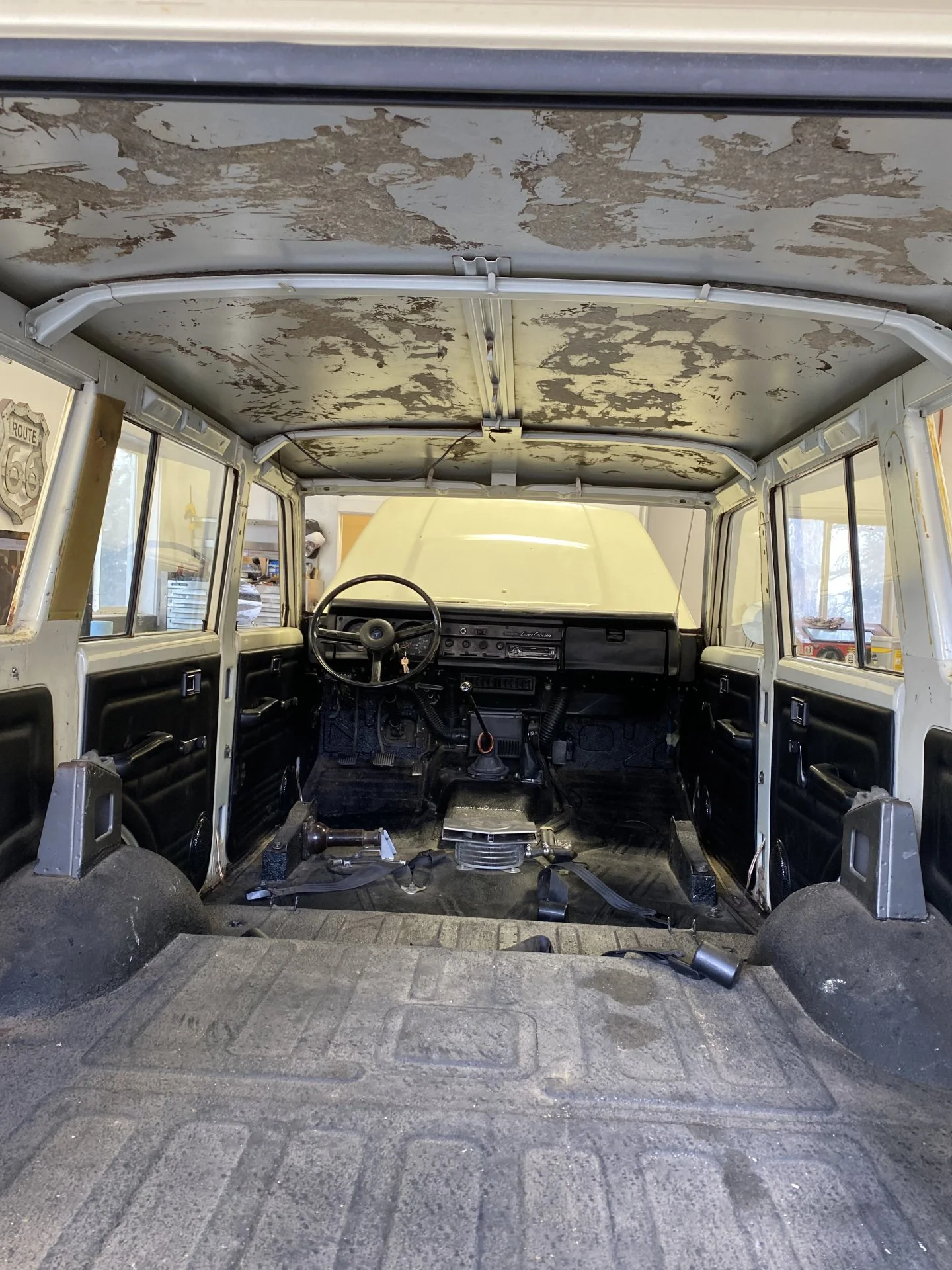

Body… track down rust… I won’t be pulling the body, but I’ll do my best. Roof looks great, other areas not so much, A-pillars probably the worst.
Need to find a product to paint over my Herculiner to allow a n 031 or 033 tinted Monstaliner to be applied over the top. Will be painting factory two tone green and white, with my favorite single stage MTK.
Things needed — good A pillar patch. Although I can build and patch the compound bends in the A-pillar make it difficult and time consuming to build which is why I’d like to find a good patch panel.
