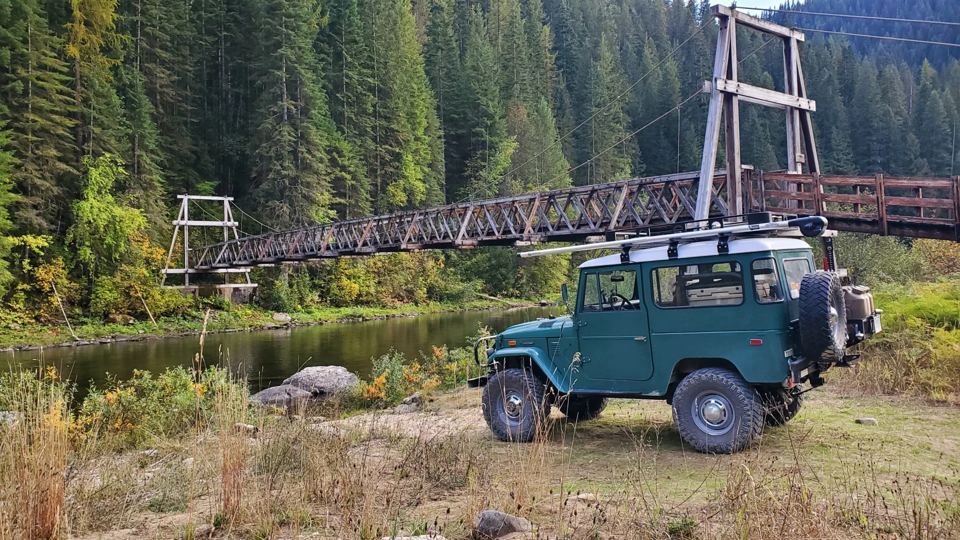

Where's the rod vault?
Right there.
Loaded with a 6wt streamer rod, and a 5wt rigged up for dry flies!

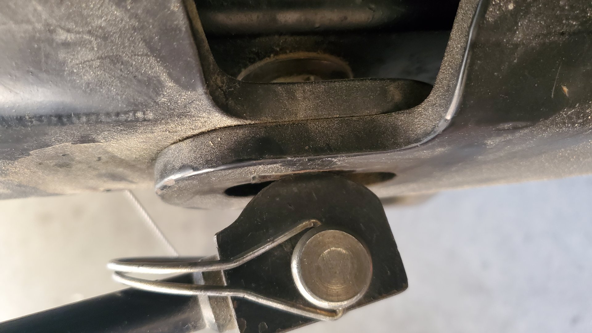

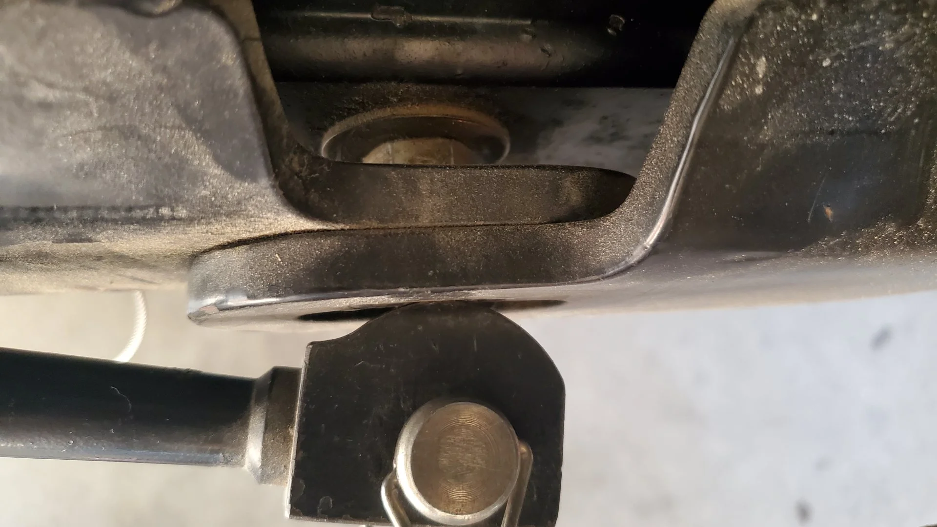

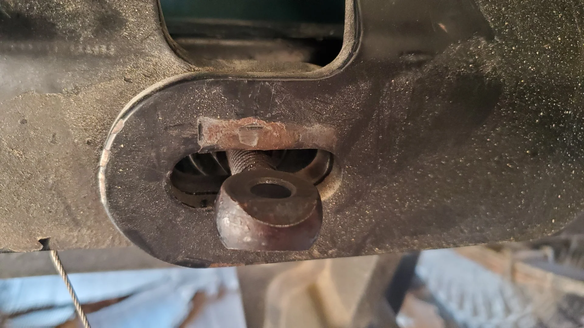

I had the lever on the 4plus rack come unlatched a few times while I was out, after hammering big holes in the road, vehicles of lesser quality would have been left for dead.
Gave the eye bolt a half turn tighter. I'll keep an eye on it for a while, hopefully It locks in on the flat spot not. Or maybe I will grind a flat spot.

I've had to adjust mine once (since 2010?) also.
It's weird, I noticed that it got a whole heck of a lot easier to cam over after I shot some stuff with Fluid Film, I thought it would go away after the stuff wore off.
Guess I was wrong.
