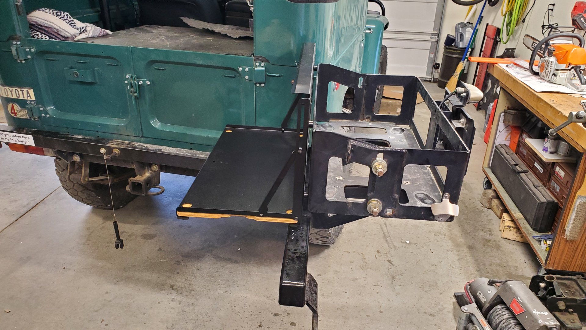

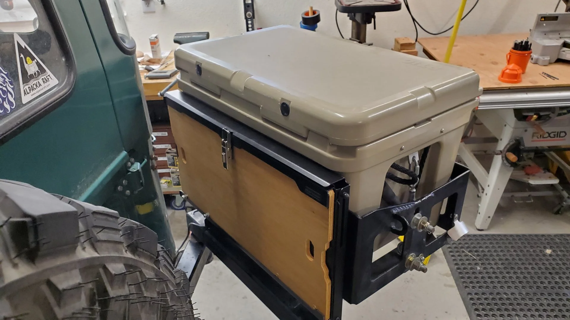

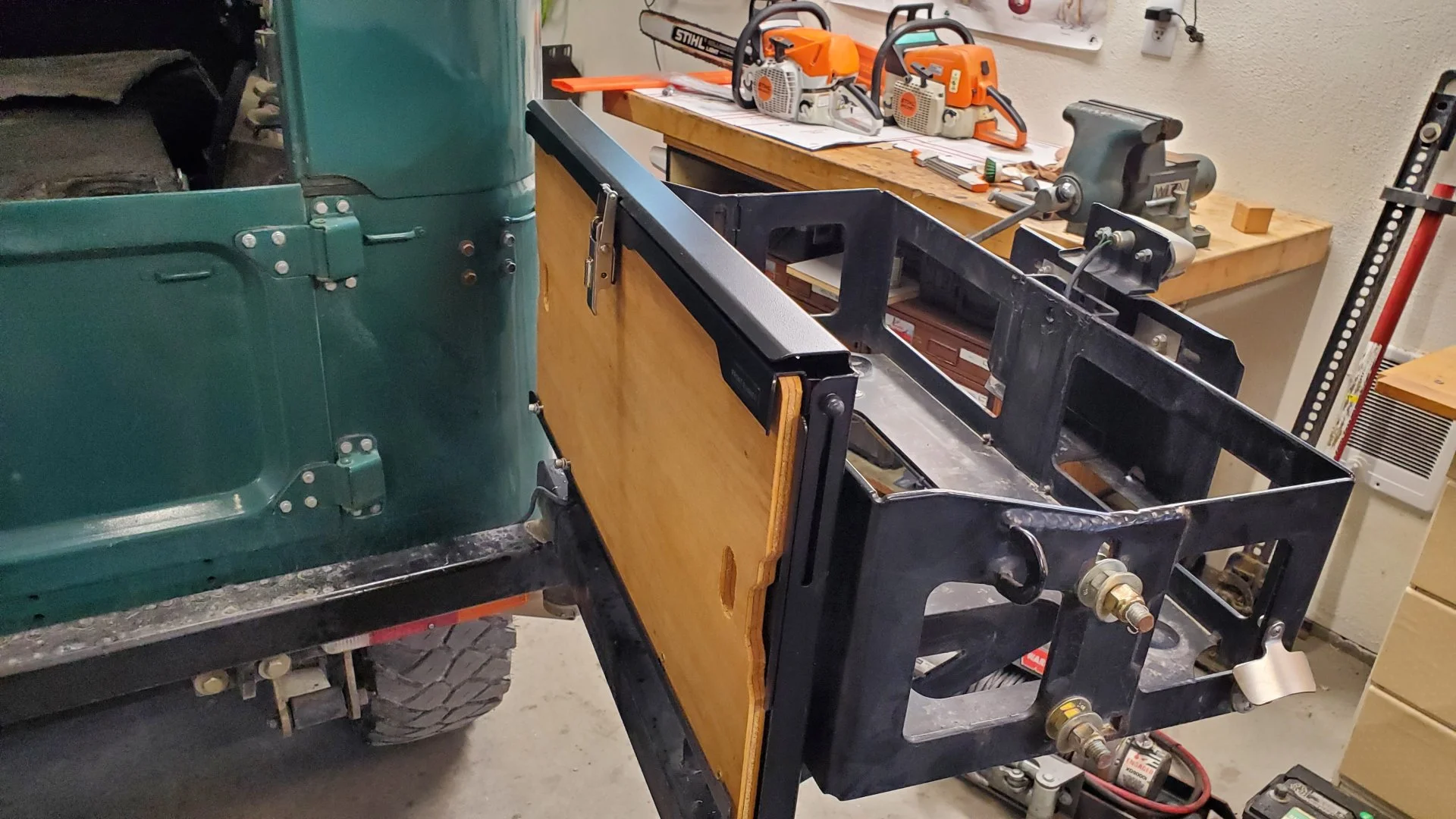

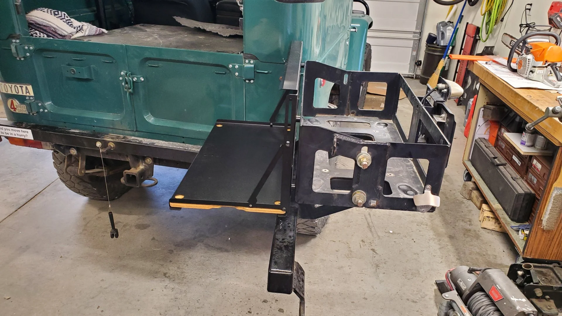

There are a couple of close clearances with my setup, a little drilling, tapping, some spacers, and 242 blue and it's installed.

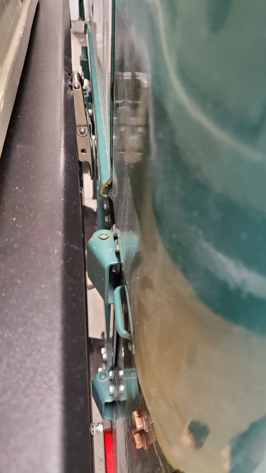

The clearance between the rear hatch lip and the latch on the fold down table is close.
I'll keep an eye on this spot.
I'm positive it will turn into a major dust collector driving down forest service roads in the summer.
That is very cool!
Dust is ok, just keeps 16 oz PBR’s from sliding off the table on an incline!!
If you don't mind sharing... about how much clearance do you recommend between your roof rack and top? I assembled my Gamiviti clamps last night and was trial fitting it all while the top is still sitting on the shop floor. Before I did final tightening I wanted to inquire what sort of running clearance is best. Thanks!
Personally I would like to see at least 1/4" of clearance between the crossbars and roof, more if you carry anything heavy up top. One of mine has a slight bend in it and does touch just a fuzz sometimes.
Thank you very much. I haven't measured but I'd guess it's currently closer to 3/4" right now. I will probably leave it alone. I don't think I'll haul much more up there than a swag tent in it's bag and another soft bag or two with clothes/bulk. However, I made the decking out of some teak 1x4's, so that's probably 35 pounds of built-in weight.
