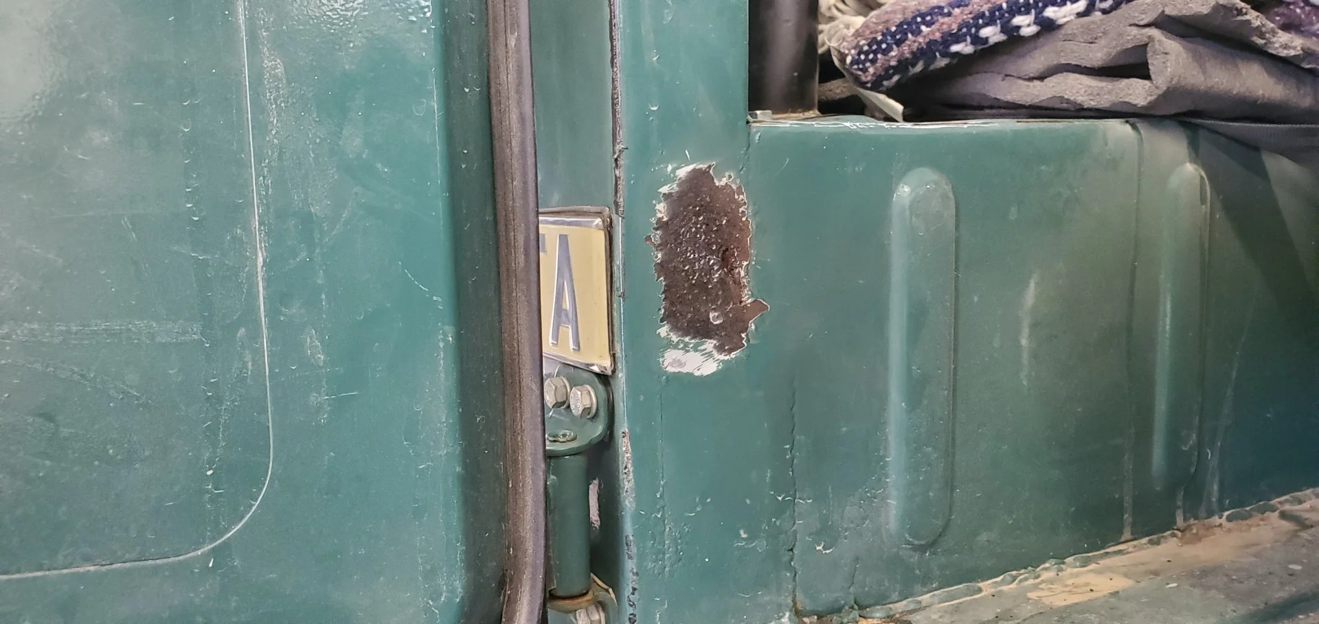

Ain't that a helluva deal.

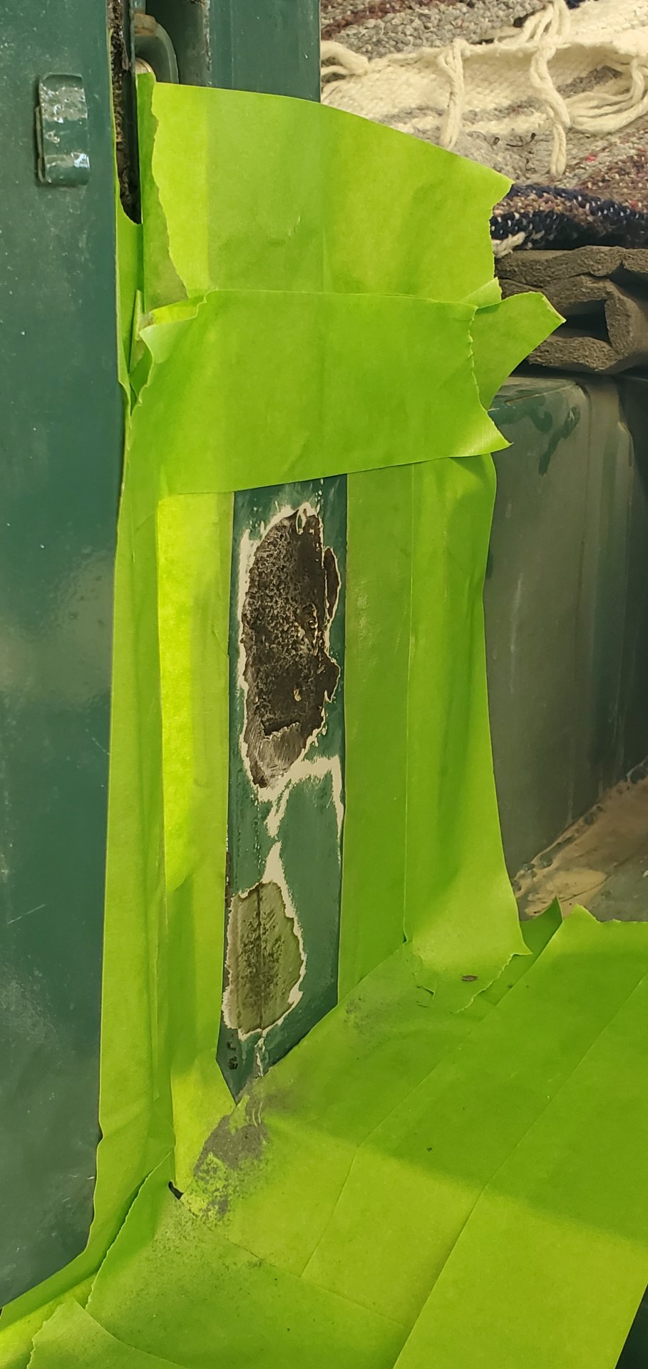

As usual, the more you dig, the more you find.
Good enough for now.
I sanded, wire wheeled down to se bare metal, shot some rust converter around in the areas I could not clean, primed, lathered some body filler in a small hole, primed again, and again.
I'll probably top coat with something simple from a rattle can soon.

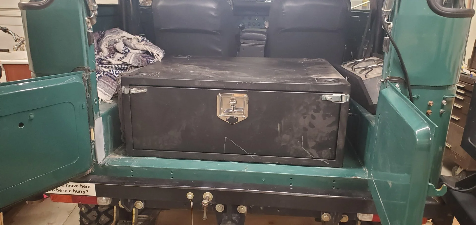

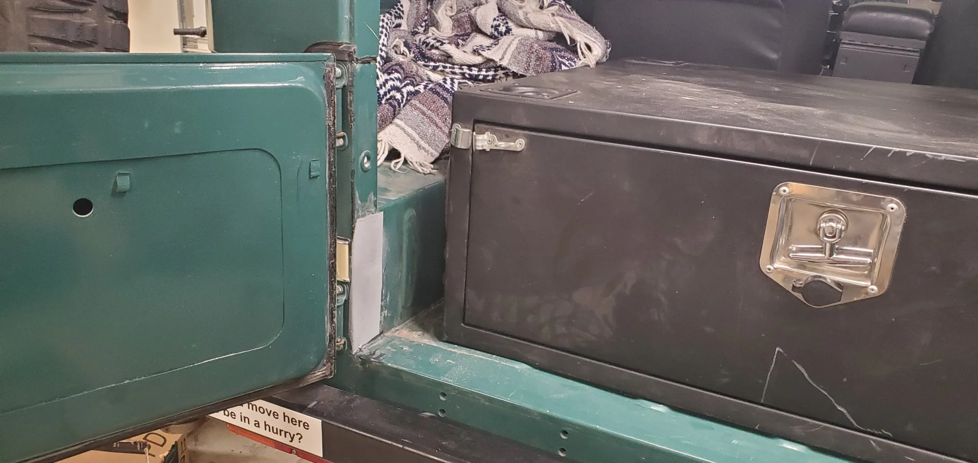

The rear seat came out today and a box went in its place.
Just in time to load it full of gear for tomorrow.
