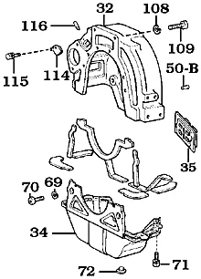

From the factory, there was a rubber plug in that hole (it came with the seal kit). I just cover mine with piece of duct tape. Sor sells a plug for $5, but I'm sure you can find one at any local Auto Parts Help display
#72
#72
I was going to get a small rubber stopper at Ace but tape sounds good too. Cheers

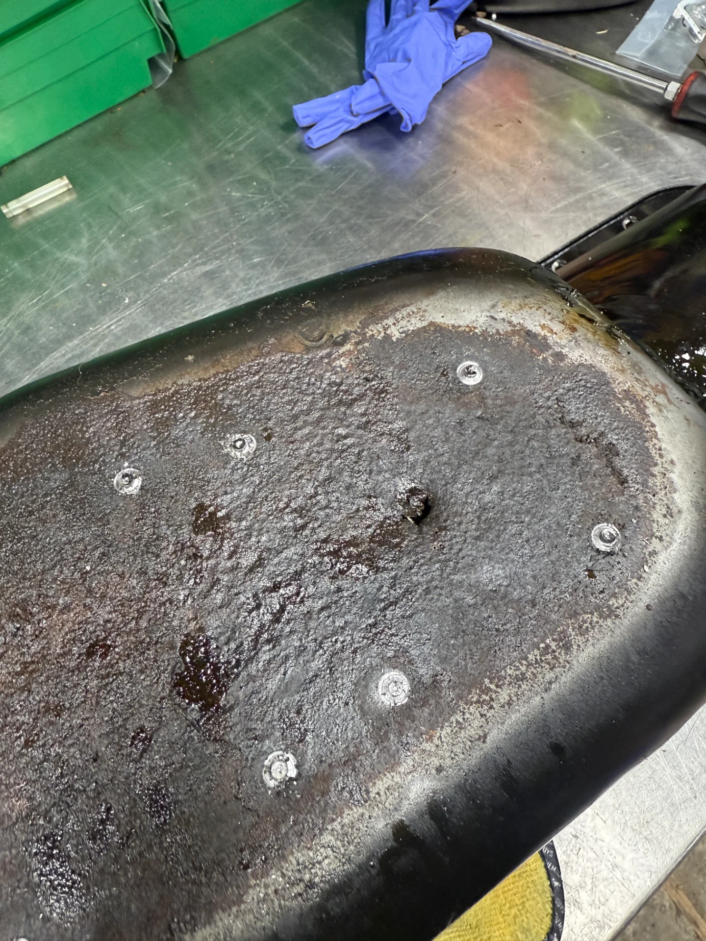

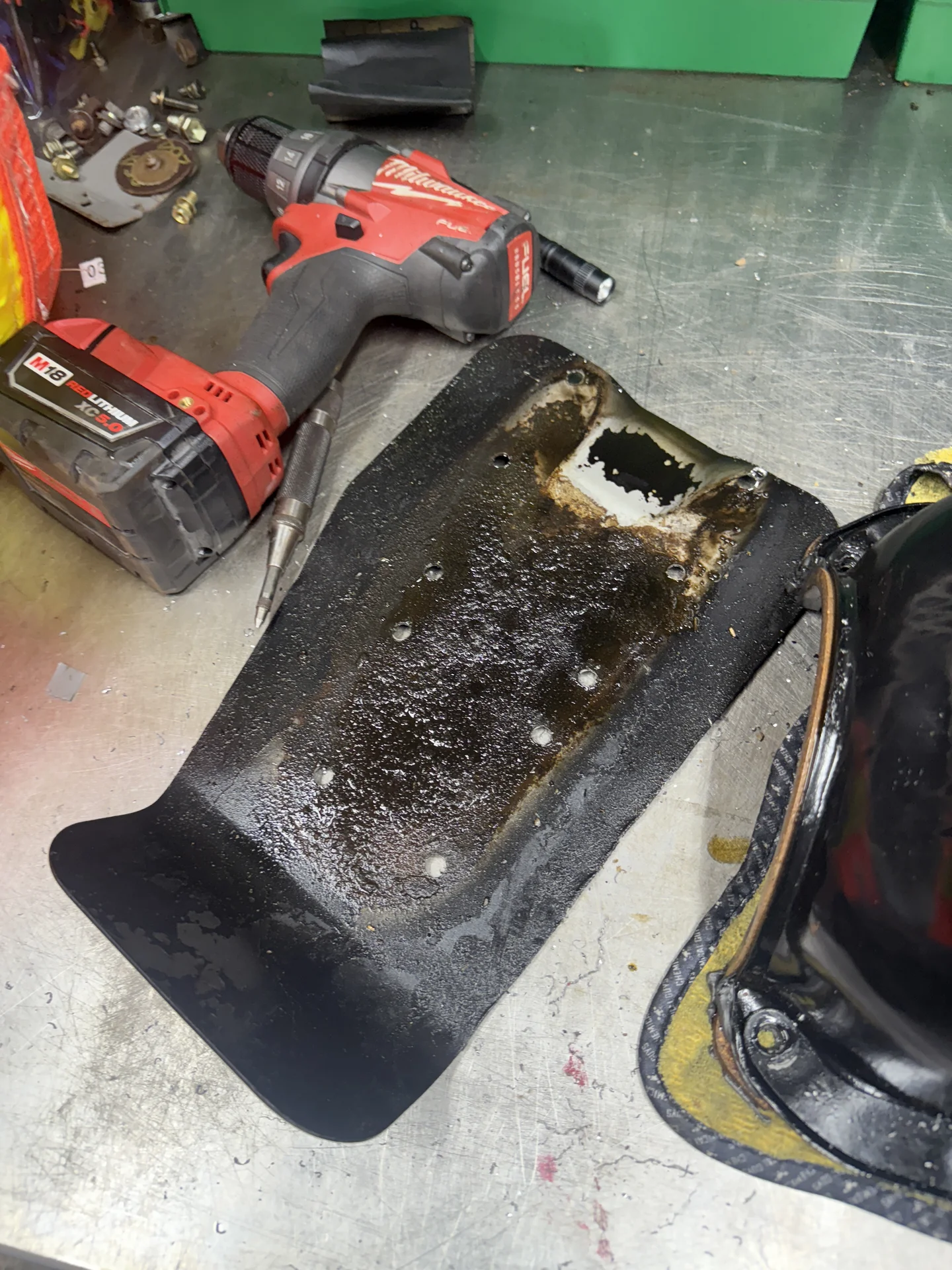

I had a leak that looked very similar to this. I swore it was an oil pan gasket or drain plug gasket but it persisted after replacing both. I finally said to hell with it and bought a new oil pan. Curiosity got the best of me and I needed to know what caused the leak. After drilling out the spot welds and removing that skid plate on the bottom of the pan I discovered exactly what my problem was. Rust had corroded its way through the pan under the plate. From the inside, it looked fine. However i literally stuck a screwdriver through the pan from the outside.
Take off that flywheel cover and see if there is oil inside it and coming down the back of the pan. If it’s dry, then your pan is likely porous.
Take off that flywheel cover and see if there is oil inside it and coming down the back of the pan. If it’s dry, then your pan is likely porous.View attachment 4165059View attachment 4165061View attachment 4165062
Holy cow. Good point. I will add that to my list. Thanks for sharing this
