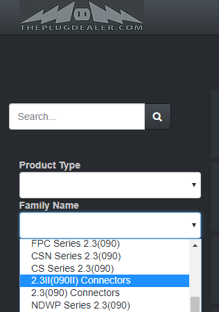

I found this thread while searching for related stuff and thought I'd add to it.
The connectors used on the 80-series seem to be Yazaki 090-ii. On ThePlugDealer.com, select "2.3II(090II) Connectors" from the "Family Name" drop down. They list all of them as out-of-stock. Maybe they're not worth stocking, or maybe their store is just broken.
Eastern Beaver also sells 090 connectors:
090 Connectors
