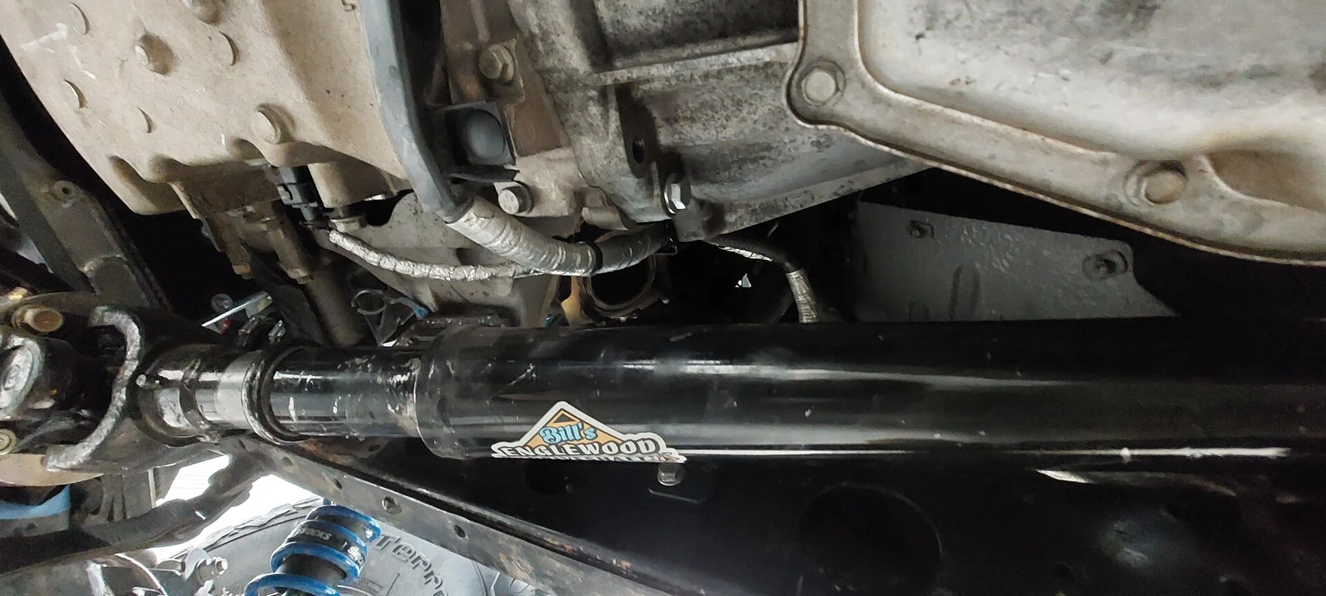

Here are a few pictures of my setup. My diff gets within an inch of the crank pulley. Your setup will most likely be completely different.

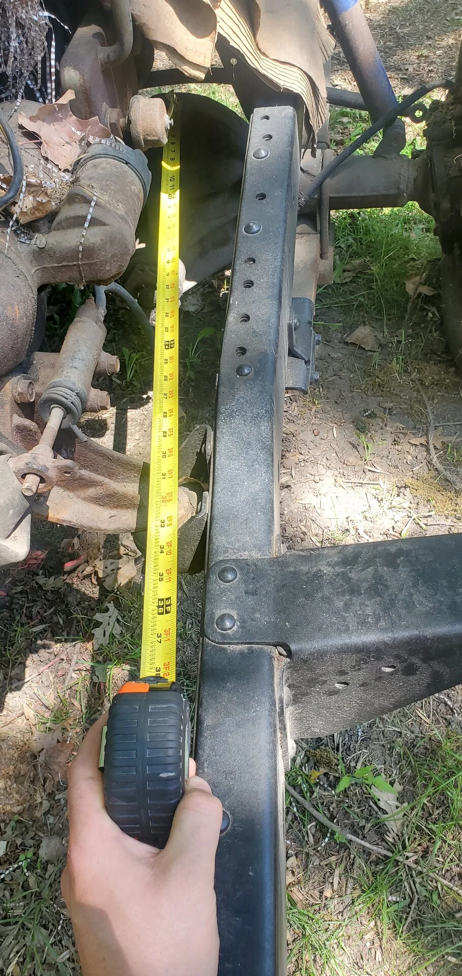

Doing some measurements on my other frame that has an engine on it still. Wish I had done this before selling the trans Saturday... Oh well, I'll be picking up my short shaft 60 h42 in a few weeks and will check things again before doing anything permanent. Either way, with the high pinion 80 front I will need to delete the passenger side bellhousing mount for driveshafts clearance. For reference, my quick measurements had the 80 flange about 3/4" further out than the 40. The clearance already looked pretty tight, but there isn't much up travel on a stock 40 to begin with. Looks to be plenty of room for a top link, but driveshaft clearance will be tight at the mount. Based on other's measurements the top link will end up about where the bellhousing mount bracket is. Tcase flange will be at about the second frame rivet back from the body mount with the black box.
