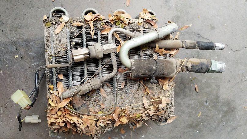

I had to replace my evaporator.
well that is gross

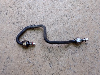

Be very careful removing the short line from the drier to the condenser part# 88716-89138, it only came on the 84-89 4runner and is no longer available
Makes me wish I had harvested all the hard lines when we had trucks at the boneyard.
Suggestion. Don't use open end wrenches on those nuts. Use flare nut wrenches.
