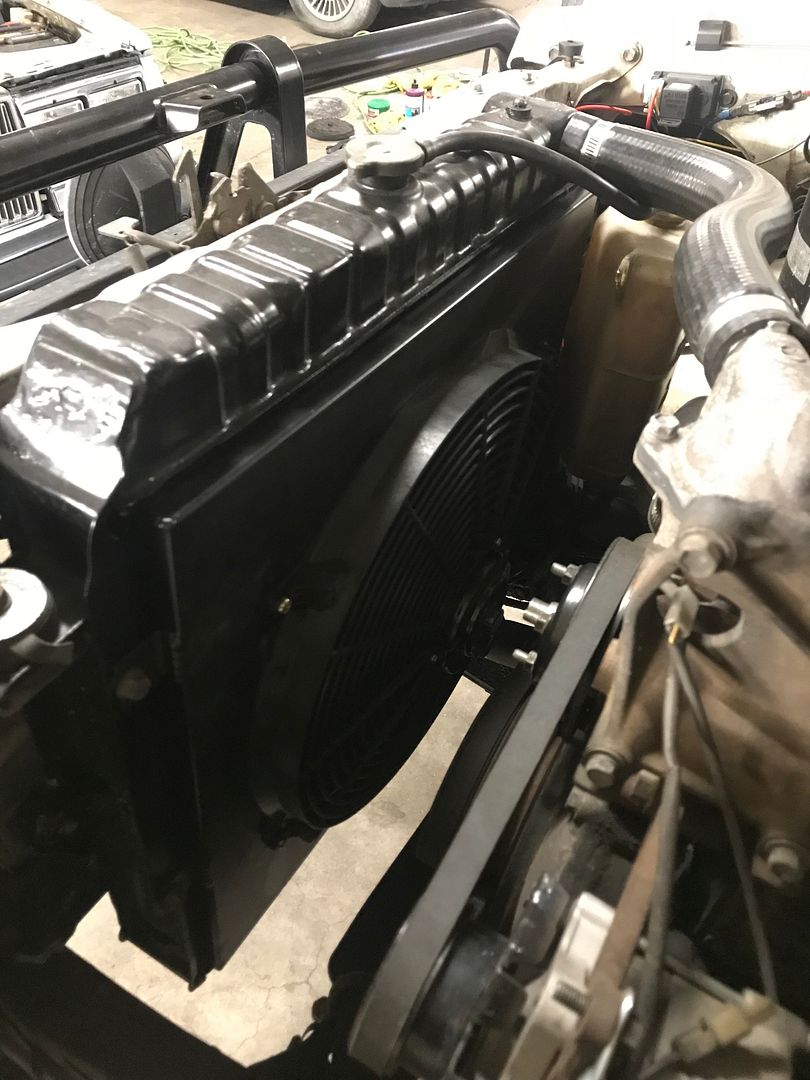

Out of boredom, I thought I'd be wise and get an electric fan. The cleaner the engine bay, the better in my eyes. I once completely shaved an http://www.stanceworks.com/wp-content/uploads/2012/12/GOOLLLLLLDDDD.png engine bay because I was 18. (also had no taste, hence Gold/Teal combo)
Anyway, here is the electric fan installed. I paired it with a Summit racing adjustable temp sensor and switch that I could program to switch on at just the right temperature along with an overdrive if I saw a bigol' hill coming up or something. Looks great huh?!
It seemed to work good. Worked great the first few weeks of commuting (short, city commute). Then I took it on the highway, noticed it got hot. Took it up a hill, also got hot. Mmhm, strange. What do I do? I definitely don't come to my senses yet - of course not, I am determined. Instead, I add another fan where the AC condenser used to be; Double fans! Surely enough right? NO. Weeks (okay a few hours spread out over the course of a few weeks) of dicking around with this and I finally put the OEM clutch fan back on. Guess what? COOLS PERFECTLY, RUNS PERFECTLY, DOES NOT OVERHEAT IN ANY SITUATION.

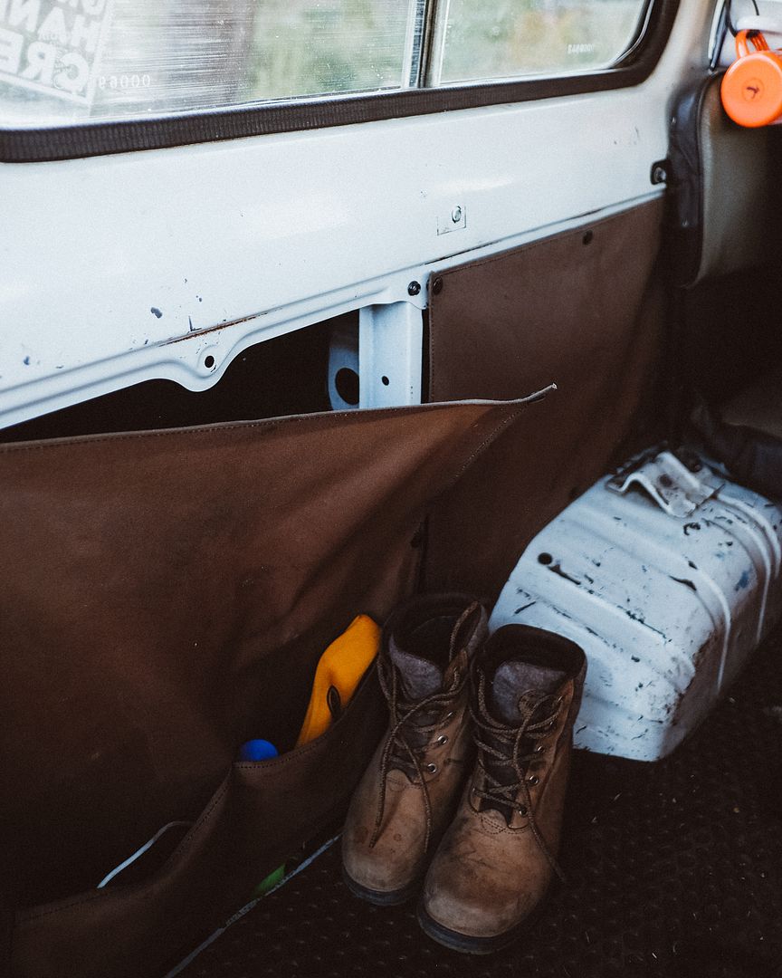

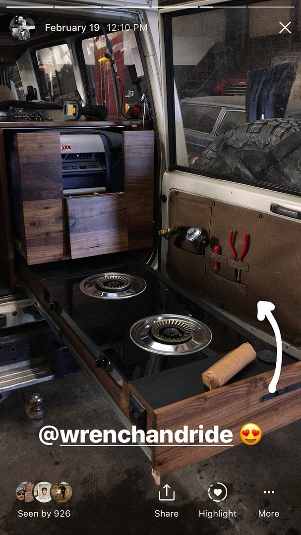

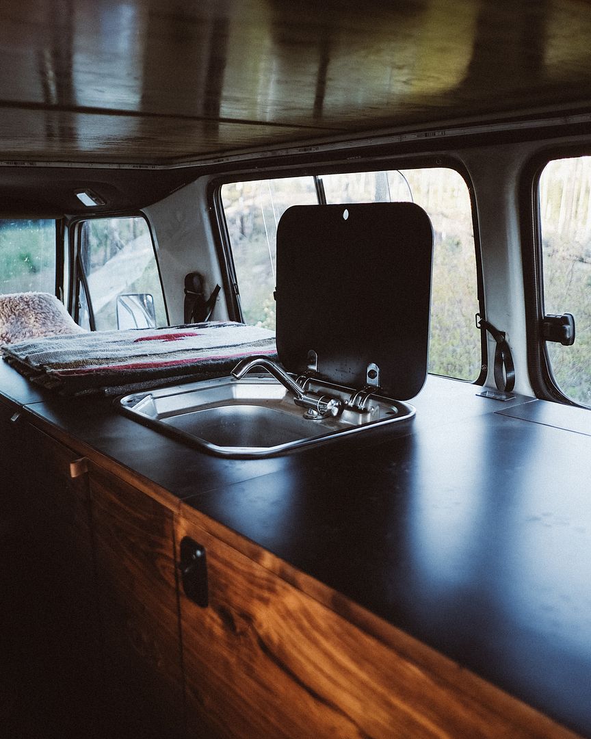

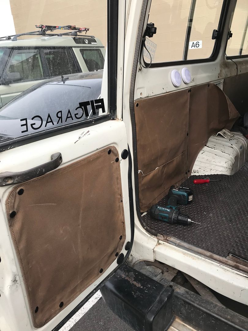

My friend sewed me up some panels for the sides of the rear. These are INCREDIBLY useful. Made of 16oz waxed duck canvas, they are durable and should patina well. They are attached with snap buttons so they can be popped off easily and you can store things behind them. All of this wasted space is finally utilized. Also he added pockets and such. I am stoked!

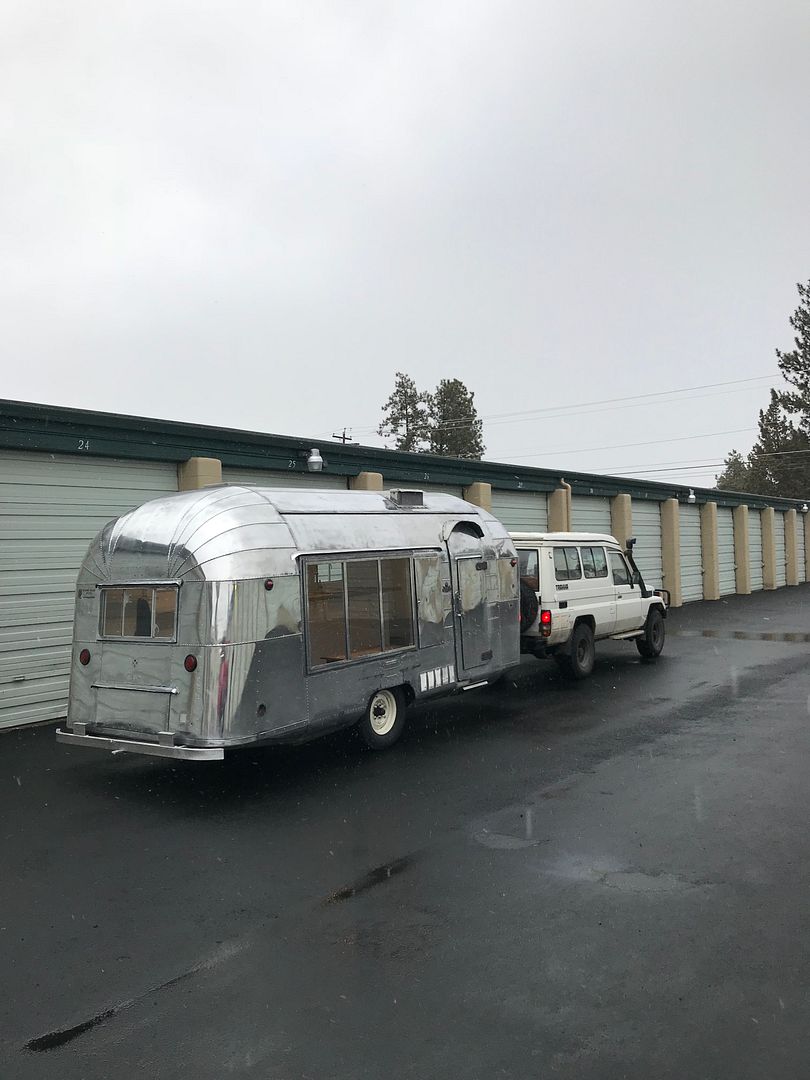

What else happened? My wife and I finished her plant trailer? It's a mobile nursery/plant store. I towed it with the 70. That was really cool.
It's been doing really well. Who knew?! Apparently people (IE girls) will pay big bucks for succulents and cacti. No Ferrari yet though.

I have built some v8 Cruisers and also had a super built up diesel. Electric fans don't work so good in my opinion, especially at speeds and under loads. This being retro fitted ones anyways, when the entire vehicle is engineered to run an electric fan they seem to work well. Fan shroud is also super important. When we built the diesel we looked at electric fans but after some testing, it was very obvious the stock mechanical fan and shroud pulled way more air, the only exception being at idle. So a pusher fan was installed on a switch for low speeds to compliment the mechanical fan, like off-roading. Mostly due to having a large front mount intercooler and wanting to keep lot's of air flowing at slow speeds and low rpms. It worked excellent for the intended purpose.

Lesson learned for sure! I left the outer the fan on just to be extra, so now I can have the best of both worlds!

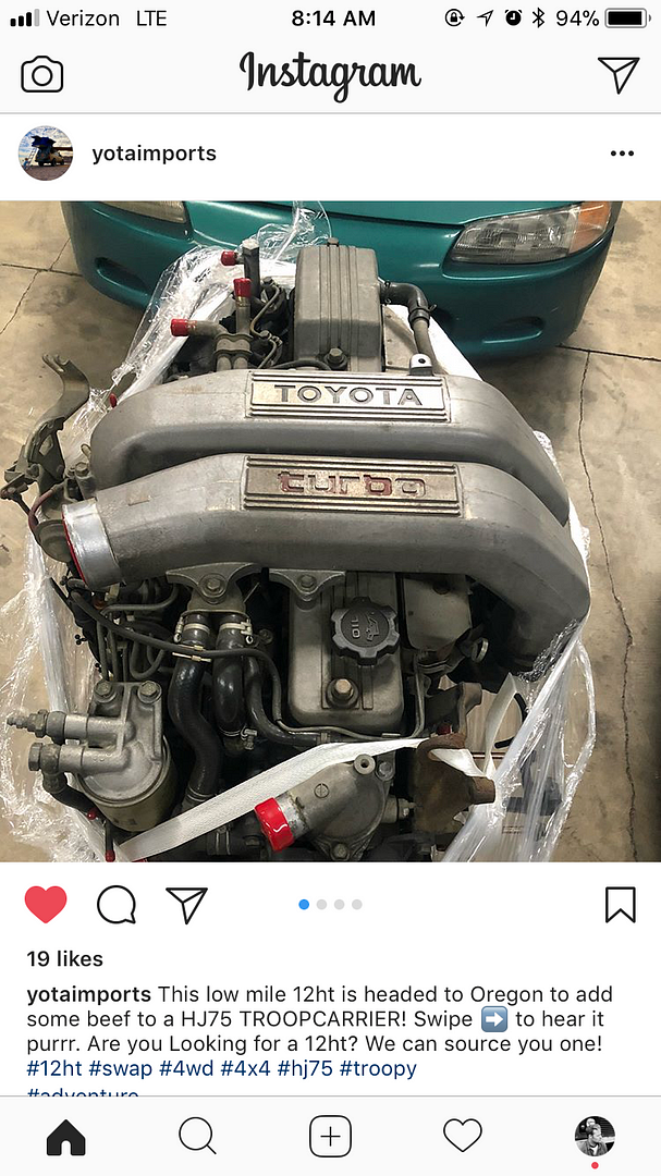

Camping over the Memorial Day holiday? We met last winter in Bend.

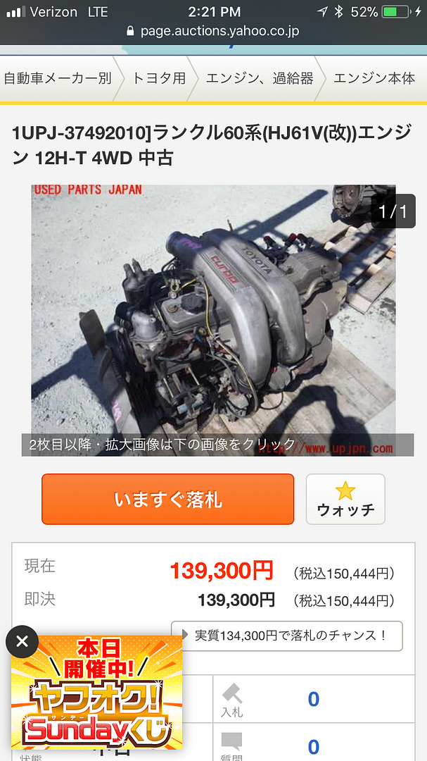

Engine is in the states and seems to be running well.
We'll see when it arrives at my shop. Take a couple weeks to refresh all the gaskets and seals then drop it in.

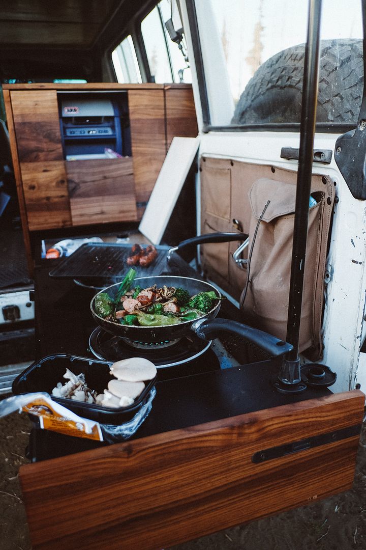

Got out camping a few times as well, managed to take some pictures of the interior in use. It's working great so far!

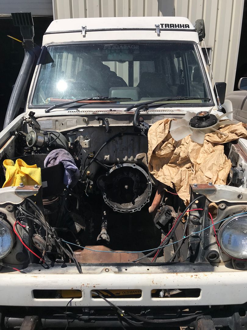

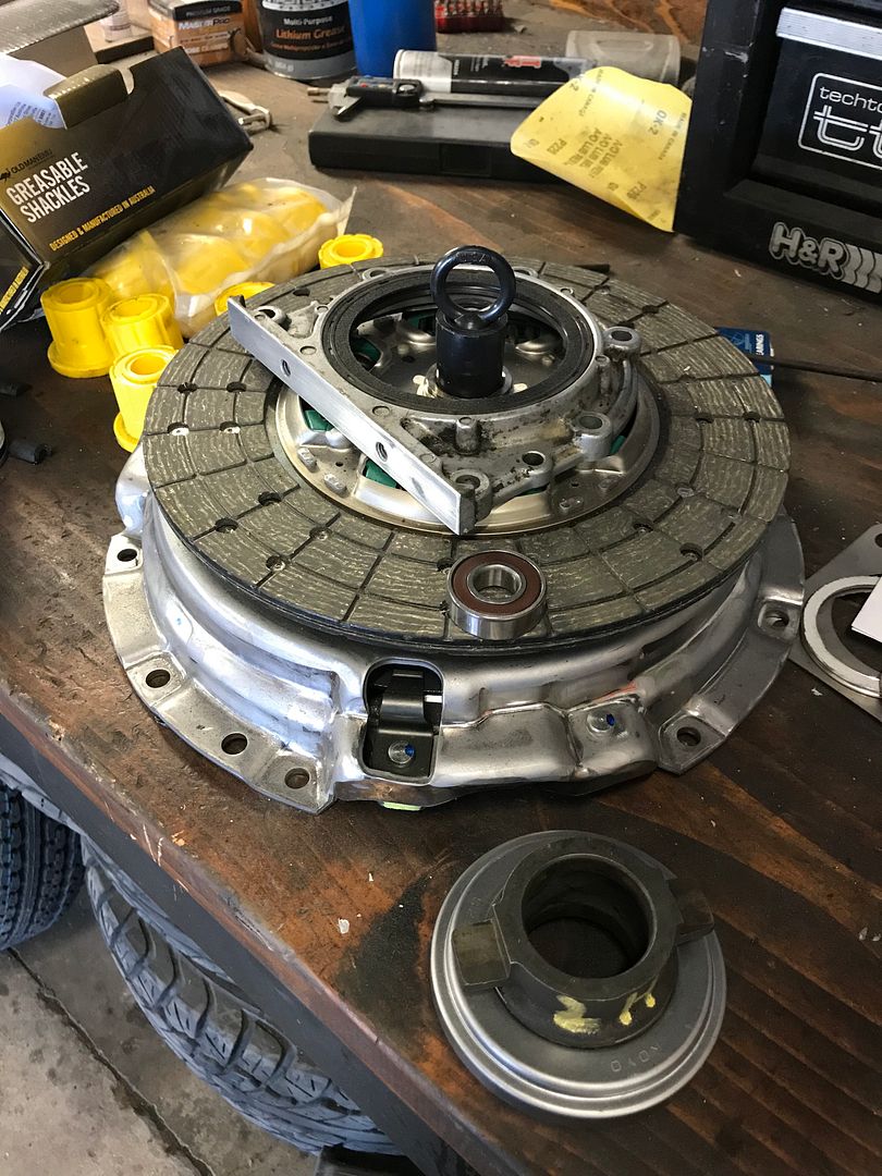

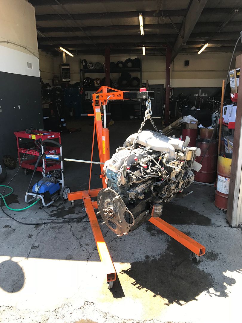

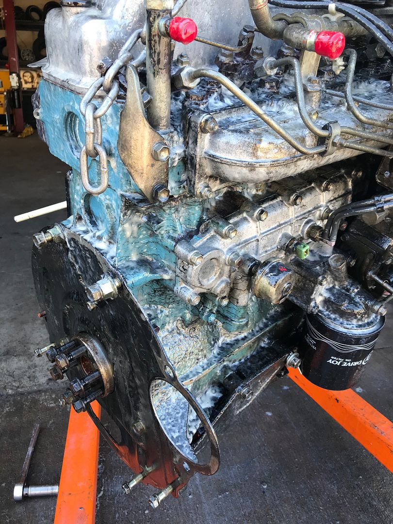

Engine Arrived and the teardown began. Was hoping to get it in within a couple days, but we know how that goes. Someone had recently replaced the clutch, pressure plate, etc with a Safari Tuff Exedy unit, which was awesome but unfortunately the throwout bearing was missing a clip so it was pushing sideways on the pressure plate(which explains the squeaky throwout bearing at idle). While waiting on the new clutch I replaced most all of the external gaskets and seals.

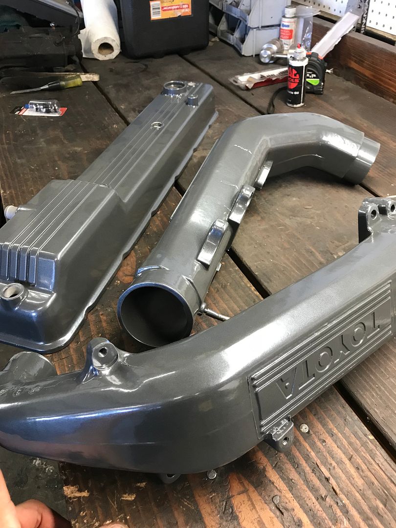

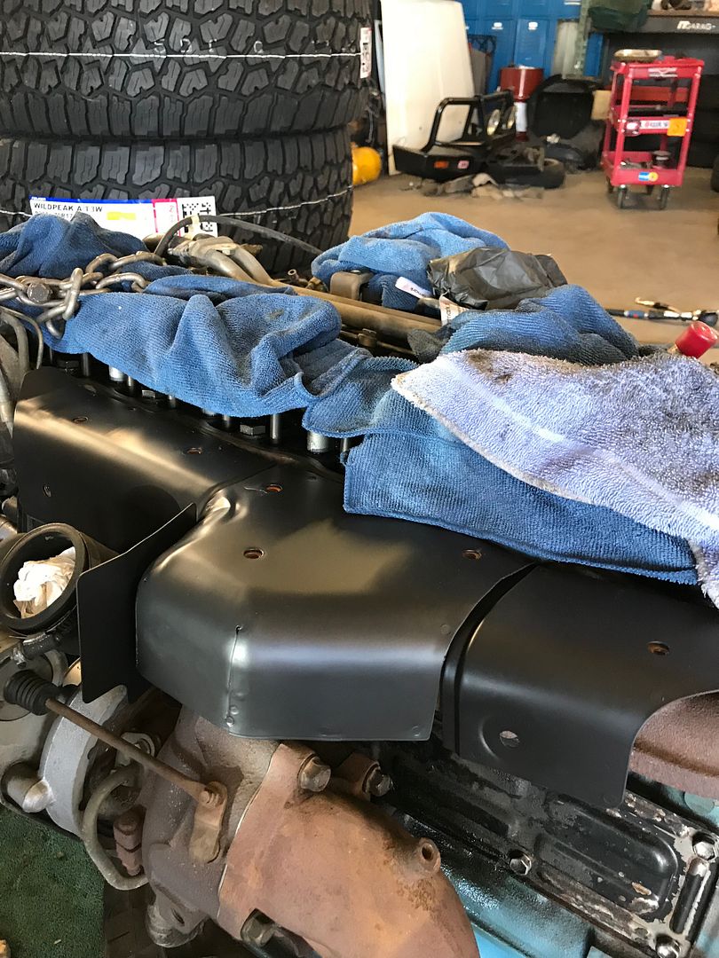

Powdercoated the valve cover and intake plenums along with a cerakote on the exhaust manifold shields.

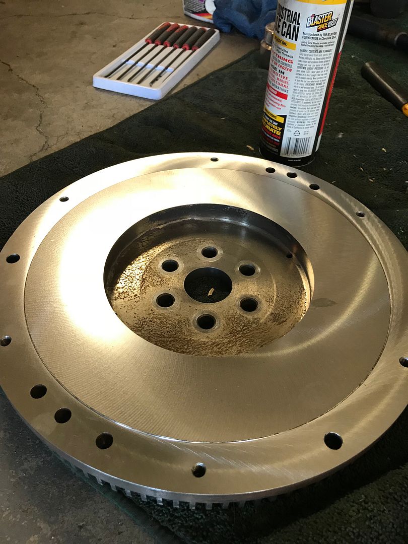

Flywheel resurfaced and new clutch kit. Hopefully it's as strong as the exedy that it's replacing.

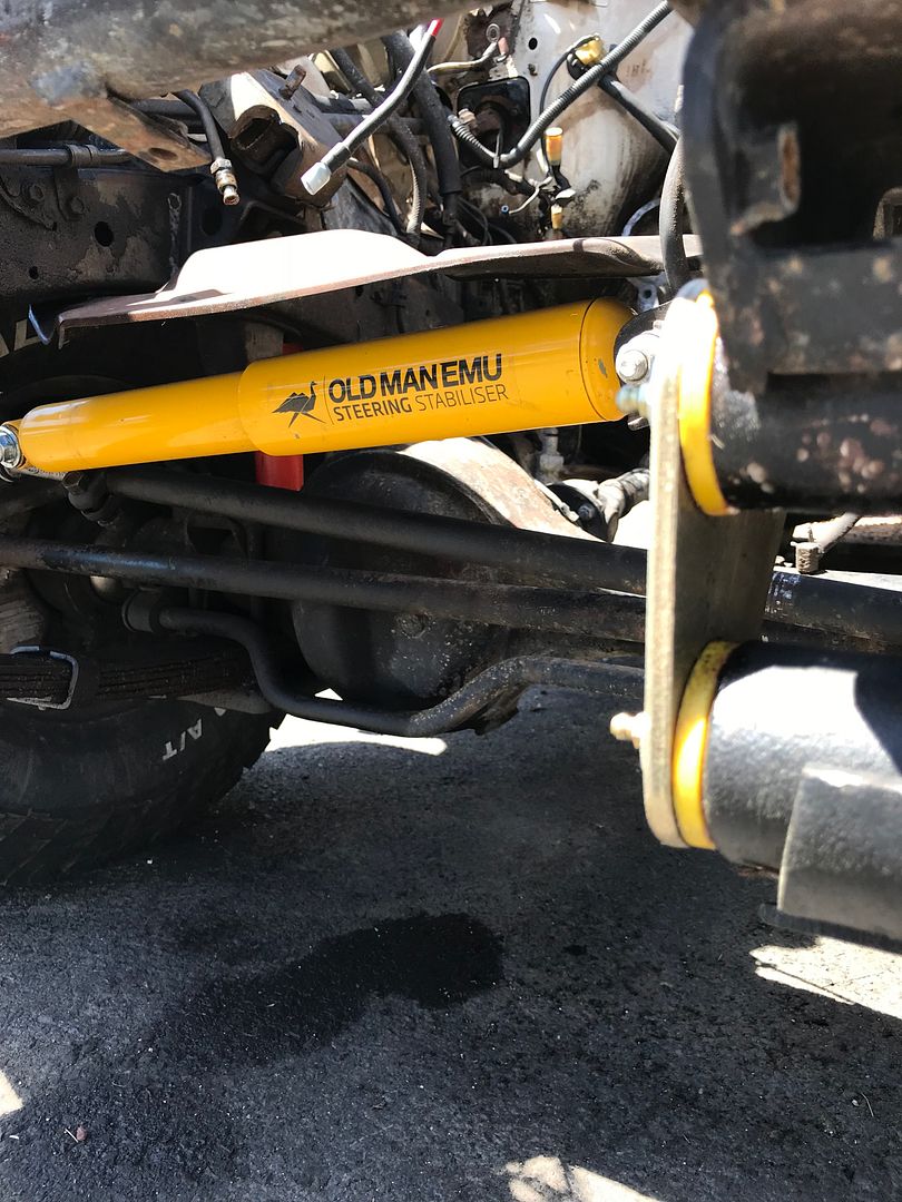

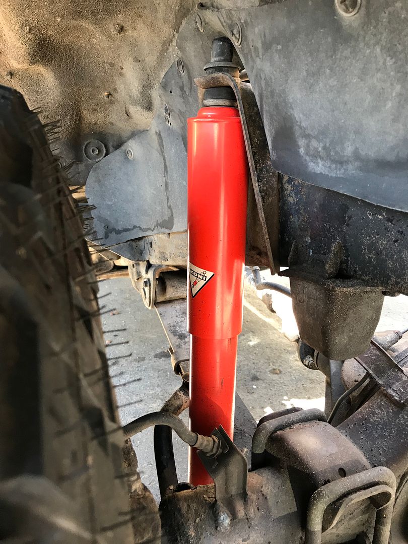

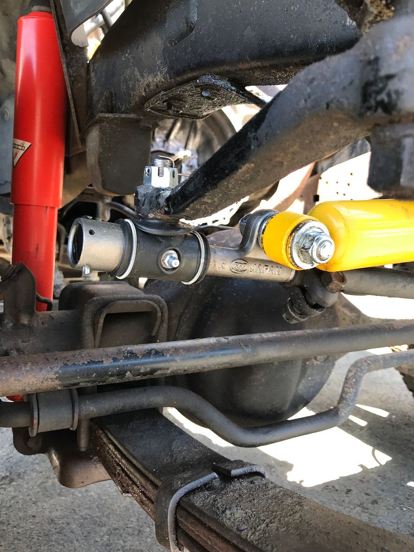

Then while waiting on parts I also did a few suspension upgrades including greaseable shackles and 555 steering links. Also degreased my shocks which actually look awesome! Vintage Konis! Stoked on those.

very slick interior, what a great idea on the canvas! what kind of light is this?
The 12ht will pull that trailer easy but remember 5th gear is a overdrive so any slight hill or headwind pull her back to 4th gear you will get a longer life from the gearbox doing this.
Good to know! Not actually looking to pull a trailer more than a few miles around town. It's a mobile plant store so it stays in one place for months at a time.

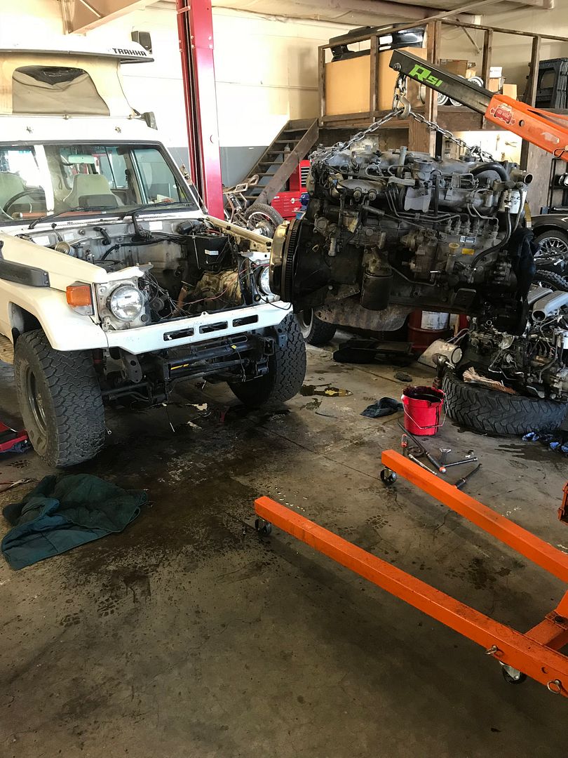

Engine is in, had a hell of a time getting the tranny lined up and the engine mounts in but with enough prybars and tricks we got it happy in it's home. Give me a few days to figure out the VSV shutoff wiring along with routing vacuum and it should be moving on it's own.
