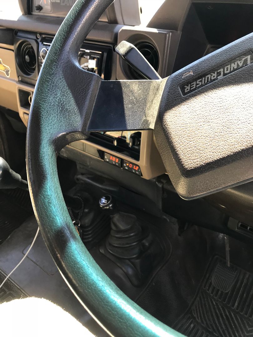

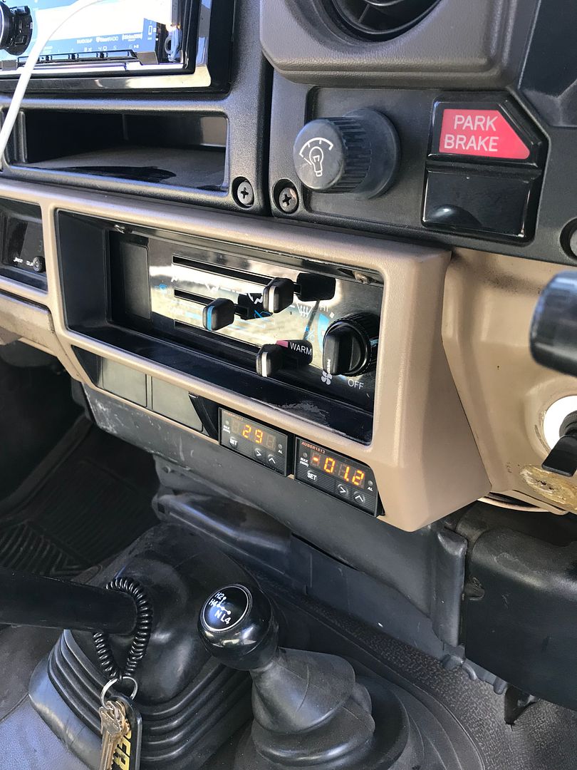

Got everything sorted, just a few things left including Pyrometer and Boost gauge install.
Lastly, I installed a couple gauges. I wanted something small and period correct for the interior. I picked Auber Instruments 1813 Digital gauges. Huge fan so far, love the 80s look.
Now to take some trips!

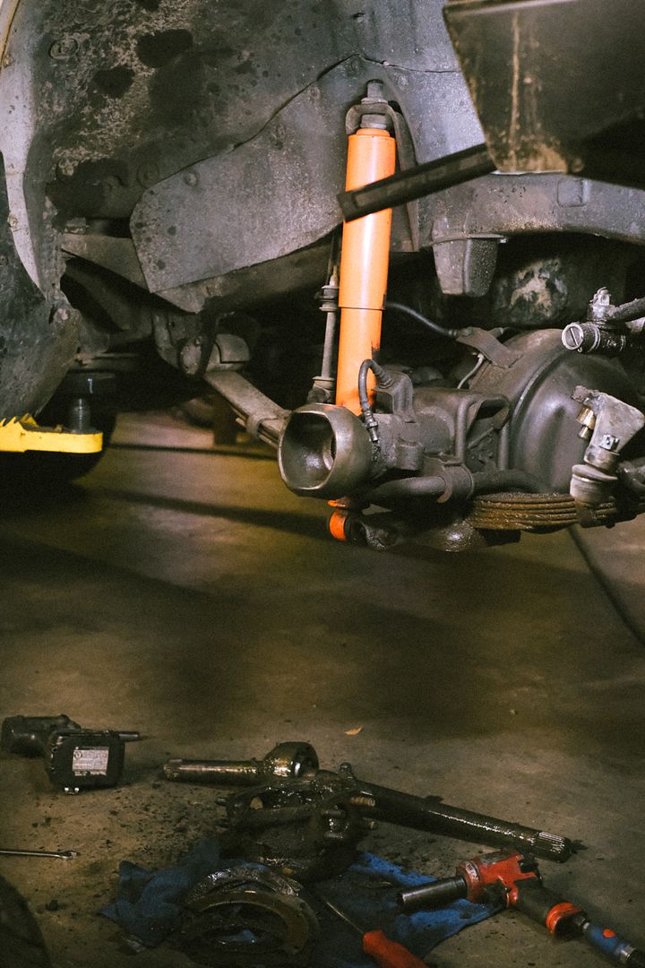

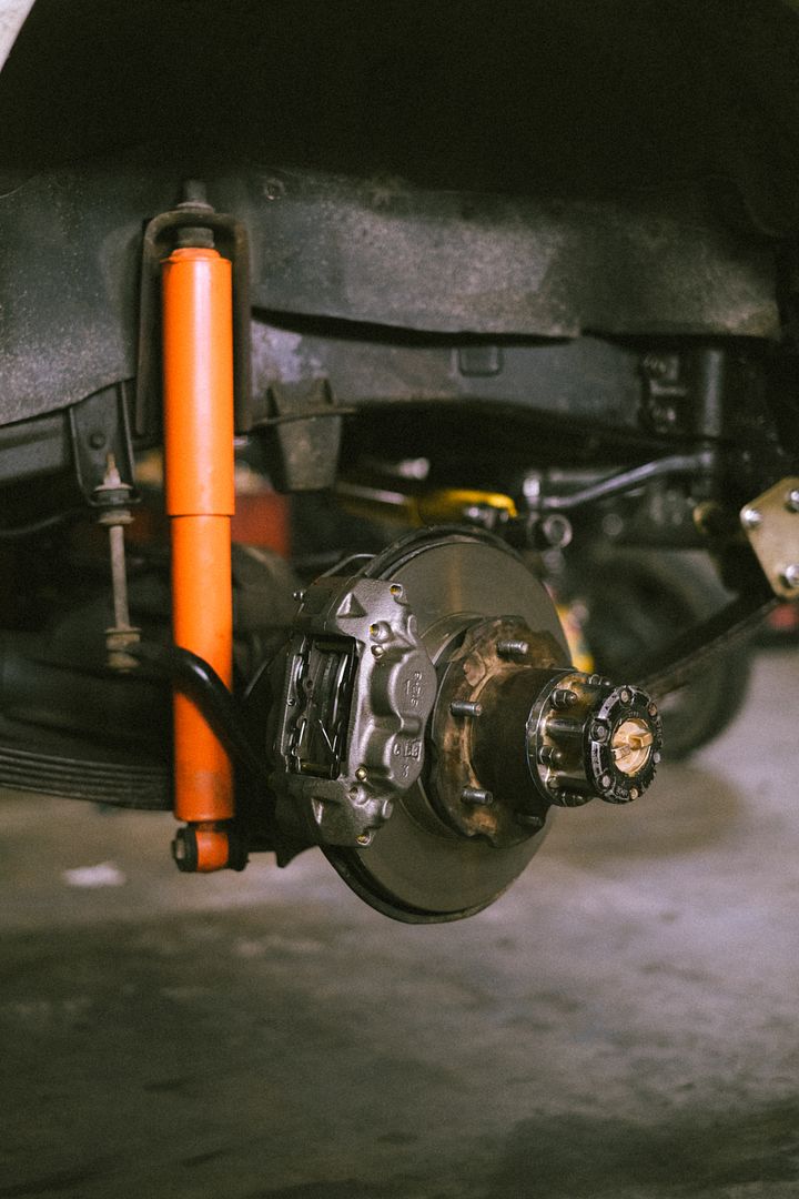

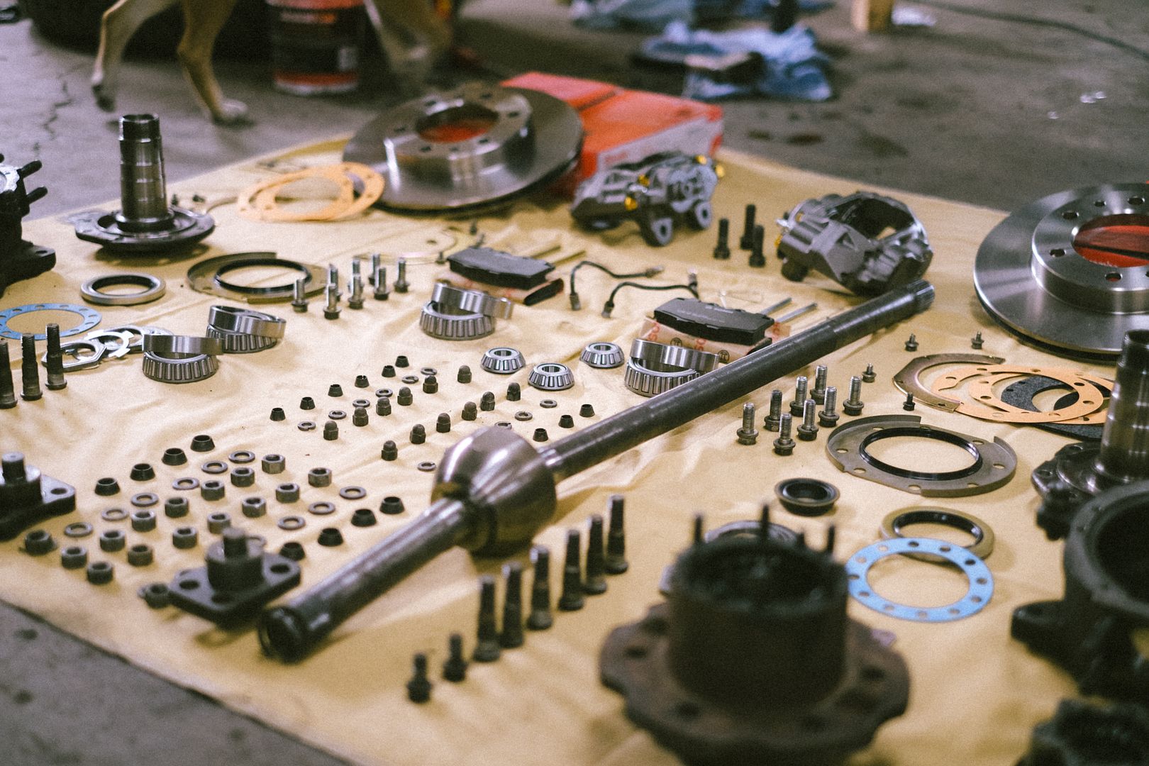

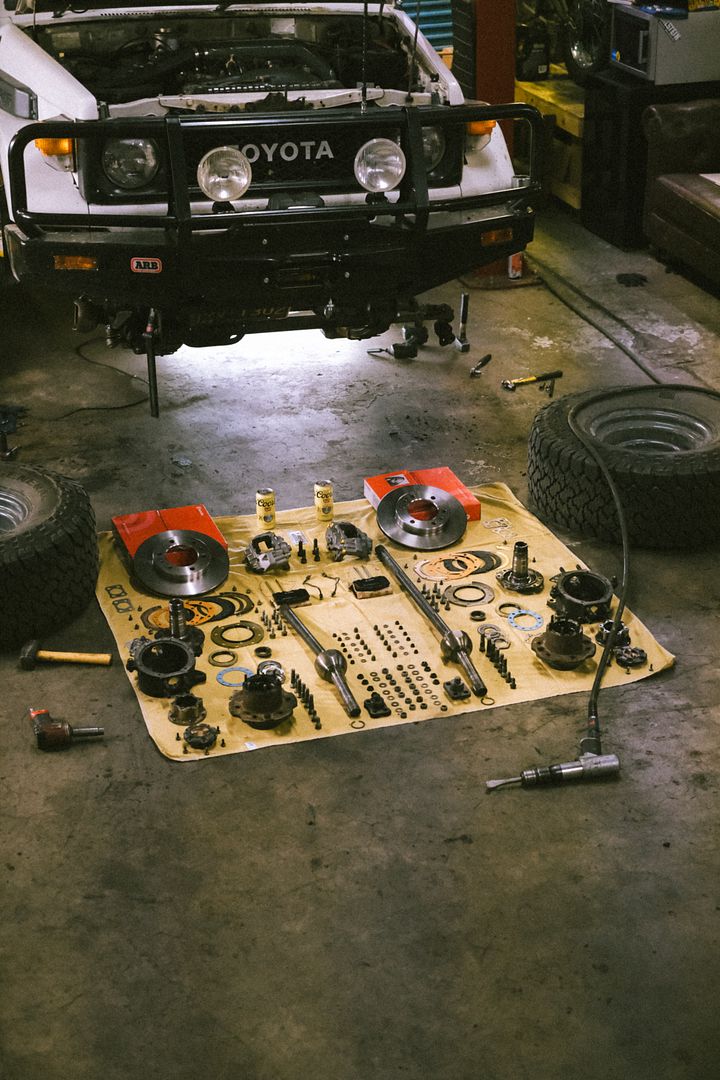

I didn't really think I needed it, but I kinda got bored and decided to rebuild my front axle before my wife and I head down to Baja for a month.
Turns out a couple of the steering bearings were completely toast, as were the axle seals. The fluids had become a nice communal soup.
After the rebuild it feels like a whole new truck. New calipers, brembo rotors and bosch pads are great as well. I thought it was tight before but now it feels brand new. Very pleased.
Only took 3 bags of towels and 25 pairs of gloves.
Decided to replace the H55 fluid with fresh Redline MT-90 as well. Very glad I did, it was a few quarts low. Tranny doesn't seem to whine as much now.

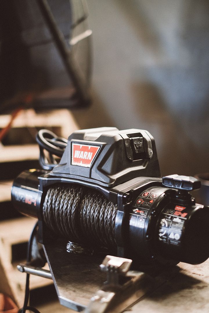

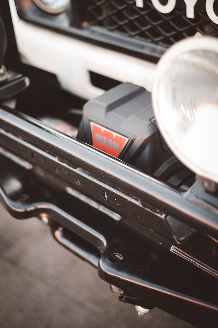

Also finally picked up a winch.

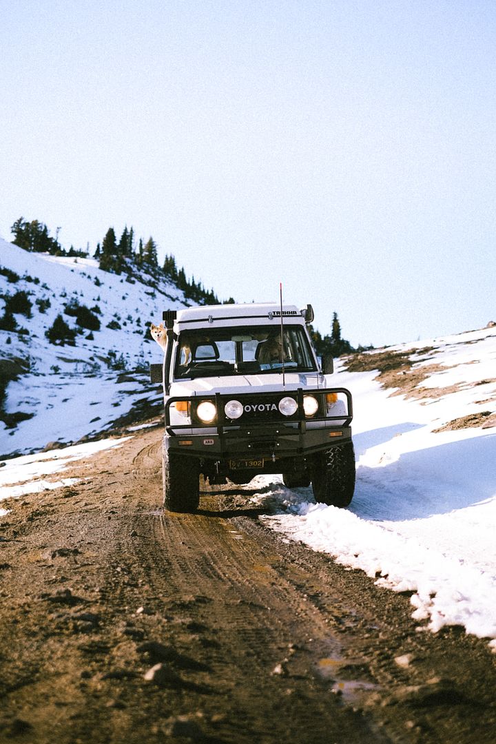

And got up into the snow.
Good thing n you did it!
A buddy of mine lost a wheel bearing down there last week. Axle came out at 60mph. It was bent so he had to find a whole new axle to keep going.

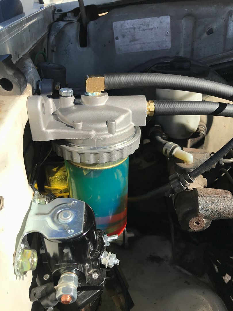

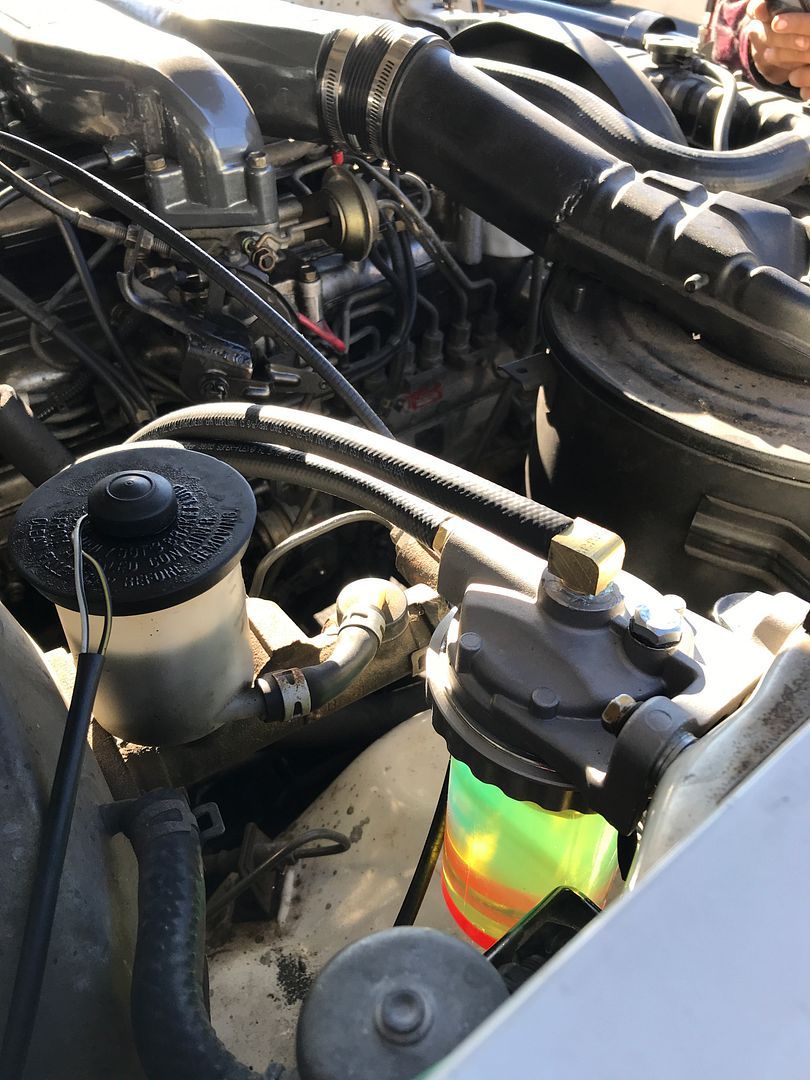

My OEM fuel water/sedimenter separator developed a pinhole leak on the bottom a few months ago. Took me a while to find the leak(it was about a drop an hour) but I eventually found it and just bypassed the separator until I sourced a new one. That proved impossible so I went with an Isuzu NPR Fuel separator off of Amazon.
It was going great, for about 12 hours. This brand new unit is leaking out of the petcock on the bottom, despite being incredibly tight. I'm just going to skip it. I don't need two fuel filters, these engines don't seem to be terribly picky with fuel.

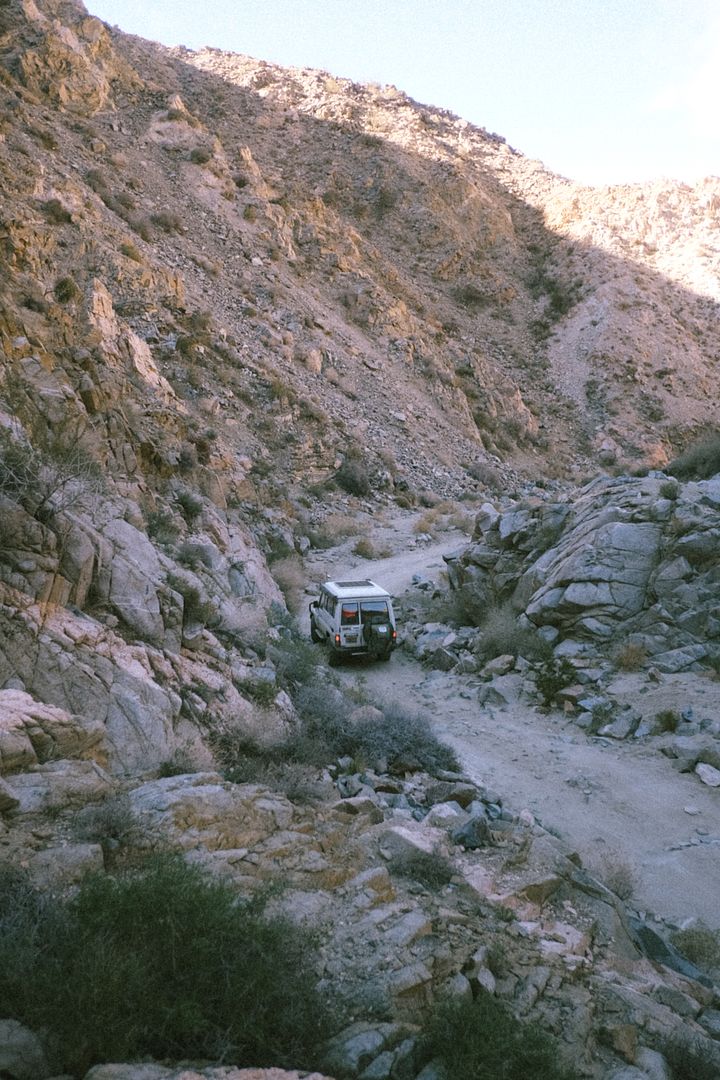

Baja was excellent. We camped alone a few nights and in a few campsites as well. All was safe and no issues. The truck absolutely killed it. I broke one swaybar bracket on the 5hour dirt road from Scorpion Bay to Guerrero Negro. I shouldn't have a swaybar anyway.
Performance was great. There were only 2-3 hills the entire trip (there and back) that required me to get into 4th gear. Still loving the 12ht with stock power but eventually I may look into boosting a little past 8psi and a small intercooler.
