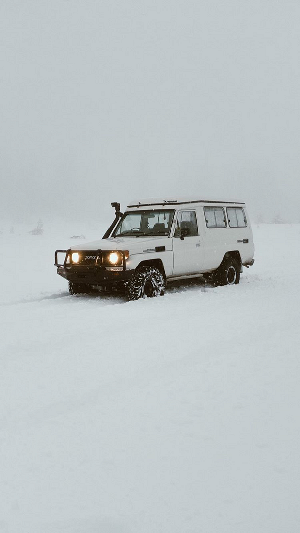

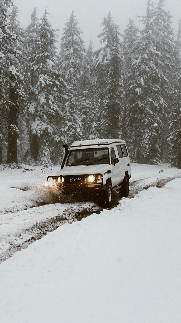

Here is why, it's already snowing down here:
