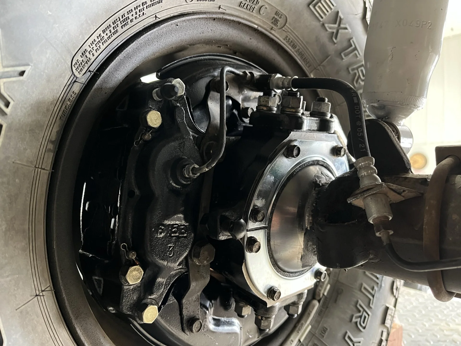

Been working on the axles in my spare time over the last few weeks. Fronts are finished. Knuckles are rebuilt with Koyo bearings (thanks, Cruiser Outfitters), new brakes/calipers/OEM hoses. I also installed new 555 tie rod ends to tighten things up. Everything is torqued to spec and ready to go.

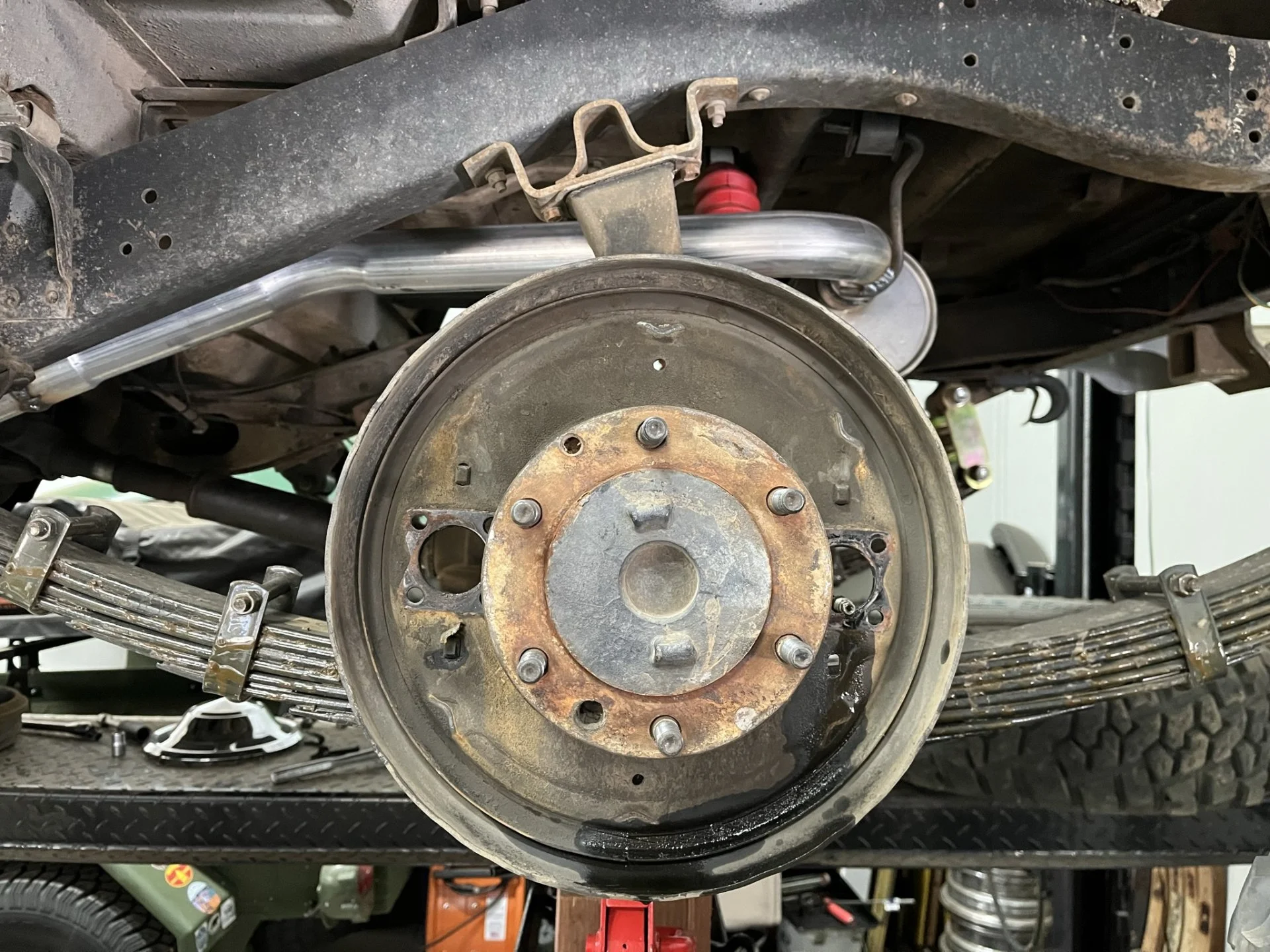

Next are the rears. Going with new wheel cylinders and pads. Also installed an OEM extended center brake hose the for the rear axle and got things torn down today. Haven't driven this 40 in what seems like forever. Can't wait to adjust the new brakes and get 'er back on the road.
Nice work. Would you happen to know the part number on the OEM extended center brake hose?
Thanks. Part number for the longer rear brake hose is 96940-34705. It was a couple inches longer than stock and gives the rear axle a bit more movement for the 4" lift.

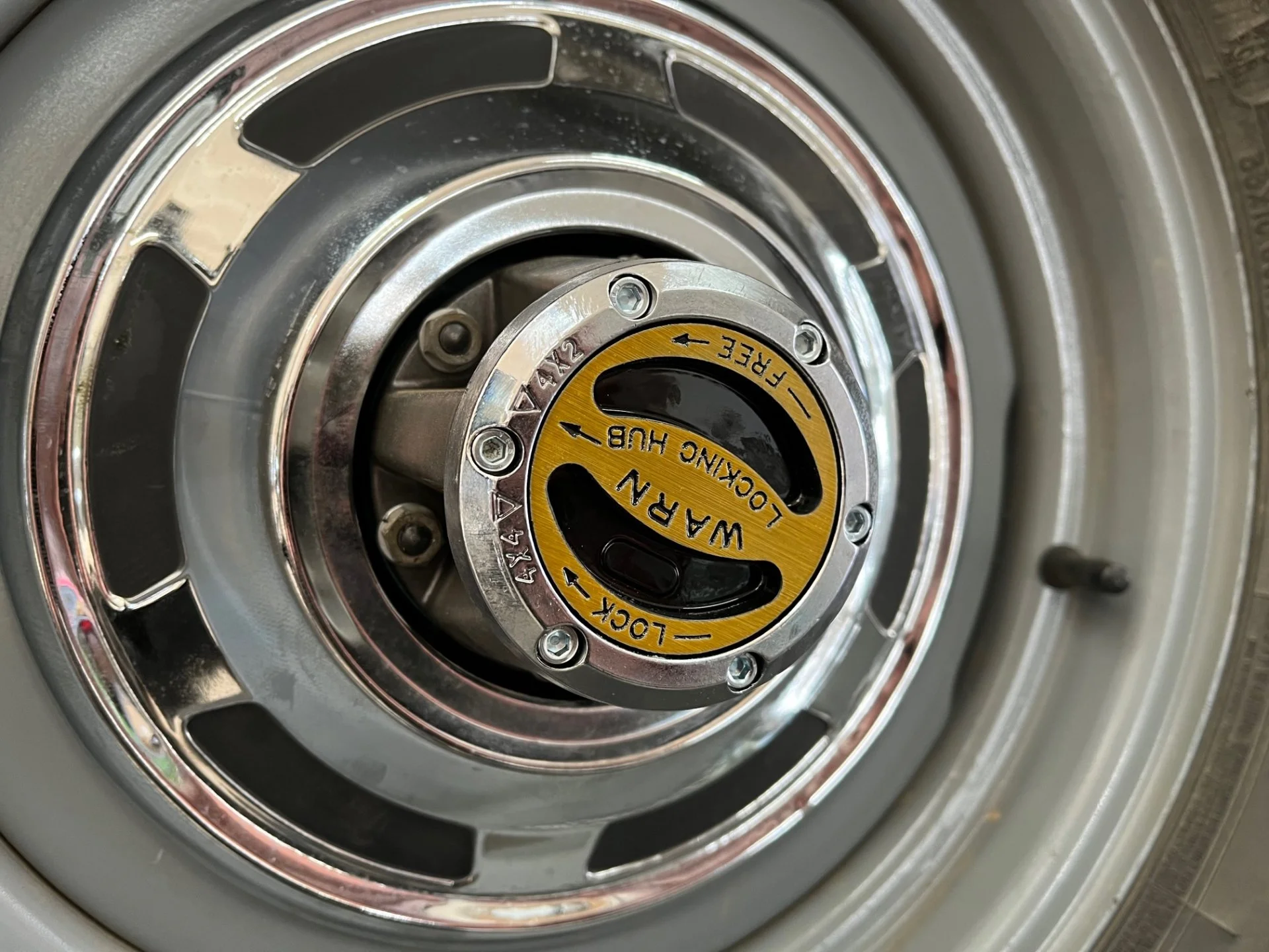

On another note, I installed some nice jewelry with the knuckle rebuild.
Are the warrens still available new?
I had to call a few places (Summit, Napa, O’Reilly all show them on their Web sites but are back ordered), but Vatozone came through. Had them in about a day. Around $275 IIRC. I’m kinda shocked that anyone still makes a direct bolt-on Warren for the 40.
