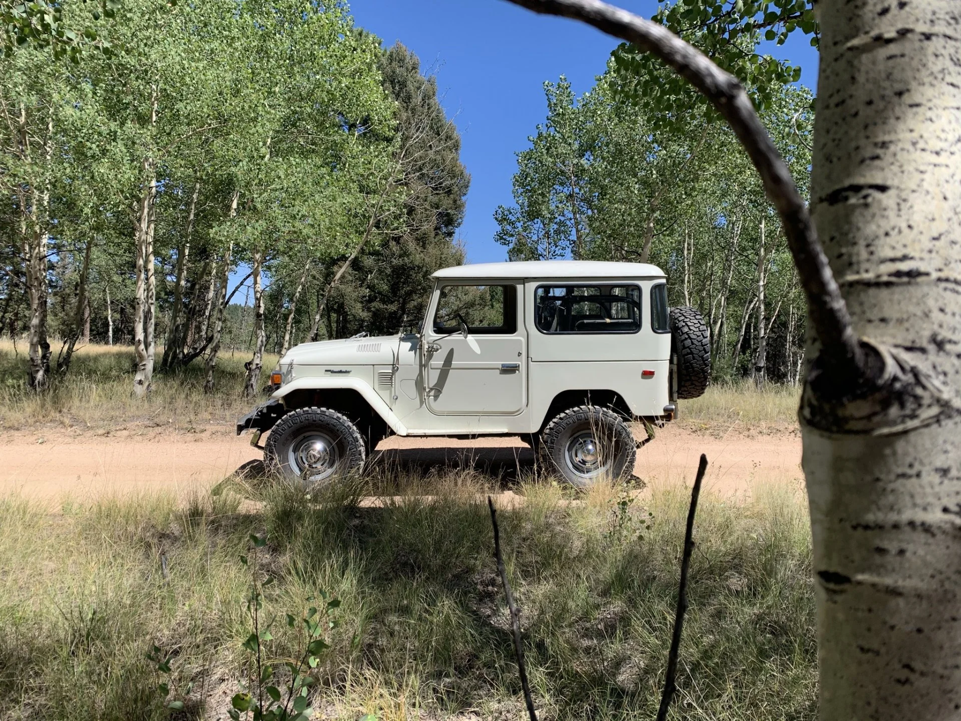

Took her for a nice drive around town today and on the dirt roads back.
On another note, the Dick Cepek 33 x 10.50s are impressively quiet tires. @wngrog, I think you'll be happy to know that I'm done with Swampers. Bias ply is just too much shakin' up here in the cold weather.

Will do. These seem wider than any other 10.50s that I’ve run in the past. I’ll get some measurements posted up soon.

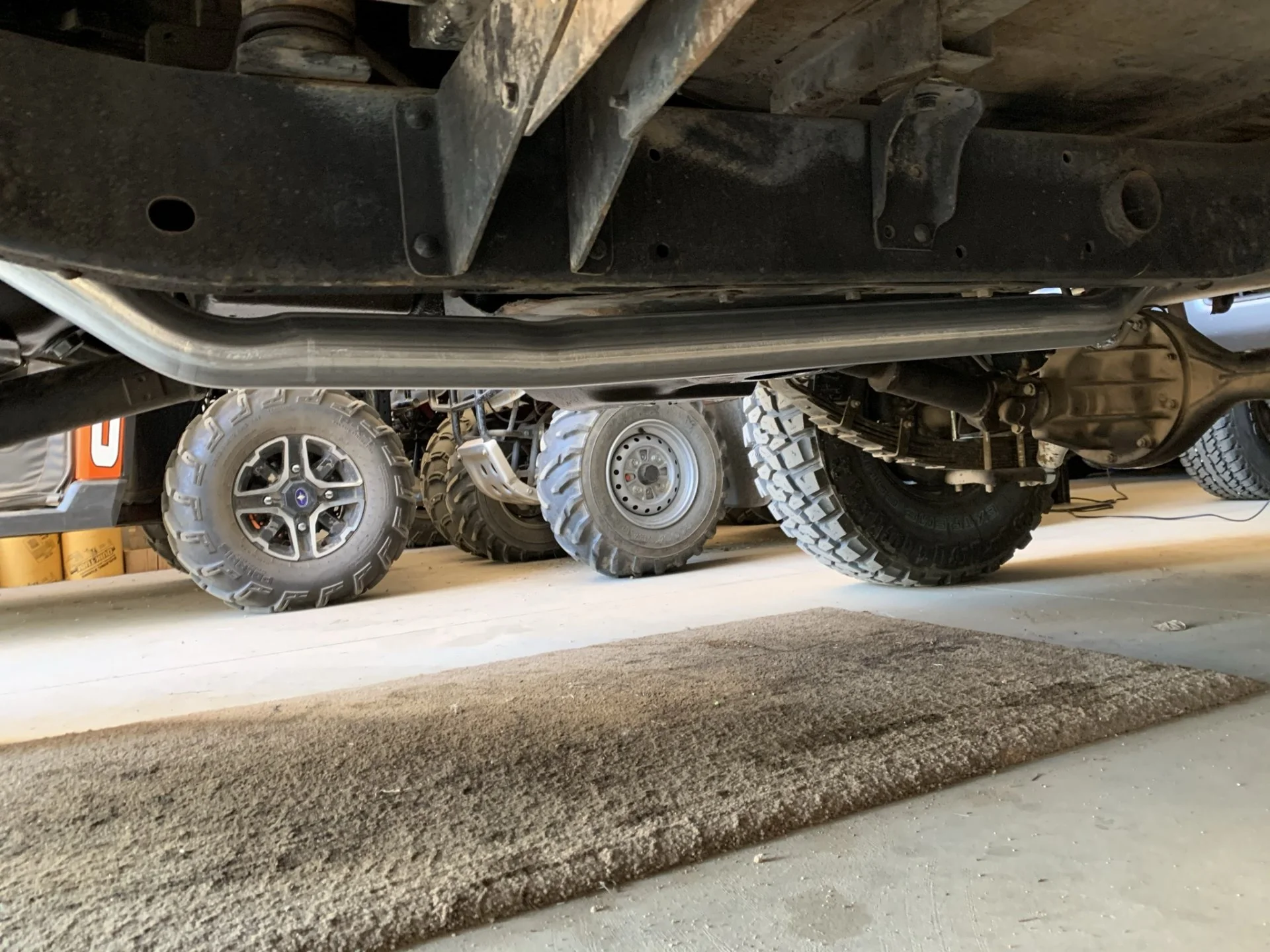

I did some research and found a really good old-school, family-owned muffler shop in Colorado Springs. I had them replace the entire exhaust, minus the manifold. Don did a great job routing it and even located me a cylindrical-style muffler. I had them route it outside of the skid plate, which will hopefully keep the floorboard from cooking my feet from this point forward.
Sounds/runs/drives much better.

Very nice! Be interested to see how you routed the exhaust outside the skid plate. Is it below the frame? Have headliner to do, as well, and have been putting it off. Not looking forward to that job.

Yes, I had it run below the frame (oddly enough, I think this was the stock configuration). The skid plate bolts are still easily accessible, despite how the picture looks.
My '76 had that same routing (under)...always found it odd, as it hangs pretty darn low for an off-road rig. I ended up making a new downpipe, and shuffled it up a bit so it's not quite so low.

Here is the original exhaust routing on my 10/75 76 model. Vehicle only has 4,500 miles on it. It has the two factory heat shields behind the skid plate. 12/71 added a heat shield to the muffler. From then on the 40 had heat shielding behind the skid plate. Never seen any above the skid plate or listing for one. 1/79 Toyota started routing the exhaust outside the frame where the transmission and transfer case are.
