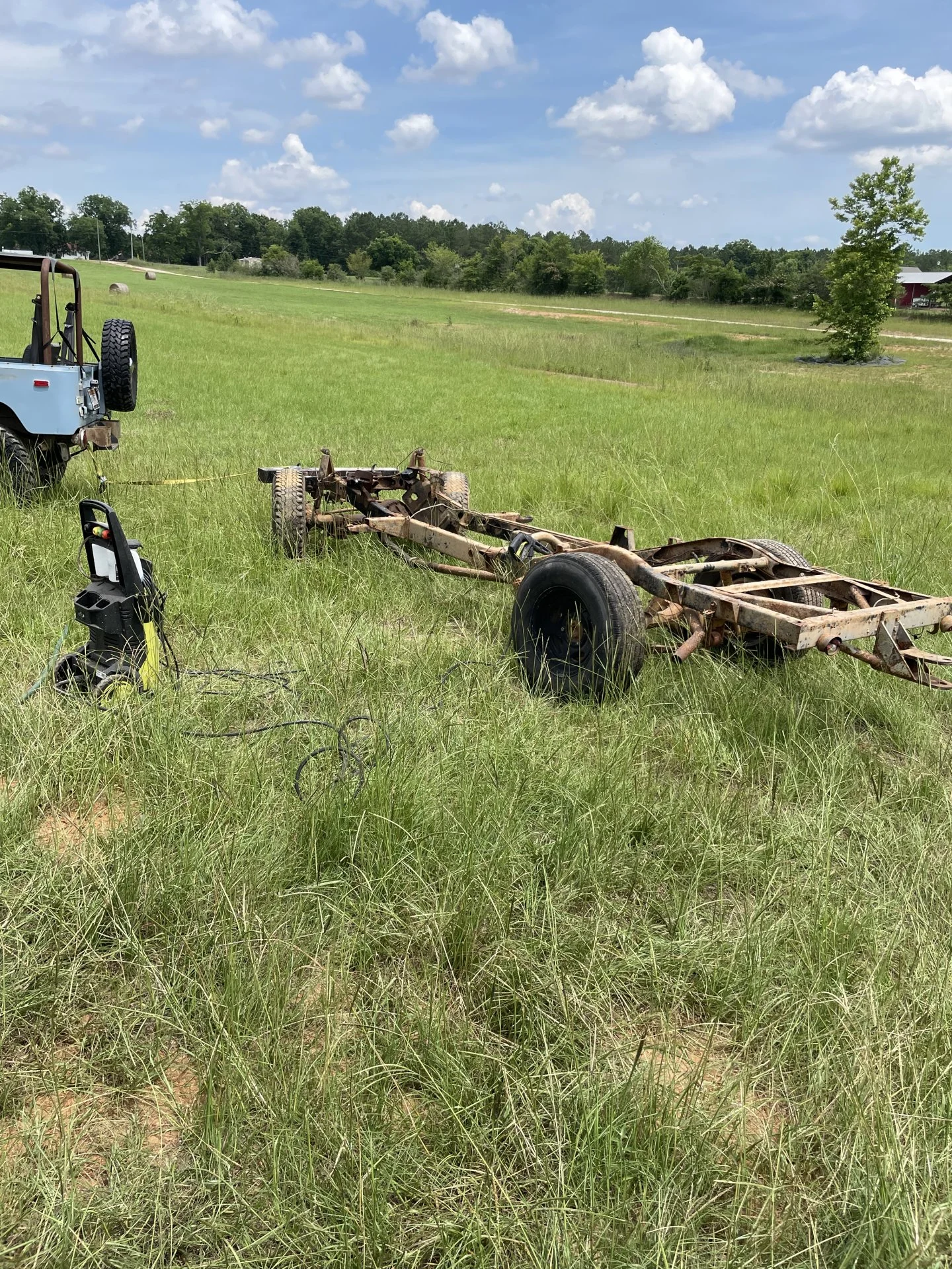

About a thousand degrees today in LA (lower Alabama). First round of pressure washing frame complete. A few decades of California dirt slowly getting washed away. Amazed of how much original black paint still on frame.
Nice! Looks like you still have some electrical components in place? Water/crud/etc. incursion is why I ask, esp. with pressure washing.

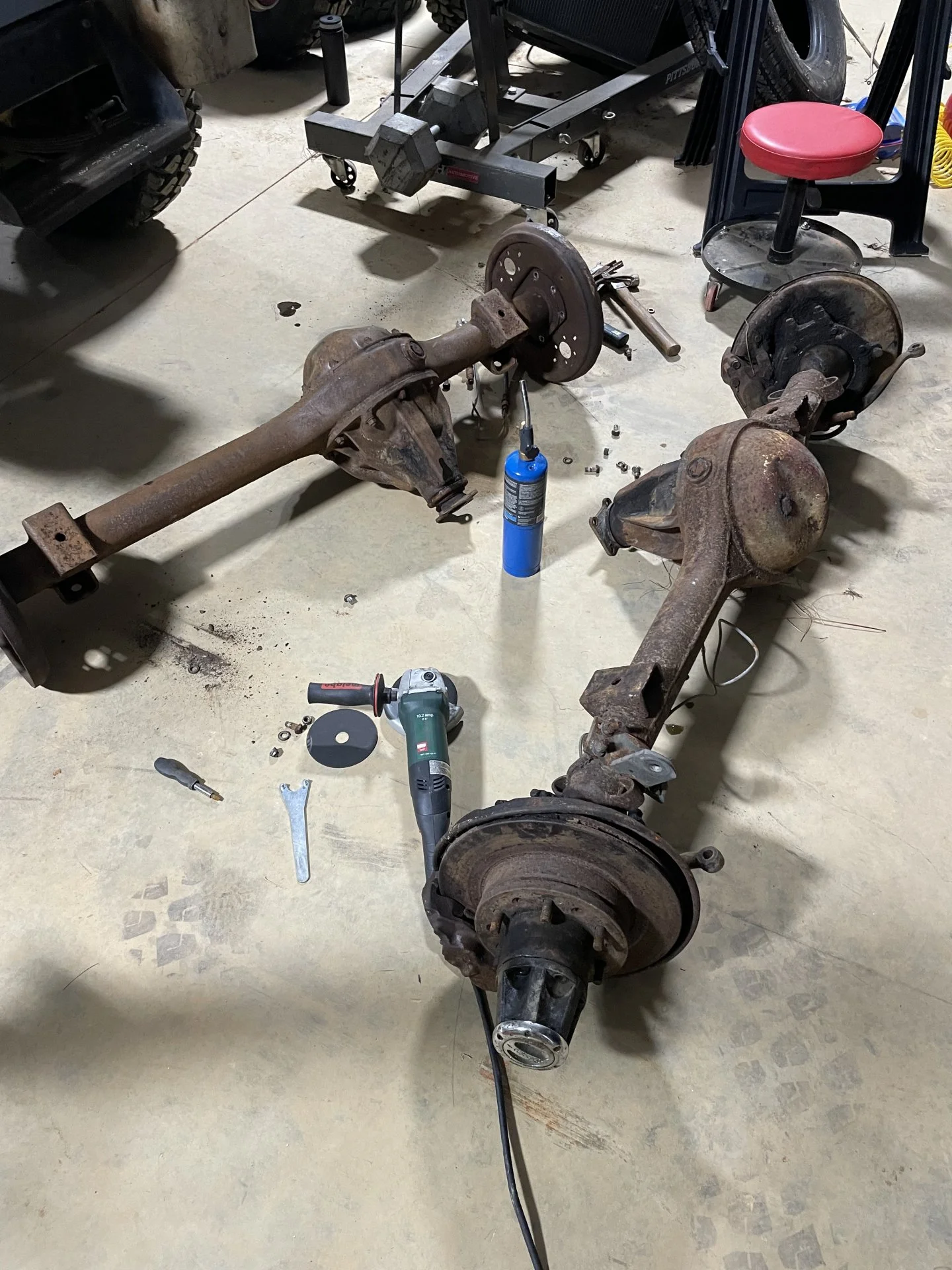

1979 axles will go under her. Thx @wngrog for the complete rear brake setup. I’ll need to figure out the front brake situation. I’m betting I need EVERYTHING; rotors, shoes, calipers, hard/soft lines. And I’m sure I’m not thinking of other things…. Bearings, knuckles, steering, etc etc.
Only took another 2.5 years to tear these down. I had two sets of 79-83 axles to choose from. One had selectro hubs and the other ASCO. Going with that ASCO set. Will order parts tomorrow. While waiting for parts, I’ll wire brush, clean, and paint.
