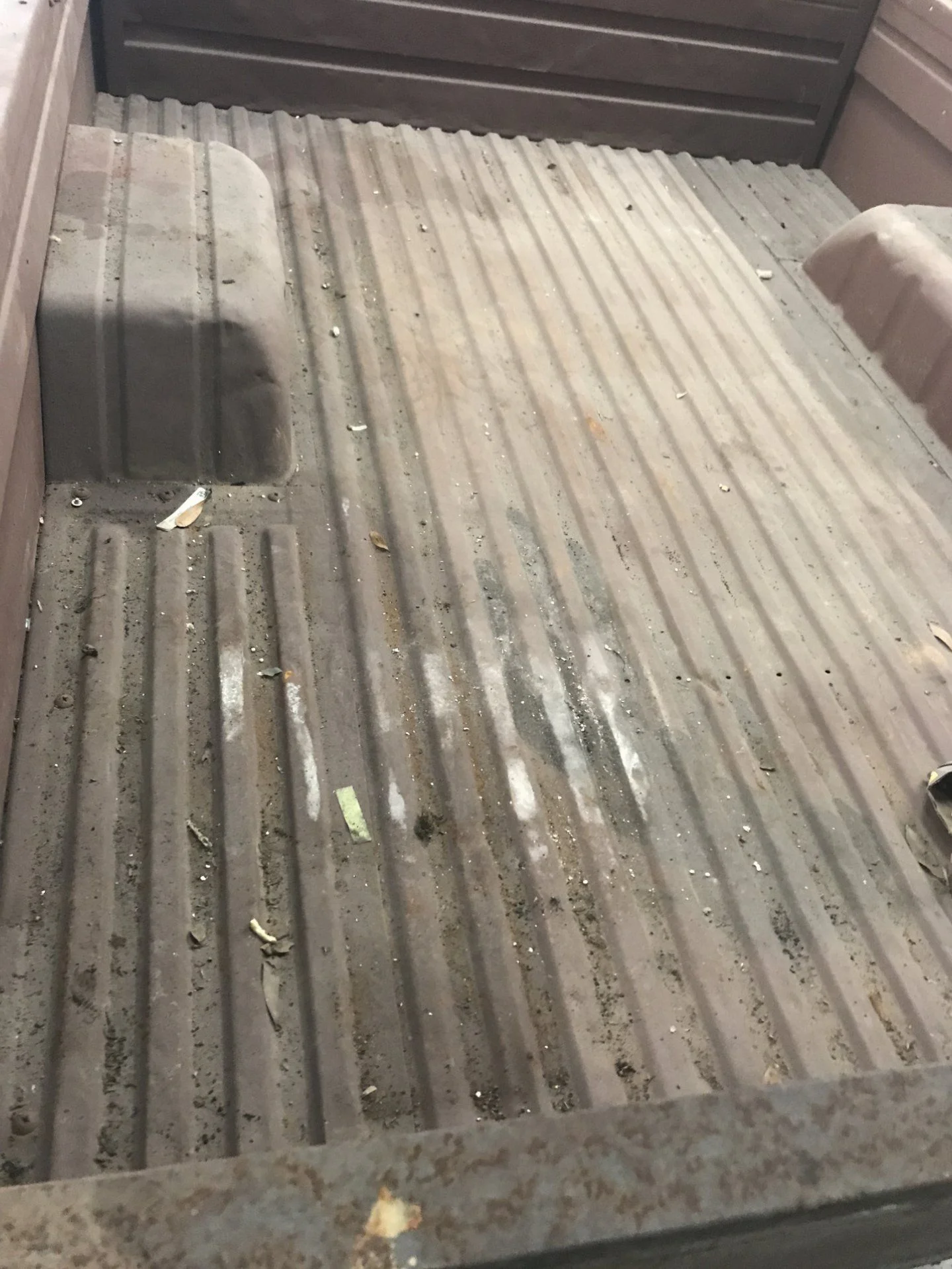

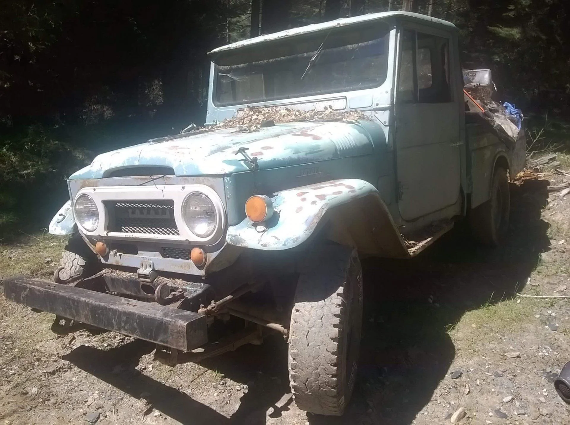

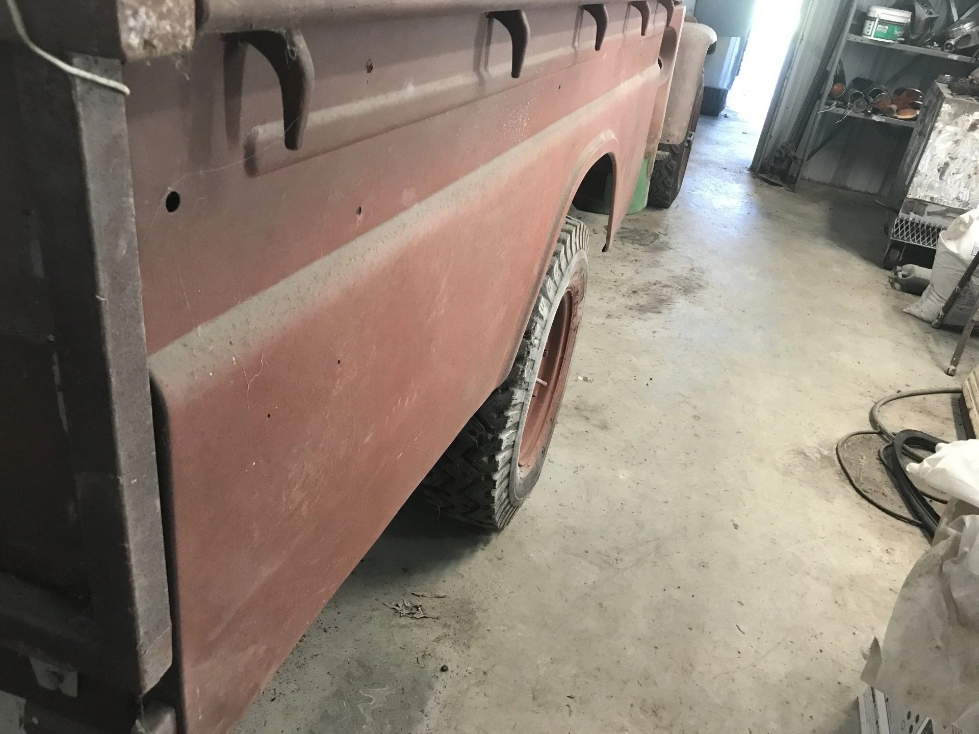

Let's get a few baseline pics up because we all love pics!
Very nice! Yes more pic's please. Was the original color on the 65 white or green?
The 65 was spring green. The 66 was either white or tan. Probably tan.
Nice find! What are your plans? Restore them both?
They both look pretty solid

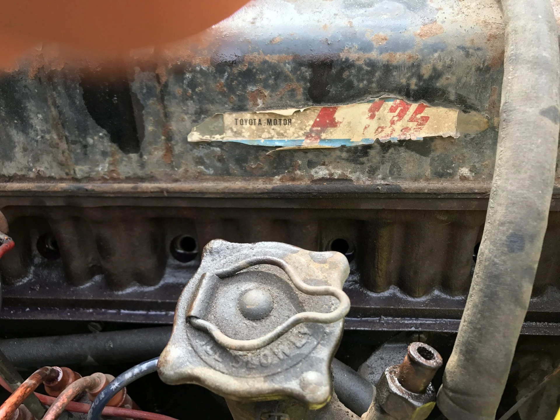

The original motor is locked up. So, I'm hoping for a miracle. I bought and poured some Marvel Mystery Oil down each spark plug hole. I'm going to let it sit for awhile and attempt to break it free. I'll let everyone know either way.
I really like Sea Foam and Marvel oil. The two together are almost a for sure un-lock release agent about 2oz per cylinder that is about one can. Good luck and don't be in a hurry to spin it be patient just nudge it with a wrench on the crank.
