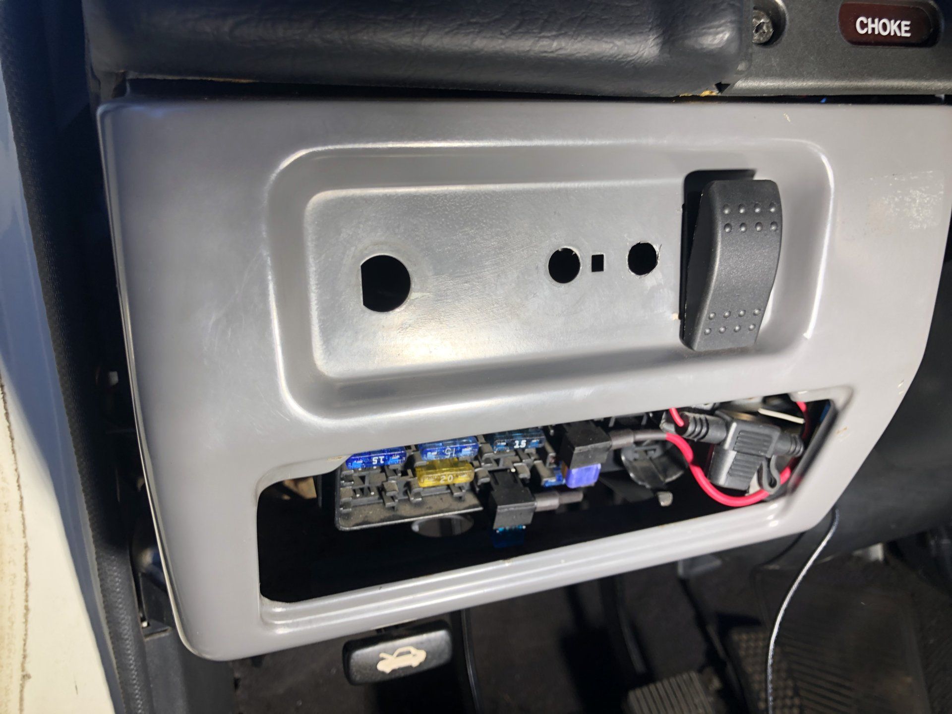

Removed the old manual CHOKE switch and drilled another hole for the dimmer switch to make room to mount the tiny tach.
Got the Tiny Tach in its new home
