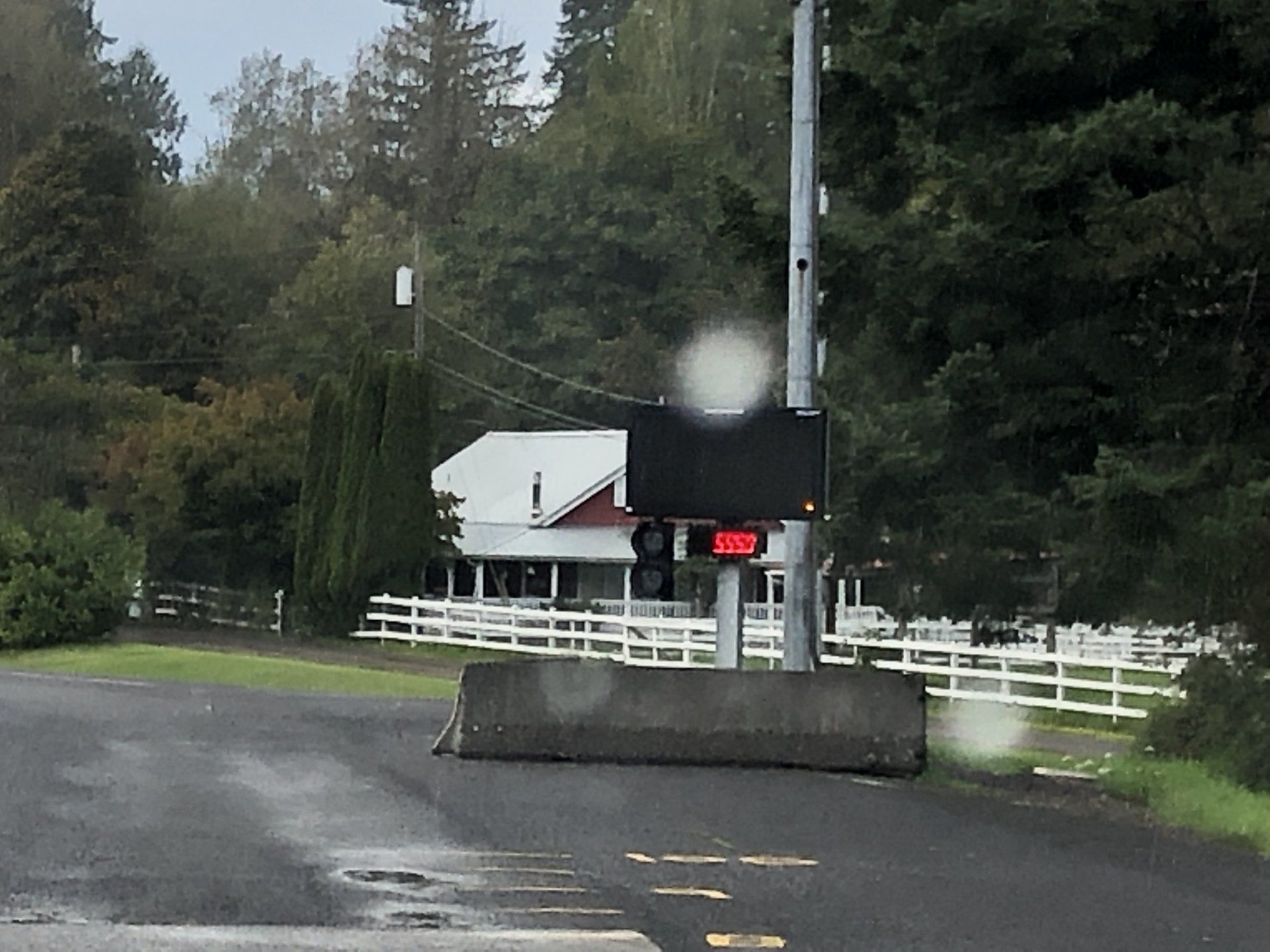

On the way home took the 60 over the truck scale.
5950 pounds with the 4BT swap
4600 pounds with the 2F

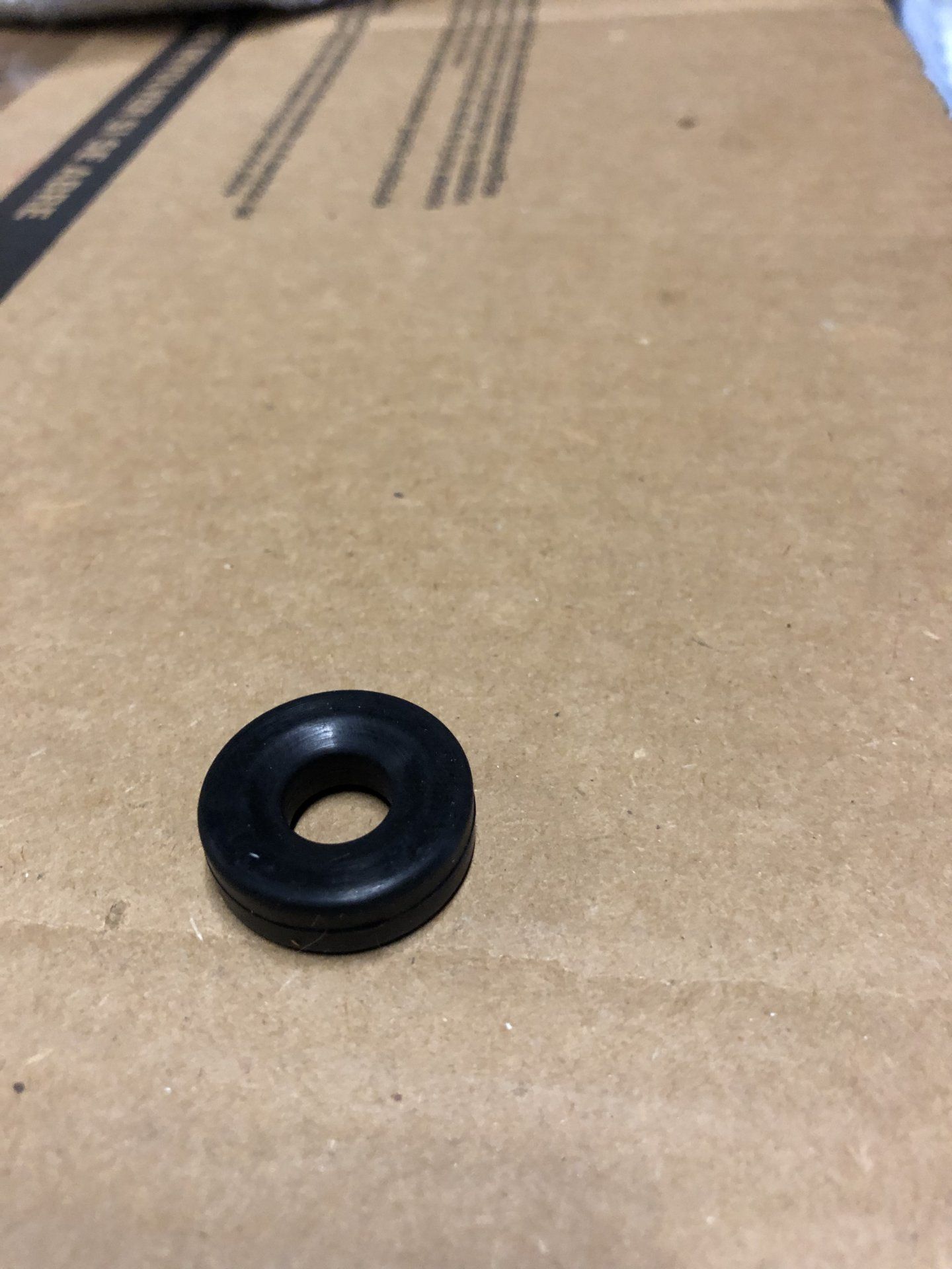

Get Valve cover breather installed only to find that I only got one rubber grommet that goes on the valve cover bolt to hold the Case/ Holland valve cover down.
Went to 3 auto part stores and no dice on finding a part. Need to call Mobile Diesel Service Monday and see when they can send me one. Got some rubber bushings from the hardware store but not sure if they can handle the heat.

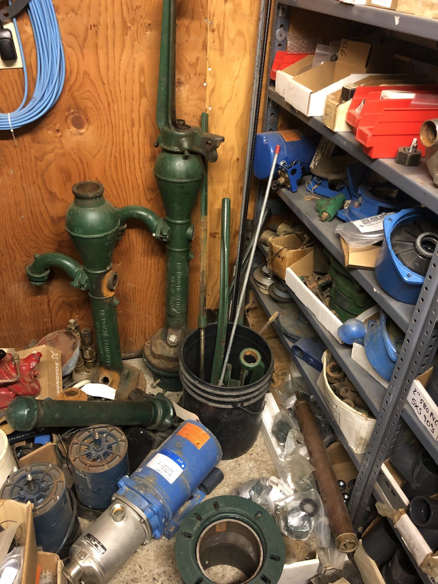

My bone yard of older handpump I’ve removed still in rebuildable condition.
Sorting through the parts to gather all the parts needed for a complete pump stand.

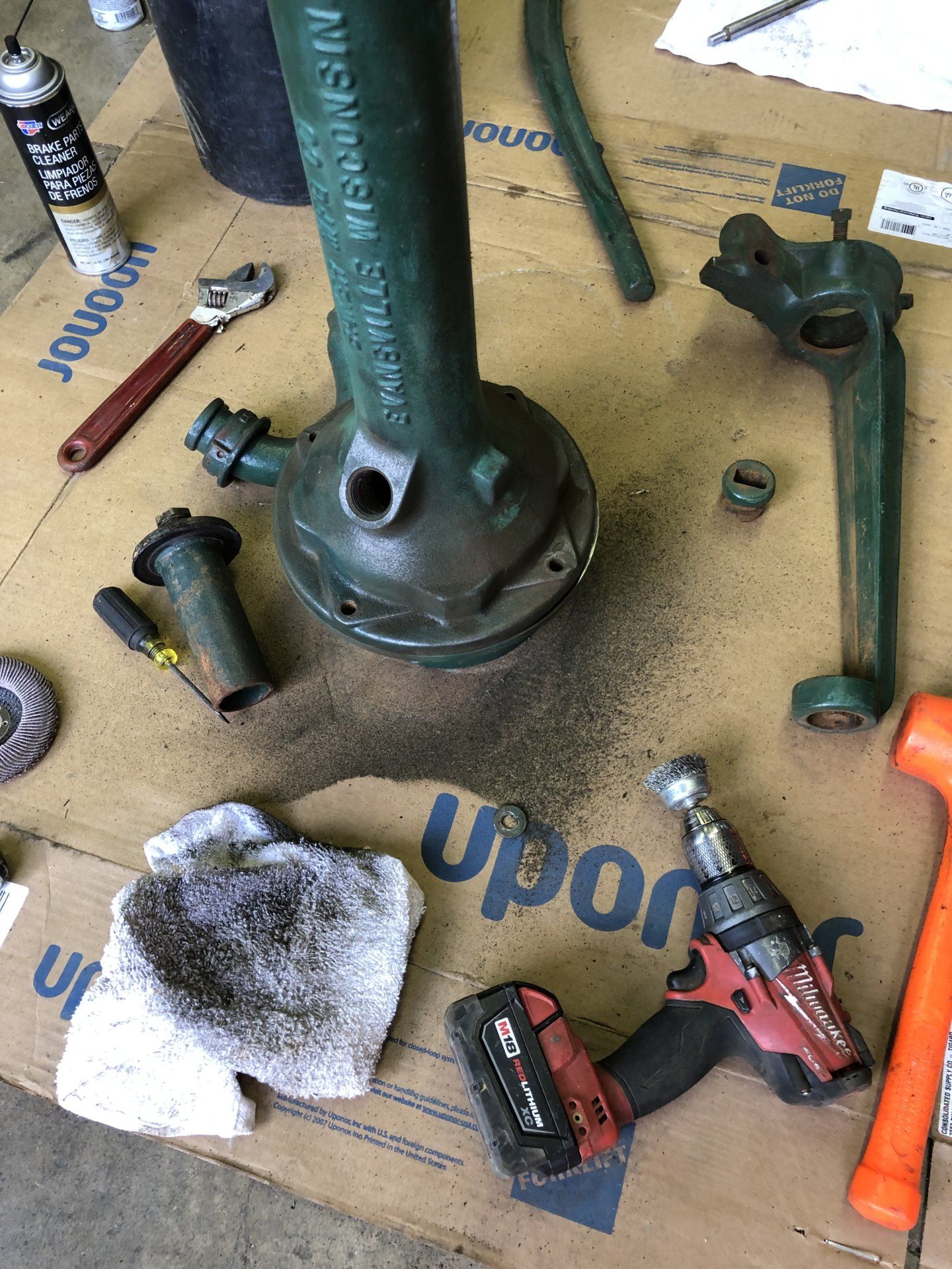

Used wire brush on drill to clean all the grime and rust off old pump stand. Brake cleaner to clean before spray painting with Krylon Colormaxx paint and primer.
This paint is amazingly fast drying and coats really well. Comparison to what the pumpstand looked like an hour ago.

Had a plan to go to the Tilly Jane A-frame work party and overnighter today with my boy and his friend. I received the Case/ Holland Crankcase breather grommets yesterday so I installed the crank case breather early this morning. Not sure if when I routed the hose if it hit the power steering return line or just a coincidence but after about 10 miles I hear a pop and a loss of power steering. Open the hood to find the hose blown off the return on the gearbox. Went to the shop luckily only 5 minutes away and hopefully go get fluid and be on our way again. I had noticed a sound that had progressively gotten stronger the past day. I thought it was perhaps the belt but found out my front injector was blowing exhaust from the cylinder out the injector. It’s not spraying any diesel only pushing exhaust out. Ran to Napa and got power steering fluid and a better hose clamp. I’m wondering if the PS return kinked when I was weaving the crank case breather line through and finally built up too much pressure and blew. The hose inside diameter actually increased size. Got new PS fluid and filled pump. Turned steering wheel and got fluid to start filling system again. Took it for a drive. Returned and added more fluid as it was still whining. Finally got it the PS working good. Shot a video of the injector exhaust leak.

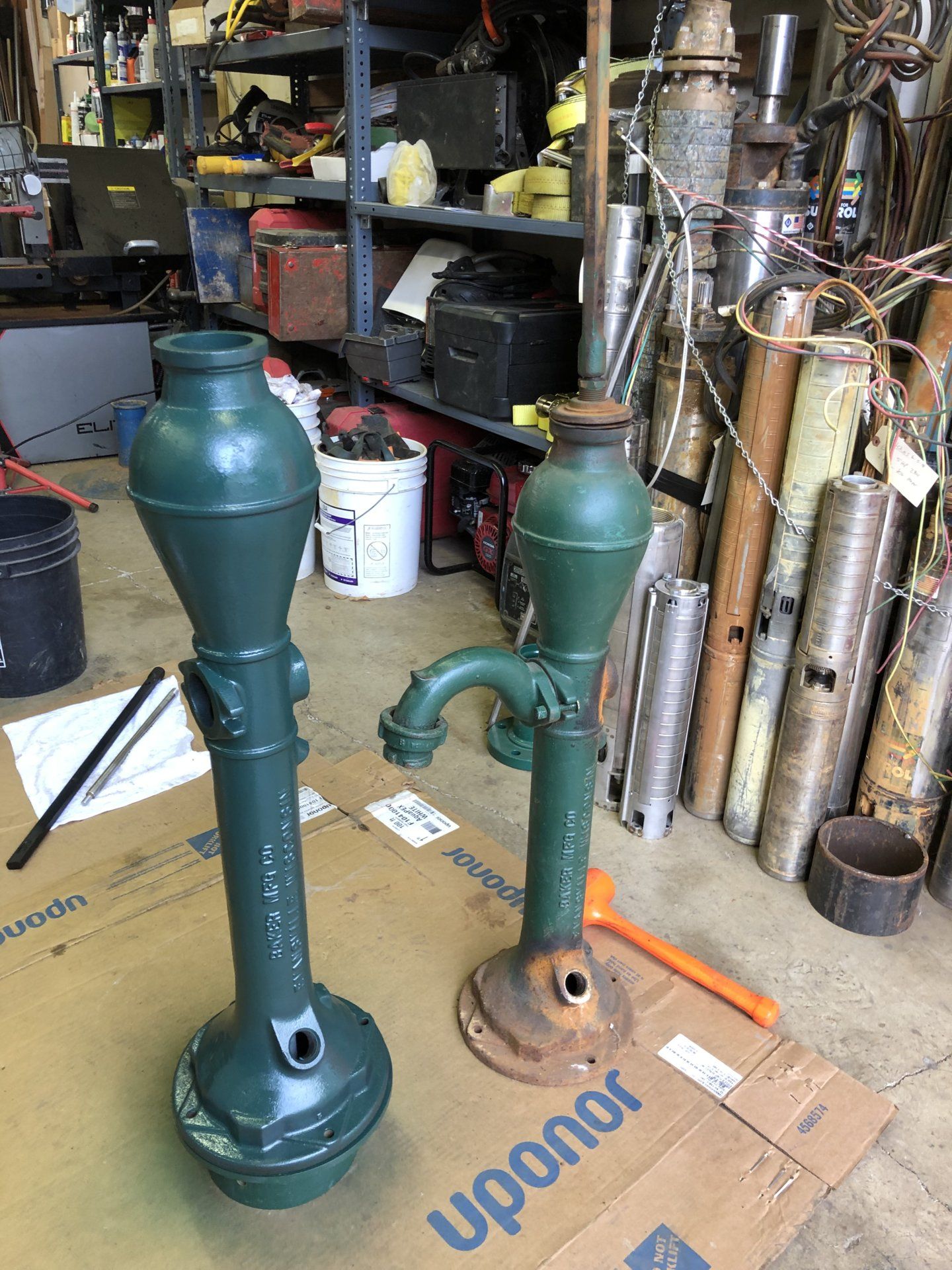

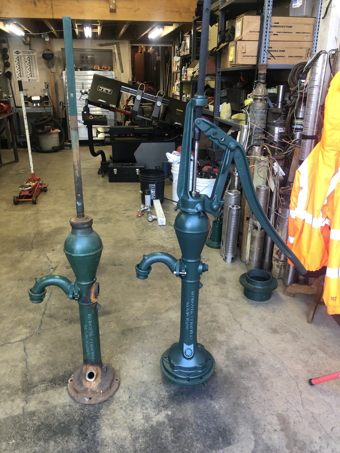

Got back and decided to get a jump finishing up the cleaning up and getting the hand pump painted and assembled.
