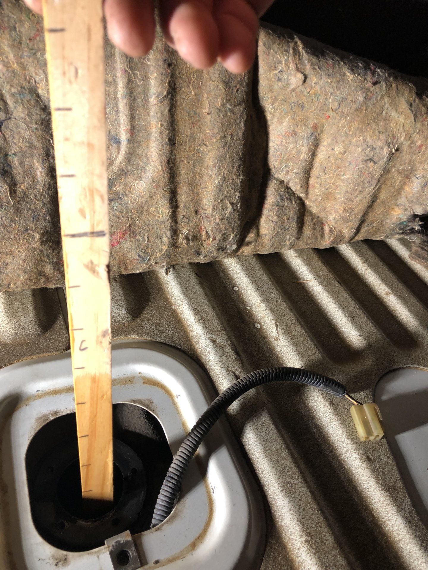

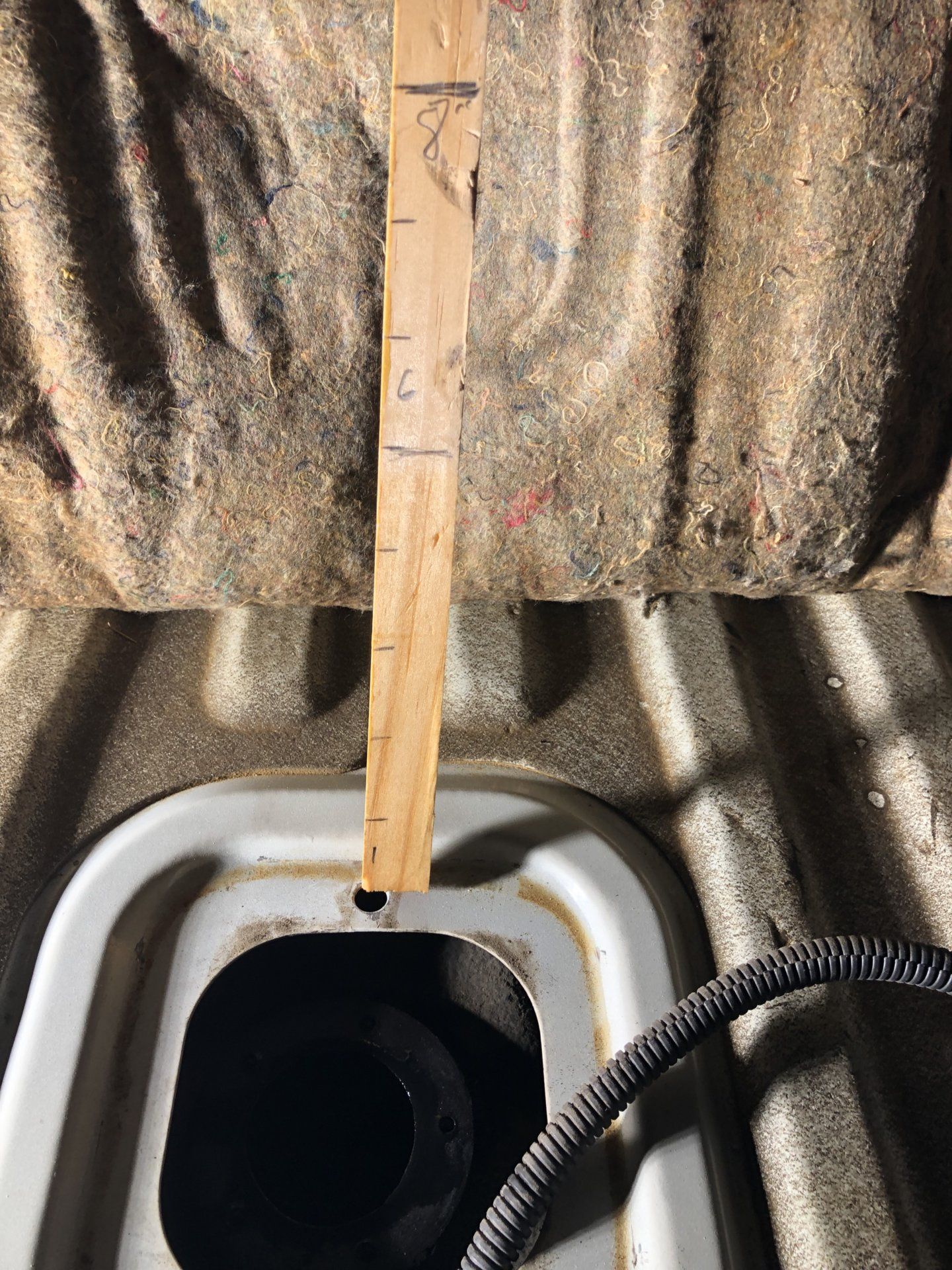

Pulled the fuel float.
Got a clean piece of wood and marked it with inch marks and put it into bottom of tank.
Bottom to top gasket for float is 8”. My current fuel level is 5”, 3” down from the top.
I’m not entirely sure how full the tank gets when you fill it at the pump but I’ve done 214.5 miles in 3” of fuel in the tank if it gets completely full. There’s still 5” of diesel to bottom of tank. Because it’s diesel I’m not going let it run too low, but this test shows the 4BT is really putting out the mpg’s. 4:10s on 37s. I know cruising down the highway it literally feels like it’s barely working the engine. 5th gear is runs like a dream. Highest I’ve driven is 74mph on I-84 Labor Day in the Columbia River Gorge.
The fuel float is rusty and should be replaced. After these findings I’m convinced the fuel level is working properly. More input from other would be appreciated. With the 2F I would be needing to refuel tomorrow!

Im assuming that +200 miles was starting with a full tank? I think you used more then a 1/4 tank, otherwise that would be 40-45mpg. These tanks are 23 gallons by the way. Your sender might be bad? How is the fuel level calibrated with the Speedhut gauges? Might be a discrepancy there.

Tank 8” deep
Fuel 5” deep
Mileage 214.5

To make it easier we’ll do 215 miles in 3” of fuel if the tank is totally filled to top, no air gap. That’s 71.7 miles per inch of diesel in the tank. Tank is 8” deep x 71.7 miles per inch = 573.6 miles roughly.
573.6 total miles divided by 23 gallons= 24.939 mpg.

The one in the fuel tank is just rusted and the arm isn’t looking too good either. Don’t want it to rot off and have a float bobbing in the tank.
You are getting mileage that I've never experienced myself. The highest I've seen was 21mpg but I usually average in the high teens and our setups are not that similar. But when doing the math ~24mpg is doable on the 4bt. There are others that have achieved better albeit not in a lifted vehicle. At this point it seems like you've got a great mileage tune and it'll be interesting to see where it's at after a couple of tanks. 1 tank of fuel is never the average. I hope it stays high for you.

Pretty sure the tank has a depression where the sending unit goes, so the lower 3" is a lot smaller volume-wise than the upper 3".
Only way to know for sure is to fill it up, drive it, fill it up again and check mileage vs fuel used. Do that 3-4 times and average it out - then you know.
