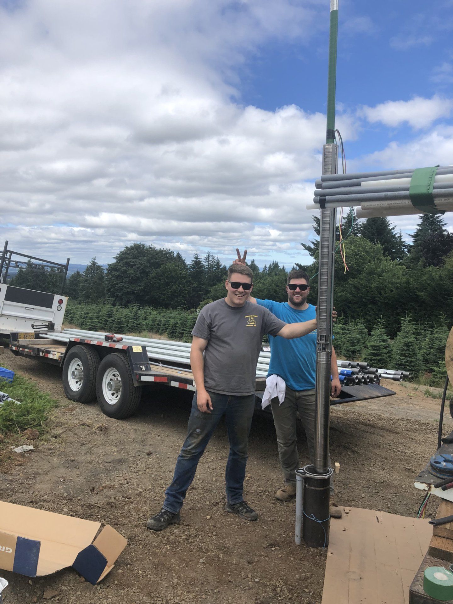

Setting a 882’ 25gpm 10HP 480V 3 phase Grundfos well pump yesterday with my employees Grant and new guy Ronnie. Working with these 2 on the job is a lot of fun.

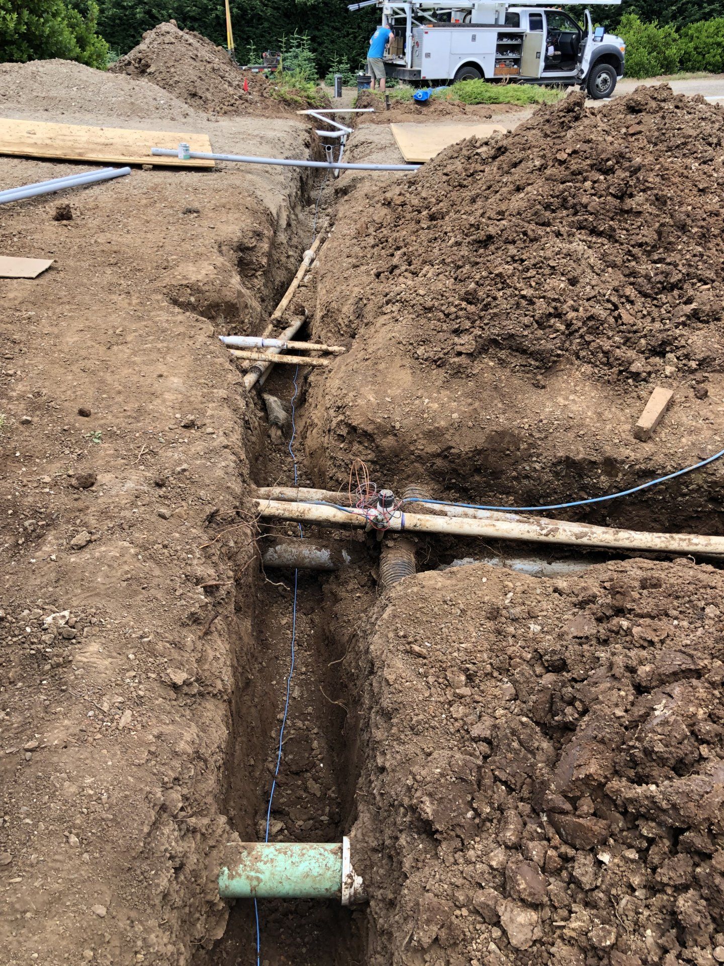

What a nightmare digging between the well and the pumphouse. I can’t wait to get on vacation.:bounce2::bounce:

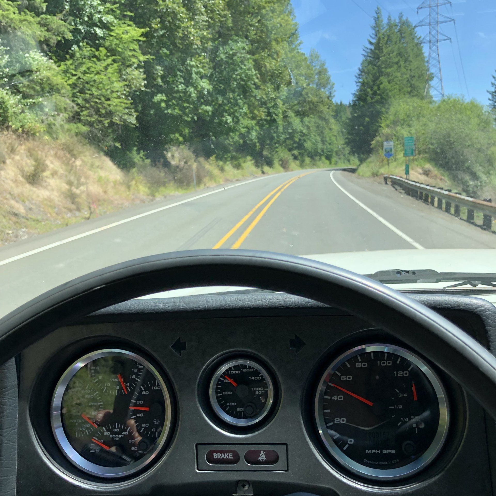

300 miles on the new Speedhut gauges and really like them. Only thing I need to remember is to wait and let the GPS speedo acquire and not just drive off. Driven a couple times and due to my terrain it won’t acquire signal for 8 miles til I’m in the low country. My fuel gauge fluctuates quite a bit more than I would like too. Seems to fluctuate 1/4 tank while driving. Wonder if there is something like a resistor that can be added to keep it steady like the stock fuel gauge.

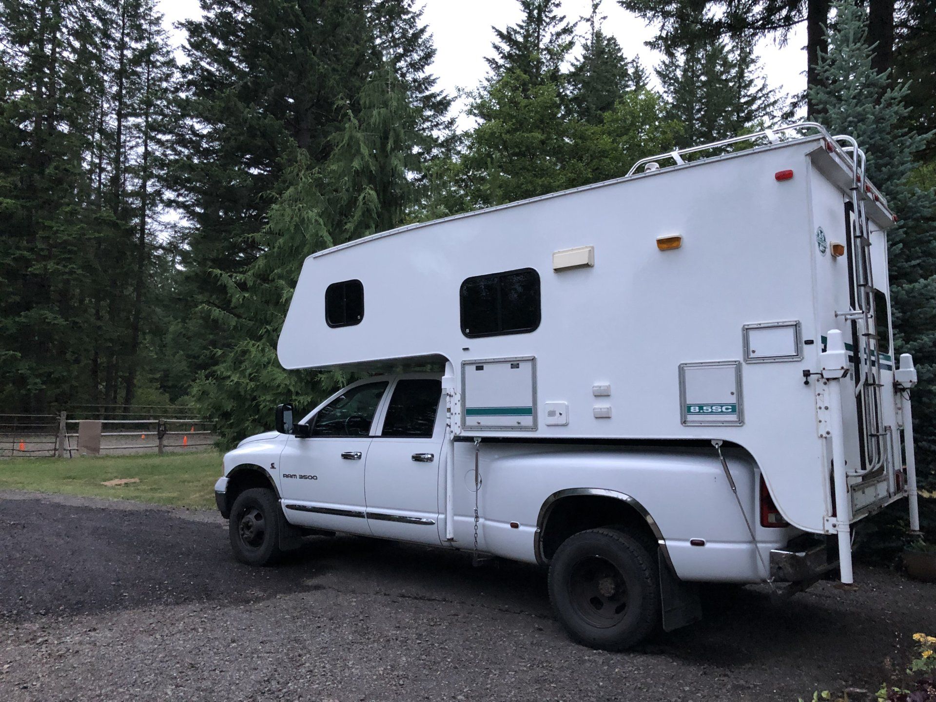

This is my 99 S&S camper I rebuilt two years ago. Bought it and got two seasons out of it but the front bubble windows leaked and started causing the front to sag and hit top of cab on bumps. End of the season I tore into it and opened a :worms:. Nobody I knew ever worked on rebuilding a camper so had to learn. I have some build pictures from that. I should post up that sometime.
