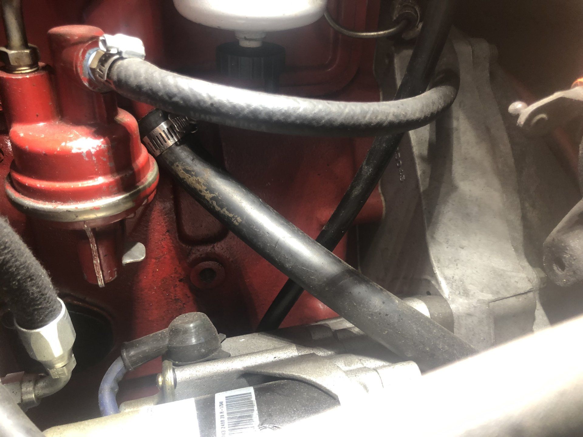

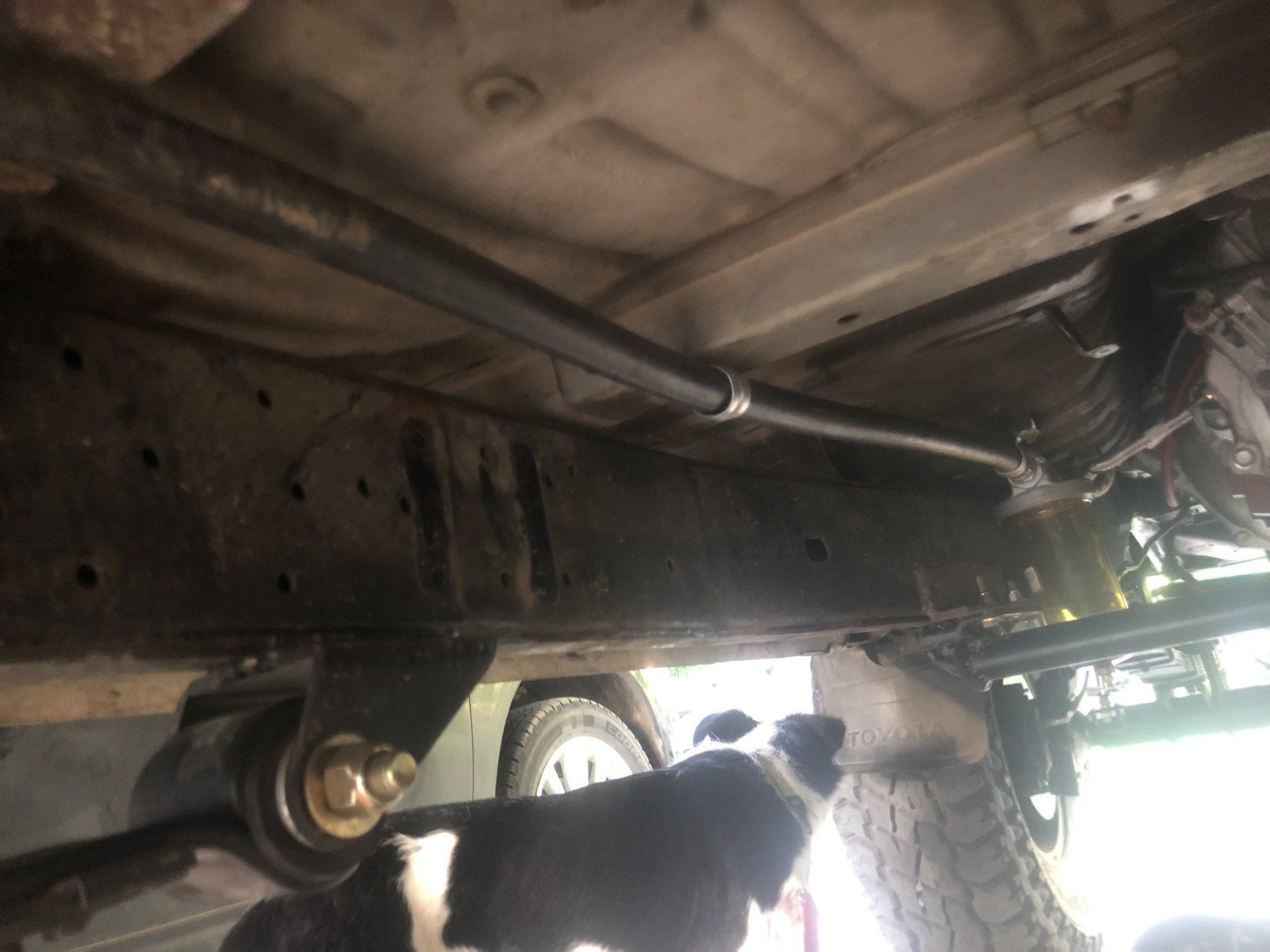

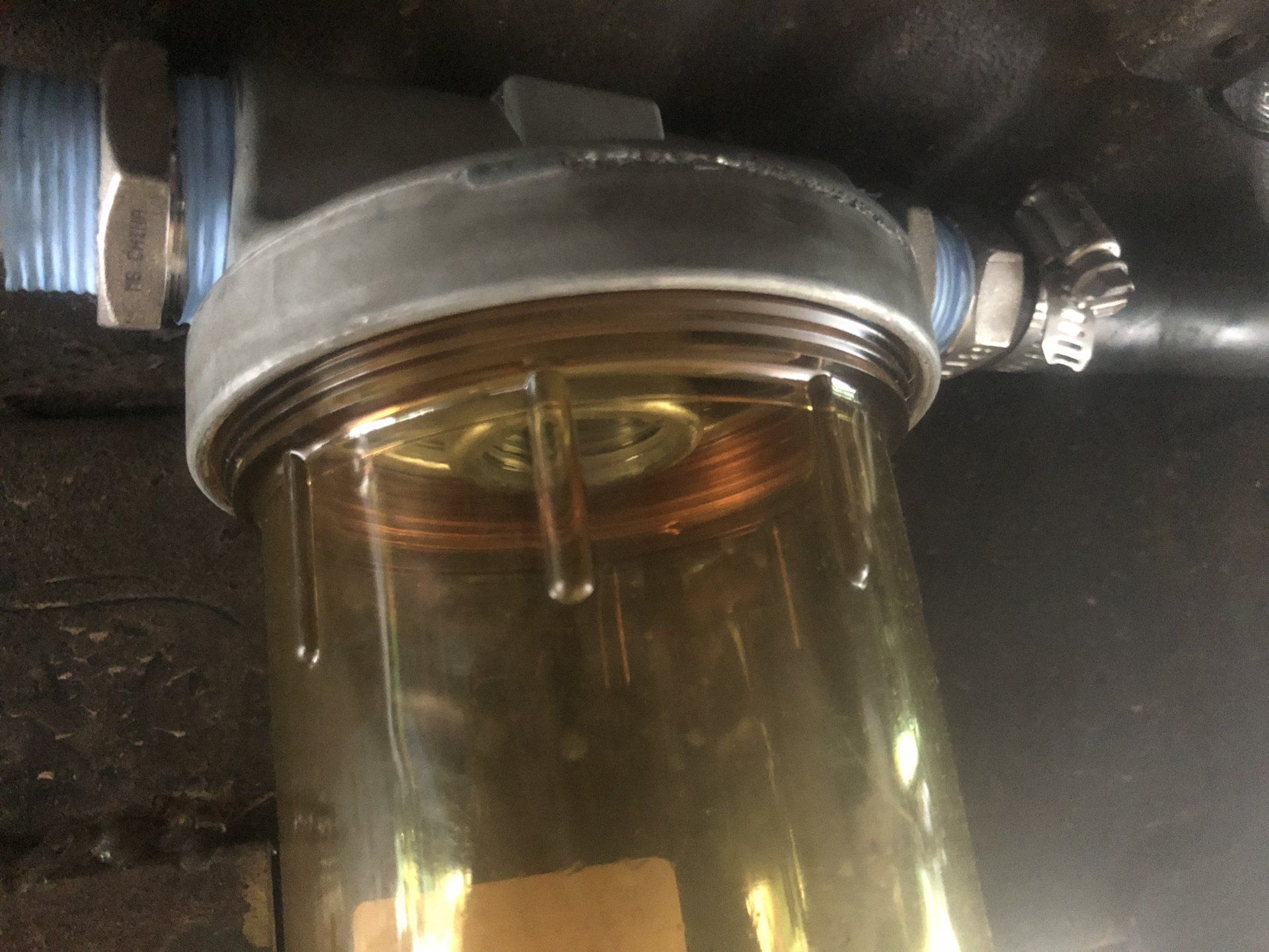

I got some 3/4” HDPE pipe which is flexible poly. Heated the pipe and hose clamped to the crankcase breather. Ran the pipe down to transfercase crossmember and installed the filter sump. I could only get 1” local so got one from Napa. It’s like the Goldenrod style I put on here a couple thread pages back. Installed 1”x3/4” bushings and poly adapters. Ran the 3/4” pipe after the sump along frame to just about the rear axle. With the 60 running it blows out good at the axle and is far enough back now that I don’t have the crankcase odor.
Attached at the crankcase breather with 3/4” black poly and hose clamp. This also helped keep my starter a lot cleaner. The oil mist vapor made it pretty sticky around the vent.
Ran line down to the filter housing. No filter inside just a sump used for collection.
Ran discharge poly as far back as I could to reduce any oil vapor odor.
End of the line and no more dripping oil.

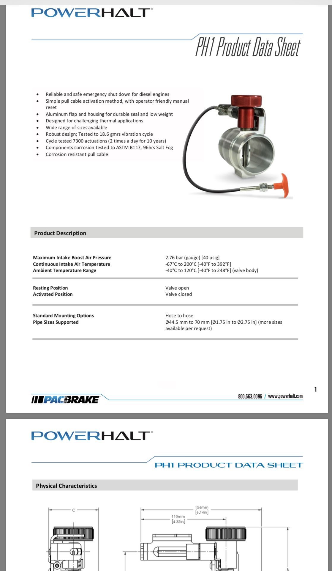

I have a PacBrake Jake in the Dodge 3500. It works great. They make a positive shut off valve to shut off the air just before it enters the motor intake. They make one with manual pull cable and toggle version. They also have one to shut it off automatic off RPMs. Thought I’d throw this out there to the diesel crowd. After all the investment I’ve made, I’d like to safely shut my motor off before it runs away. It’s about $5-$600 for the toggle switch style. Main cause for runaway is the turbo oil seal goes out and oil starts leaking into the air side of the turbo and feeds the motor with its own oil. Having a device to stop it seems like a good idea to me.

IMHO, a manual air shutoff is not worth the cost. 5th gear and stall it. We're not driving 7.3l diesels, we're driving 3.9l diesels. Between your brakes and 5th gear, you should be able to stall it.

As far as the runaway it looked like good news for a manual and killing it with 5th gear. Still as much as I’ve put in this the PACBRAKE positive air shutoff looks like easy insurance. I’ve watched plenty of videos with 4BTs running away in box vans. I’m sure those vehicles neglected maintenance which caused it. I guess for me it knowing I could safely shut it off.

If you want to put it in, it won't hurt anything.
